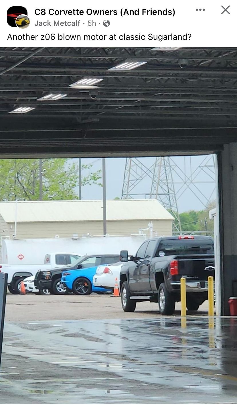

476 miles - not something I want to see done to my new Z06. Anybody know this car and what the issue was?
Edit: On Friday (3/10) a poster said he was from a Chevy dealer and had a Z06 with a locked up motor at 181 miles. The post disappeared very quickly thereafter. Don't know if it was a troll, a repeat of a car previously reported, or if the poster thought better of providing the information based on his employment status.

In the comment section someone said the engine had a strange noise and GM wanted to open it up and take a look. Don't quote me but I believe every failed engine has experienced some type of valve train failure, or a spun rod bearing. This poses the question that could there be some type of casting issue in the block or the heads causing an oiling issue. I have a feeling that poor break in procedure is not the culprit, if GM tests the engines at high mileage why are customer engines failing with very low miles.
