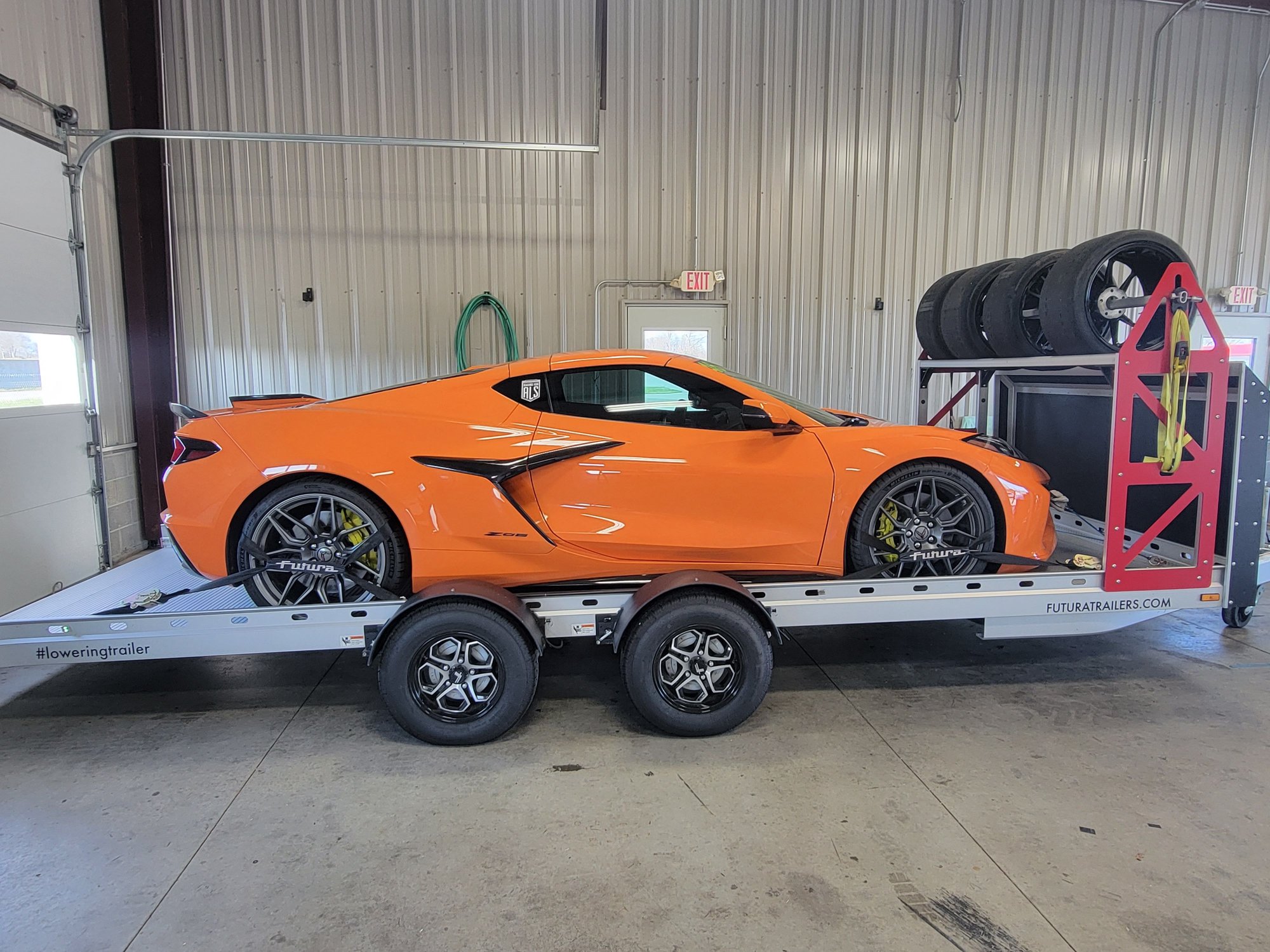

April 2nd update. Had another trans code issue at NCM. P0700 Car didn't make it a full session. I did get to meet another C8 Z06 owner / instructor that recognized me from the forum. Since it was my first time at NCM - I asked if he could ride with me and give me some pointers. Great meeting you and thank you Cy! I got to also ride along with him in his E90 M3 in track. Great driving!
Taking the Z to the dealer tomorrow. 18 hour round trip drive for one 18 minute session. I tried to call around and get some local help but the service dept was obviously closed. The track mgmt was very empathetic and even offered to rent me a C8 (but I declined due to cost and the fact I already was out 3 sessions out of 6 for that day). Thanks Zack!
I did get to see the museum - which was a super cool experience! Hate to report the bad news, was hoping it went better this weekend because NCM is one great track. A lot of blind turns, technical sections, high speed turns and elevation changes.
