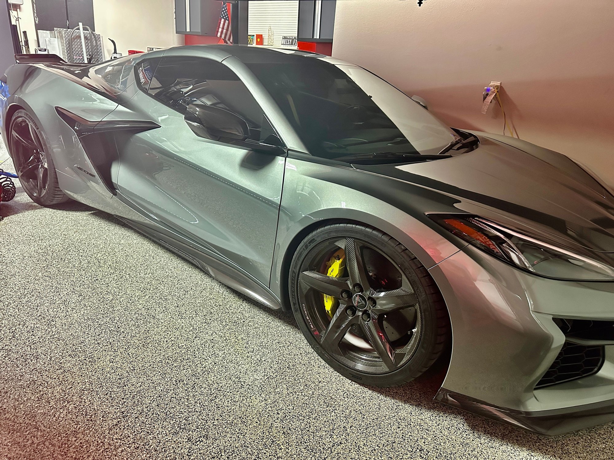

What is the measurement between fender and front tire? Is the fender below or even with the tire? Or a little above it?

The fender is slightly above the tire. It's not tucked.

Any idea how much ground clearance you have now to the splitter?? The BP here installed obnoxious concrete speedbumps at their checkpoint.

Do these collars allow for height adjustment like the non-front lift cars, or is the drop fixed? And does cutting the bump stops harshen the ride at all?

The drop is fixed. Bump stops shouldn't harshen the ride. The Z is meant to be lowered which is why it comes with coilovers.
