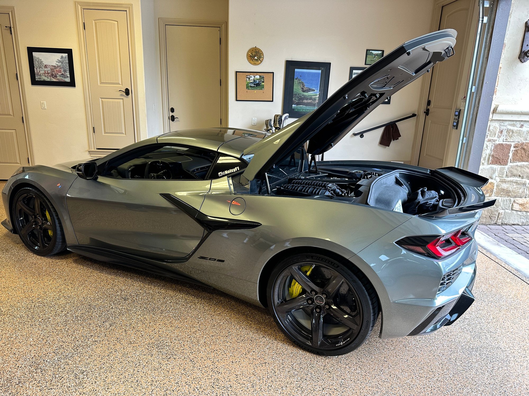

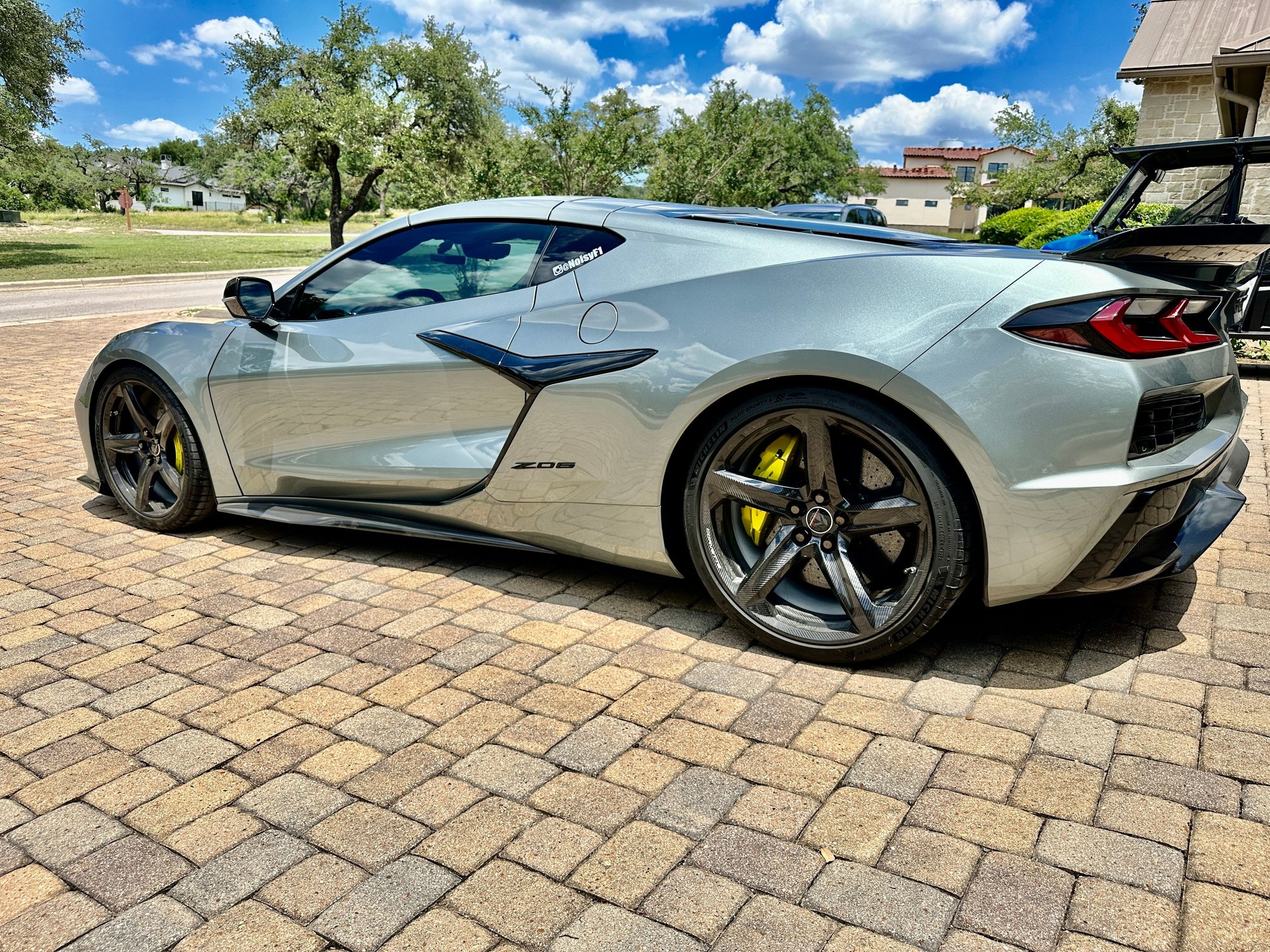

Originally Posted by smajicek
Your collars are the 1 inch from cicio correct? got any pics before and after?
Yes correct.
Here is before and after.
