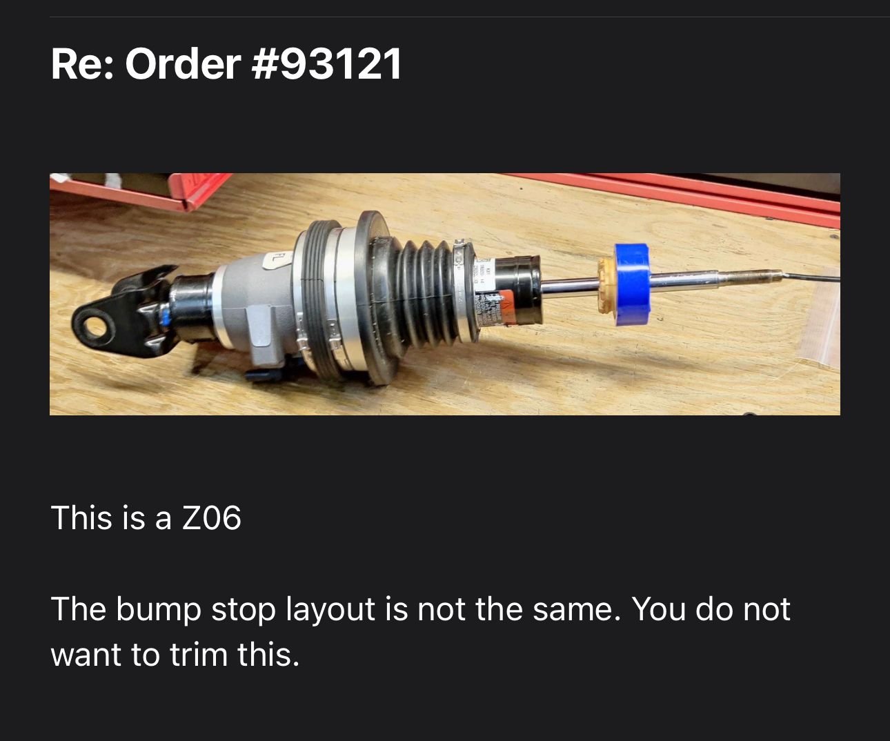

Originally Posted by RD-1
The OP is incorrect, the bump stops must be trimmed as per the instructions provided by Cicio.
That is not correct.
I spoke with Cicio today and received the attached email, you do not want to cut the bump stops on the Z06. The image you posted is for the Stingray.
So very simple install of these Cicio Performance front lowering collars for the Z06 - no cutting or modifications whatsoever.
Old May 24, 2023 | 11:53 AM
  #46
RD-1's Avatar
RD-1
Joined: Sep 2020
Posts: 399
Likes: 486
My apologies, I stand corrected. They should update their website and instructions.

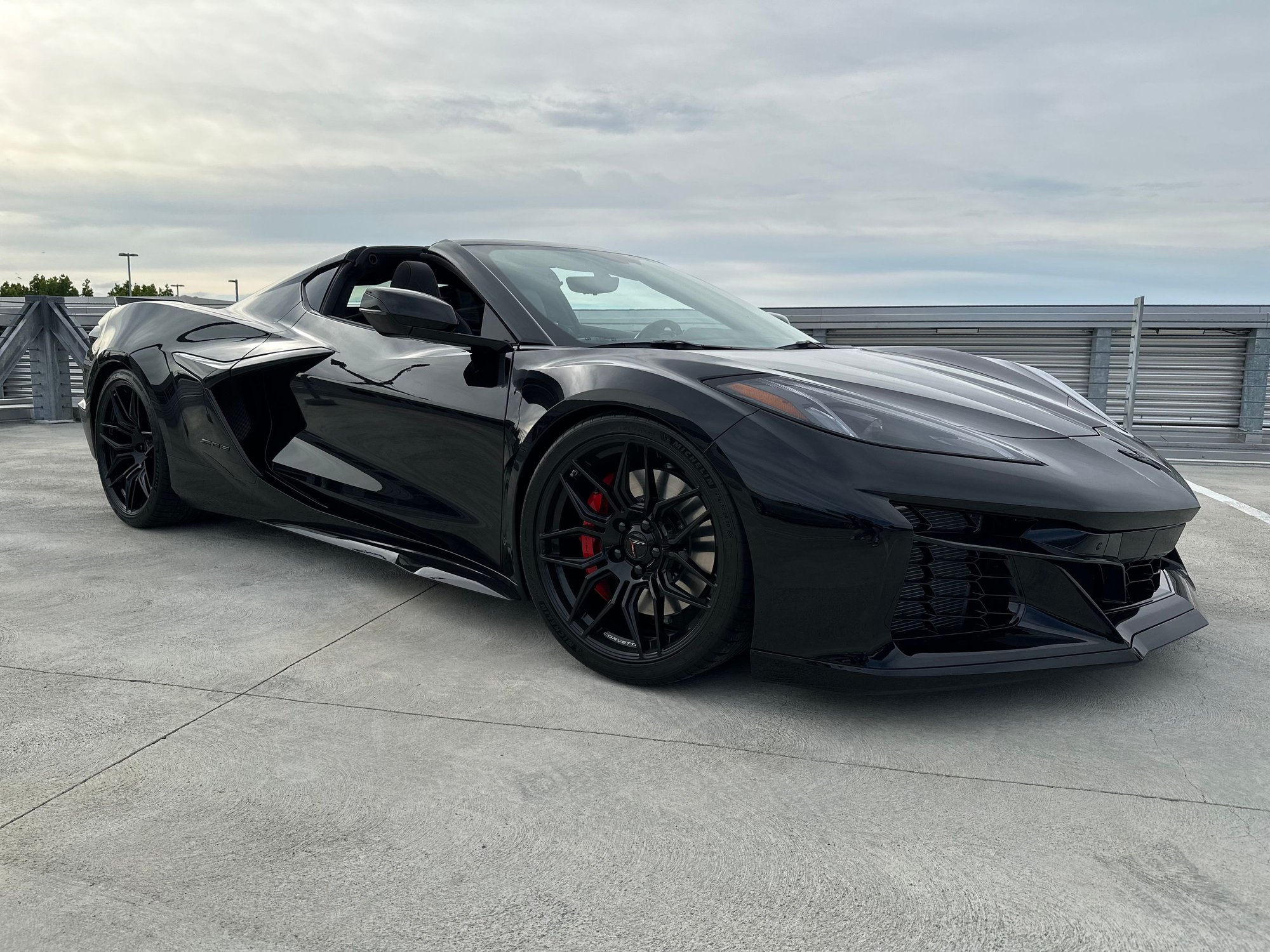

Another pic of Cicio collars installed. They go lower than the Paragon ones.

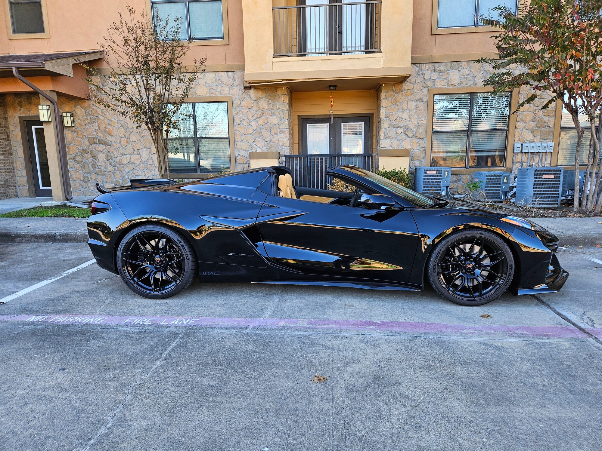

item 21012386 from GM. Here’s updated pics after settling with Cicio.
To Cicio Performance Lowering Collars = PERFECT!
