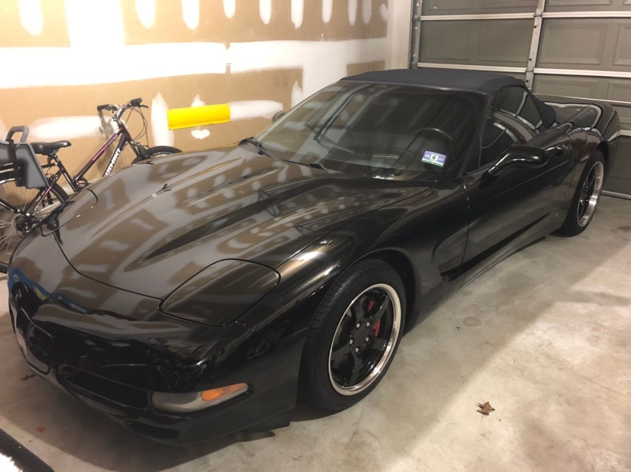

Applied adams spray ceramic coating today to my C5 ( not the new UV one) after wash, clay and surface prep.
Application was super easy, rainbows in 1-2 minutes fully cures in hours. Adams claims 6-8 months of coverage.
I’ve also applied this to my Silverado a few weeks ago and have been pleased with the results so far. I park the Silverado outside and it’s seemed to do a great job protecting from the elements.
