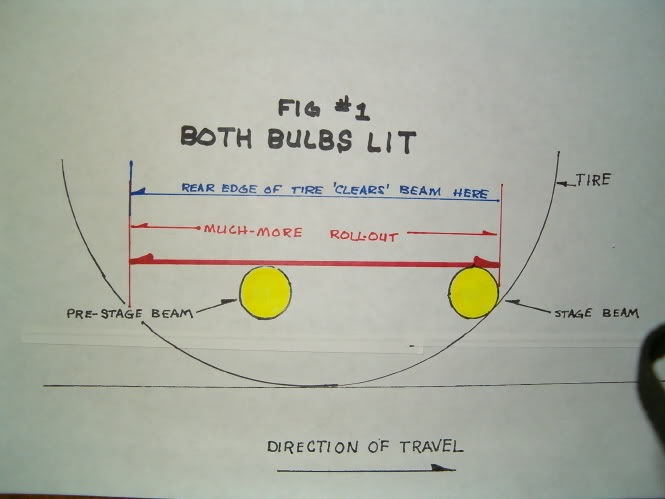

Deep-stagers don't necessarily go-Red more often than 2-bulb racers if they are consistent, and know what they are doing:
inconsistent racers are consistently late, then early, then on-time.
deep-staging is no-different than a batter, standing a few inches deeper in the batter's-box against a fastball pitcher:
it is a legal, strategic maneuver employed to provide a racer with what he feels is an advantage for his particular vehicle

Great diagrams. It is easy to see how much movement you have before you go deep and even how much you have after you go deep which you did not diagram but we can visually the rear of the tire sitting stage light.
HUGE difference. A driver taking advantage of all that can slow a car easy .2 as well as increase rt up to the same .2
