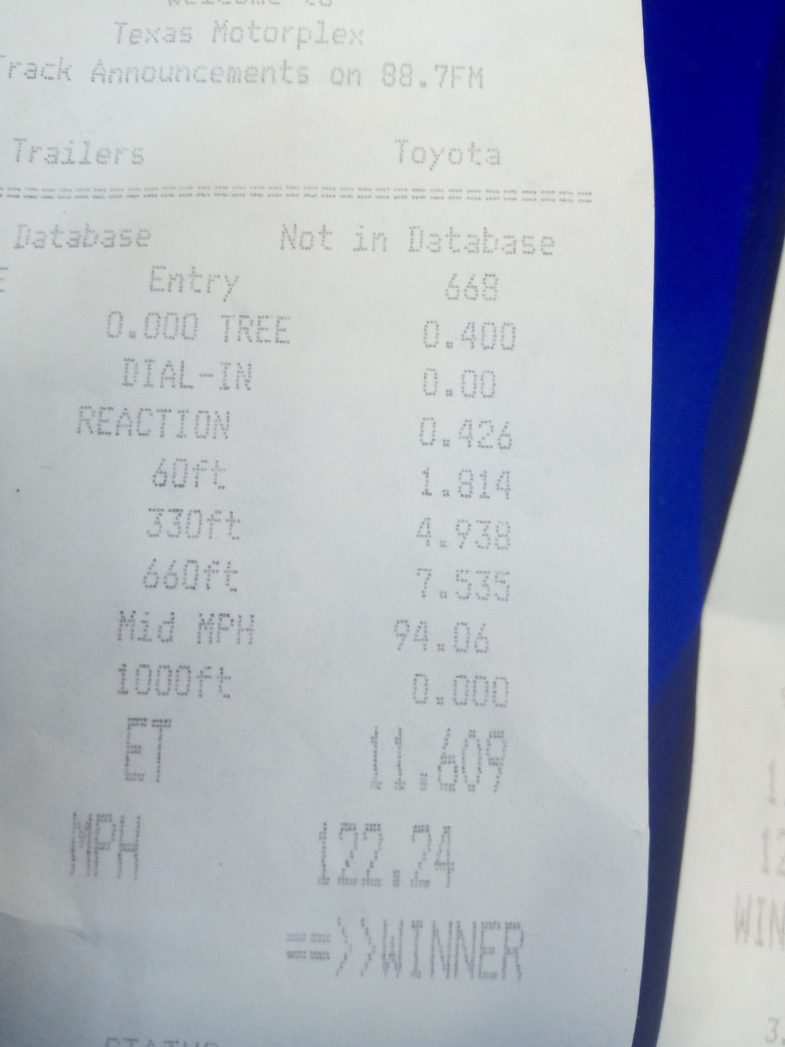

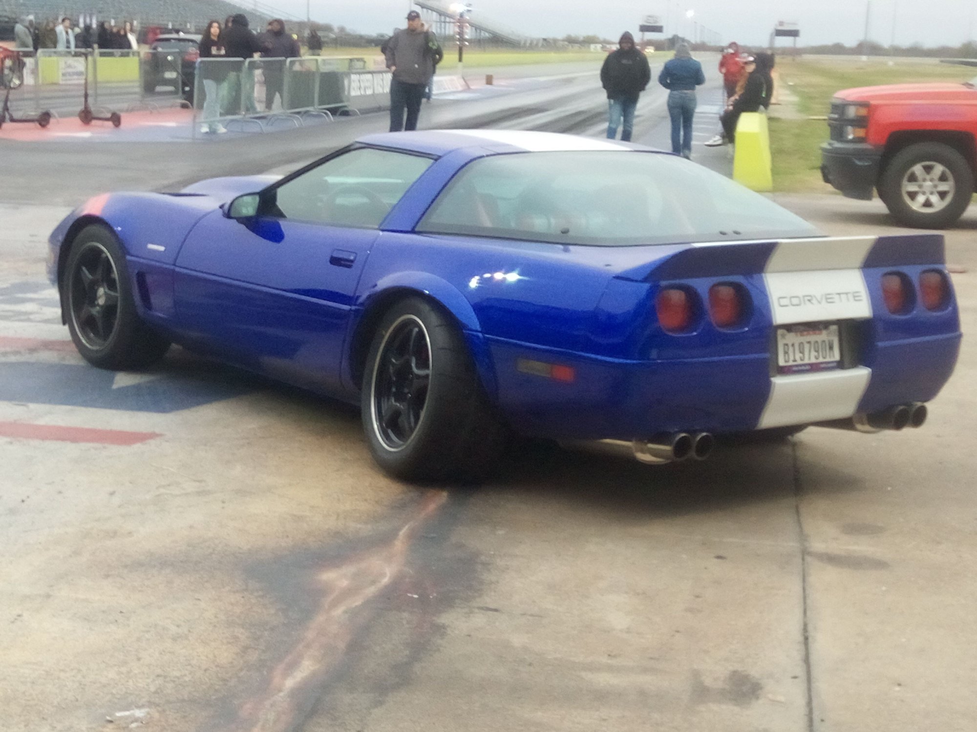

I ran my 96 GS quite a few times at Texas motorplex. Hard to leave with the 6 speed and lite weight aluminum flywheel. I was leaving at idle and running consistent 11.60 @122 mph. The first time I tried to leave @ 2500-3000 It broke the driver outer spindle. No more drag racing my c4. I know what it will run now and have my c3 vette to race with a solid rear axle. It's fun and addicting but can be $$$$$

Wow @GS977 , what mods do you have? That’s incredible.

383, Lt4 heads I ported myself, 58mm tb, 12.18:1 comp, gm847 cam, 1.6 RR, electric wp, delteq ignition (Opti eliminated) 42lb injectors, 373 gears, 3in dual exhaust with x pipe, car is heavy. Weights 3375 without me in it.

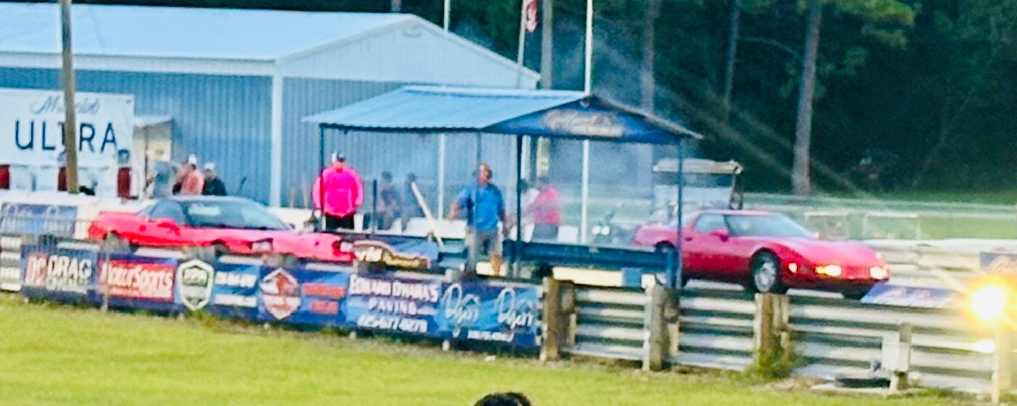

My 84 which I have been racing for about 15yrs. Started with a stock car that was swapped to a pump gas 427 SBC, TH350 and D44 IRS. 10.40s N/A and 9.00s on nitrous. Eventually I built the 427 into a high compression 434 and went 8.30s@162mph in the 1/4 on the stock IRS suspension with 1.24 60ft best. There were failures of ujoints and outer stub axels but not as bad as you think. Tq converter, power management and suspension setup makes a world of difference drag racing these cars. Also weight... getting light helps alot.... I had to weight 3150lbs back when I still raced with the stock IRS.
Currently it has a 440 SBC on nitrous with a close ratio TH400, 9" rear with S197 3 Link rear suspension for "stock suspension" class racing. I only run 1/8th mile now and have been 4.94@140MPH (that well into the 7s in 1/4) with a best 1.08 60ft on a tiny MT 255 60R15 R drag radial tire. Its been een 1.11 60 on the MT 275 SS street tire..... Currently weight 2950lbs. Still street legal.. heck even the power windows still work.
Lots of videos on my YouTube as well.
