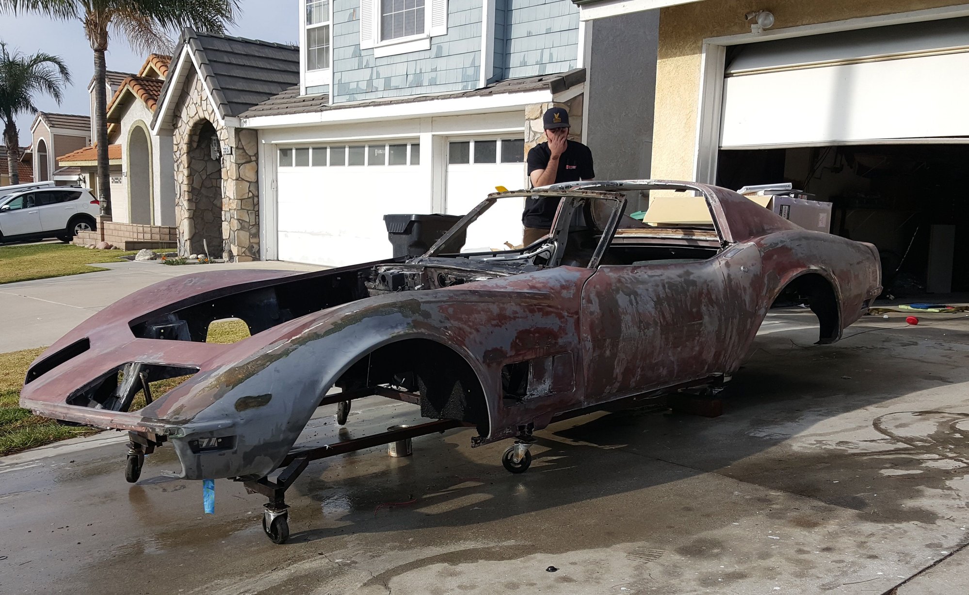

here it is stripped
stripped

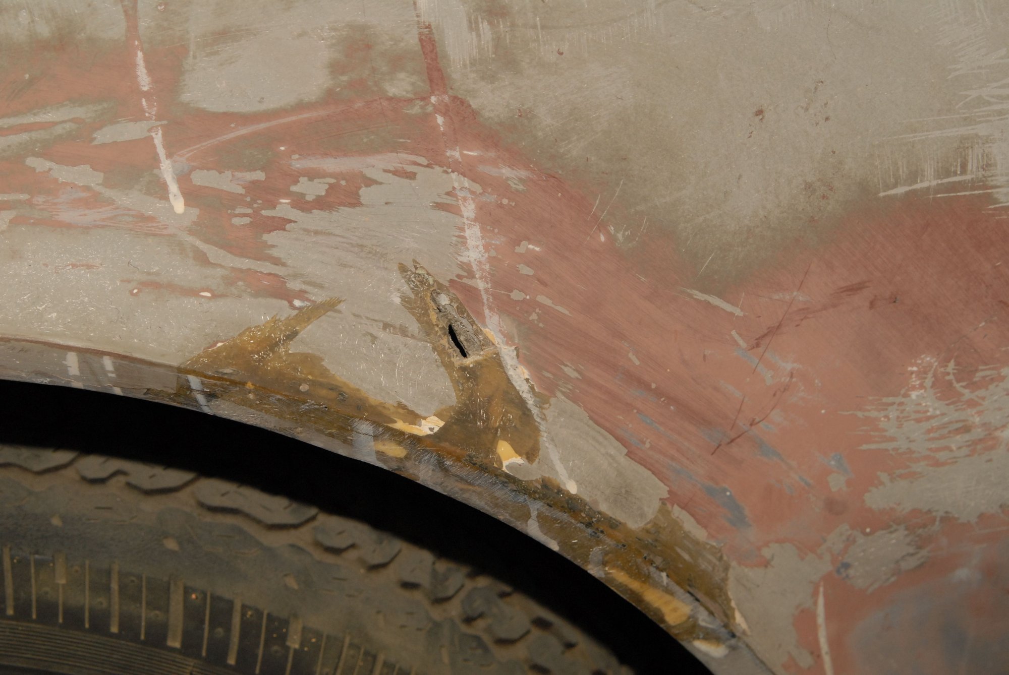

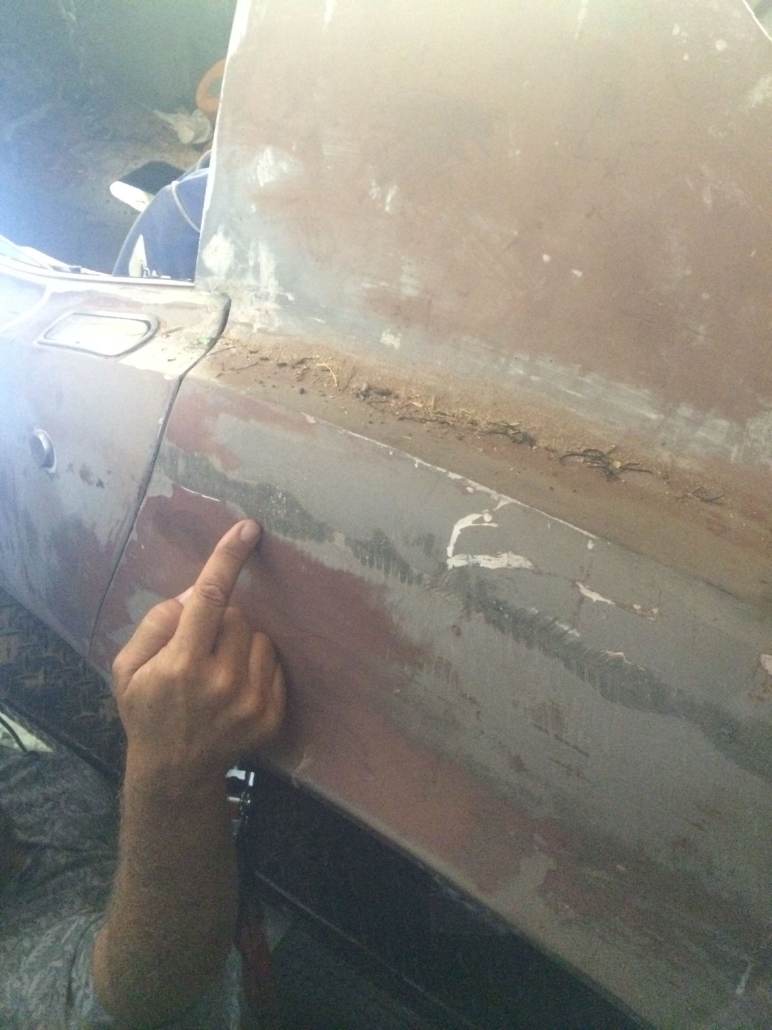

here is the rear quarter panel damage
Old Jan 21, 2016 | 11:50 AM
71frameoff's Avatar
71frameoff
Joined: Feb 2014
Posts: 228
front fender had been replaced. wheel well opening not correct. too close to the tire in front. I will replace the entire fender when I get it on the frame.

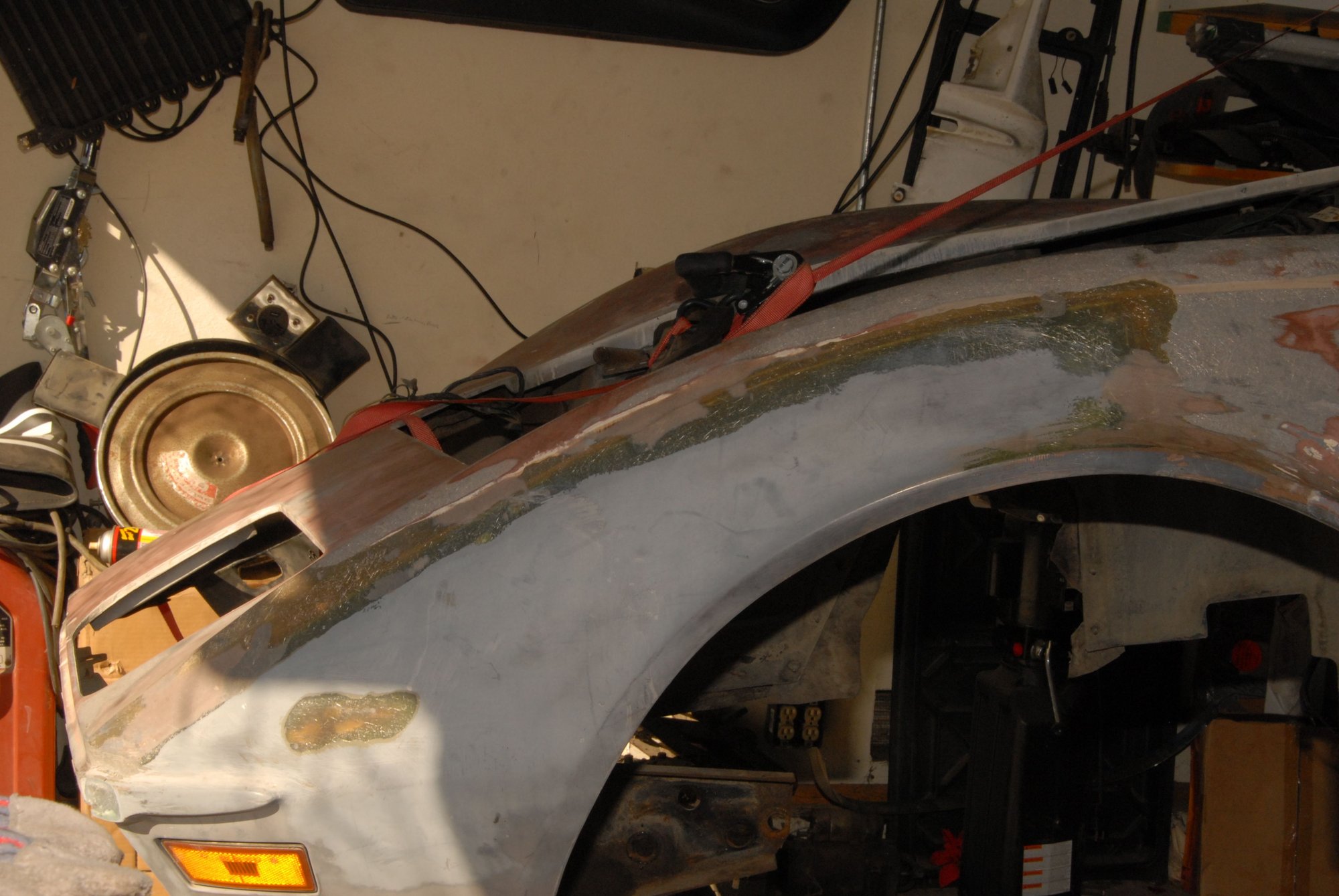

front fender has a ton of bondo or some other cheap junk that has to be removed.

HONESTLY...I would STOP and NOT grind out the seams at this point...because ...as I wrote....HONESTLY..... this Corvette is not stripped.
In my opinion...which I know was not asked for...BUT before I would do any body work and grinding..I would have to get the body down to BARE panels and NO primer. And as always...its your car...do as you like.
And...there would be a limited amount of work I could do while the car is on this body dollie. Attempting to perform panel alignments and getting them right and or replacing panels....especially the front fender CAN ...possibly come back and HAUNT you.
I do not install some panels when the body is NOT on the frame. Mainly because ...I have done it and GOT seriously screwed by doing it. If you choose to do so...I hope all comes perfect.
In post #13..the first photo...you can see that the top hood surround is NOT a light gray...which means it is NOT SMC...for all those who may wonder how to tell.
In POST#12...the light gray fender section IS SMC.
DUB
