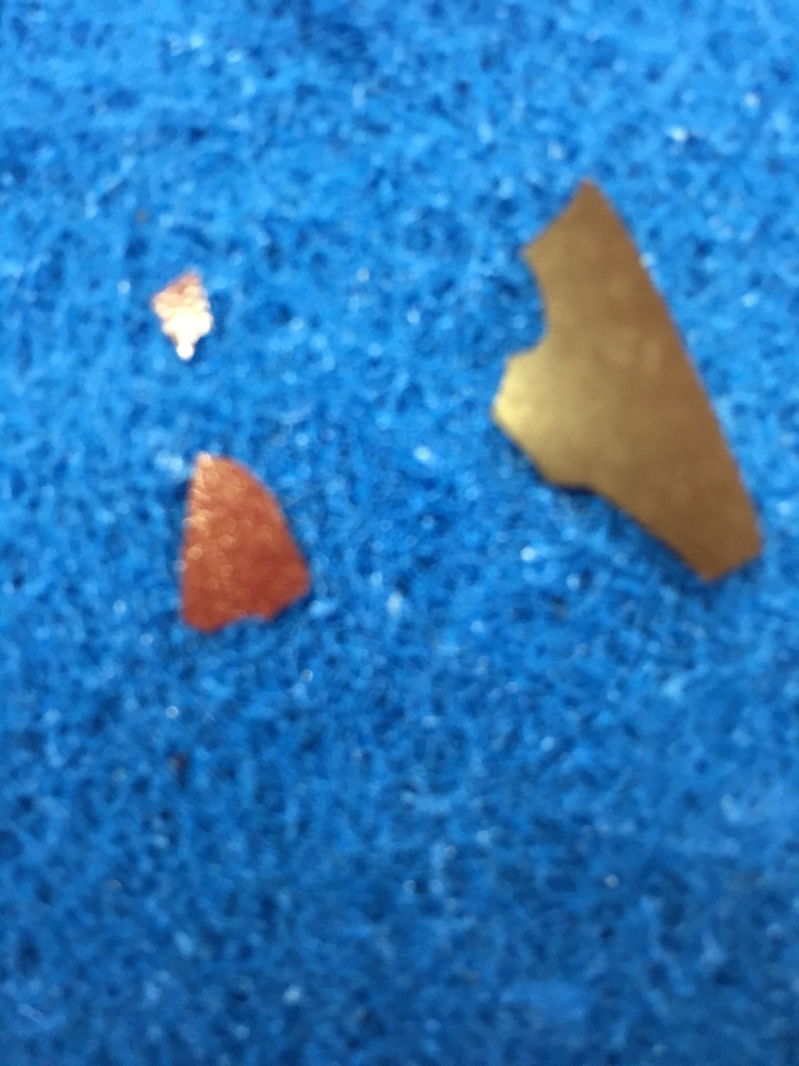

Old Feb 7, 2016 | 09:34 PM
croaker's Avatar
croaker
Posts: 2,364
Likes: 103
From: Centerville Louisiana
I'll check it out tomorrow. Thanks

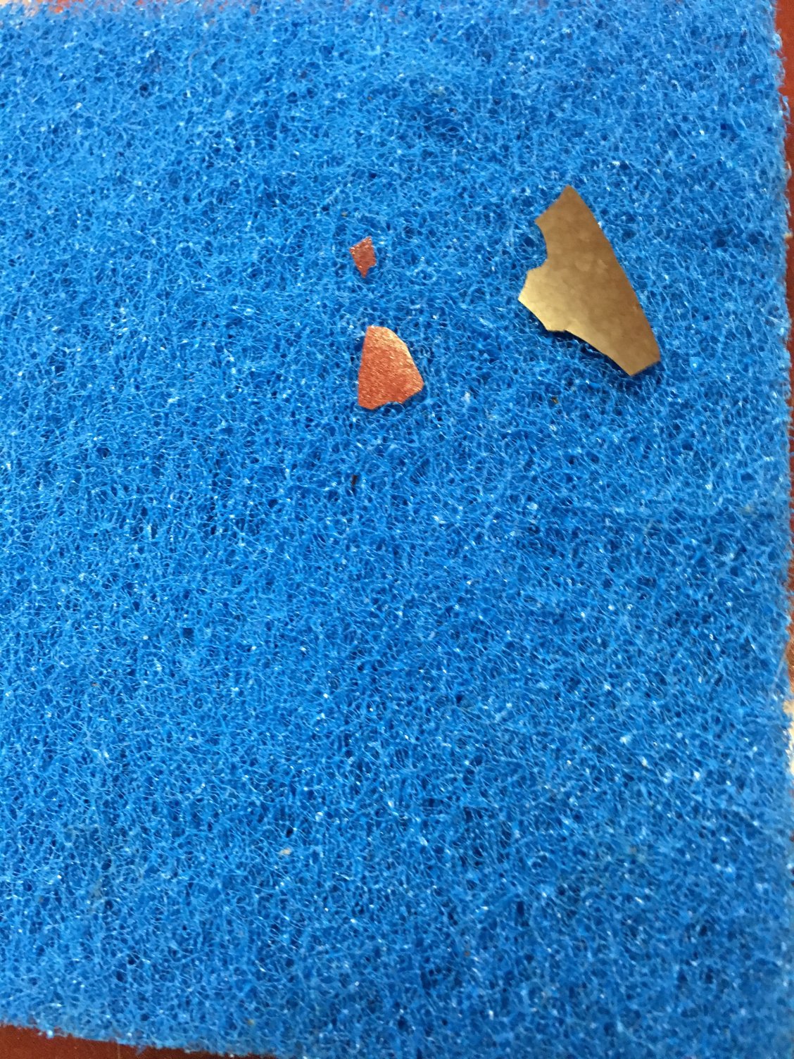

Old Feb 8, 2016 | 09:43 PM
croaker's Avatar
croaker
Posts: 2,364
Likes: 103
Some close ups
Old Feb 9, 2016 | 05:20 PM
DUB's Avatar
DUB
Joined: Apr 2009
Posts: 19,294
Likes: 2,753
From: Charlotte NC
Sorry ....these photos are no help. Even if they were in focus...it would be hard to actually tell if that is raw SMC or not.....which is why....
I need to know the answers the the first two questions I asked in post #4.
DUB

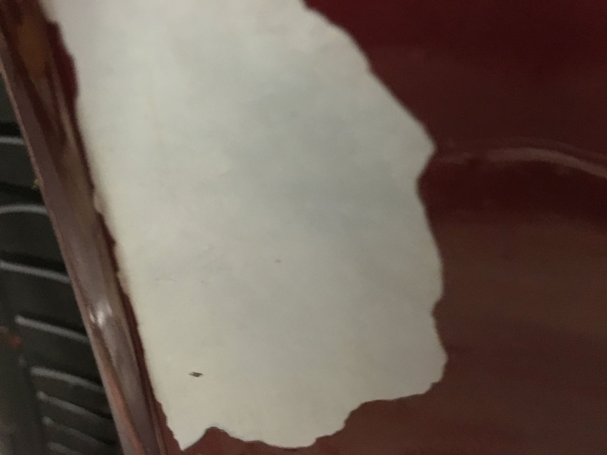

Old Feb 9, 2016 | 08:33 PM
croaker's Avatar
croaker
Posts: 2,364
Likes: 103
Both sides also I drug a razor blade edge ways across the area and it didn't dig in
Old Feb 10, 2016 | 05:37 PM
DUB's Avatar
DUB
Joined: Apr 2009
Posts: 19,294
Likes: 2,753
From: Charlotte NC
VERY GOOD PHOTO...THANKS.
QUESTION:
1.) Does the exposed light gray area have any dark gray streaks or what may resemble what marble might look like????
2.) Is this light gray exposed areas shiny???
IF you answered YES to question 1. Then this is the raw SMC and it should be protected.
AND question 2 does not matter if you answered YES to question 1.
RAW SMC looks like a light whiteish-gray marble. Where you can have some random dark gray streaks that will run through it from time to time. I have seen some SMC panels that were a consistent gray color...with very little to no streaks init.
SO...if you have an edge where the paint is off the panel and lightly scuff the edge. IF there is a primer applied...you should be able to easily break through the primer due to sanding on an edge...and that will let you know that the panel has been primed.
The dark red/brown color on the backside of the one paint chip tell me that it seems to have been primed with a lacquer primer. And it is releasing due to more than likely improper sanding techniques or surface prep prior to priming......which is why I asked if the panel under the paint is shiny or not.
DUB

Old Feb 10, 2016 | 09:16 PM
croaker's Avatar
croaker
Posts: 2,364
Likes: 103
So what type primer would you suggest to put on it ? knowing it will be road tested driven for a while before paint
Old Feb 11, 2016 | 05:37 PM
DUB's Avatar
DUB
Joined: Apr 2009
Posts: 19,294
Likes: 2,753
From: Charlotte NC
Knowing that whatever you put on is going to HAVE TO come back off again.
So...IF it is RAW SMC...you can use some aerosol can primer from who ever you choose. The main thing is to get something on the raw SMC. And if you find some of the touch up aerosol can paint that is close to the burgundy color...you can apply it on top of the primer and that will also seal it up a bit more.
DUB
