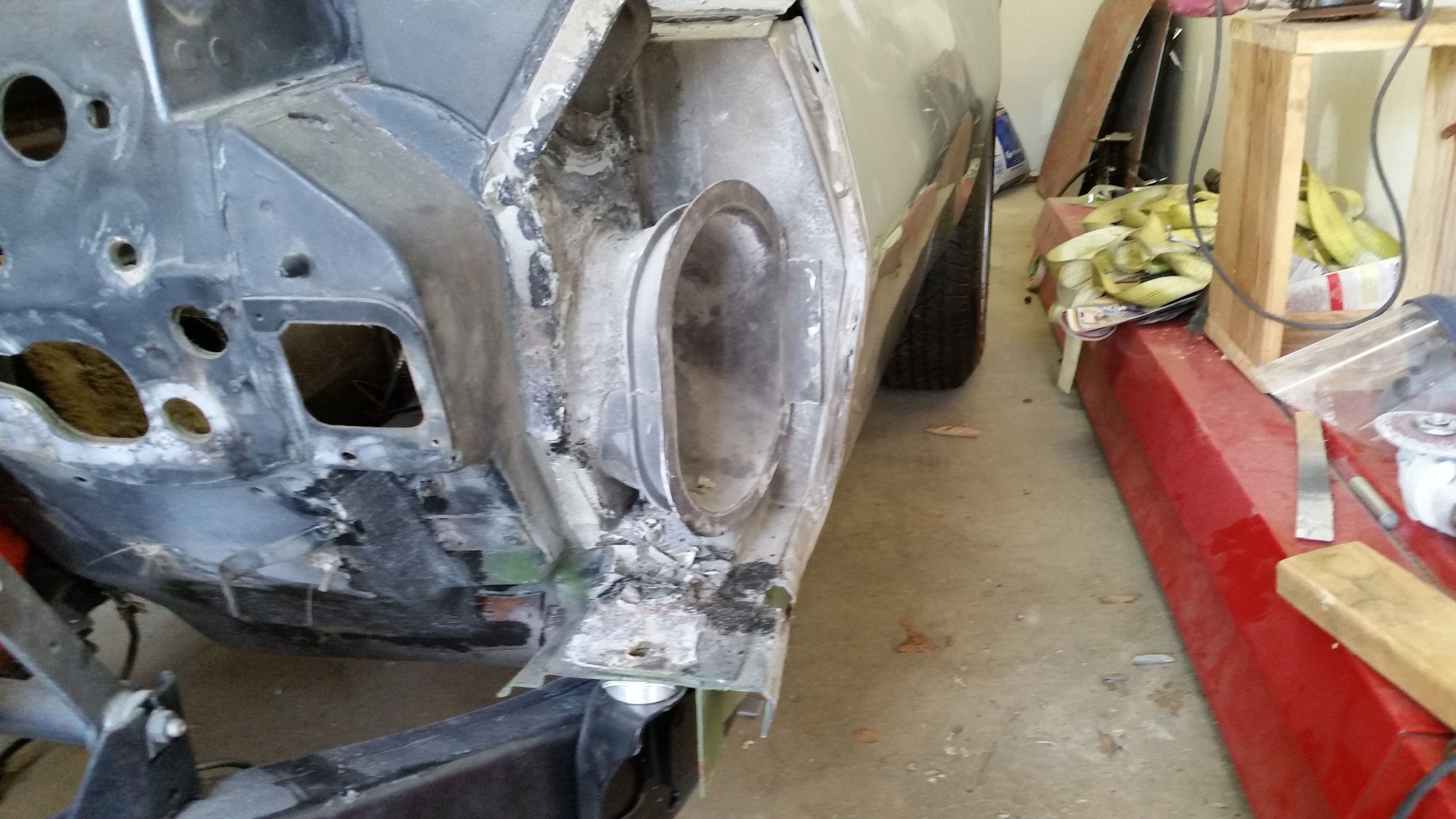

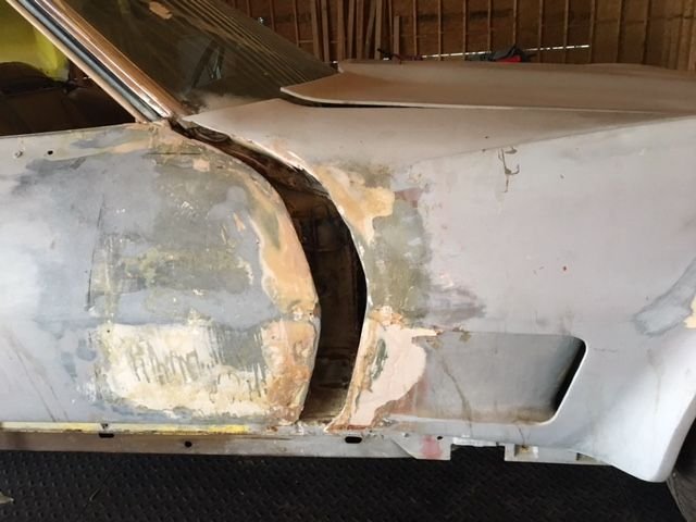

I am in need to replace the front passenger fender on a 1975 corvette (I purchased it this way s don't beat me up). As you can see, part of the surround panel was damaged in addition to the fender and door panel and has to be replaced. Has anybody had experience replacing with a 1\3 front clip. Any tips\tricks\advise is greatly appreciated. I have done fiberglass work on boats and jet skis in the past but this will be the first time on a corvette. Thanks in advance.

I feel you are missing more SMC than just what is obvious.
I should not be able to look in and see the hinges in their entirety...so I feel the bonding panel that allows the fender/top hood surround to bond and compete the edge at the door is missing.
As for sectioning in a front clip and doing it a '1/3 clip'...I do not do that....mainly because for me it is waste of time and really nothing is gained except for the increased possibility that the splice area can crack or distort on you.
I either install the panels like GM designed them to go in when they were manufactured...or I install complete front clips.
But do as you wish and I hope all goes well in that respect.
DUB

Thanks for the advice as I will have more questions as I dive into this. Like I said, this is how I bought it. 1975 corvette convertible 4 speed car for little over 22,000 miles from the original owner. Unfortunately, he had started to restore it but had a stroke and cannot speak and can no longer work on it so I can't get any info on what happened.
Yes, I am pretty sure that some inner panels are missing and\or cut up and will fix once the fender\front end is removed. Right now I am leaning toward a new front end. Besides cost, what is the difference between the hand laid and press molded front end and what are their good and bad points?

Looks like maybe some of the plenum area and or firewall is missing.
