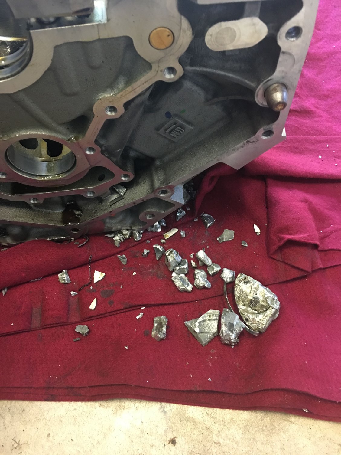

They sent me a new head, wanted the ms90 guides but that didnt happen.I thought I was going to get 2 new heads, but they just did the bad one. Then I had to replace the piston and hone the sleeve.
Sounds like you were lucky, this is what happened to a friends motor after having heads redone.
The pieces are what was a piston.
And the block was junk.

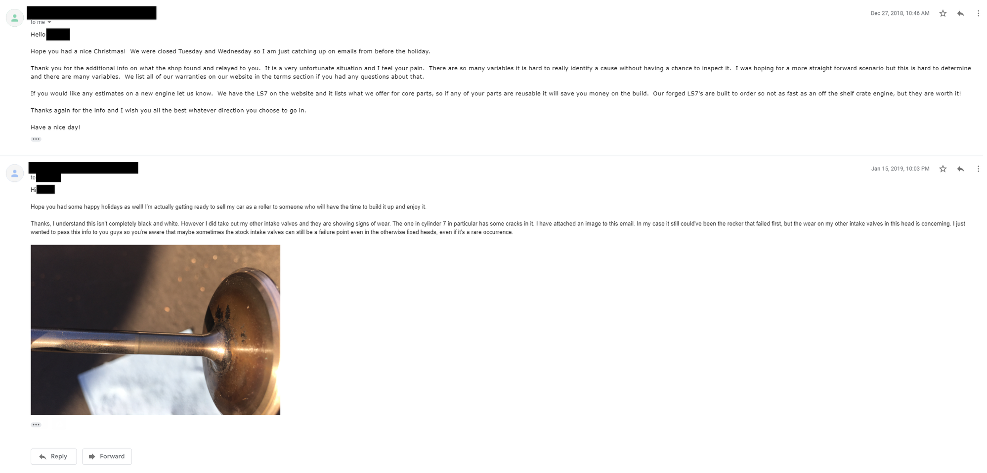

My intake valves were polished. Actually, AHP still offers their "AHP Package 4 LS7 Cylinder Heads" with "Stock Titanium Intake Valves Treated and Polished" (quoted directly from their website). So if this really is an issue, then there are heads still being sold with it, which is one thing you all should worry about if you have these heads. This thread already had a few others with broken intake valves, so the risk is there.
Look at my original thread here about my engine failure, and you'll see what my intake valves looked like: https://www.corvetteforum.com/forums...-blown-up.html
Look at posts 47, 84, and 87. I actually remember you posting on that thread!
Post 47: https://www.corvetteforum.com/forums...post1598519143
Post 84: https://www.corvetteforum.com/forums...post1598590935
Post 87: https://www.corvetteforum.com/forums...post1598591393
Especially look at the #7 intake valve in post 87. When I emailed AHP the pic of my #7 intake valve, I never heard a response. They also mentioned in that thread I posted above that a real professional would never look at pics, but they complain about a guy in post 16 in this thread about not sending them pics. I would've definitely worked with them to send them my heads if they were at all curious about what happened (if they paid for the shipping, which is not unreasonable when you can clearly see the condition of the intake valves), but they never asked or insisted, and they never appeared to be concerned at all that their product may have a flaw. I was the one keeping the conversation going and reaching out. Post 38 asked for people to post experiences like mine, so I hope this info helps people when they decide to buy new heads.

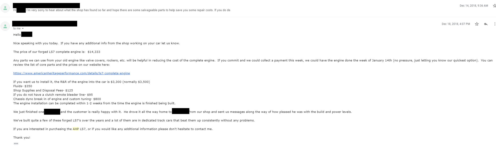

I stated in my engine failure thread that AHP did the head install from start to finish. I called them up, they prepared the heads ahead of time, I drove to them and dropped my car off, stayed overnight so they could finish installing the new heads the next day, then picked up the car.
Originally Posted by 73DBG
Also feel like there’s a lot being left out most likely, not saying quality control mistakes don’t happen and AHP isn’t immune to that, but I do find it hard to believe a reasonable solution wasn’t offered. Reasonable meaning a compromise on both sides. One can’t expect a shop to cover a $15k+ new engine when the customer only paid for say $3k in parts/heads...that’s barring gross negligence that can be proven beyond a reasonable doubt that the parts in question could be isolated to the specific cause of catastrophic engine failure. Now that’s gonna be extremely hard to do on a modified race car engine, regardless if you don’t give your Z hell, it’s still a race car with a race car engine.
What exactly do you think is being left out? If you're going to make that claim, please be more concrete about what else you think you need to know. Both sides said their stories in my original thread about my engine failure. I was actually very nice in how I handled things, both in that thread, and in my calls and emails to them. Unfortunately I think that's probably why I was brushed aside. Yeah they offered to allow me to pay them a ton of money to work on the car again, but I don't consider that standing by the product. I also never asked them to replace the engine for free.
Of course things can break, no one can argue against that. But don't you want to know about the possibilities? And then once there is evidence of parts failing, wouldn't you want to see the shops do a root cause analysis to try to ensure it won't happen again? Otherwise, it will happen again. If it happened once, it can happen again given the same conditions. Do you agree?

Regarding the GM LS7 Titanium intake valves. Its is no secret that they suffer from lack of QC and finish quality. This is evident by a microscopic examination of the surface finish on the factory valve stem as they come from GM. What you will find when doing that is two things. One inconsistent and thin (bordering on poor) CRN coating. Two Decent RA finish but very poor RZ finish.
These two things are issues that GM produced the factory valves with (not us). Even Del West the manufacture of these valves has openly admitted these two issues and say the GM ti intake valves are not an accurate representation of the valves they are capable of producing. In short GM forced the manufactures hand to make the valves to GMs spec (for budgetary reasons) and not to the recommended specs Del West advised GM to make them to.
As a result of this we treat and tumble polish all our GM factory ti intake valves to do two things. One help harden and even out the factory CRN coating on the valve and two correct any RA and RZ roughness issues that may be present on the valve stem from GM.
Over the 8 years we have been reworking LS7 heads we have had very few issues with the factory GM ti valves after they go through our process. In fact the process we use on the factory gm ti intake valves is a process we carried over from one of the F1 teams a few of our guys used to work for/with.
With that said the failure Corvette_D is referring to occurred on a set of heads that was reworked in mid 2016. We have since then tightened up quality control on the factory valves even further and in fact any time in the past where has been any sort of issue what so ever we make changes (both policy and process) in order to correct said issue moving forward.
We do all we can do to ensure the quality of the GM factory titanium valves we are reusing/reworking on our head reworks meet our stringent quality control standards. For those looking for even more security or piece of mind we do offer both new (vs reused) GM LS7 ti intake valves as well as our very own AHP Ti Moly LS7 intake valves as upgrade options. With that said the issue/failure rate on the stock treated/polished and reused GM LS7 ti intakes is so low (less than .03%-.04%) that most choose (for budgetary reasons) to stick with the stock GM LS7 titanium intake valves being reworked and reused.
Something else to note regarding factory GM ti intake valves is that GM did correct the valve stem issues on the C7z06 titanium valves and treated/tumble polished each and every one of the LT4 titanium valves before installing them into the heads.
We would like to note that we have reworked well over 2,000 sets of LS7 heads over the years and have had less than a .03% failure rate on those heads we have reworked. That is a 99.97% successes rate. We feel that this is important to take into considerations and put into perspective when reading things like what Corvette_D is posting about.
Regarding Corvette_D's situation above he is posting about I would also like to address that (Corvette_D) is not stating the entire situation.
In late Sept 2016 (Corvette_D) picked up his car at our shop after we completed the work.
On 6/1/18 "D" emailed us asking about welding an extension on his dry sump tank along with potentially installing an oil pan baffle.

I would like to address all the points made by AHP.
It doesn't matter that GM produced the valves with issues. The issue is that you, knowing that, still use those valves. What sort of analysis have you done to prove that your "fix" makes the valves better? Who knows, maybe it does, but it doesn’t appear to have worked in my case or other's cases.
After seeing my pictures and hearing my story, what did you change?

I'll post them then (and to not be hypocritical and invade anyone's privacy, I will blackline all personal information. If the fact of showing these emails is still deemed person information and against forum rules or terms of service, I will happily remove them and am only going this far as I have been provoked to do so and would normally never publicly display emails without the consent of all parties involved)
First email is for context, the second email shows the prices. Not sure how AHP was doing good by me for quoting me all this stuff.
Here I'm also showing the email I responded to as well for context. I never received an answer to the email showing the worn intake valve
