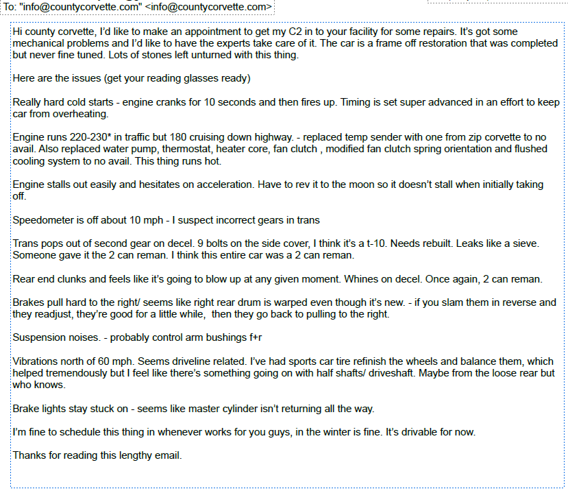

First John is a highly competent mechanic with his own shop. He brought the car to us in absolute frustration in being unable to fix, in his words, a “Frankenstein” car and a "2 can reman." He sent that in an email.
Thank you for the accolade. Yes, I did make those statements. However they were in a jocular and sarcastic fashion. I used that verbiage to explain the cars transmission and rear axle, which I was hoping you would address. The term "Frankenstein" was never expressed by me.
Here is an image of the initial email I sent highlighting the issues I wanted repaired;
Initial email to cc
The car came in with poor running, drivability issues, vibrations and clunking noises. We were able to diagnose the engine misfire was due a to zip tie end stuck in a valve seat. It did take some time to uncover that.
I'm still curious why you didn't perform a leakdown test sooner. That would have revealed the zip tie hanging a valve open. Personally I would have performed a leakdown test after the compression test. Also, I still ruminate how the head of a zip tie being lodged between the cylinder head and valve seat didn't create any piston to valve interference.
We did resolve the vibrations and noises to a certain extent, but John was upset that we would not take the car to 80 to 100 MPH where he was still feeling vibration on reproduction bias ply tires. It should be obvious to all that we did our best to reasonably fix the vibration but obviously cannot and will not drive customers cars at 80 – 100 mph.
The car left your facility with clunking noises and marginally improved vibrations around 70 MPH. I was not "upset" that you wouldn't drive the car at 80 MPH. The corvette is equipped with retro appearing radials. There were never bias ply tires on the car while it was at your facility.

Yes, you installed remanufactured trailing arms to remedy a clunking noise in or around the rear of the vehicle. It did not rectify the issue. I have emails from you stating that the clunking noise was still apparent after your repairs were executed. This was the last futile repair made on my car, so I did dispute those charges. Chase honored the dispute and I received full restitution.

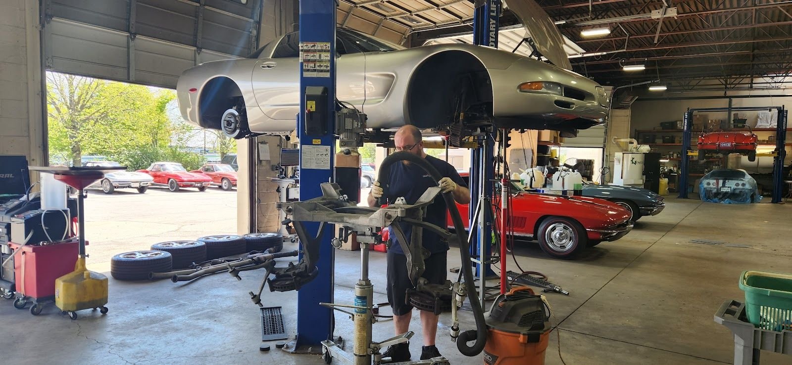

Why has no one noticed that the image of the balancer installation by the original poster shows a 1965 and up frame with the big block notch. Not from this car I can assume.
