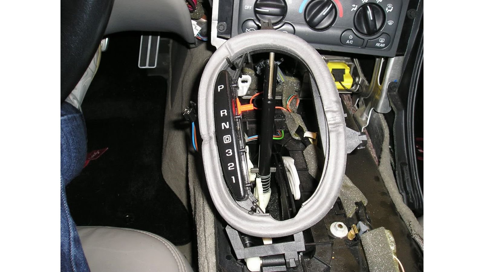

Most floor-mounted transmissions have a safety switch under the boot. With your engine off, you can remove the boot, press the switch, replace the boot and try shifting out of park. This could take you upward of 60-90 minutes to complete, but could save you hundreds, if not more, in the long run if you're able to resolve the problem without replacing any parts. To remove the boot:
- Remove the shift knob.
- Remove the center console.
- Expose the shifter and shifter boot.
- Lift the boot off after removing the four 10mm bolts on the rubber shift boot.
- Press safety switch.
- Put boot back on.
- Replace the center console.
- Replace the shift knob.
While you have the boot off, you also may want to wipe down your shift interlock solenoid.
