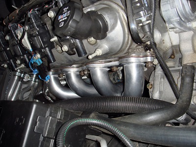

Nice view of what the stock manifold collector looks like though. Compare it with what Kooks uses:
C6header4
Now that, ladies and gentlemen, is what a 4-into-1 merge collector should look like…

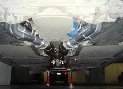

Now it was time to get the new headers in. I installed them from below, but could not have done it without help. I held them up while my neighbor (thanks Les!) put the bolts on. Don’t forget the gaskets; I re-used the stock ones as they are 3 layer steel and better than the ones that come with Kooks. Just make sure to clean them up nicely beforehand. I kept all bolts lose for now:
C6header6
I then installed the catted X pipe, one section at a time; I was able to push the axleback exhaust out of the way to get the rear section of the X pipe in; wasn’t easy, but just be patient…
C6header7
C6header8
