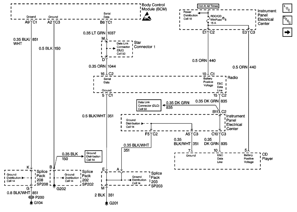

All of the C5 schematics are HERE.
The green wire is supplied 12v from the radio, look at schem 2 to see everything it feeds. Not having a load shouldn't matter, the radio would still be putting out 12v.
If I was there, I'm sure I would either have you working properly or be able to pinpoint the exact problem in under 10 minutes. You need to figure out what voltage your radio is putting out on the rap wire. If it were me, I'd cut the white? wire in the pac harness and see what the voltage is. If you have 12v, that would point to a short somewhere on your green wire, in which case I'd just connect the amp trigger wire to the white? wire (coming directly out of the radio on the pac harness) and call it done.

Hooked the PAC back up and used the purple wire I mentioned earlier. I checked the brown and purple with a volt meter and saw that the purple lost voltage a few seconds after the car was shut off. (Brown stayed hot). Amp turns on, all controls work, and I have RAP!!
Now, can someone please explain to me WTF happened? I've looked through the schematics that Mark sent yesterday and I can't even FIND a purple wire! (Maybe I'm missing something)...

I'm glad you finally got it working, but after looking through ALL of the available C5 schematics, there isn't even supposed to be anything purple, not on C1, not anywhere I did find a few 'base' prints to go with the 'Bose' prints I posted in the FAQ, I'll get them added, but they don't show a purple wire either.

Glad you got it straightened out. I looked up RAP and it is generated in the components thru the BCM serial data buss. The BCM tells each RAP controlled component to stay on for the RAP time period.
