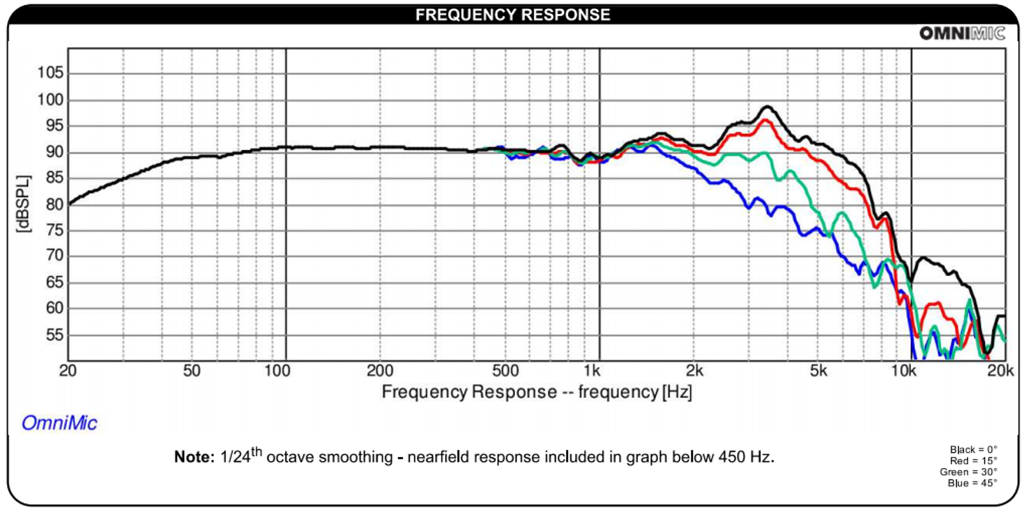

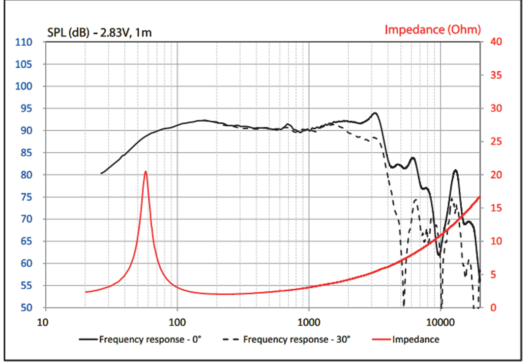

SPOILER! Because I can't wait to share! In my constant quest of searching for the perfect audio solutions for the C6, I've made a decision to change up my combo (yet again). This is not a HUGE change per se...but it hopefully will pay dividends in the never ending journey that is finding grin-inducing mid-bass. If you look below, I've attached the frequency response graphs for my current drivers, as well as the ones I'm switching to. Now I will say, this is not a PERMANENT switch unless I achieve the sound I'm after. The theory behind the graphs goes like this. Ideal driver conditions (IE where the driver is happiest) is represented by flatness on the frequency chart. Once the line starts climbing, fluctuating, waving, or dropping rapidly, you are reaching the unhappy zone for the driver. Typically, they display beaming as well which is often portrayed by a different color line, or dotted, or some other way that is easily discernable. Now, beaming isn’t typically a problem with bigger drivers at lower frequencies (IE sub’s and larger drivers), but it becomes a much larger problem with smaller drivers. This is why you always attempt to point a tweeter directly at your nugget (head) to reduce beaming as much as possible. Notice that the black lines in these pictures (represent 0 degrees of axis, or driver pointed right at the microphone) gives the best performance. Also notice the lines don’t separate until the higher frequencies. This is where beaming comes into play. However, I don’t have to worry about beaming as I choose to operate these drivers in the frequencies NOT AFFECTED by beaming. My current tune has my woofers driving from 75 Hz to 716 Hz. Worth noting, my driver doesn’t begin roll off at 75 Hz, it has already began the roll off well above that, closer to 150-250 Hz. Typically, it’s 1 octave higher than the target cut-off depending on slope used. In my case I’m running a 24 db LR slope on the high pass. So, with all that said, when comparing these two drivers, you can see how flat the 8” driver reproduces the frequencies I’m asking them to play. Put simply, the 8” driver is PERFECT in the range I need it to be. It plays nice and flat all the way down to ~60 Hz (the Fs of the driver is 37.7 Hz). The Fs of the Focal is 55 Hz. That doesn’t sound like a lot, but it really is. This means that the 8” driver is MORE EFFICIENT in the lower frequencies than the 6.5” driver is. I can really make them dig without worrying about hurting the driver. I can say I’m likely to adjust my curves to ~65 Hz – 5-600 Hz. I’m going to ask my mid-range (4” drivers) to play lower, which is no problem for them. This all should make the front stage have much more of a “warm feeling” without the sub having to inject mid-bass frequencies.
A few of the other T/S parameters favor the 8" driver. First is Xmax. 5.3 mm with the Focal versus 6 mm for the Dayton. That doesn't sound like a lot until you factor in cone area. An inch and a half larger driver with .7 mm more excursion is huge. Also, power handling. The 8" driver operates in ideal conditions at 80W RMS. My amp only puts out 75W RMS (@ 4 ohms). So the Dayton is getting fed the perfect amount of power. The Focal operates best at 120W RMS. Obviously, I'm not driving them hard enough which is likely why the output feels like it's not there. Now this is NOT that fault of the Focals. Sure, I could bridge my amp (delete my rear channel all together, which I've done before) channels and feed them 150W RMS. But I still don't have the confidence that they would give me that solid mid-bass in the Corvette. They do in my truck...but that's a different conversation. So when comparing components (amp output, RMS power per channel, driver size options, etc.) the 8" Dayton is clearly the better choice of driver to run in my system. And I've already purchased them!
A quick word about sub tuning with the soon to arrive new drivers. I’m currently running a single 13TW5V2 from 20 Hz – 160 Hz. Personally, I don’t like driving them that high because it doesn’t ALWAYS sound good that way. Some tracks sound great while others are…meh. I’m hoping the move to the 8’s will allow me to drop the sub low pass to around 90 Hz because the new cone size and Xmax of the 8’s will provide the mid-bass output that is MUCH needed in this platform. In an earlier post, I mentioned that running the sub that high was a way of “cheating” to get more mid-bass support from the system as a whole. It’s not ideal, but it does work as kind of a band-aid for lacking mid-bass.
So that’s all for now. Stay tuned for the install and tuning.

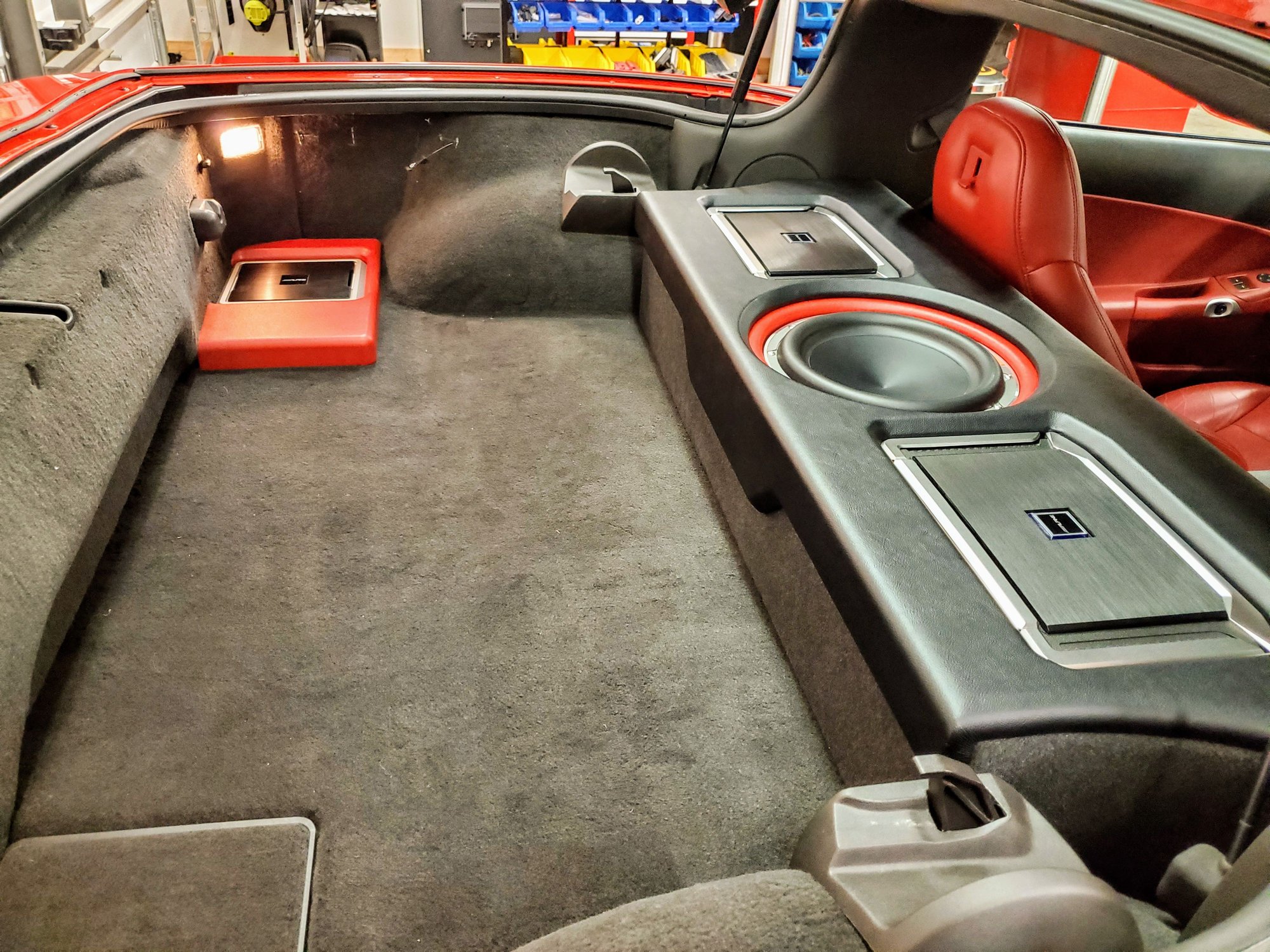

Speak to me about this theory of up firing a sub in a C6. I currently have a single 10 inch Hertz Mille Pro that I currently find lacking in output. Enclosure is built to manufacturers spec; .6 cu ft internal volume.
Are you suggesting that my output woes are due to the direction the sub is facing?
Current setup in photo.

Yes, as a matter of fact I am. I have noticed through extensive testing that when firing a sub upwards into the peculiar glass shape on the C6, that I experienced what I've come to call wave cancellation. Now it wasn't absolute cancellation...but it was a noticeable 3-6 db reduction (as high as 10 db in one test) in output from the sub. Try a little experiment. Go into your car and find a nice bass heavy song. Listen to it for about 10-15 seconds. Without turning it off, roll your windows down and listen for another 10-15 seconds, and then repeat. If the bass frequencies all of a sudden "sound louder" when the windows are down, you are suffering from the same problem I was. If you have measuring equipment, you should see a noticeable gain in db when the windows are down. Give it a try, and let me know.
