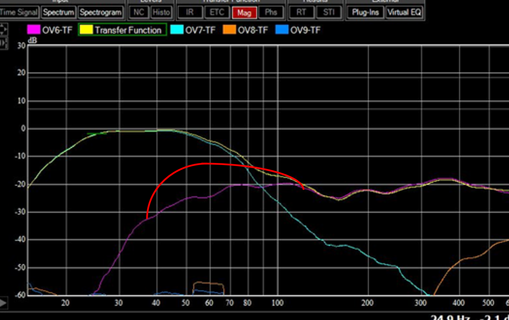

8" drivers were broken in finally and it sounded like my time alignment was affected from it. I thought no way a speaker breaking in would affect TA. But, sure enough. Threw the mic array back in the for another session, and my time alignment was off by about ~6 ms. (Some drivers had more, some less, sub was fine). But how is this possible? Simple. The speaker you use to time align your system is the furthest one from your ears. In the C6, its the passenger woofer. Since the woofers recently installed were the new guys, and they were the base point of the TA measurements, after they broke in, the TA was affected on all the other drivers. So after the TA, we did a full re-tune. I did make one mistake. I adjusted the woofers to line up with the curve even down at like 60-80 Hz (like the red line in the picture) which had some pretty big bumps to gain down low. I tried to raise the bass to have a more full sound even when the sub isn't playing. This resulted in a woofer "popping" sound that you get when the driver is at or near xmax. So I had to make some gain cuts in that area to flatten the curves out to back to the purple line. All good now.
