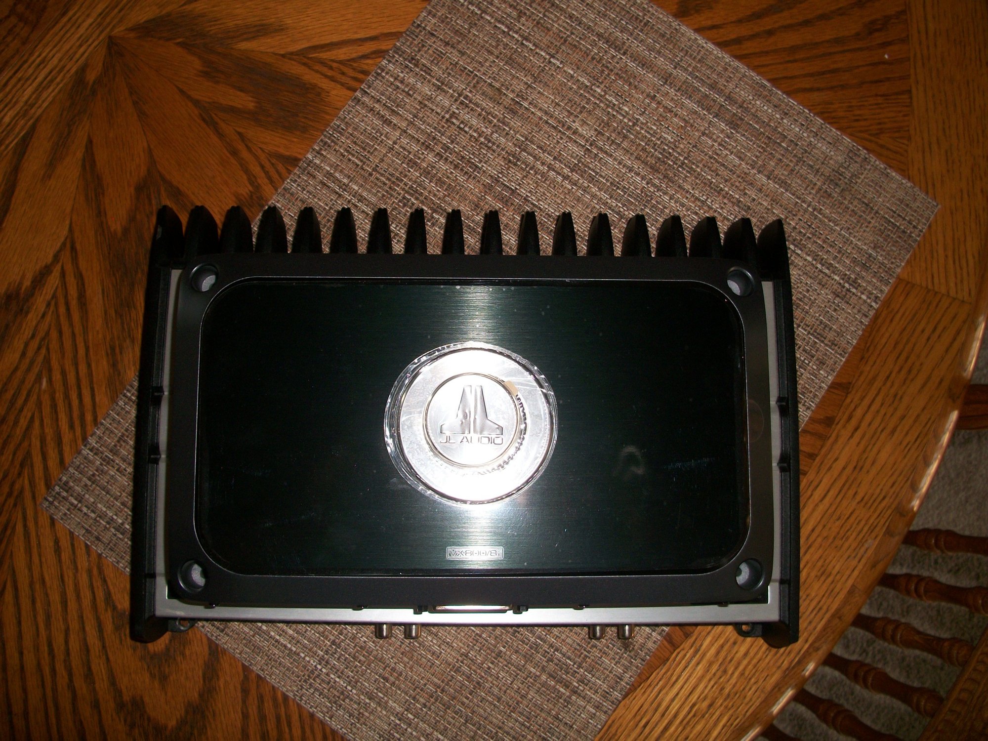

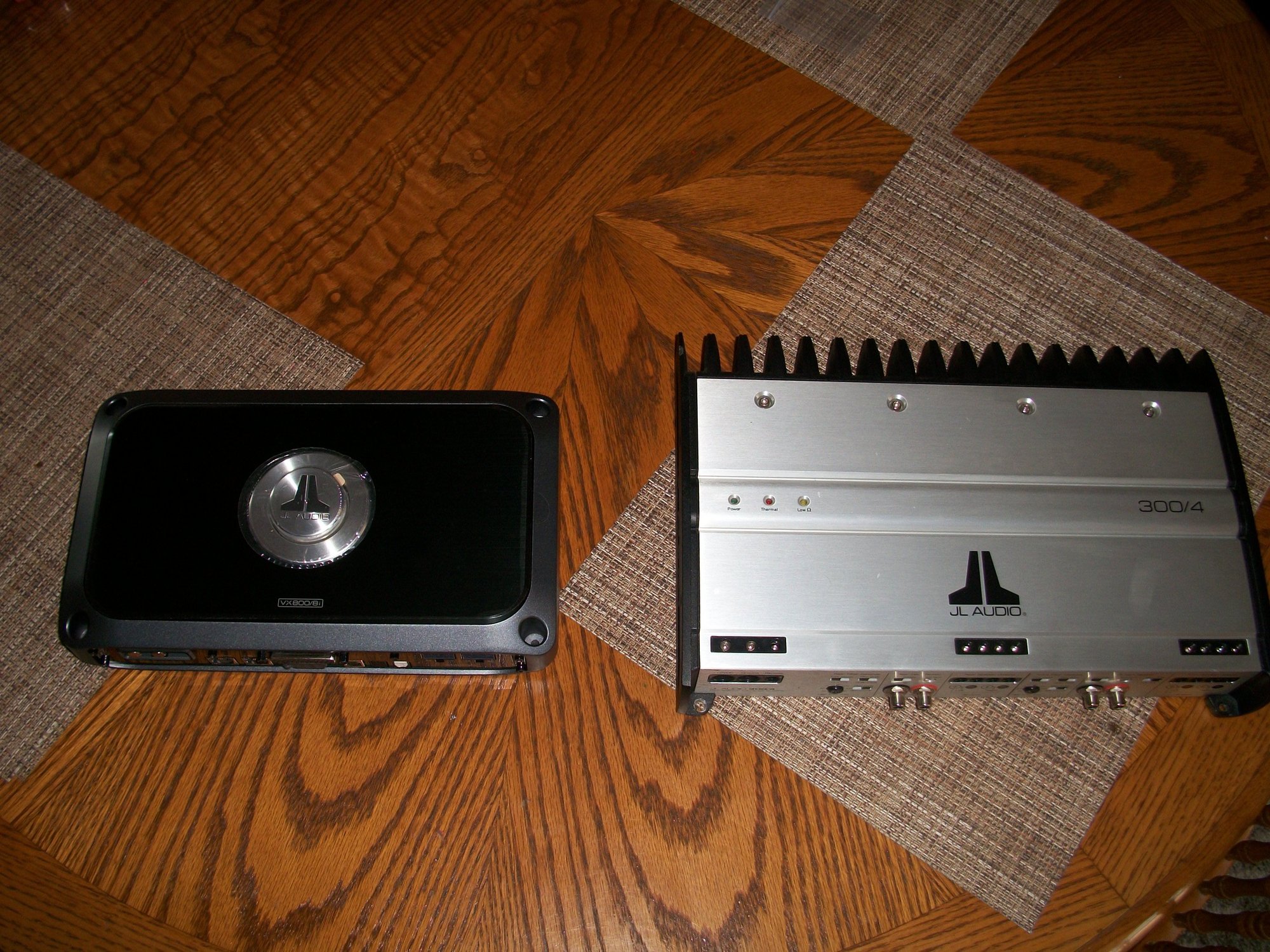

And here it is in all it's tiny glory...look how itty bitty this thing is. 8 channels! BTW, the picture feature SUCKS!I have about 6 other pics and I just got frustrated trying to upload them.
Look how small!
Replacing the 4 channel on the right...look how tiny it is! Hard to believe it's an 8 channel WITH a DSP considering how big the 4 channel without a DSP is next to it.

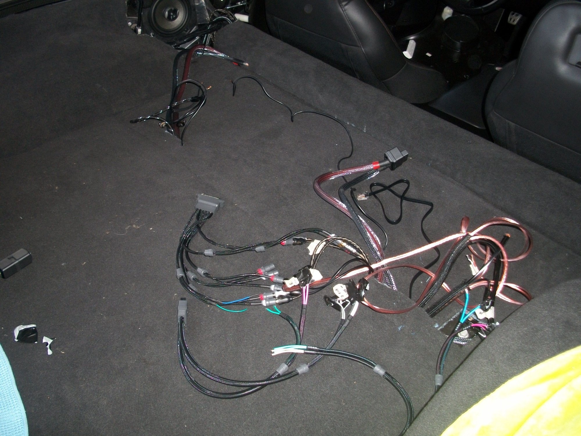

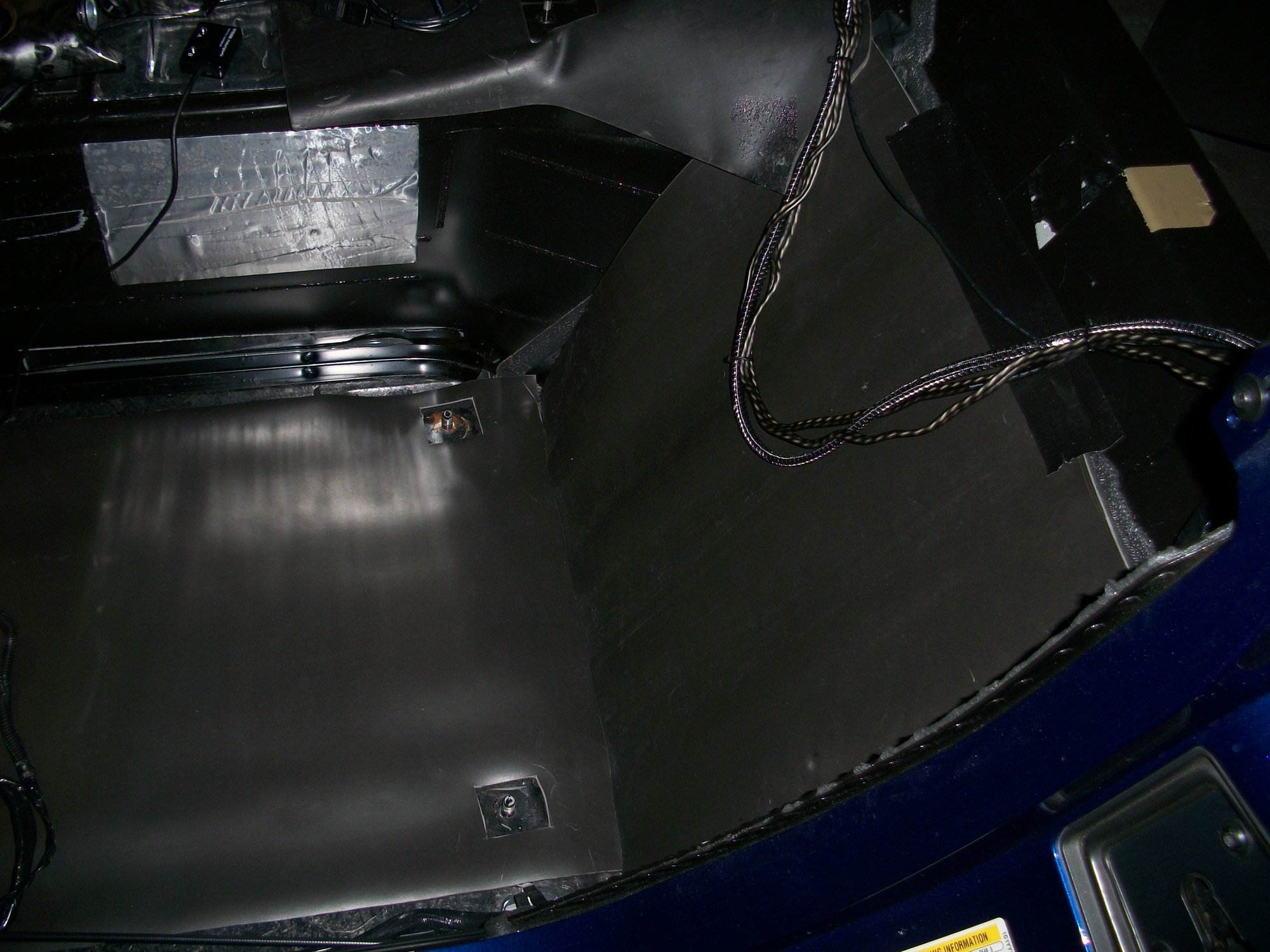

Default Major update

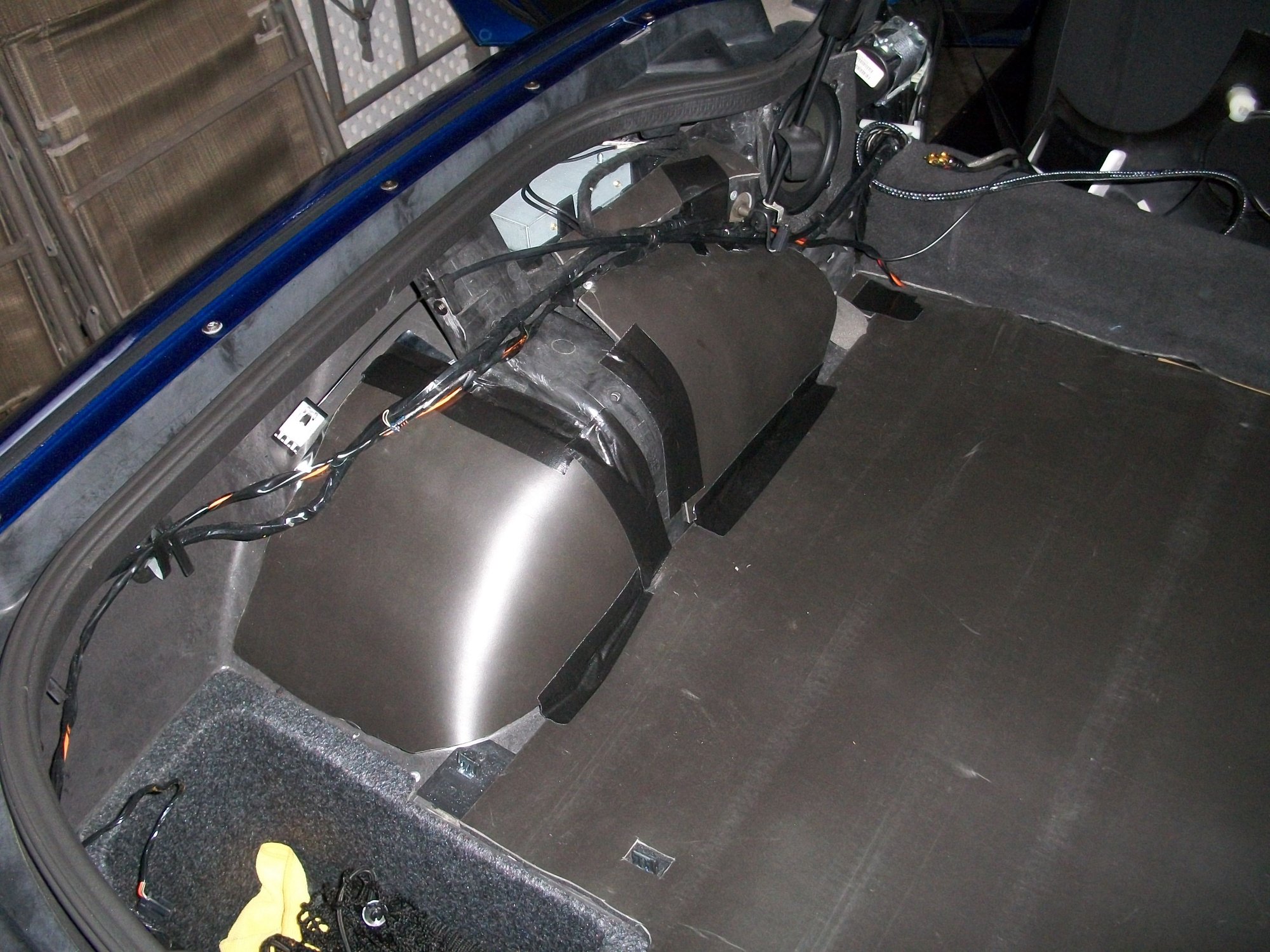

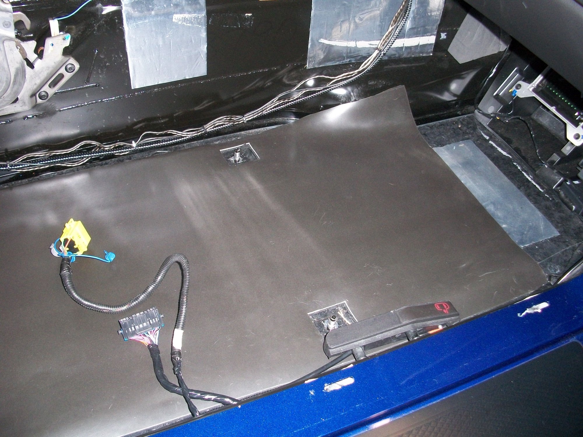

Well, I'm happy to say, I'm FINALLY done with the install. I have removed the 3 way passive crossovers and went full 8 way active. Installed the tweets. Swapped amps. Removed interior AGAIN and swapped the ineffective HMF sound deadening material for MLV. Removed the rear speakers. Soldered all connections and installed capacitors on the tweets to prevent the dreaded tweeter "pop." Wired the amp so I have tweets and mid ranges are on their own channels and then bridged channels 5/6, 7/8 for the door woofers. Here's some pics.
Garage in shambles
Down to the guts of the wiring and floor pan.

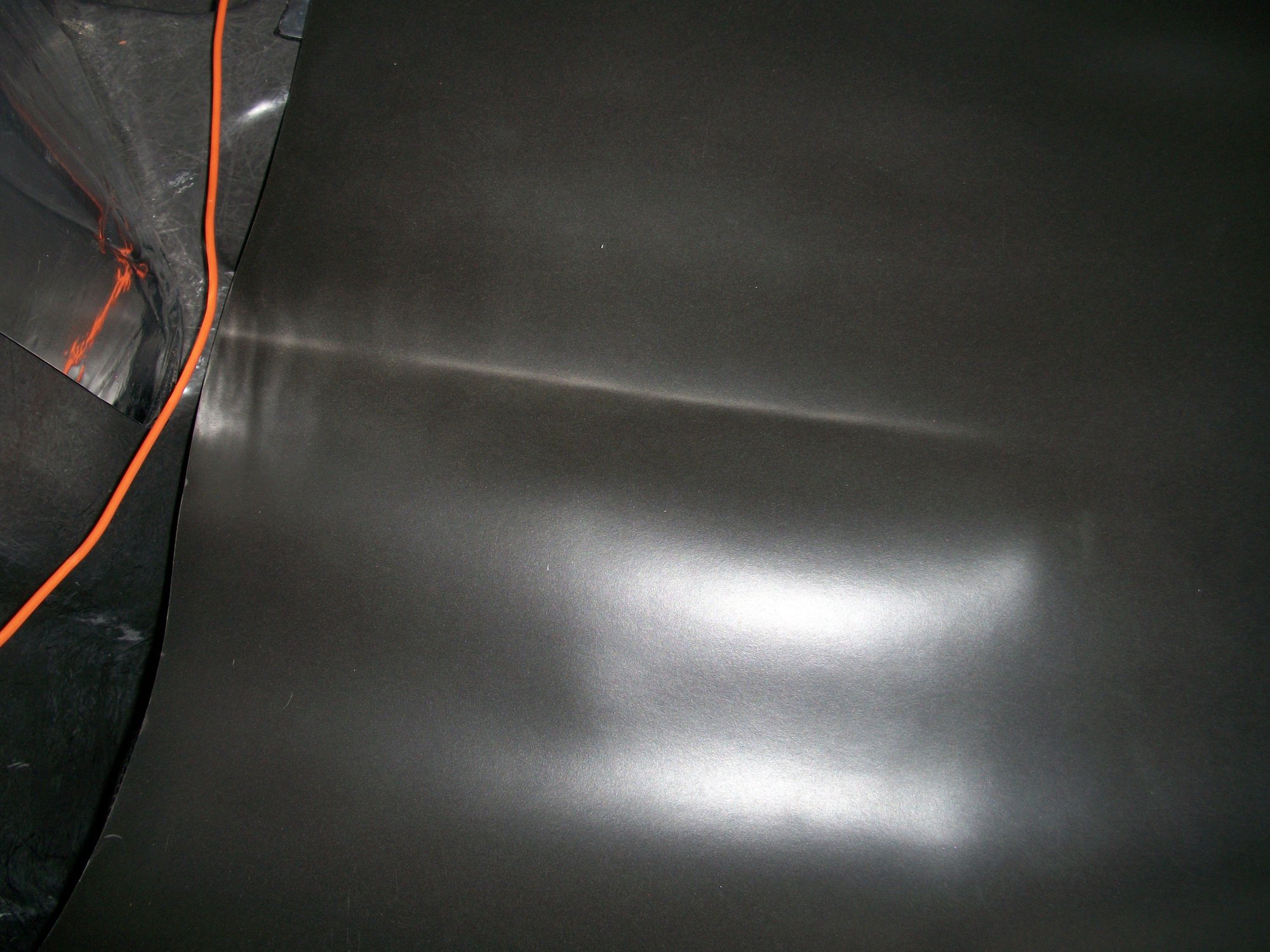

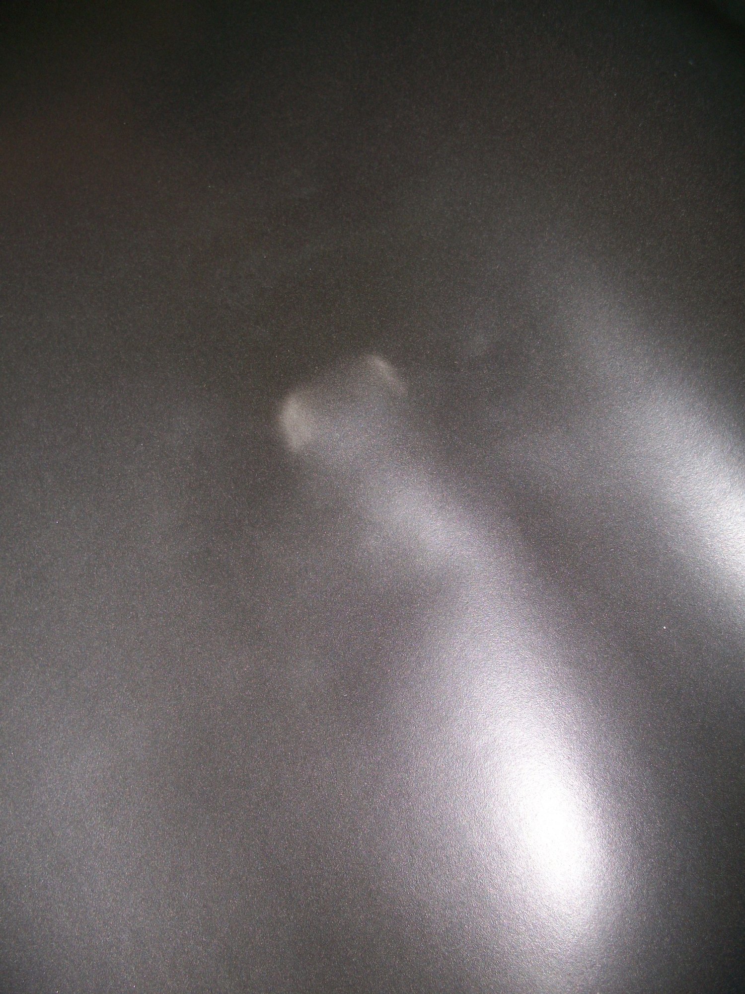

MLV trimmed to fit. Frustrating about the cubbies in the C6...no real way to "deaden" them completely effectively.
This is how I could accurately trim the MLV. Pushing down on the clips and attachment points made a nice outline to trim around.
Like so...
Same deal when trimming straight lines...
Just fold it over on itself and apply pressure.

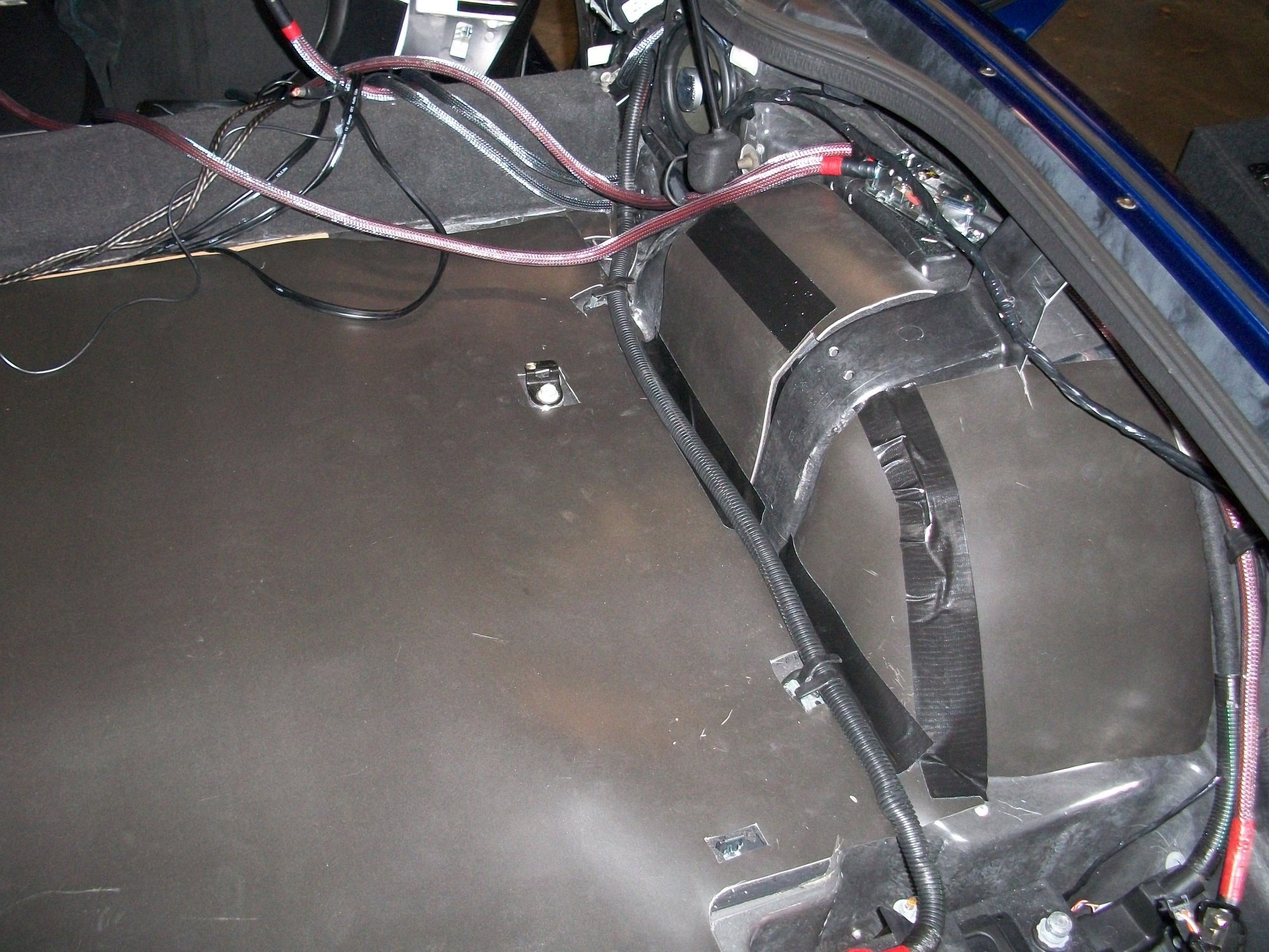

Finished the MLV in the trunk
Needed to get more up in the fender area, but I was running low on MLV and that sh*t is expensive!

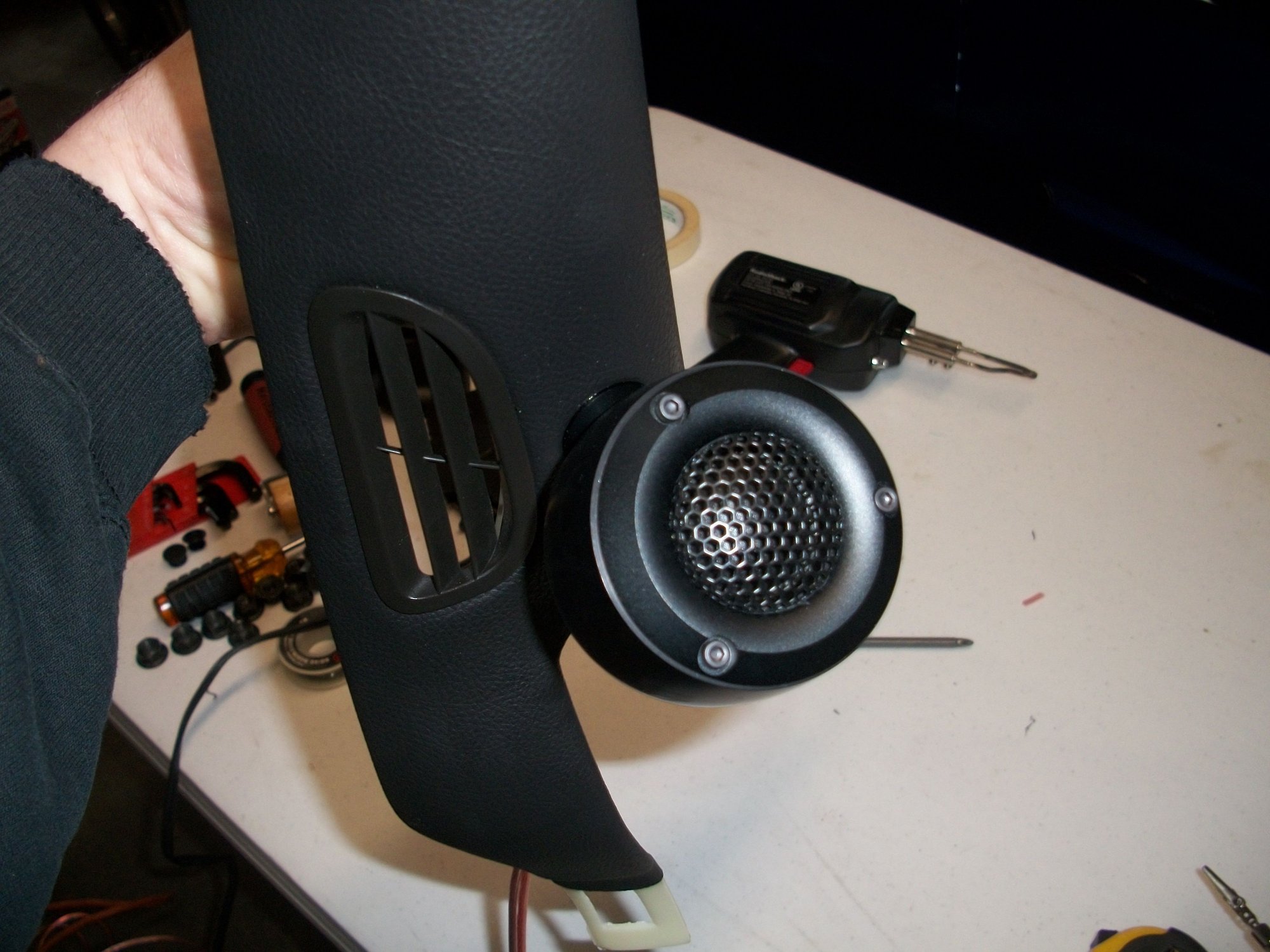

Got to work on the front half and tweeter install
You guys have seen the floor pan before, so I'll fast forward to where the MLV is in. Not changes in application method in front either.
Drivers side as complete as I have materials for...
Passenger side
waterfall area

Finished pic of the capacitor install
some soldering
I solder all connections
Finished tweeter install
All installed and ready for the box and final install. I lost motivation to keep taking pics, but I will snap a few of the completed system soon.

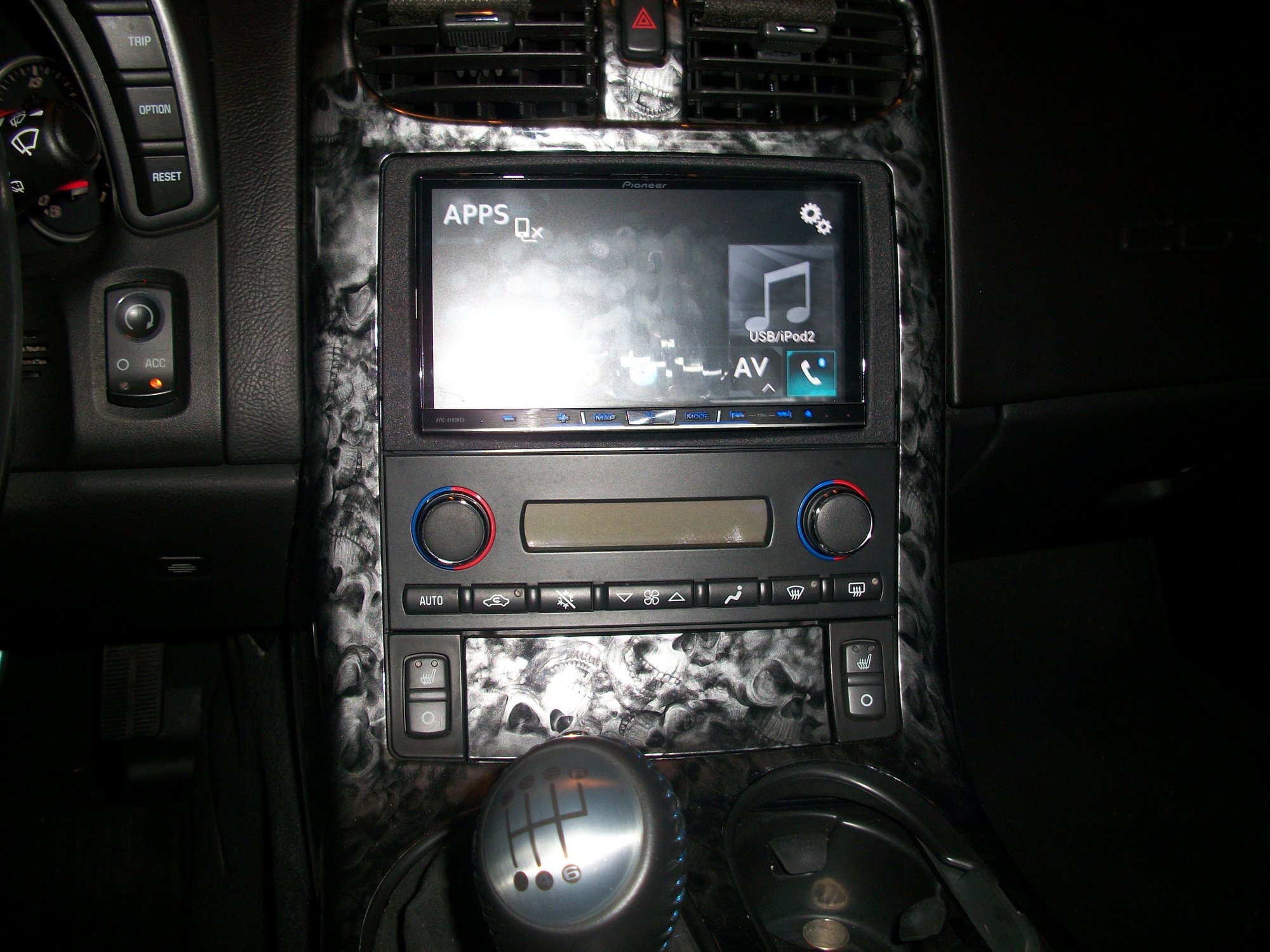

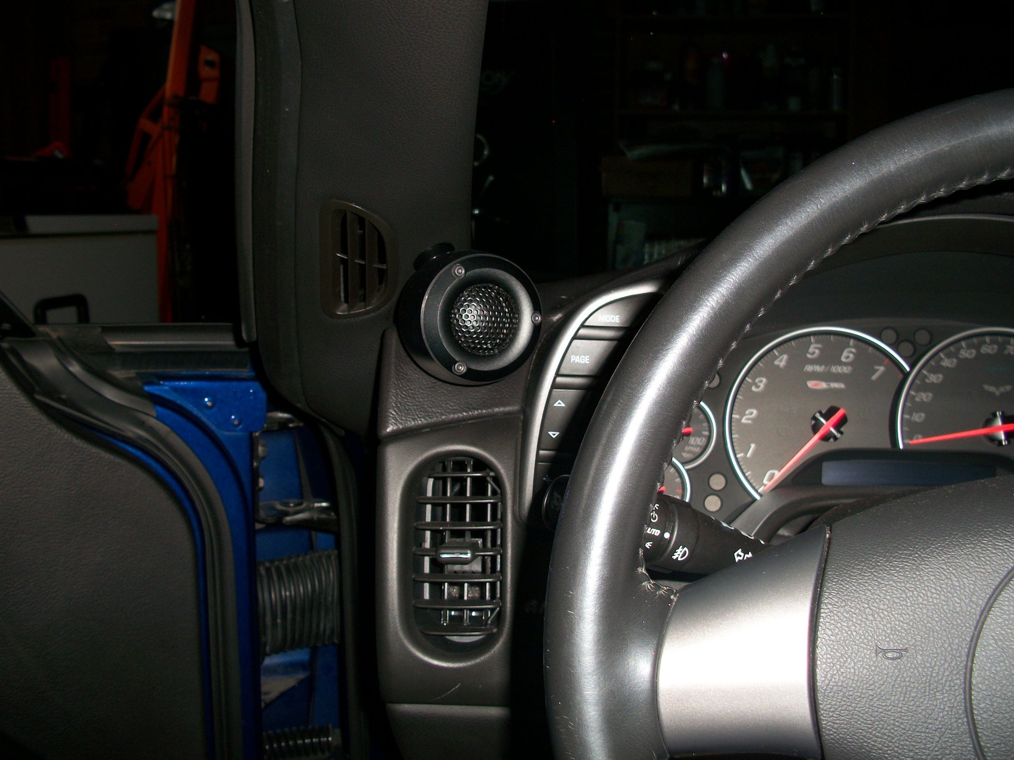

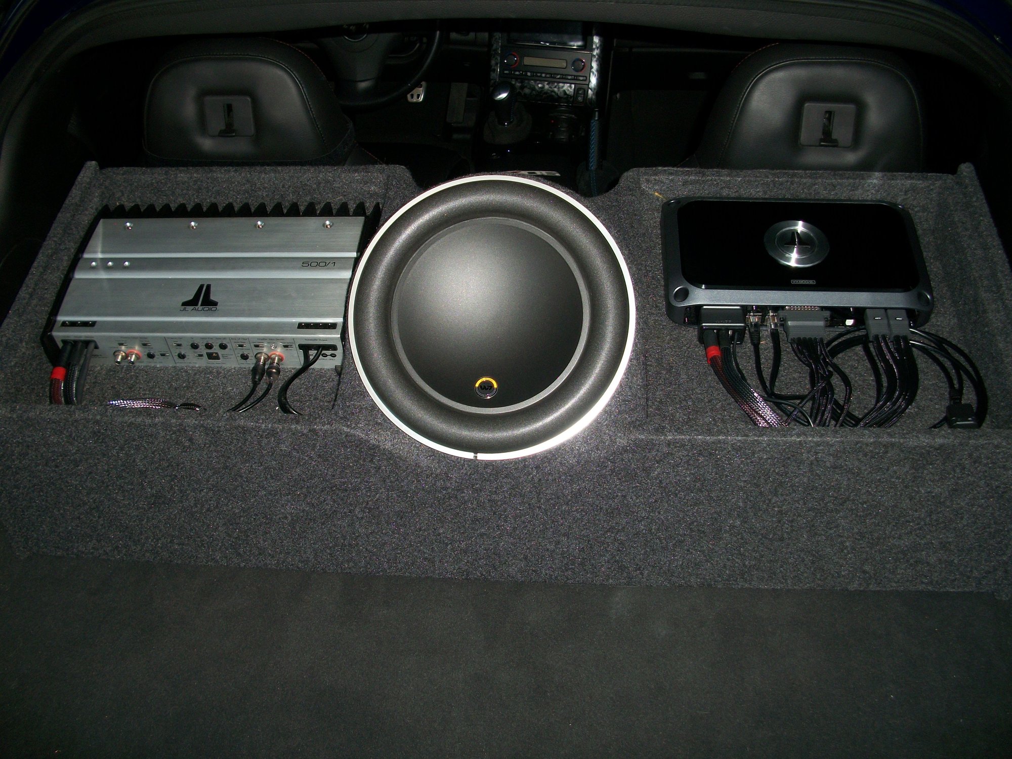

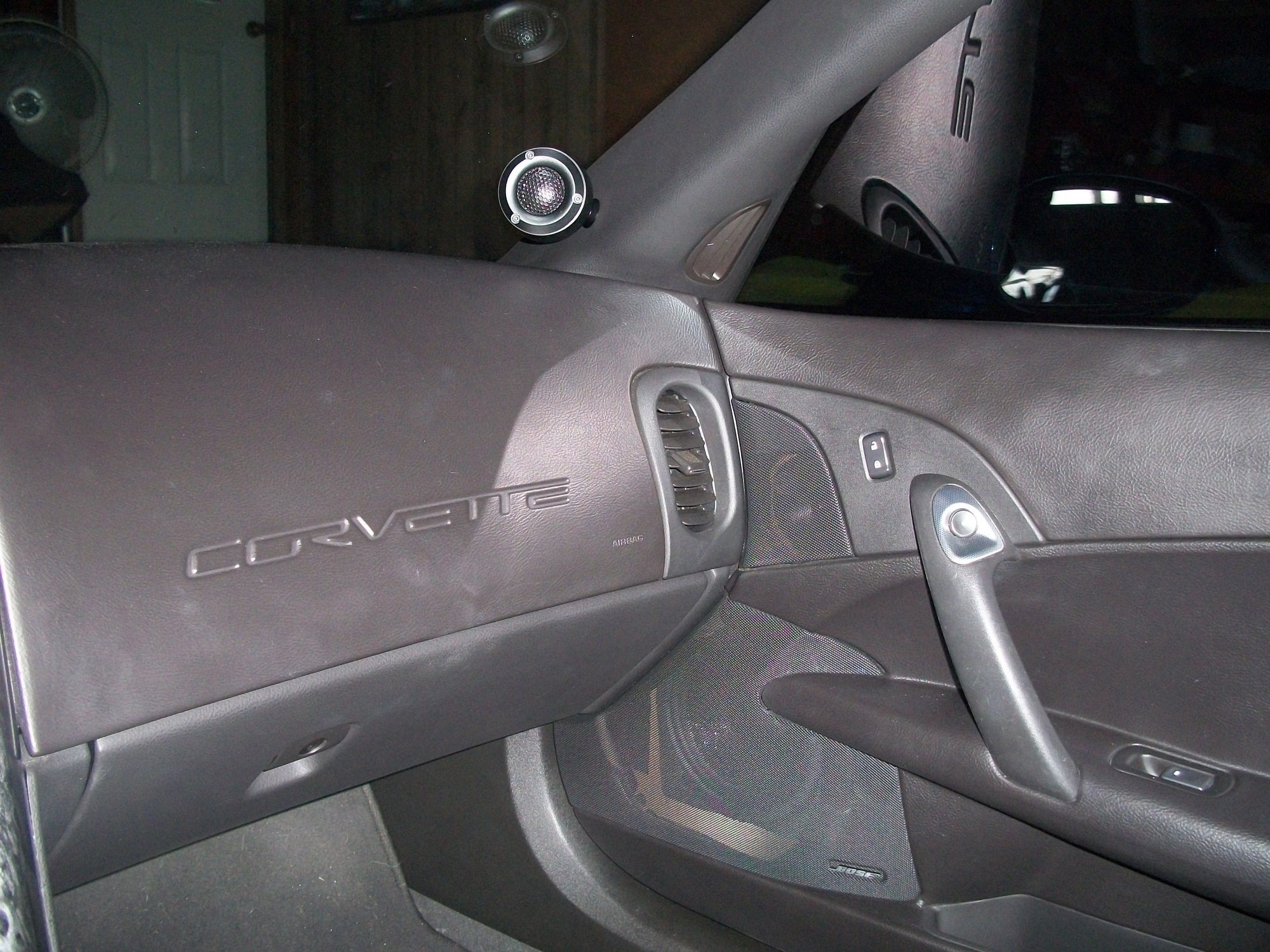

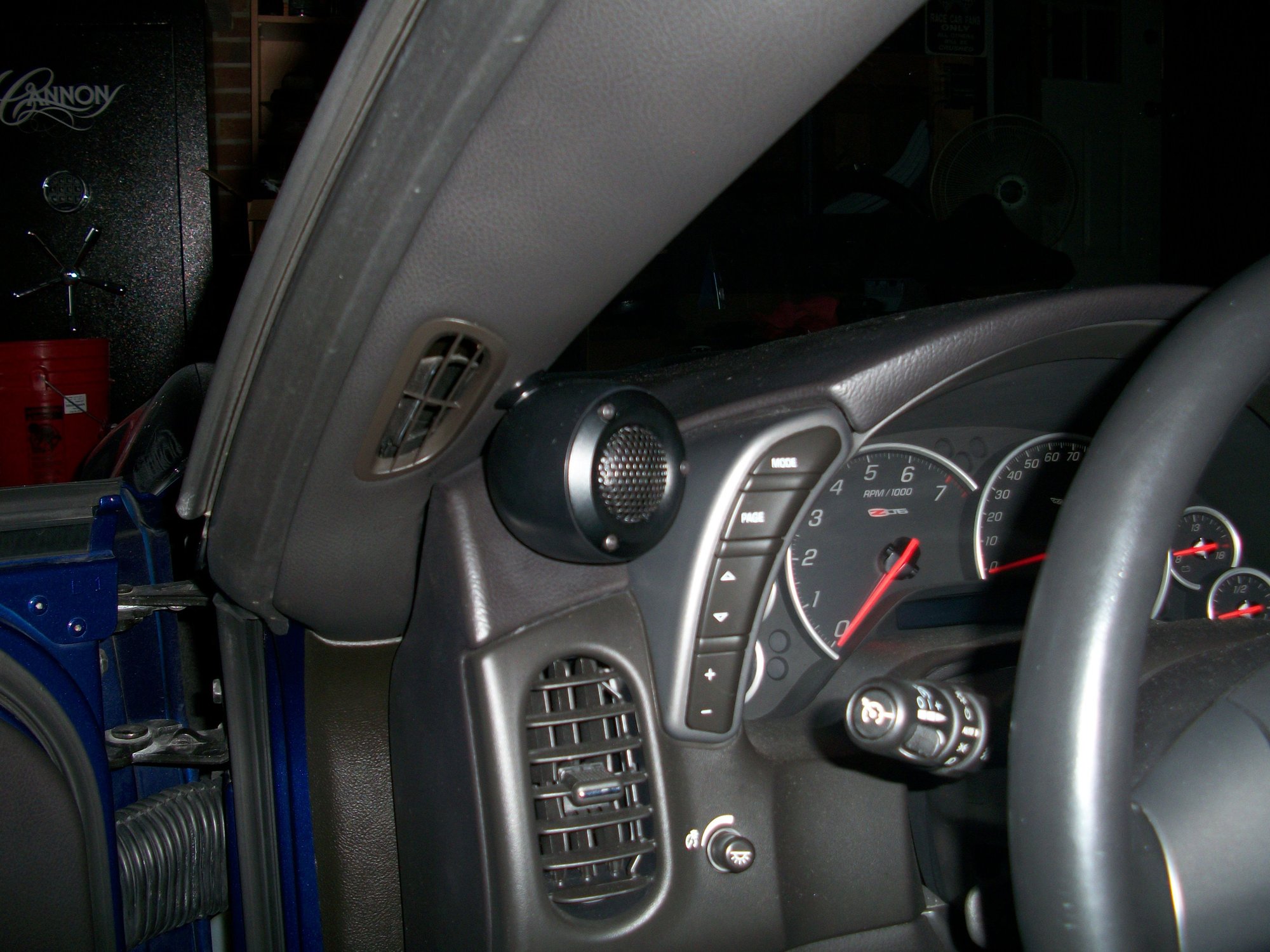

Some final pics...I'm going to have to figure out a beauty panel to cover the amps.
Head Unit
Console
driver tweet
pass tweet
Just need some ideas for amp covers or a beauty panel
I just need to clean my interior. LOL! It's pretty filthy. I also am going to remove the door deadening and install the VB-2 and then reinstall the deadening on the inside of the door (as much as possible anyway). The MLV flat out works. You can't even hear the exhaust through the floor. It's great. BUT! It showed me that the doors are now the weakest spot for noise...so the VB-2 gets the nod. More work, but nowhere near as involved as pulling the whole car apart again.

Nice, clean install! That W7 looks mean.
