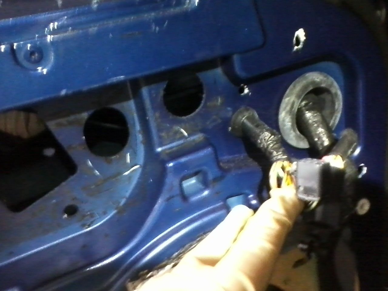

Finally got around to installing the Cascade audio VB2. It's a thin adhesive Mass Loaded vinyl that sticks better than Dynamat, and actually blocks sound instead of reducing vibrations. Product is here: CAE VB2 Sorry for the crap pics. It was really hot so I just took cell phone pics. I have an OLD cell phone.
Before VB2
Some deep recesses
After VB2
Doors are MUCH quieter. I'm going to take her out for a spin this week some time.
