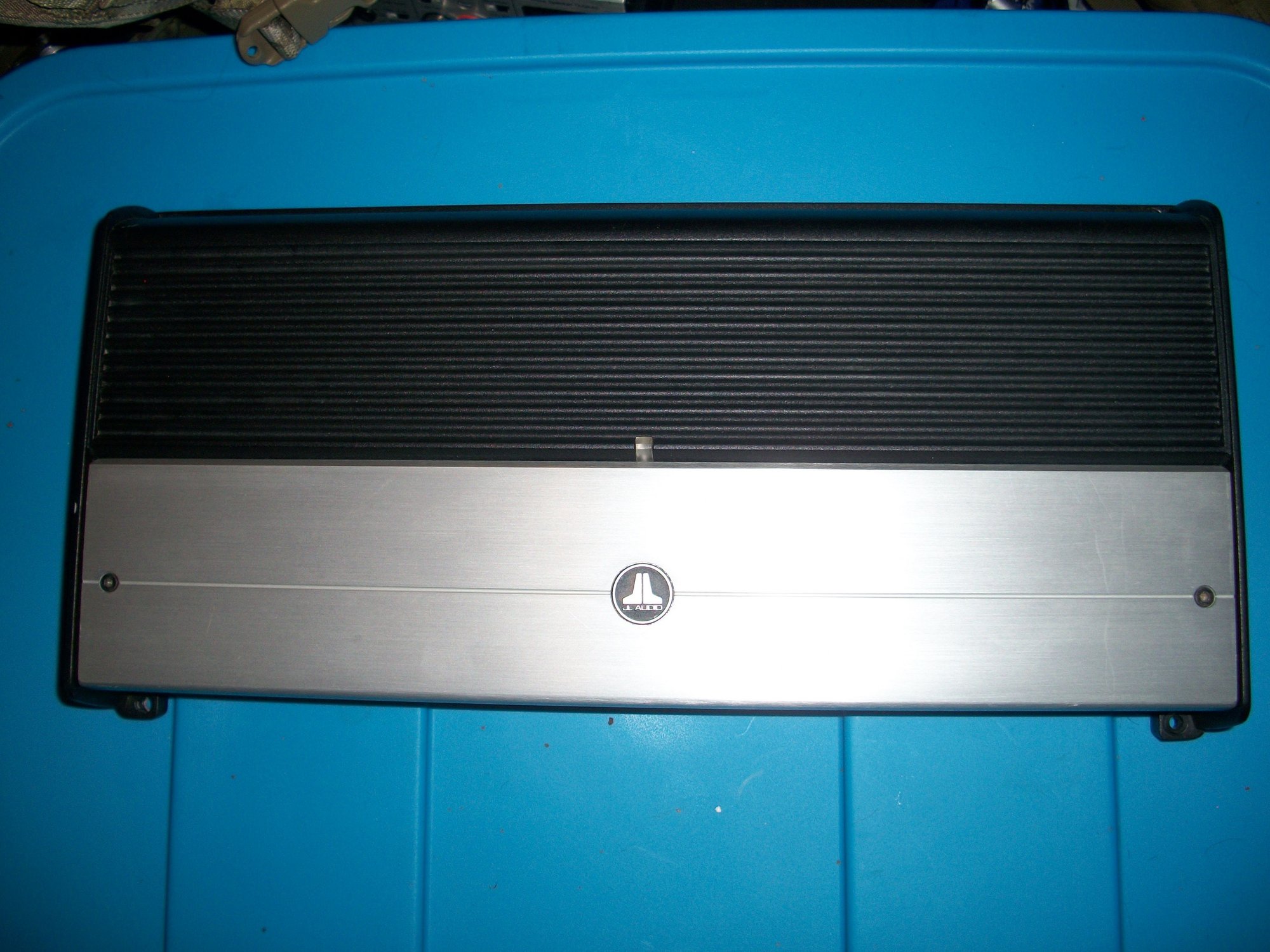

Teaser pic. New toy. JL XD 1000/1. The XD 600/1 is enough for the 10W7, but NOT enough for what I'm about to do.
Oh no, Ronin is raising the playing field...... Again!

Tested the 1000/1 on the bench on Saturday...all is working very well. Stay tuned...another Easter Egg (2 actually) is/are coming.

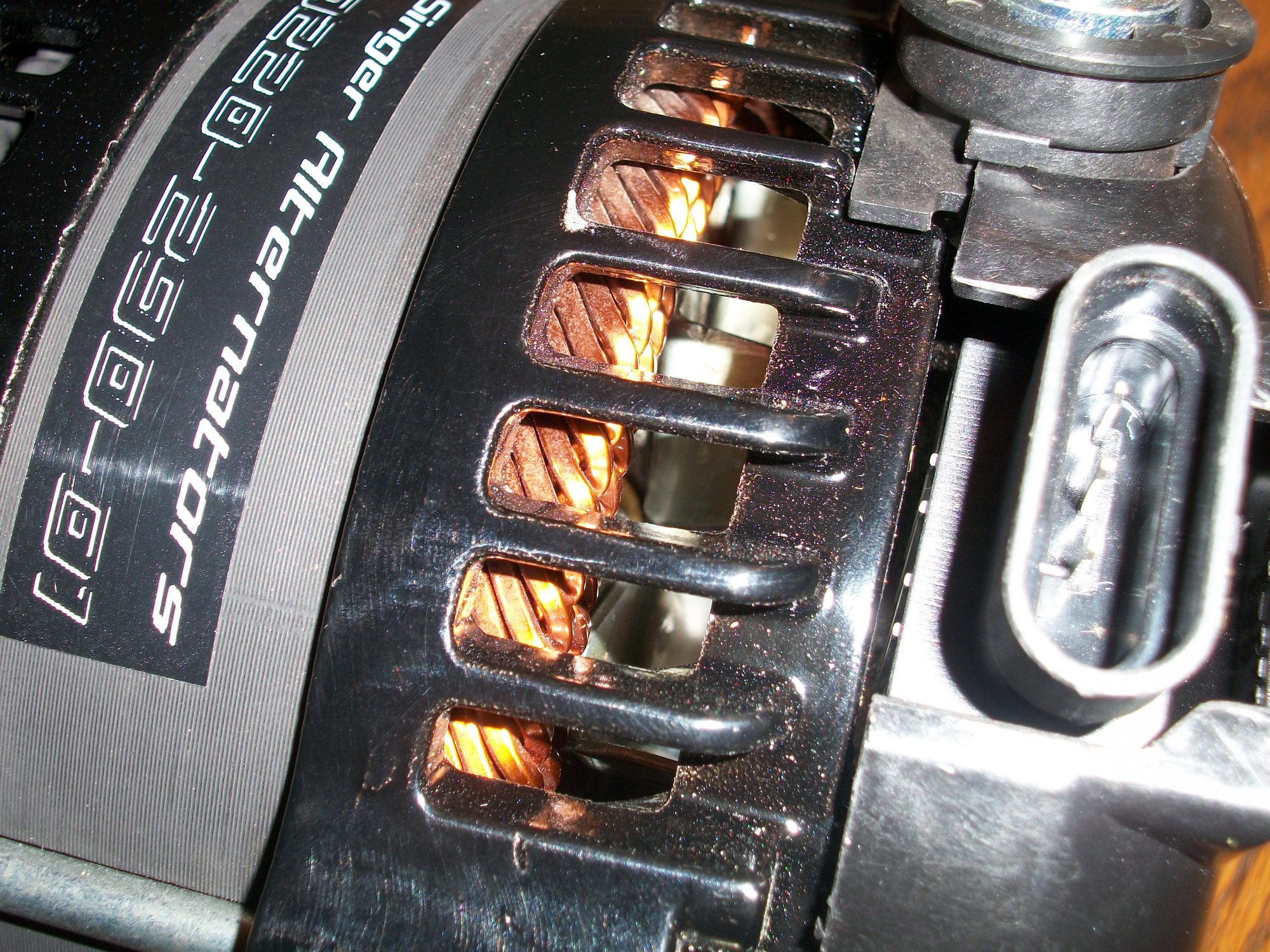

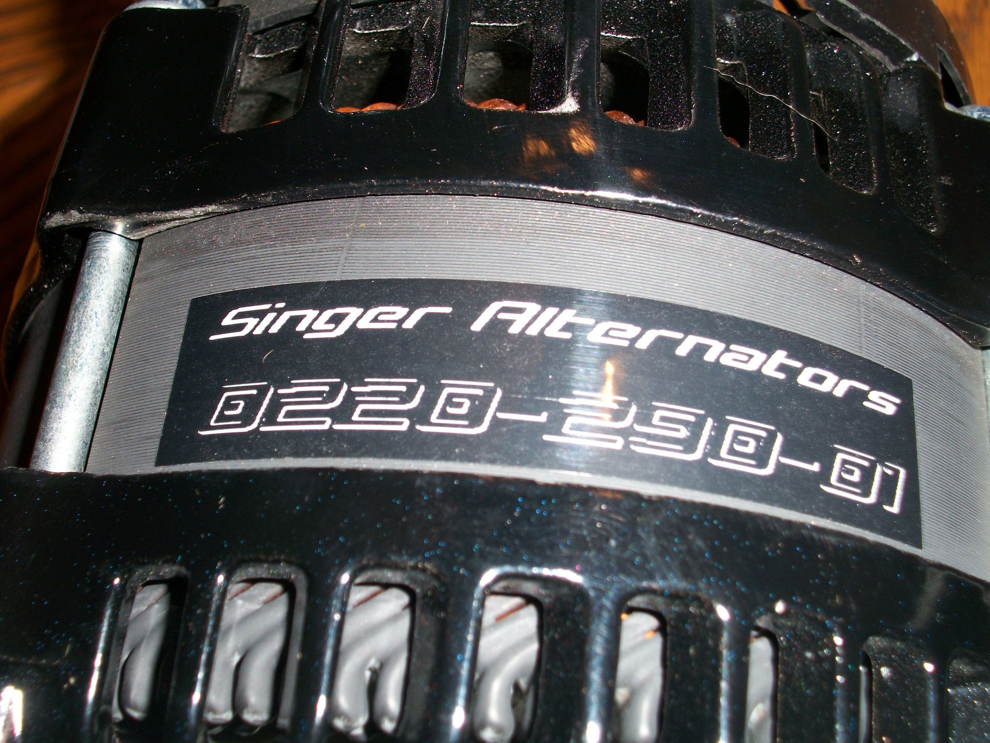

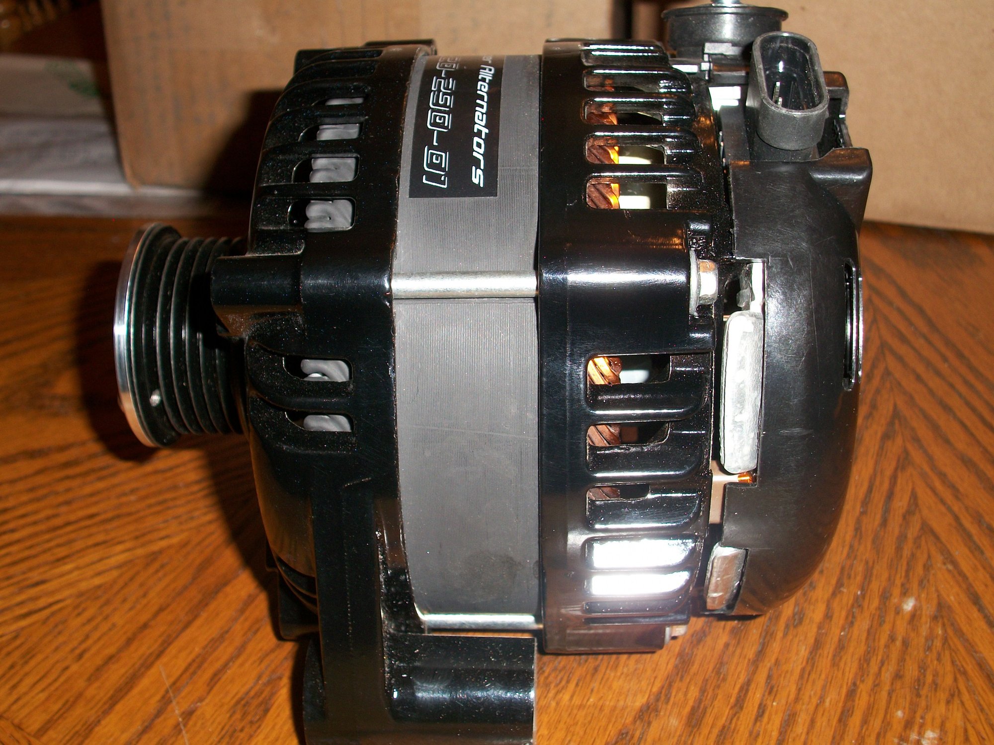

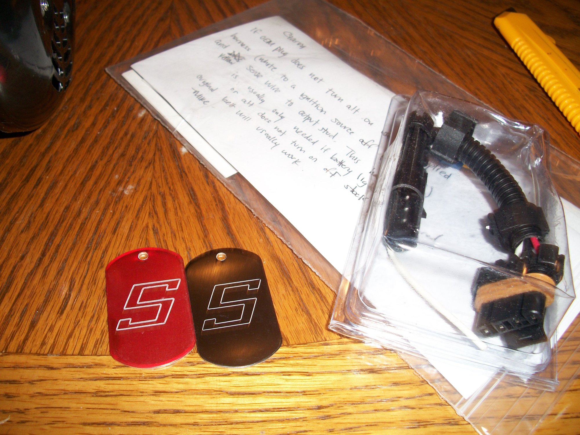

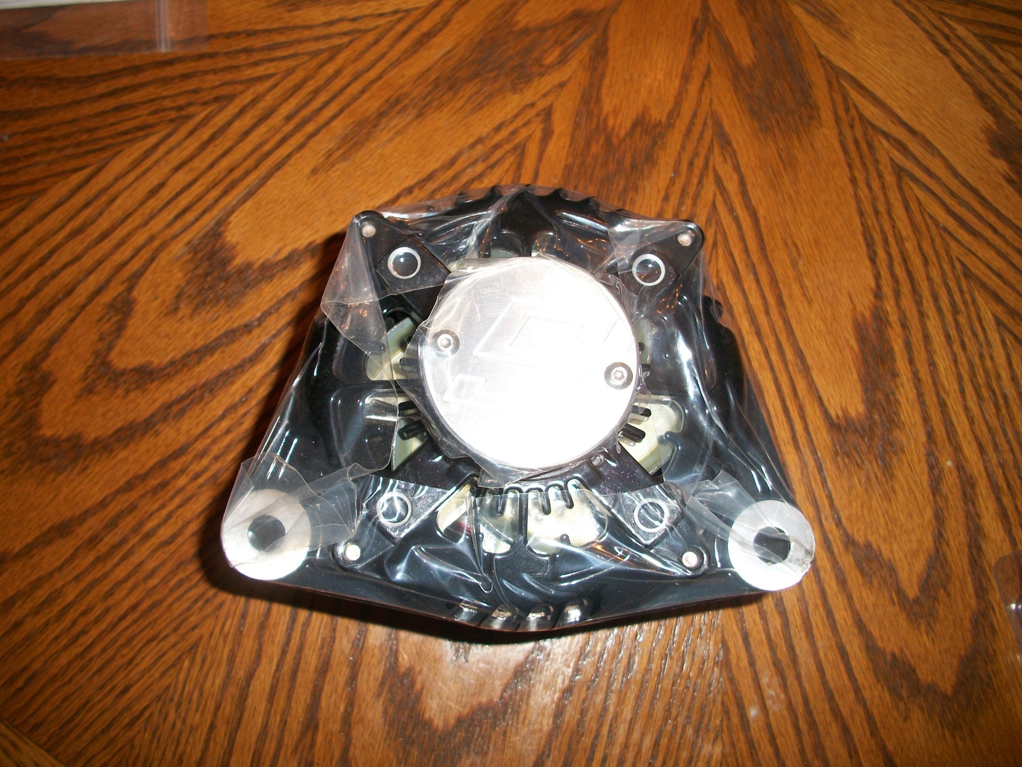

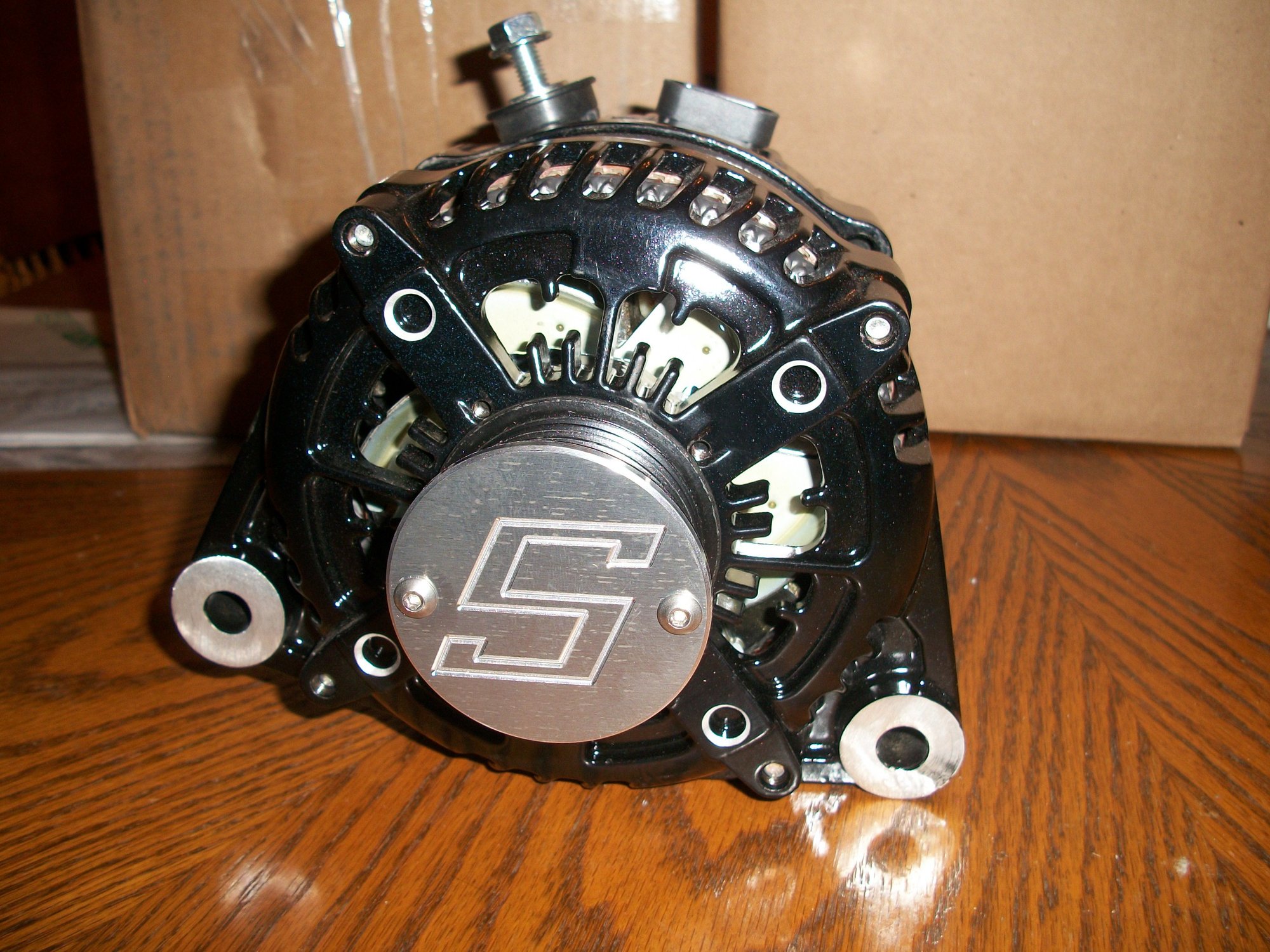

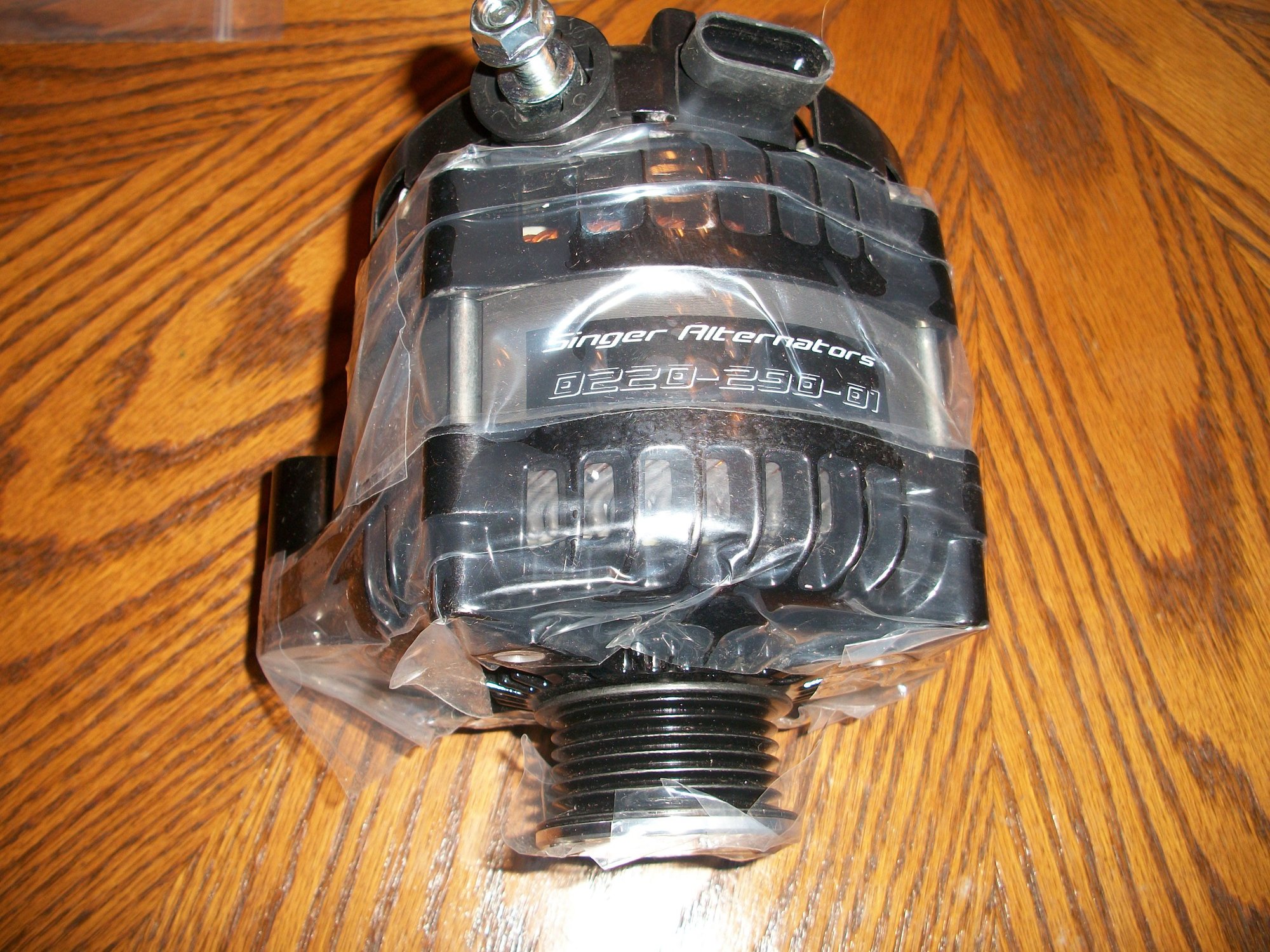

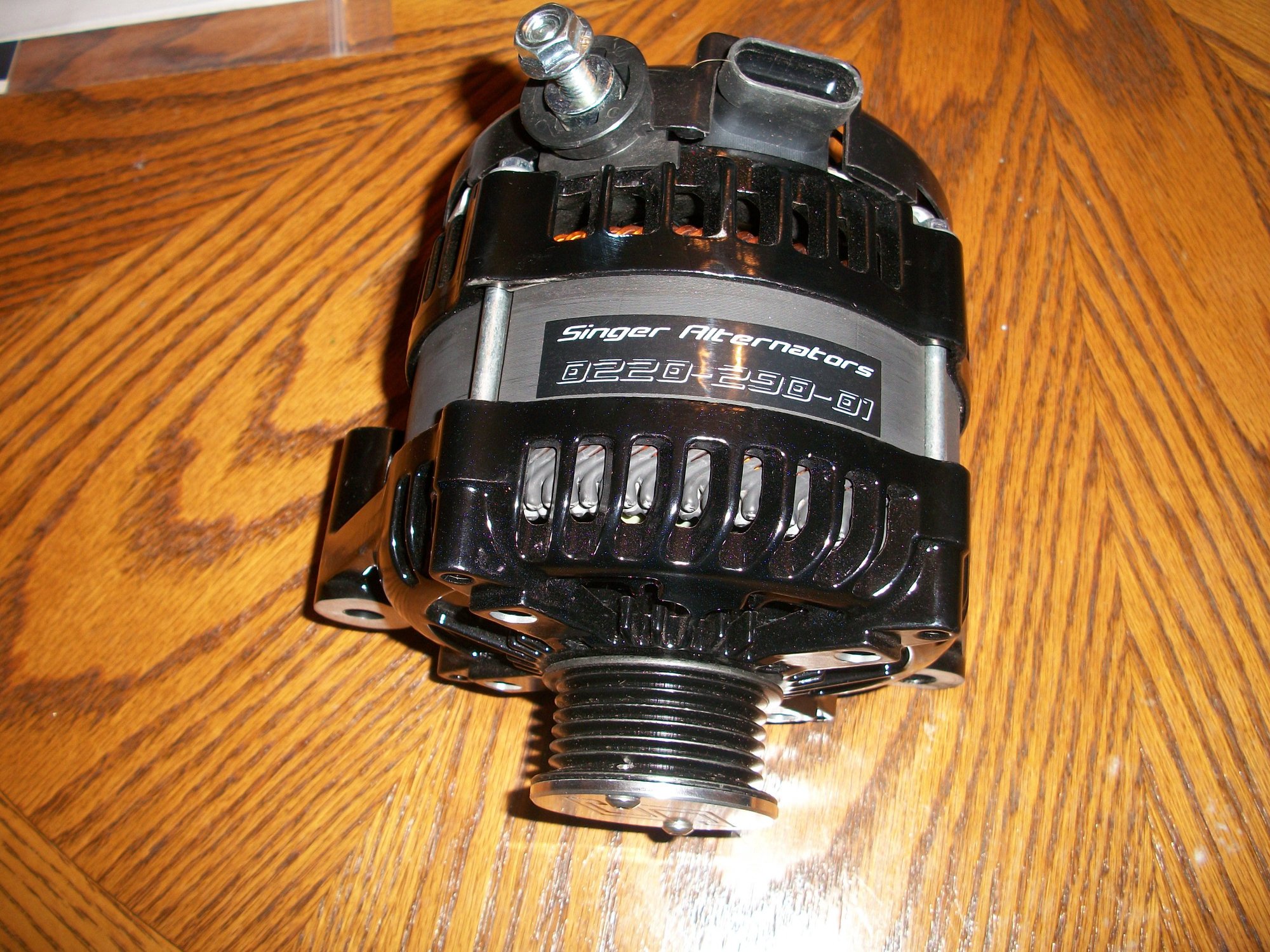

Easter egg #1...
I can't wait to get this on the car. 220 amps at 600 rpm, and 290 amps at 1800+ rpm. Should be more than enough to power everything in the car. I can't stress how gorgeous the inner windings and wiring of this thing are. They look perfect! Swapping out the OEM alternator cable for a 0 gauge OFC. Just the cable swap will be pretty involved. But hey...gotta do it right? I also like the custom personal touches, hand-written note and custom pigtail (if needed) for my specific vehicle. If you're interested in getting one, contact Singer Alternators and talk to Michael. Tell him Garry sent ya.

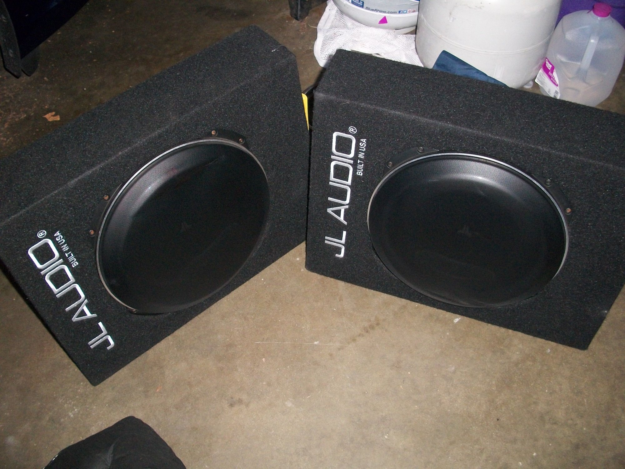

2nd Easter egg...
Yep...

Are those the tw3 or tw1? I had 500W on my tw1 and almost smoked it. Had to get a 2nd tw1.

Those are the 13TW5V2's. I also run the TW1's in my truck. I run about 150W RMS @ 1.5 ohm on them and they sound amazing. I agree that 500W is a bit much for a TW1.

Just for giggles, I ran both speakers on my 600W amp to "test" them. OMG! Just ONE of these hits jut as hard if not harder than my 10W7. Two of these are going to be absolutely ridiculous. So of course...I have to do it.

My 12tw1's in ported boxes absolutely pound. Are these sealed or ported? I assume you will use them in the box as is,?
