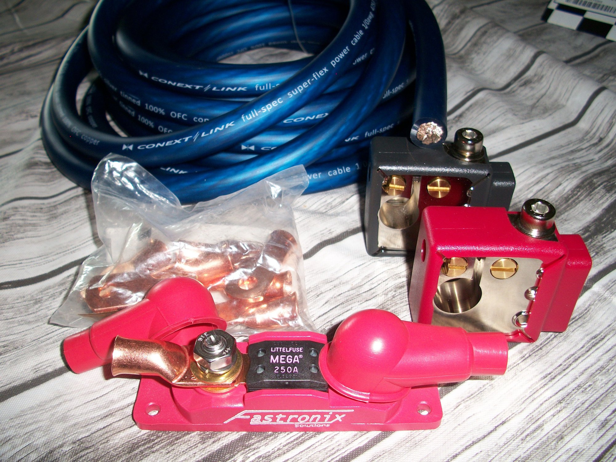

New parts rolling in...
25' 1/0 OFC cable
KnuKoncepts Ultimate battery terminals
Fastronix 250A high current master fuse
Cable lugs (just having to wait on crimpers)

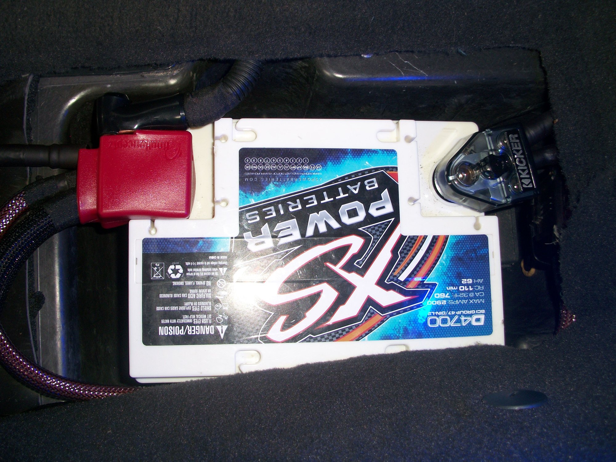

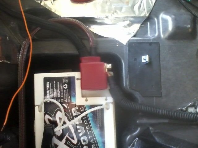

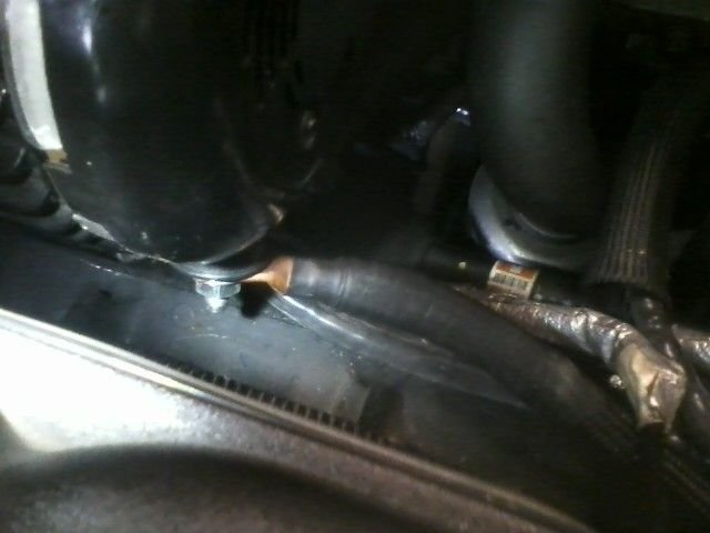

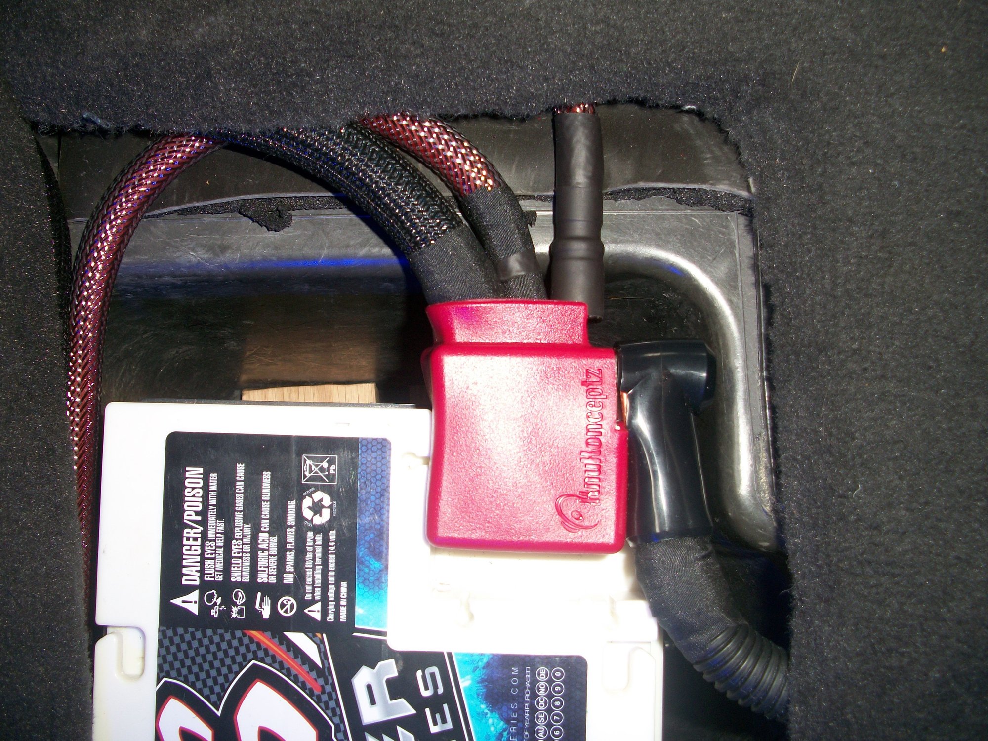

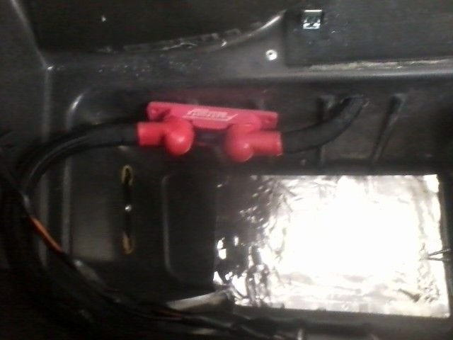

I now have a 1/0 cable directly connecting my alternator to battery. I've completely eliminated the OEM 6 gauge alternator to starter cable. After firing it up, ZERO issues or warning lights thus far. Planning on buttoning things up today, and then doing some test driving tomorrow. This will eliminate the alternator from being able to push too much spiciness through the starter and main battery circuit. I did cut open the fusible link after doing a continuity and resistance test, and it tested okay. After heating it with a torch, the resistance went all wonky. So I'm still hopin the FL was the culprit. The down side is that if my car still has the hot start issue, it is now 100% a smoked starter. Fingers crossed.
New battery post setup. Yes, I'm going to put a boot over the exposed lug. Just waiting on delivery.
Here's my fuse location. Left rear cubby.
Connection point to the alternator.

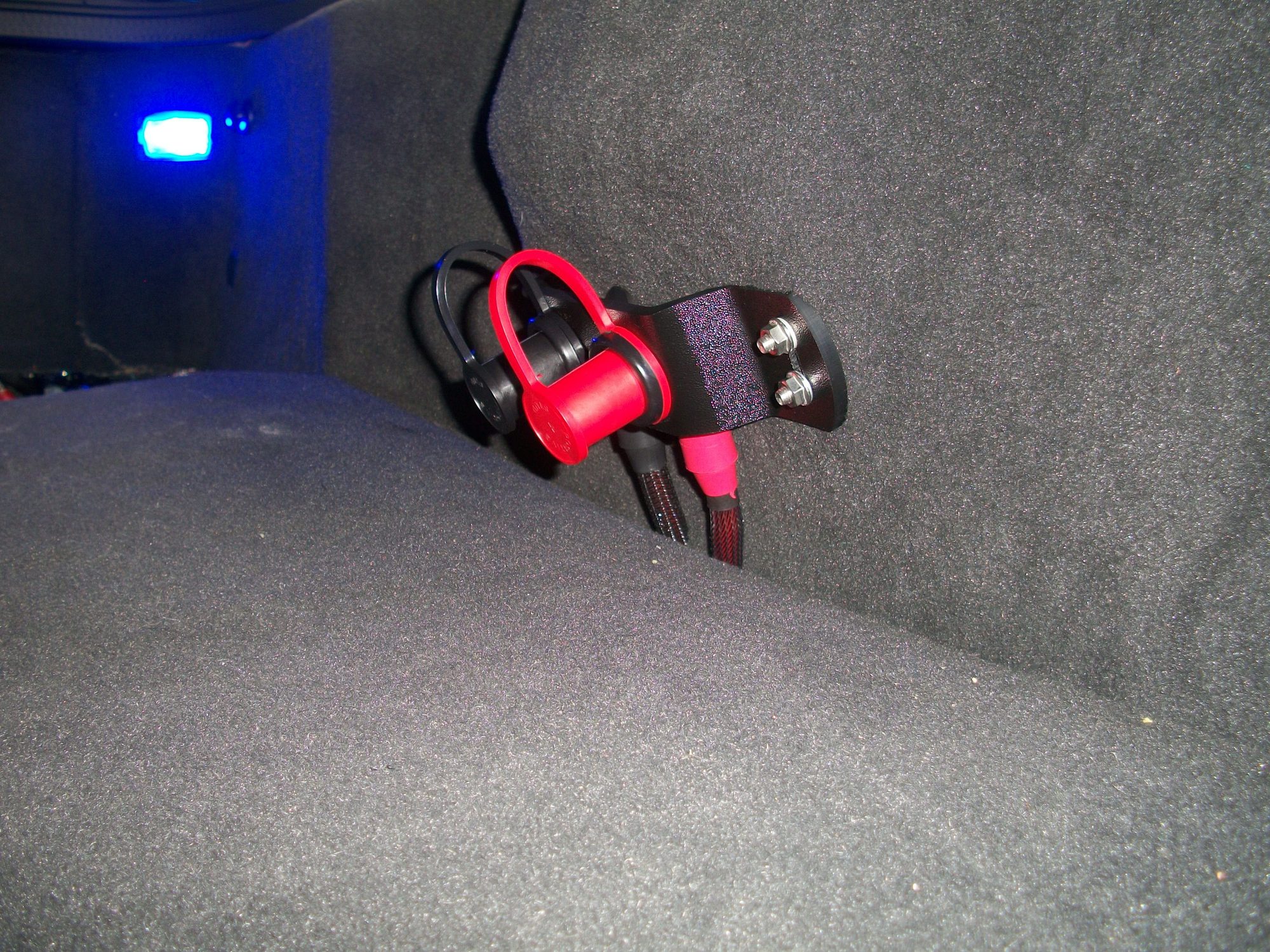

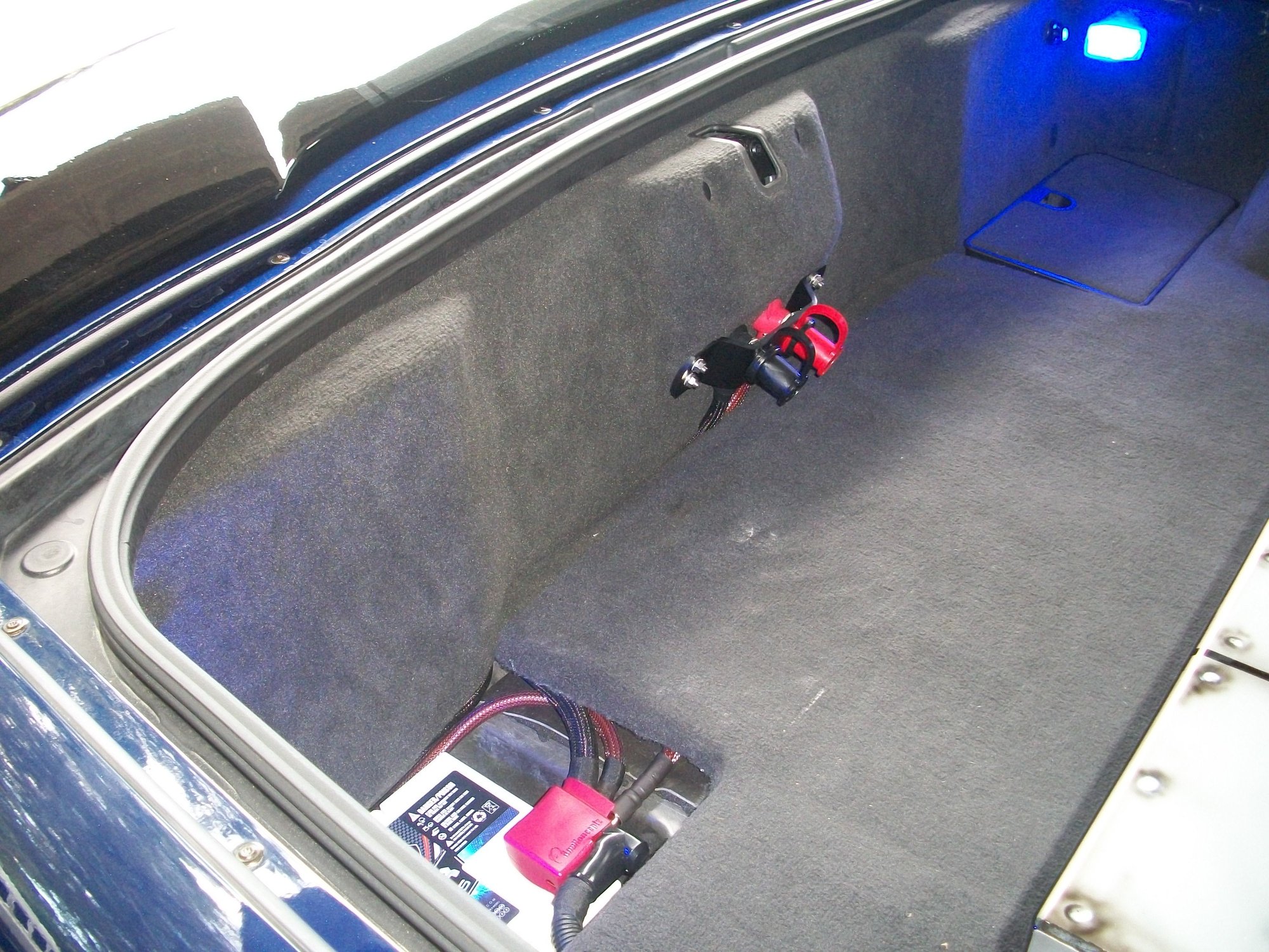

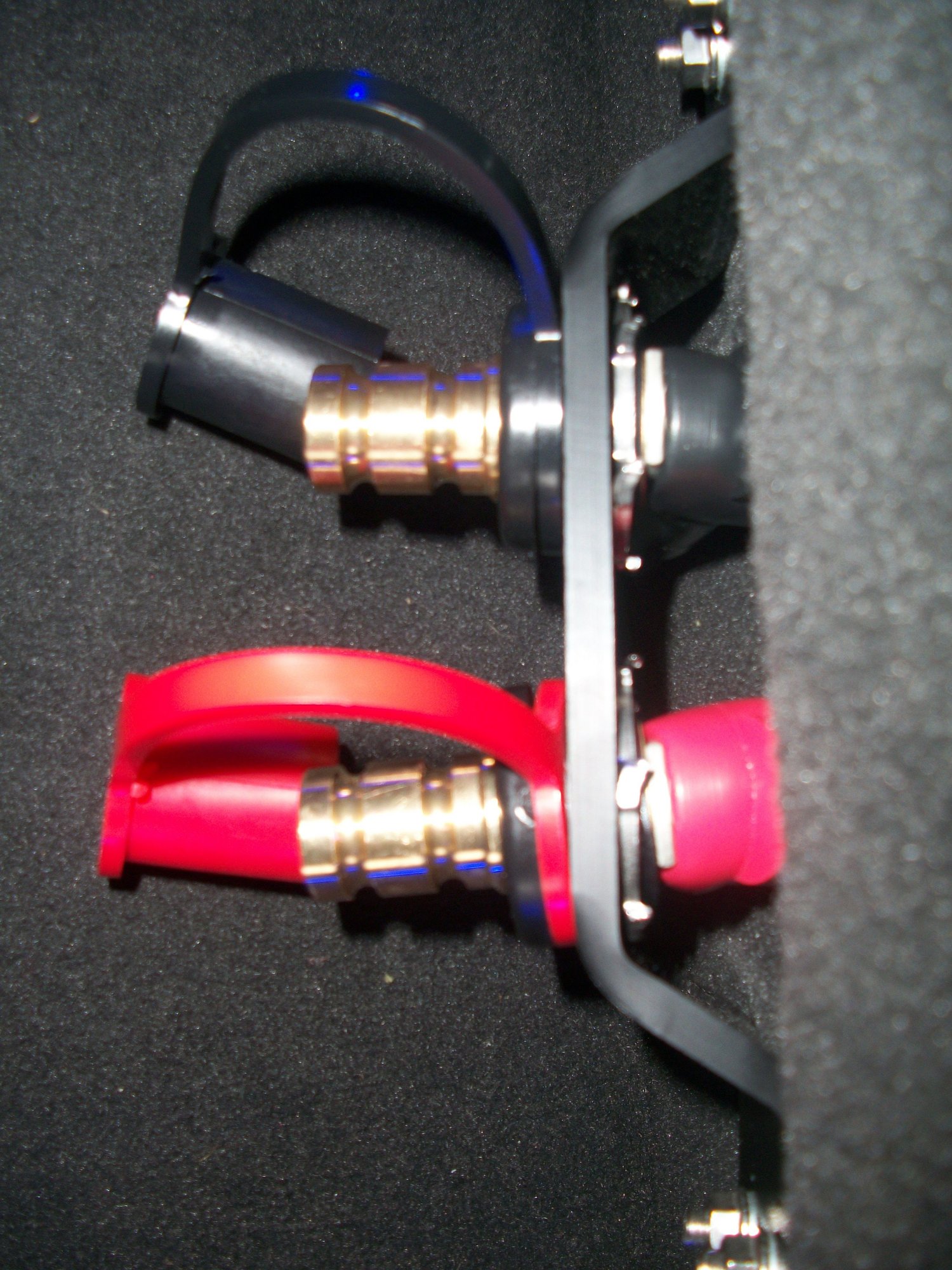

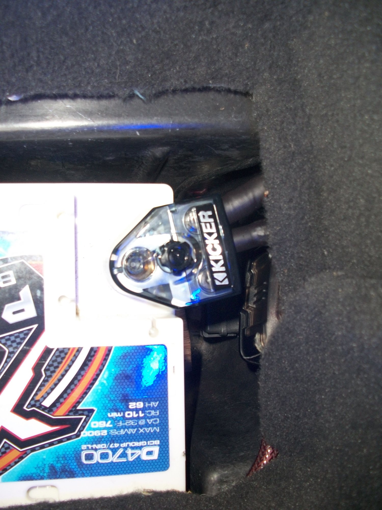

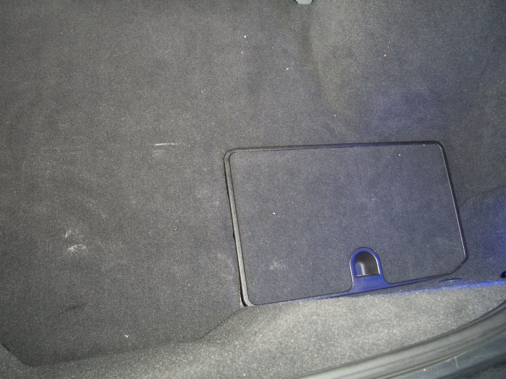

Well...I can FINALLY say it. And I actually MEAN it this time. I'm 100% DONE! My install is as installed as it's going to get. The final mod was a remote charging point for a power source to use while we're tuning. As you can see from my previous pics (and the ones below) there was no way to hook a power supply up to the current positive terminal I am using. So my solution? See below.
Will also be helpful for dealerships (if I ever bring it to one) to keep her charged.
Added my new kicker negative terminal
Had to trim the cover a bit. Ran 4 gauge wire into an 8 gauge reducer.
Just pop on some gator clips and done.
And the battery box cover still fits.
So yep. I'm done. I had originally wanted to put this on the outside of the car like behind one of the tail lights on the rear bulk head, but I would've had to drill a pretty big hole in the bulk head to run those cables through. This is the simpler and cleaner approach.
All that's left now is to finish up with tuning! No more hot start issues, not more power issues. Just enjoyment. Long road...but so worth it when you crank up the tunes!
