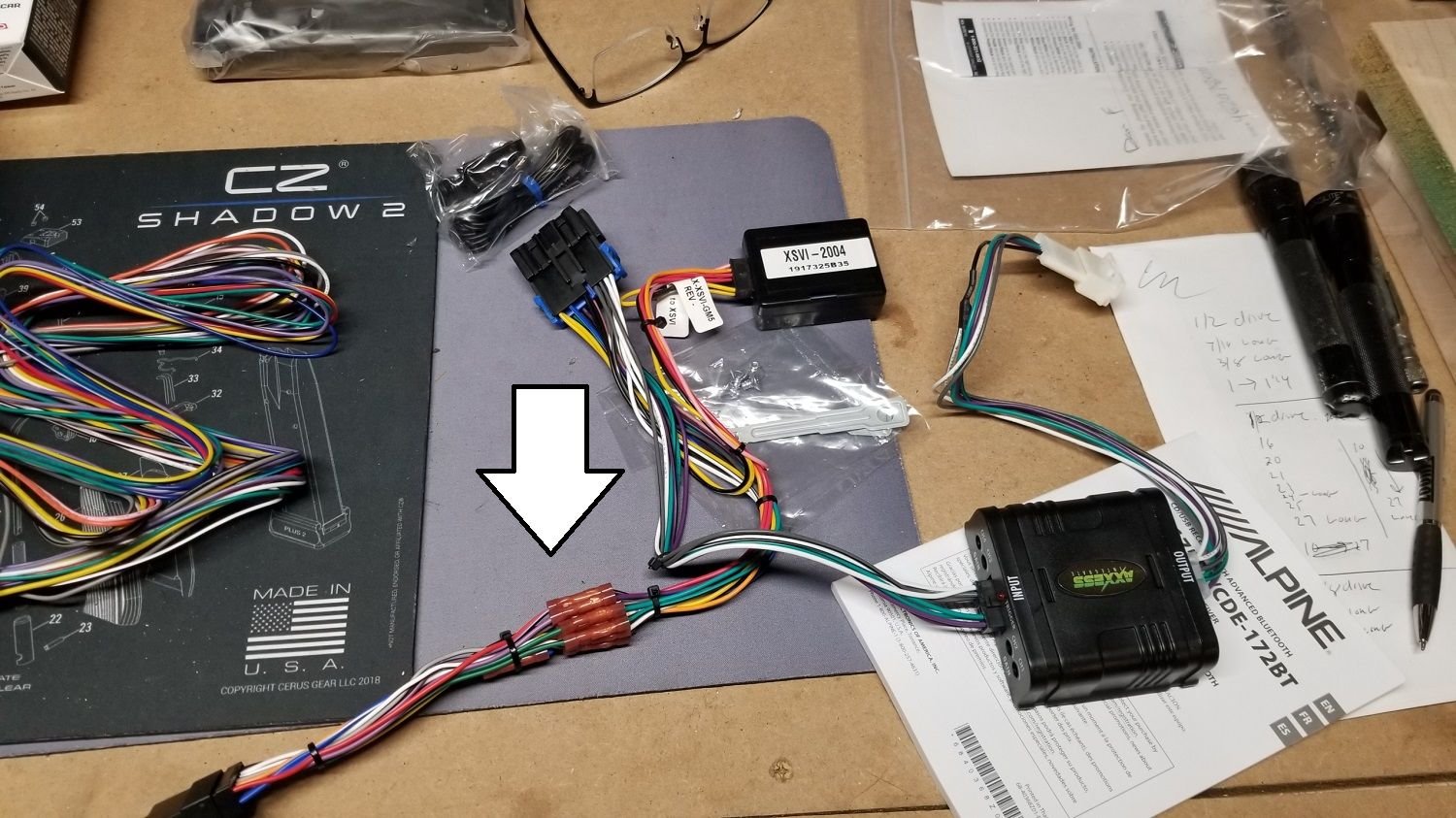

So after a lot of time i got everything wired up..speakers rsdio xm ,amp...and nothing worked. Removed the amp..nothing..removed the head unit and put the Bose back in..works..so its something with the axxess adaptor i guess..at this point i think ill just buy things and go for a total bypass of the Bose..

Nothing powers up. 99 vert
Crutchfield did the connections..i think the interface modules arent powering up..
Did the 30 second on off sequence several times..NG.

Crutchfield did the terminations and all the wires line up. Theres power or the Bose HU wouldn't work.

Crutchfield is having a good time with these things. They are sending me extra modules to try if this doesn't work out. They say the new turn on sequence is to disconnect everything, get in the car, close doors, let car go to sleep. Then hook everything back up and do the 30 second on off. If this doesn't work , plug in new modules and start over. PITA in my opinion.

Got it working. Pulled the Bose out, got all the wiring where I wanted it, unplugged everything, shut the doors and let the car snooze for a while. Then hooked it all back up and did the 30 second on/off. Came right on. Messed around with the settings until it sounded OK. Rear speakers do not sound that great. Bad location in a vert. Big improvement though overall. Now have to do some sound deadening and try to make the rears sound a little better. Some Polyfill and second skins might help. Mounted the mic on the right stalk, Xm antenna I'll try on the left side by the windshield ..And replaced the sun visors with ones from Southern Car Parts, big improvement.
