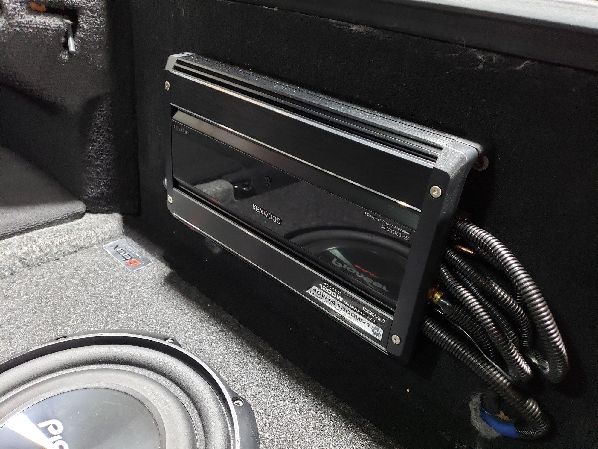

Greetings,
I have been following this forum for quite sometime. I see there are many who know what they are talking about and I have learned much from these threads. Now I have my own question on speakers. I have a 98 coupe. I installed the following components a while ago
https://www.kenwood.com/ca/car/excelon/ddx9904s/
https://www.kenwood.com/usa/car/amplifiers/kac-7005ps/
10 inch Pioneer sub and box from Dennis at DD when he was around. I am not certain the model.
https://www.crutchfield.com/S-RN02nw...Audio-L65.html
Also have Lightning Audio (I believe) 3 way component in the doors. No model number and could not find an image on google.
I really enjoy music. My sub is way to punchy for me and would really like to match new speakers to the head unit and amp. I am truly a noob with all this fine tuning. The amp has many adjustments I will be playing with to get the punchiness out of the sub. Either I have no clue what I am doing (which is true) or my speakers really suck. Can anyone recommend front and rear speakers for this setup. If I can get out the door around $200.00 on speakers that would be a plus.
The speakers came with the car and a single din pioneer. I believe the owner had best buy install it. I tore everything apart and and added all new wiring, sub, head unit, backup cam and amp. I am assuming the speakers were paired with the original Pioneer head unit and that is my problem.
Thank you in advance for any input.

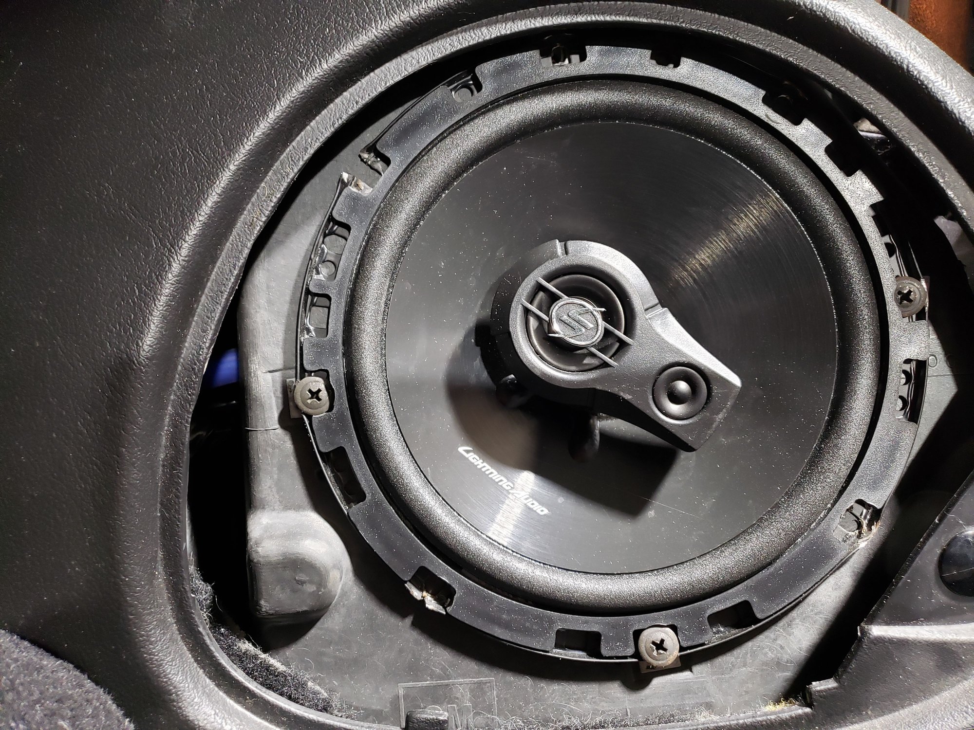

These in the rear https://www.crutchfield.com/S-RN02nw...Audio-L65.html
The fronts are Lightning Audio 6 inch (2 way if i remember correctly) and 3 inch tweet. There is no model number to find. I believe Best Buy put them in from what the previous owner said. A real crappy job hung in the doors with aluminum straps. I have the adapter plates I will use for the new speakers when I get them. The sub is a 10 inch Pioneer in a custom built box that goes into the storage well. I do not know the model number. I do plan on pulling the sub and speakers as soon as this heat subsides to a decent temperature.

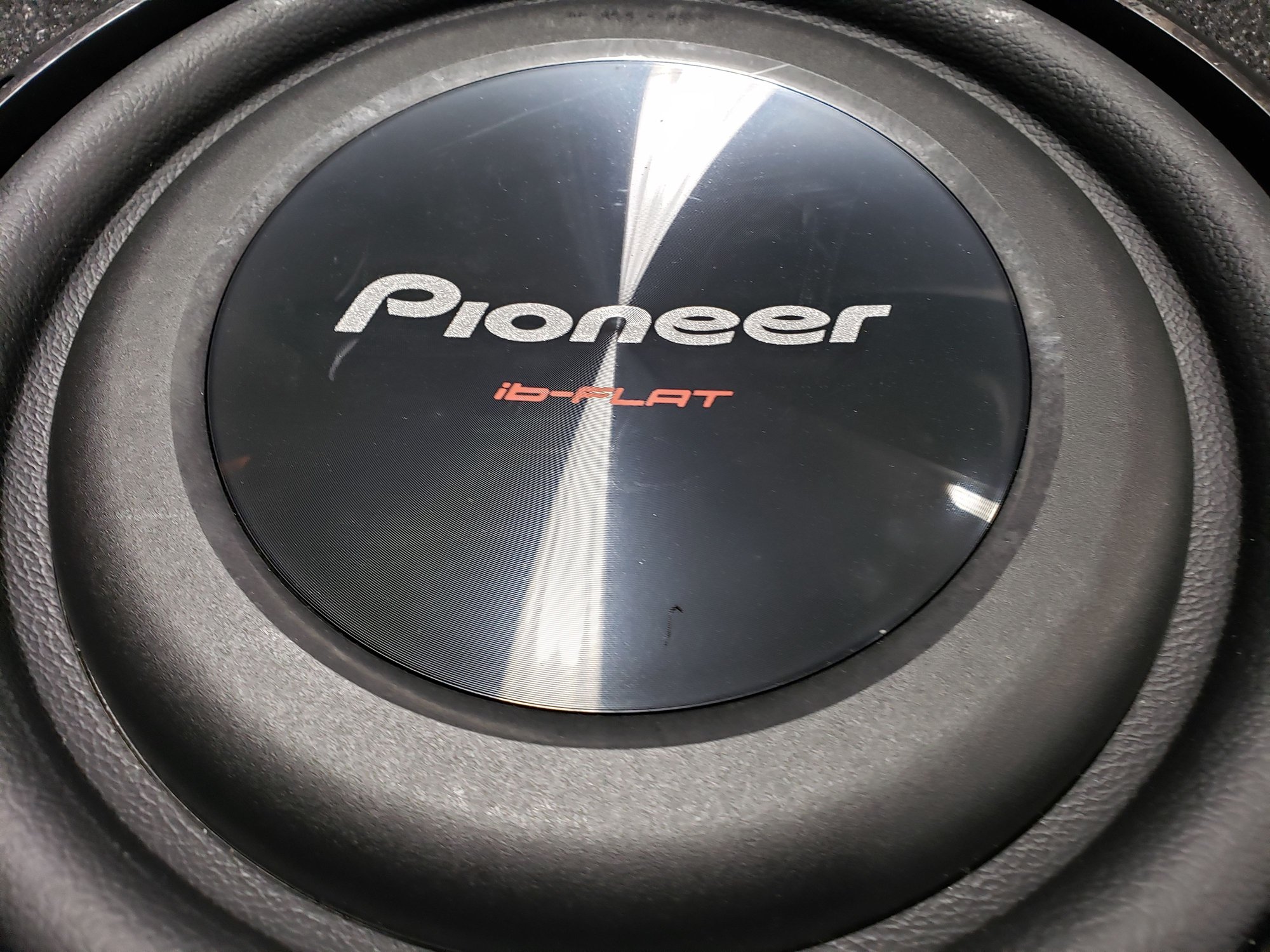

All speakers are 6.5"s? Can you post a pic of the sub? I maybe able to help you figure out the model of it.
I would spend $500 of your budget on a JL XD 700/5v2 and replace all your speakers with 2 ohm models. That will give you 100W RMS per channel and 300W RMS for your sub. Should be plenty more power and not break the bank, not to mention, it's a TON of power in a TINY amp. Once we figure out what sub you got, we can move further towards reaching your goal.

Did you ever figure out what sub I have? If not, that will be coming out in a few days.

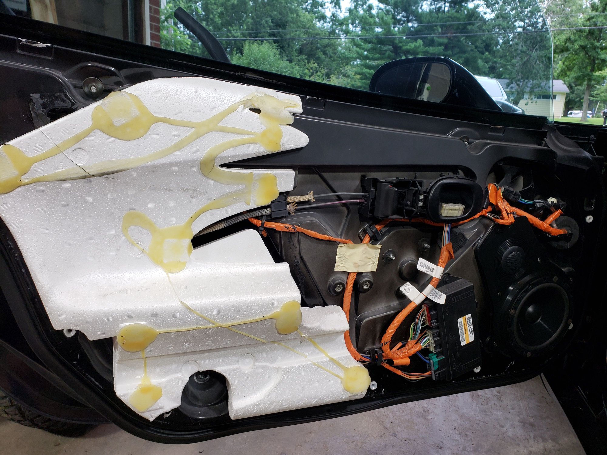

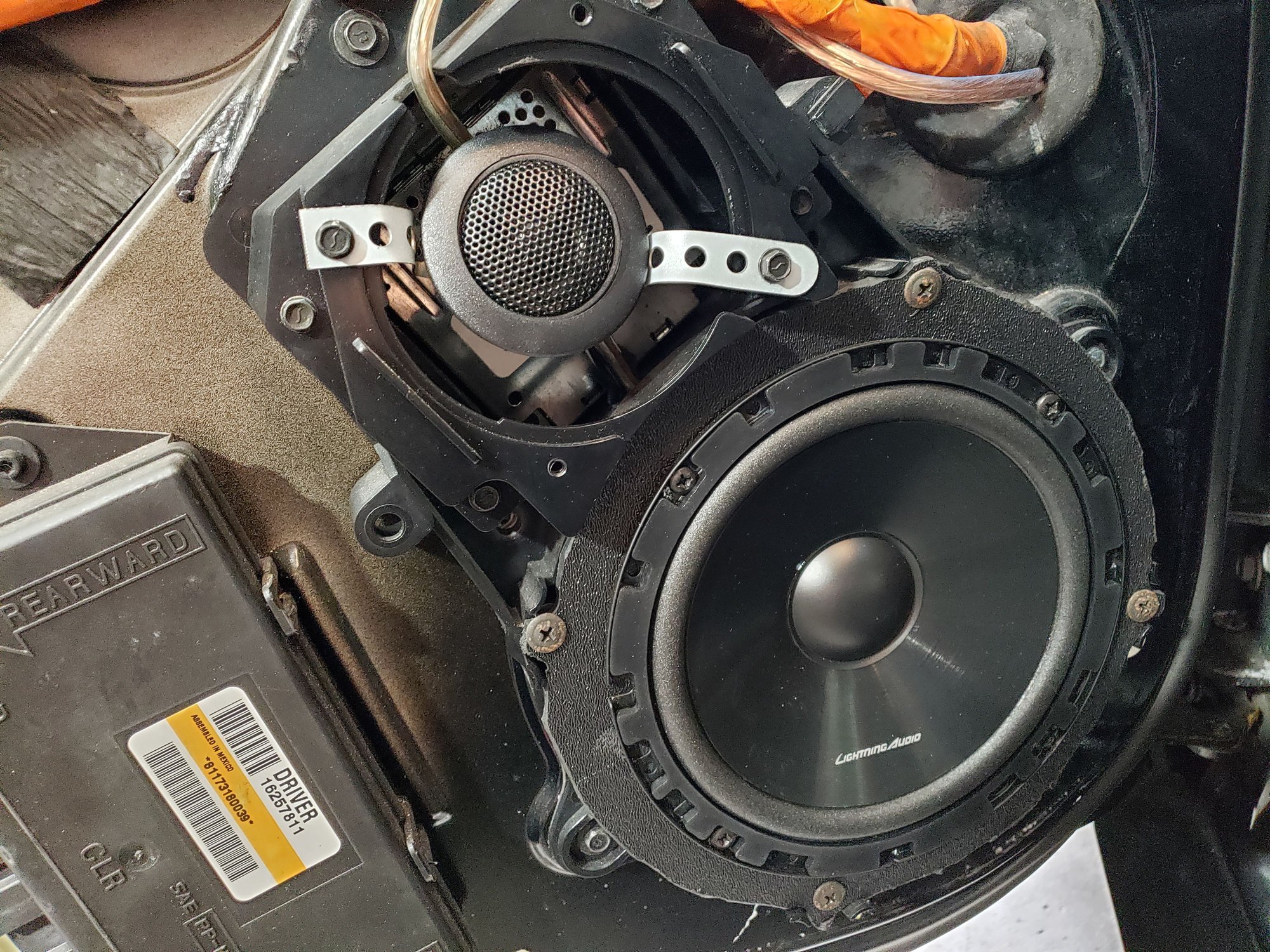

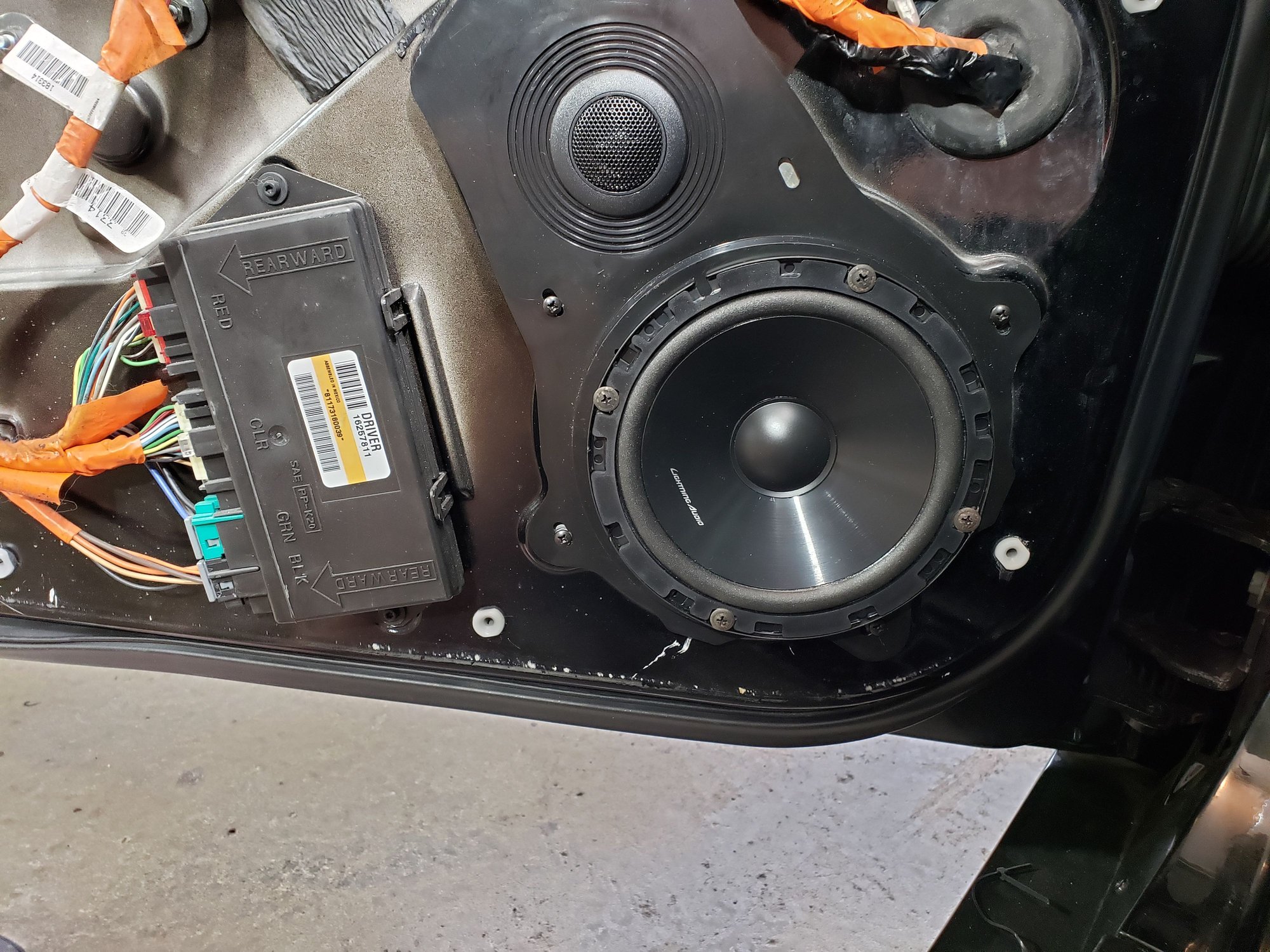

Here are some new pics. I started on the adapter plates. The door speakers are 2 way, I had to dremel out the adapter to fit the speaker. I believe I messed up and used the wrong solder to connect the twiddler. I have no sound from it.. Here is the solder.
Other pics
Any advice is greatly appreciated.

Solder shouldnt affect it.

This is the sub you have:
https://www.pioneerelectronics.com/P...nt/TS-SW2502S4
It's not a bad shallow sub, and you're driving it with the right amount of power. What this means is that if that is not enough sub for you (meaning you want more bass), you will need another sub and more power...or a bigger sub and more amp. But you mentioned it was "too punchy" for you which to me means you need to EQ it. I would also need to know your signal sine wave...IE making sure your HU is not sending a clipped signal. Good news is this is all part of "tuning."
As far as the tweeter goes, where does the other end of the wire go to? Are you running a crossover? Direct into the amp? I didn't see X-overs in any of the pics. If you send a full signal to a tweet, you can kill it in seconds. So far man...don't spend a dollar on parts yet (even on the amp I recommended). It sounds like all you need is tuning. You won't know if 40-50W on the speakers isn't enough until you tune it. Got any good audio shops in the area?
Side note, do you have any sound deadening in the car?
I am not certain what signal wave is. I will do my research on this. The other end of the tweeter wire is soldered to the 6" door speaker terminals in the door. There is no crossovers. The speakers are all wired directly to the amp. I believe I have a decent shop around here who can tune it. I also do not have any sound deadening as of yet.

No xover...hmmm..doesn't sound right...poor tweeters are getting same signal as the mid woofer...unless there is some kind of internal xover.
unless you have these: https://www.crutchfield.com/S-YBAbDQ...dio-L65-S.html
which do have an internal crossover.
Crossover: Each tweeter has an integrated 6 dB/octave high-pass crossover, simplifying installation.
Wiring: Each woofer has two sets of wire terminals, shorted together. The tweeter wire connects to one set and the amplifier to the other.

Check the back of the tweeter..might see some kind of crossover back there
