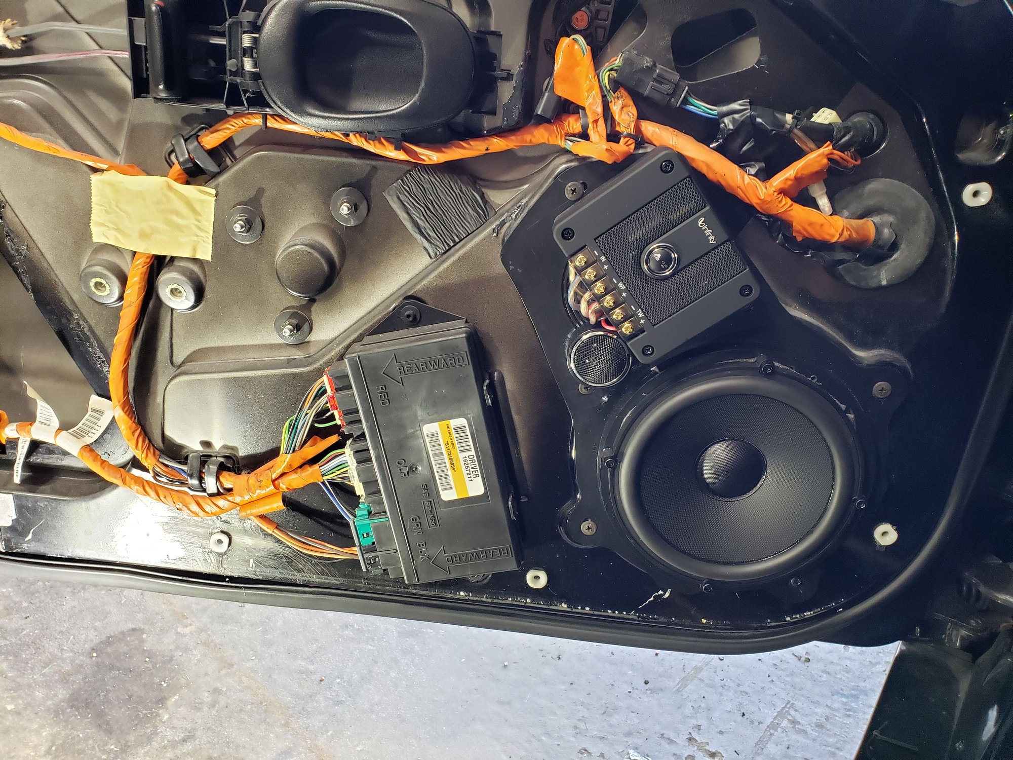

If I need to start a new thread on this, please let me know. I am wondering where a good place on a C5 coupe is to install the speaker crossovers.
Doing a search was not to productive.
Thank you.

From what i have seen the crossovers can fit on the door..

Alright, started the project around 10 a.m. I just buttoned it all up. I figured out the crossover placement as you can see.
I want to say I am extremely pleased with these speakers. Fronts and rears sound so much different from the lightning audio speakers. Now I will play with all the settings on HU and amp. I want to thank all of the input from Pb82 Ronin and mifi2000. You both have helped greatly. I may be asking questions on crossovers settings and all the settings on the amp. I would at least try to learn before I pay someone to tune it. Thanks again

Here are some starting points: (hopefully you test fit the door cards to make sure the crossovers fit in that spot)
Passive crossovers are nice because you don't have to do much tuning at all (it's all internal)
Adjusting time alignment is still accomplished easily with a tape measure
Make sure "loudness" is off (if an option in the HU)
Adjust your amp gain all the way up (until you see clipping, then back it down just beneath the clipping point with the HU at maximum listening volume)
Do not use filters in the HU when running passive crossovers, ensure a full signal is going to the X-over
Hopefully, this gets you going.

I used these
https://www.amazon.com/Aftermarket-Speaker-Installation-Chevrolet-Corvette/dp/B00TR1RCDQ/ref=sr_1_2?crid=1966B4VXOU7HJ&keywords=c5+corvette+speaker+adapter&qid=1564486339&s=gateway&sprefix=c5+corvette+ad%2Caps%2C148&sr=8-2 https://www.amazon.com/Aftermarket-Speaker-Installation-Chevrolet-Corvette/dp/B00TR1RCDQ/ref=sr_1_2?crid=1966B4VXOU7HJ&keywords=c5+corvette+speaker+adapter&qid=1564486339&s=gateway&sprefix=c5+corvette+ad%2Caps%2C148&sr=8-2
I have to say there was plenty of room between the speakers and the speaker grill. Here are the dimensions of the crossovers I have.
Crossover Height (in) 3-1/8"
Crossover Width (in) 3-15/16"
Crossover Depth (in) 1-5/16"
