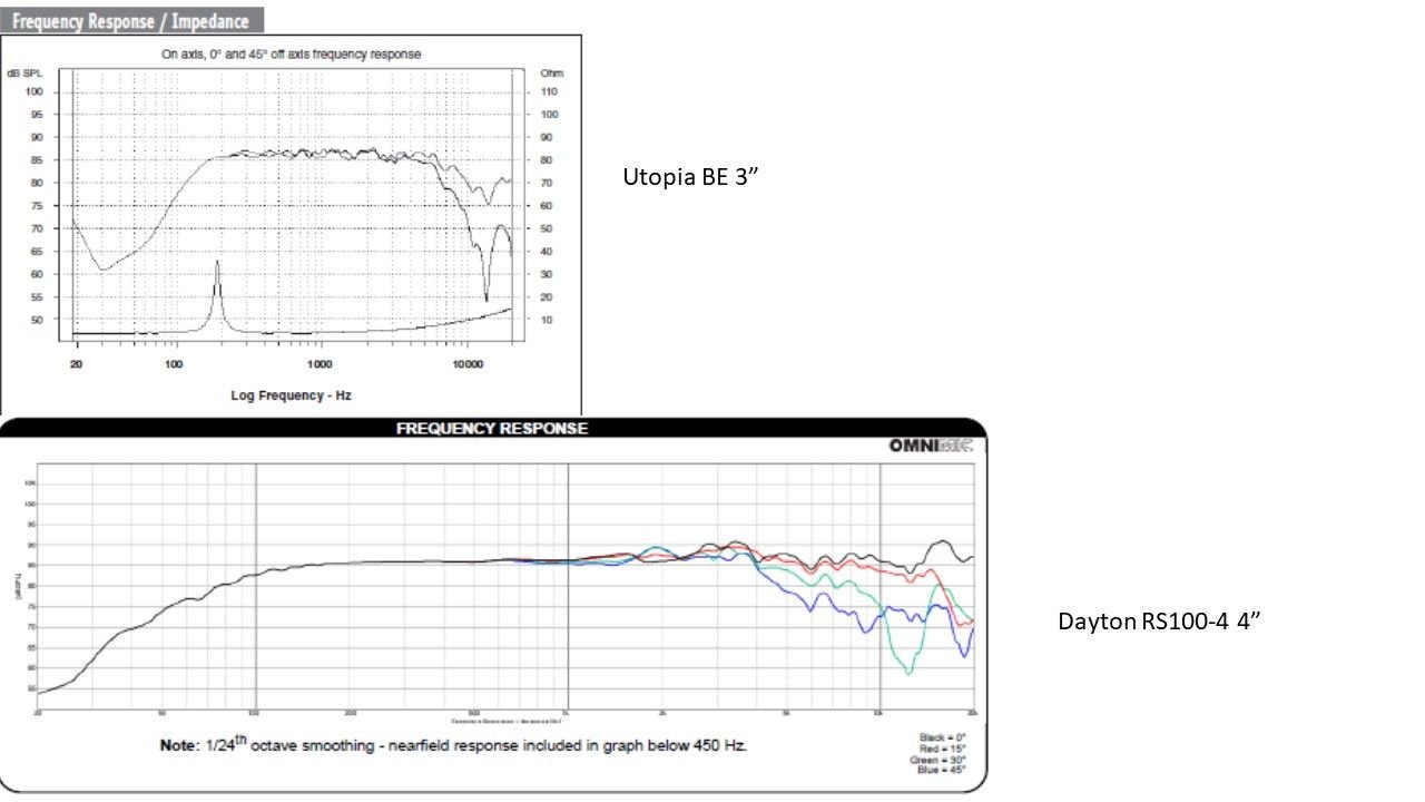

I am curious on the "cheap" Dayton speakers you used; their sound quality is better or comparable to the Focals?

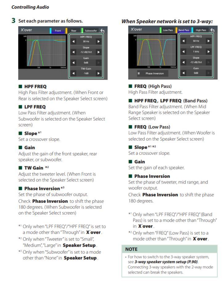

My plan was to use the factory amp & 6.5 Bose short term, then re-wire to the HU when I add the Focals in with a tweeter mount similar to you have. Pretty sure the Kenwood HU has basic crossover functionality for 2-way speakers, not sure how its 3-way system works.
EDIT: Reading the manual, the DMX906S has a pretty detailed crossover for both 2 & 3 way setups.

The Dayton's were well received by the high-end audio community and were the drivers used in some award winning speaker box builds. They also have some of the sexiest frequency response curves I've seen from a 4" driver. They rival Focal Utopia's ($8,000/ set, about $1500 for just the 3"). For $30 a driver, the RS100-4 is very hard to pass up. (EDIT: Hang on, I'm trying to post pics for you)
Also, The HU X-over settings, while better than nothing, will send that signal to all amps associated with that channel. I need to research that HU a bit more before I can advise much further...

Finally someone that understands speaker drivers
