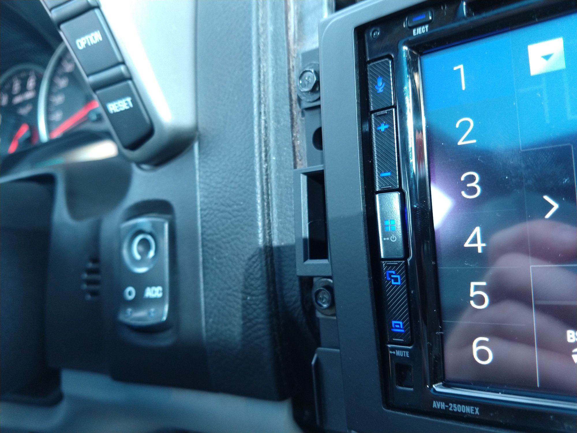

Just bought a new pionee AVH2500NEX to put in my 2005 vette,and mounted it to a metra dash kit.. Well radio sits in way to deep and makes it hard to get to controls like vol and others..
So any idea if a different brand of install kit would be any different ?? like Scosche ???

i have it as forward as it will go... changing screw holes will make it worse..
Saw on another sight where a guy had same issue but different car

Also, I'mnot sure if you have the 2 pieces of the Metra kit connected properly. It's hard to tell from the picture, but you should have seen this before installing if you had the faceplate and brackets installed properly prior to install.

yes,, but the new deck doesnt have hardly any outward chin like your pic.. I had a older AVH5700 in there orig, and that deck has the chin like your pic.

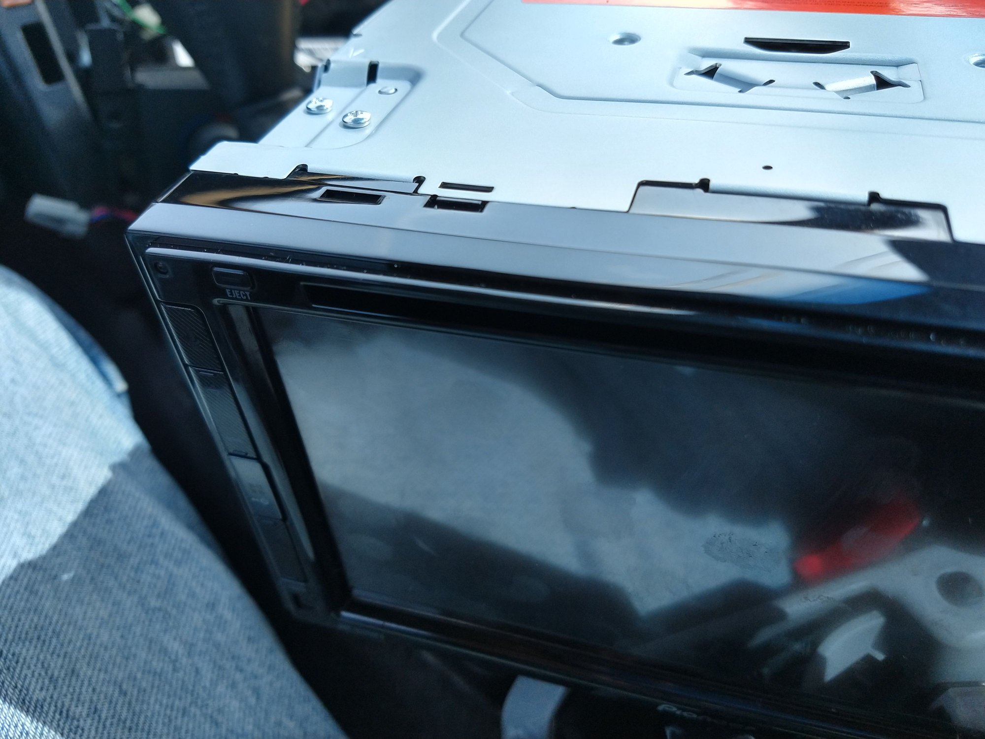

We need a picture of the side view of the head unit.

Had radio out and i was right . Without modifying the metra dash kit , radio doesnt sit into mount deep enough and makes it hard to work buttons. And you can see there is hardly any chin on the face which makes for the metra mount to not sit down far enough.. Thats only about a 1/8 of a inch lip.
So i decided to return radio for a refund.. Also i found that the screen on the radio is terrible to view in the day light. As its to reflective and cant read the screen 75% of the time, and its a fixed plate so you cant angle it. My older AVH5700 i could tilt the screen to help
