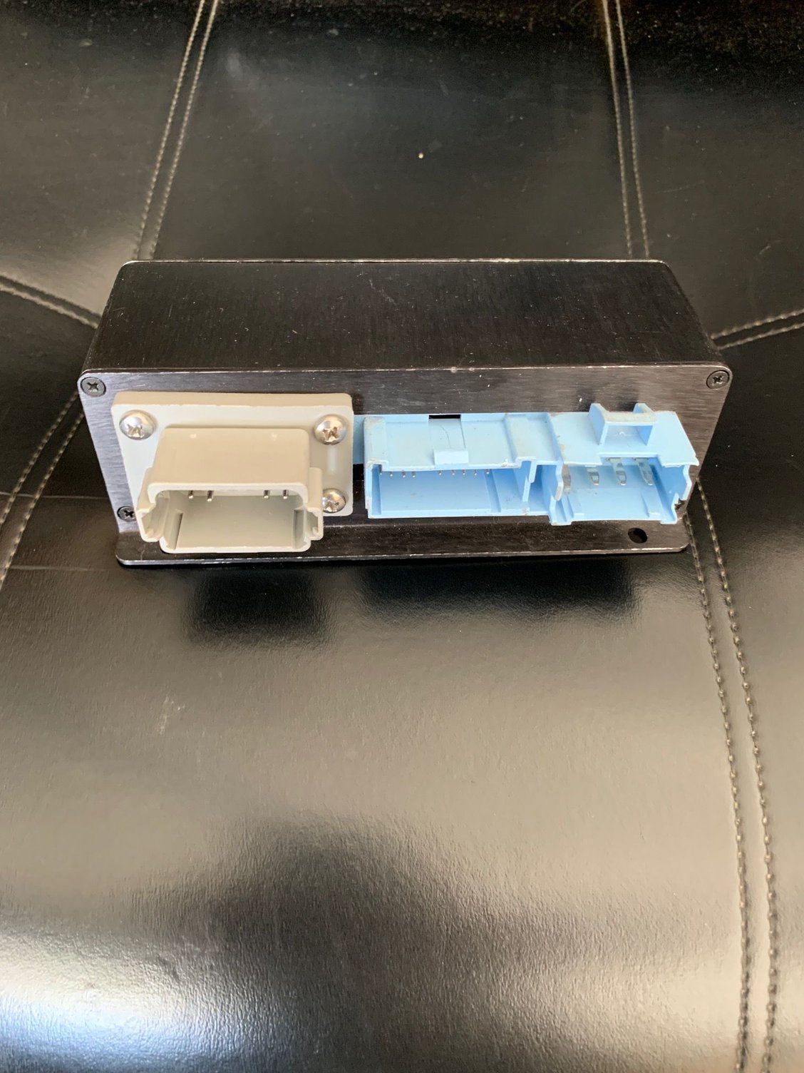

Fred said I might check out the audio forum after I posed in another, and I found a few threads I thought I might be helpful with, yours being one of them. Here's what you do... Buy an old factory amp, cannibalize it for the connector, put your face in the schematic, break out the soldering iron and some leads, and in a few hours you can make your own BoB with RCA outs and still keep everything you want to keep, including your factory Nav head unit. You aren't alone, I too like the look of factory integration and kept my Nav unit as well.
