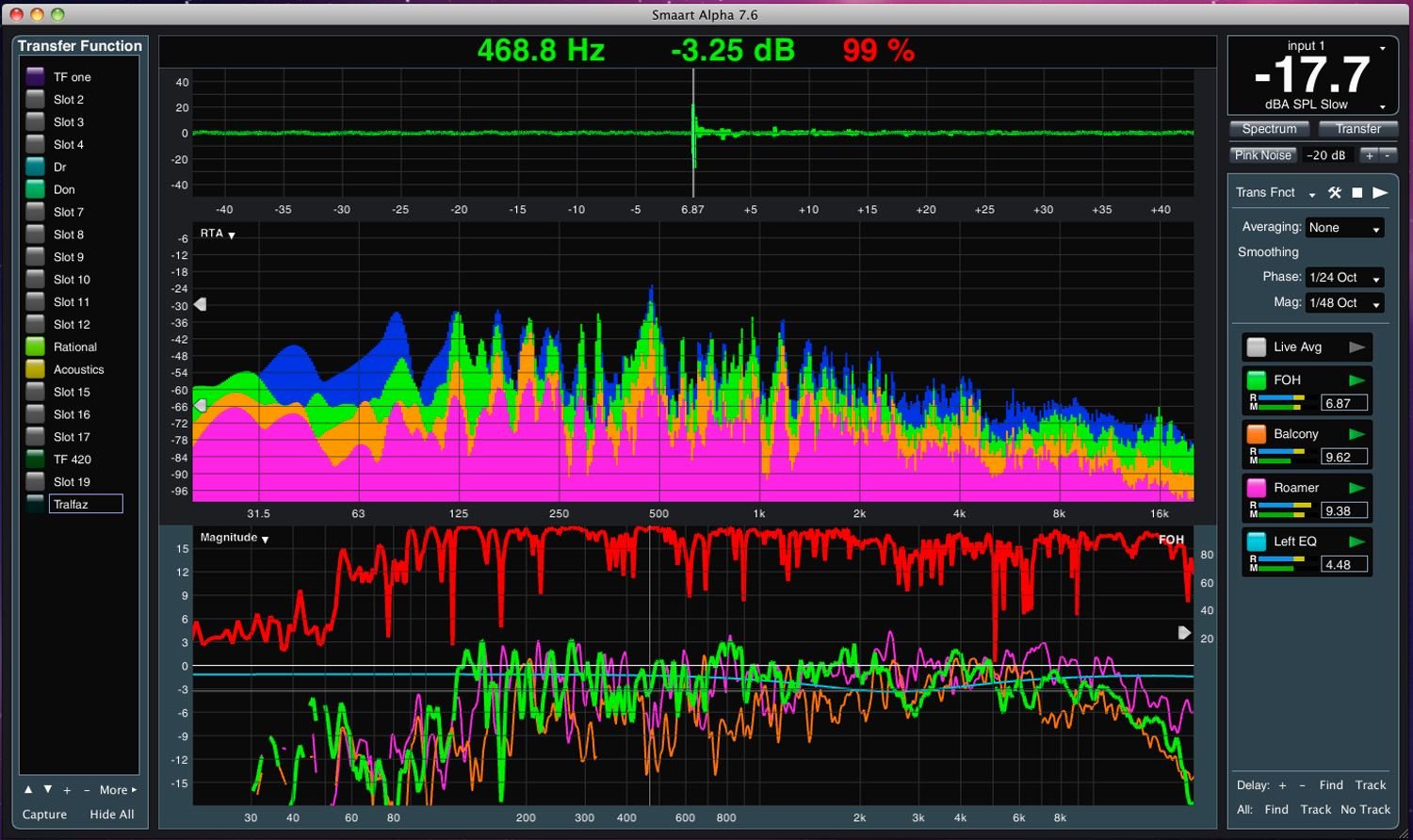

I didn't read all the posts but it's clear there have been major improvements made in car audio DSP's, and there are plenty of options to choose from.
I'll add a couple caveats. In the pro world cost does actually correlate directly to performance and sound quality. Not all DSP's sound the same even if they appear to be doing identical tasks.
One of the defining characteristics of equalization is how the individual filters combine with one another. What you see on the screen isn't always what you get with 'lesser quality' gear. Is there a smooth transition from one filter to the next?
A common feature available in higher end DSP's is the ability to create asymmetrical crossover points. For example; high-pass your lows at 24Db per octave at 100Hz and low-pass your subs at 12Db per octave at 80Hz. You're taking some of the strain off of your low-mids (protecting them from destructive bass) and letting the subs 'fill in' a bit. This same concept applies at the crossover between your mids and tweeters in a tri-amp'd set up.
Another important feature is being able to time-align the individual drivers (woofers, mids, tweeters, etc) This is critical in a 4-way, quad amp'd setup for example. The goal is to have all the frequencies arriving at your ears at the same time. Time-aligning the 'mains' to a sub-woofer(s) is rarely perfect but there is always a 'best compromise'.
Manipulating these parameters to optimize a speaker systems output is defined by the manufacturer in pro systems and things like crossovers and alignment are 'locked down'. They've done the testing and there's no point in second guessing them. These settings are 'fixed' in the amplifier/DSP's they require you to purchase with their speaker system.
Accurately tuning the system to the room (or car) is where the EQ comes into play and using a good analyzer (SMAART is my preferred software) with a high quality (perfectly flat response) test mic and a high quality USB mic pre-amp is essential for best results.
SMAART lets you use the music itself as the test signal (imperative in a live concert setting). It compares the signal coming from the source (head unit in a car) with the signal that the mic is picking up and displays the difference (transfer function) allowing you to add EQ to precisely compensate for what the room/car is doing to the signal.
Of course you can always just trust your ears and tweak on your system until it sounds good to you. The way we used to do it before they invented RTA's.

Good stuff. That's what I would like to hear more about....what gear everyone is using to measure, what types of software/apps, microphones, the like in order to actually measure everything and then utilize that to tune your DSP.
