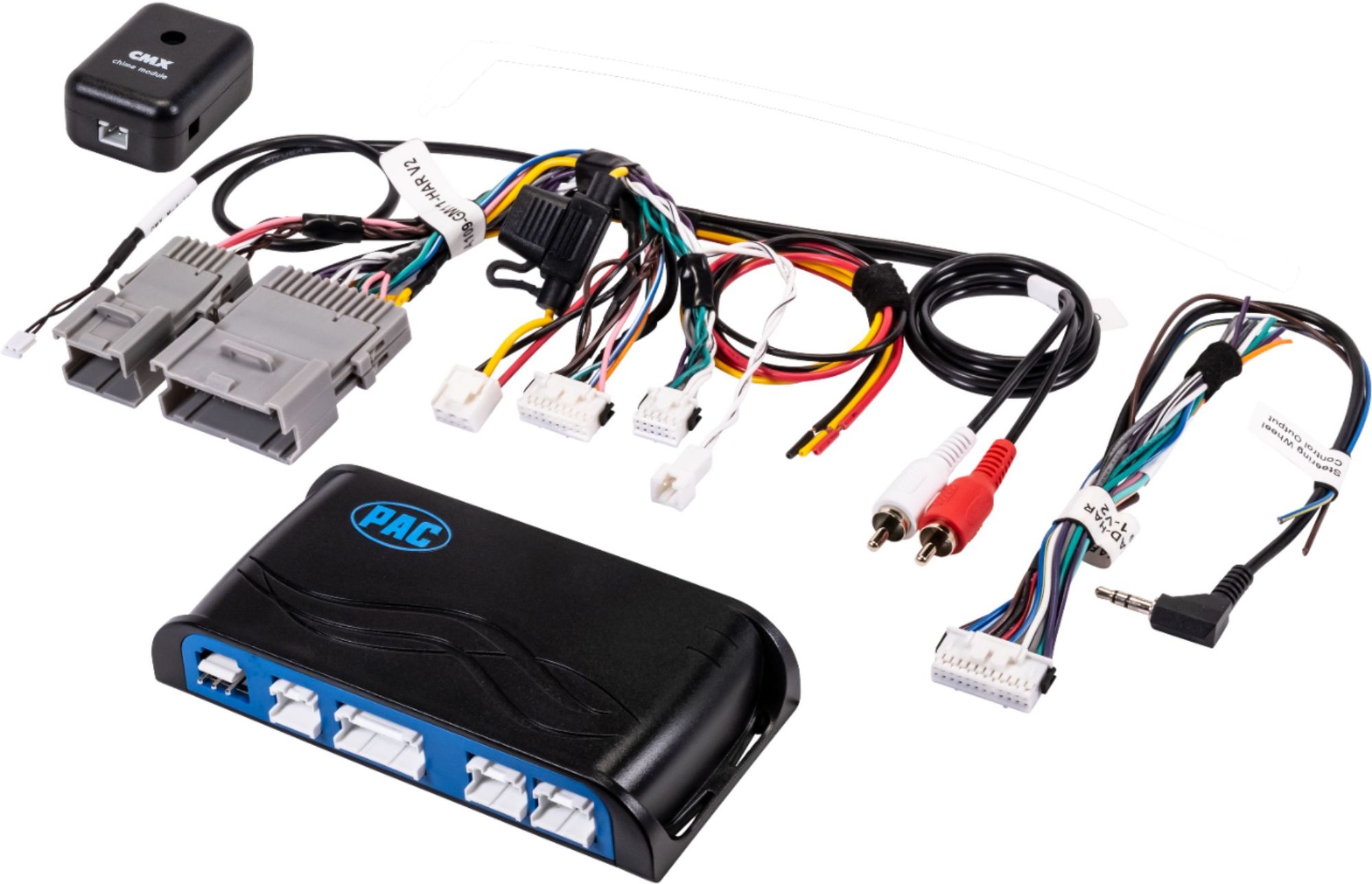

Yep Fred, there's sure some bad people out there, I don't know whatever happened to the OP but here's what I suggest he does. First I suggest he remove the head unit from the car and doing a bench test of the head unit itself by removing the interface and hooking power directly to the head unit, as I personally suspect the head units fine, but his interface went bad. If you may or may not recall, PAC had interfaces (RP5-GM11's) that couldn't handle the added power needs of some Double DIN systems, so they later included the statement in their installation instructions about adding the jumpers on the Yellow and Black wires that basically bypasses the interface and sent power directly to the head unit. If this wasn't done, there was a chance the interface could get overloaded and go out, which a number of them did, however, if you bought an interface before the revised the instructions, you wouldn't have know about these needed jumpers, and adding the jumpers once the unit has gone out will not fix it, as the interface is toast at this point. PAC has since added these jumpers to their newer RP5-GM11's from the factory, so it's not an issue anymore with the newer ones. So if he has an older RP5-GM11, that's why I suspect his head unit's fine, and he just needs to replace the interface, bench testing the head unit will help him determine if that's the case. Attached is a copy of PAC's instructions addressing the jumpers (see page 5).

It appears that they've also since recently redesigned the RP5-GM11, this is what the newest ones look like now. It appears it no longer comes with the radio antenna adapter.
