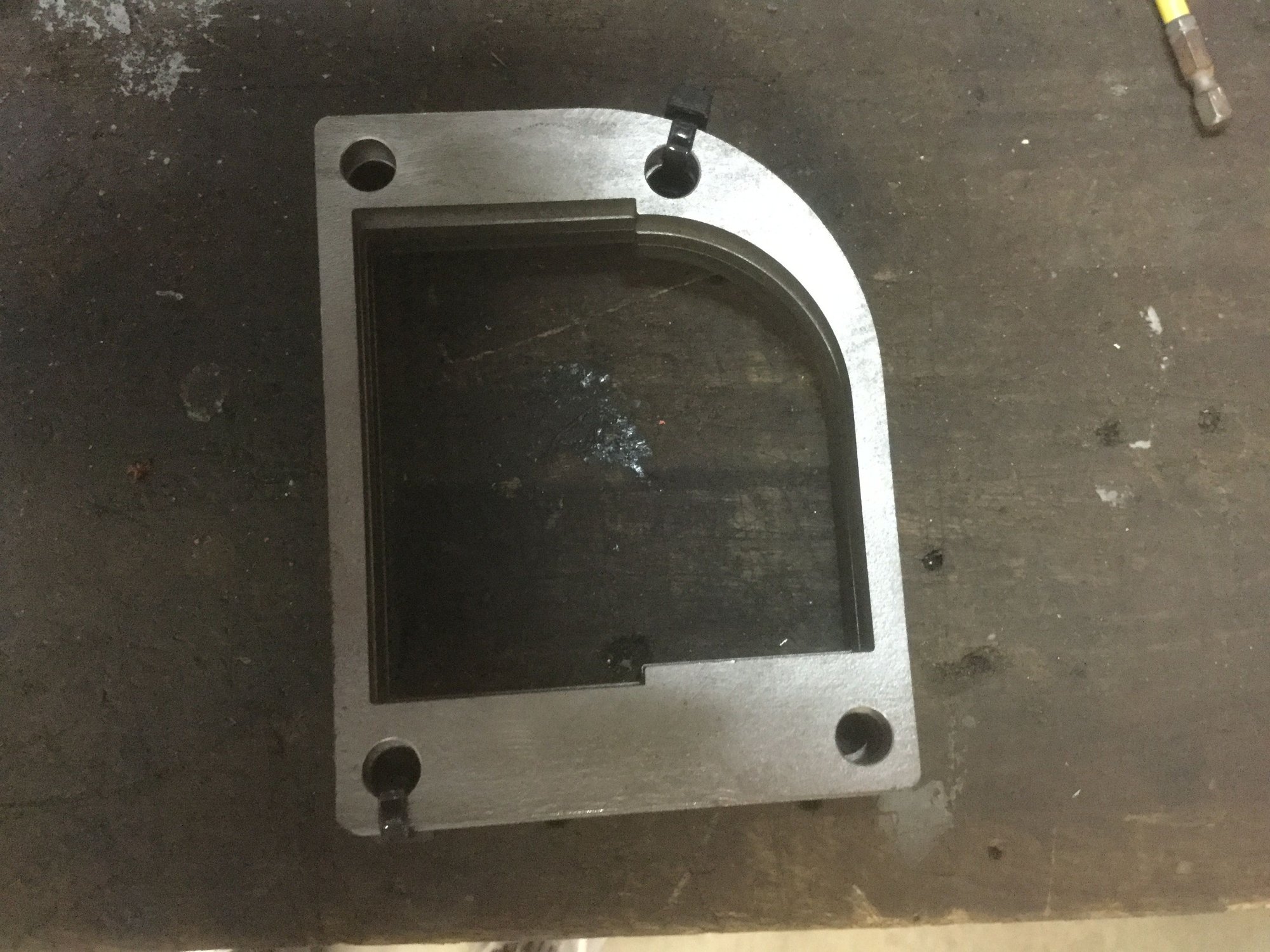

This thread is not too ancient yet so I'll revive it. Just about to place an order for the brackets mentioned by daz_au and I believe others have mentioned them. Going on a non-original frame. Anybody else have good or bad things to say about them?

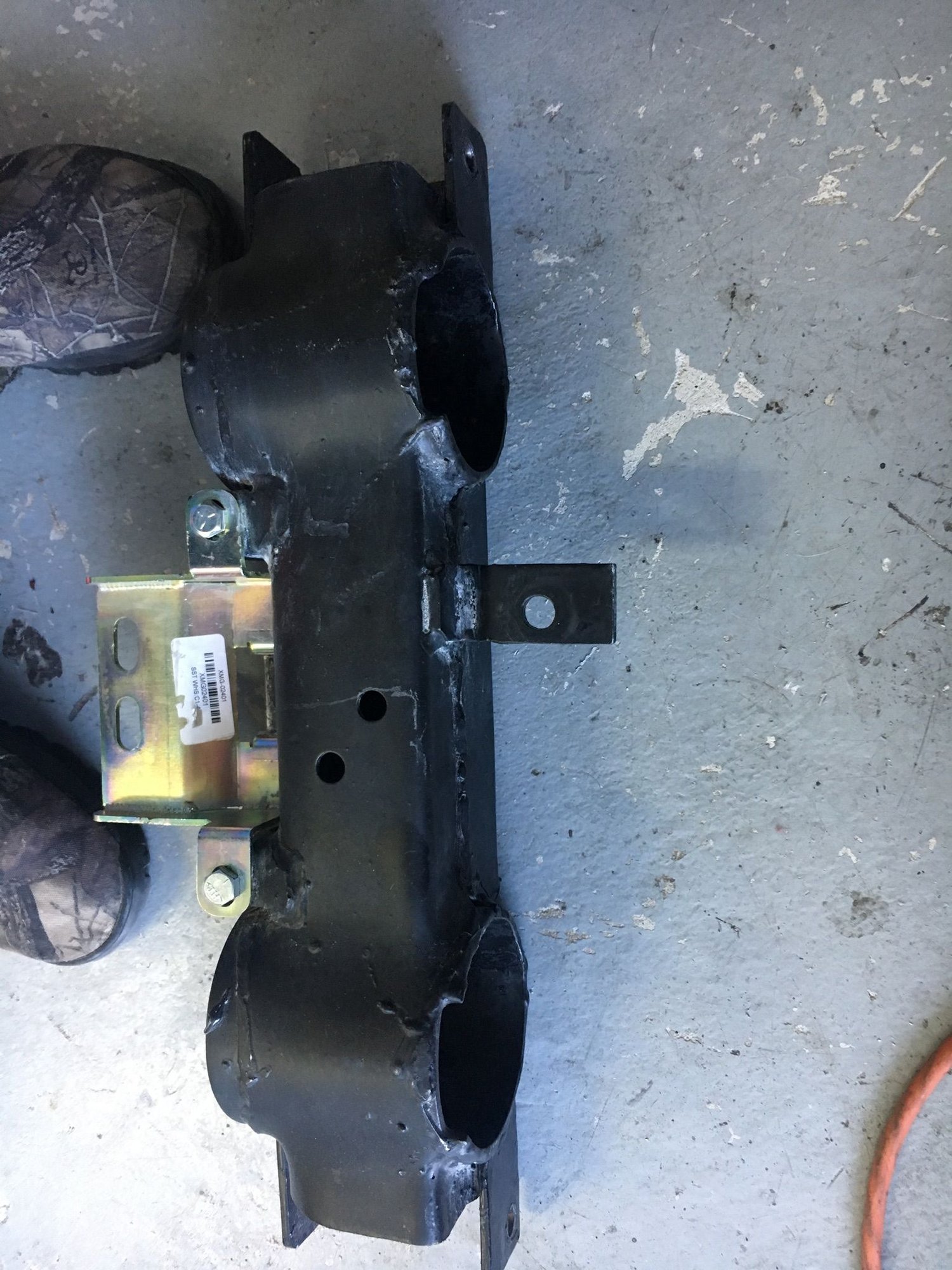

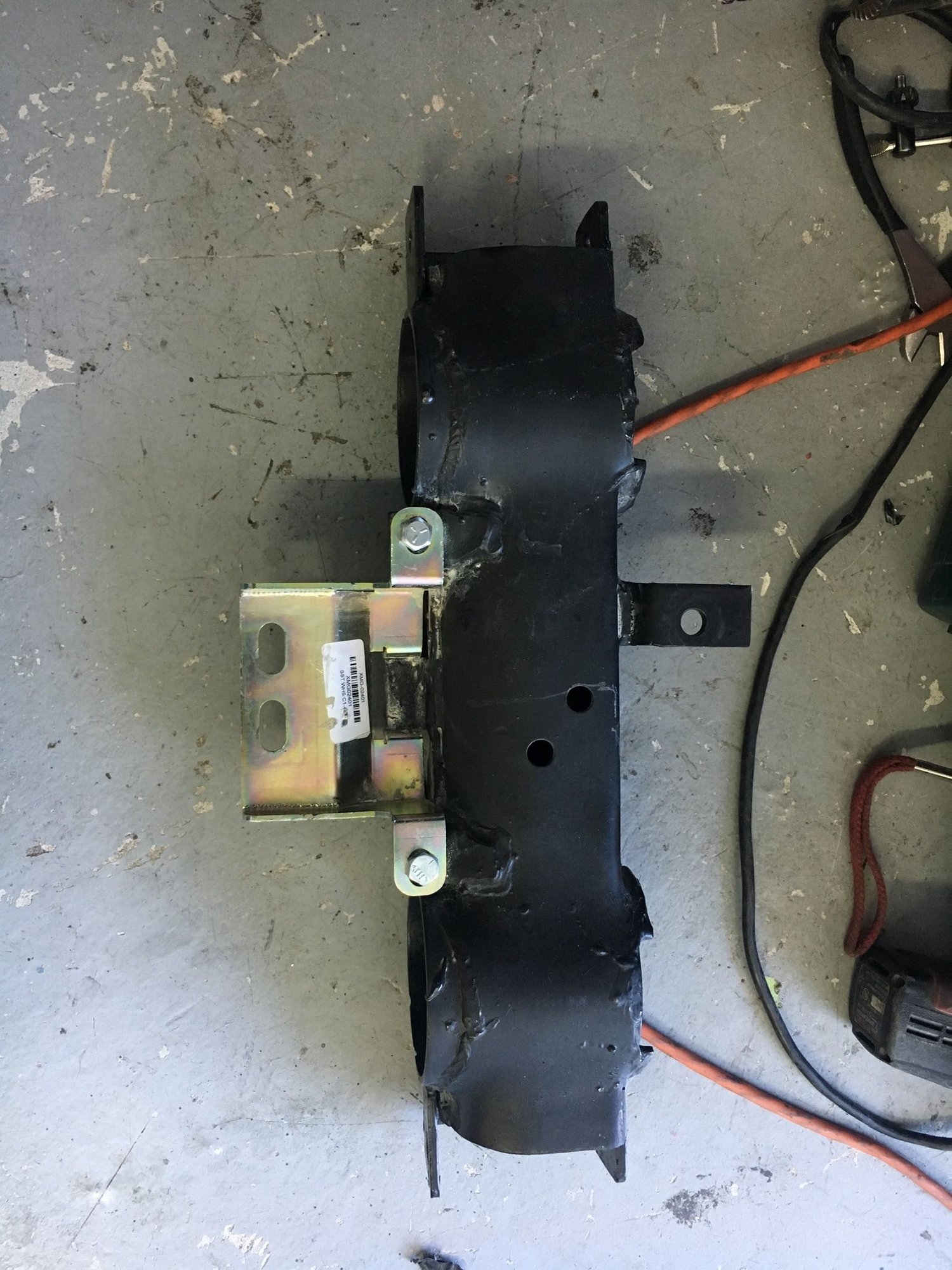

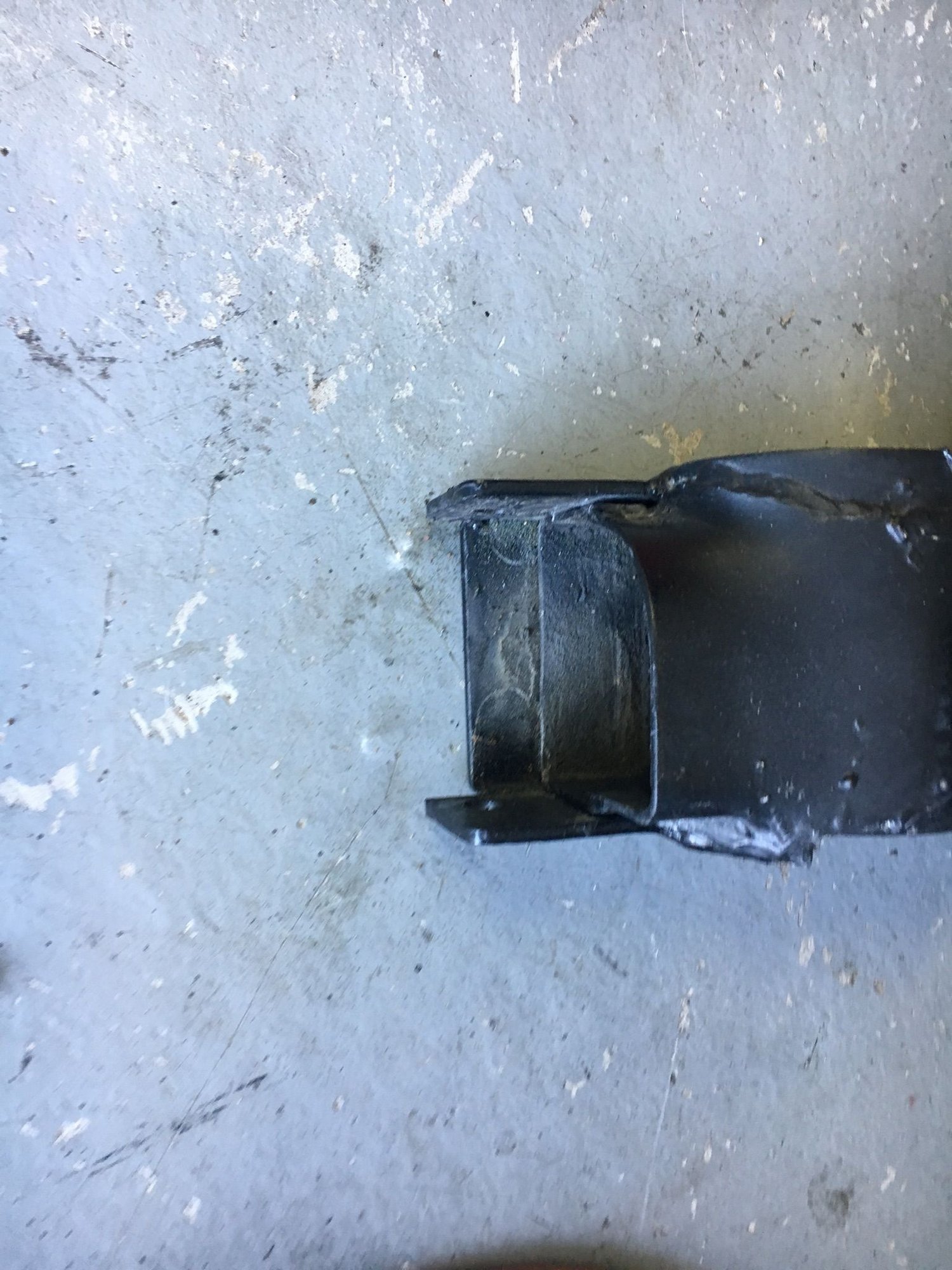

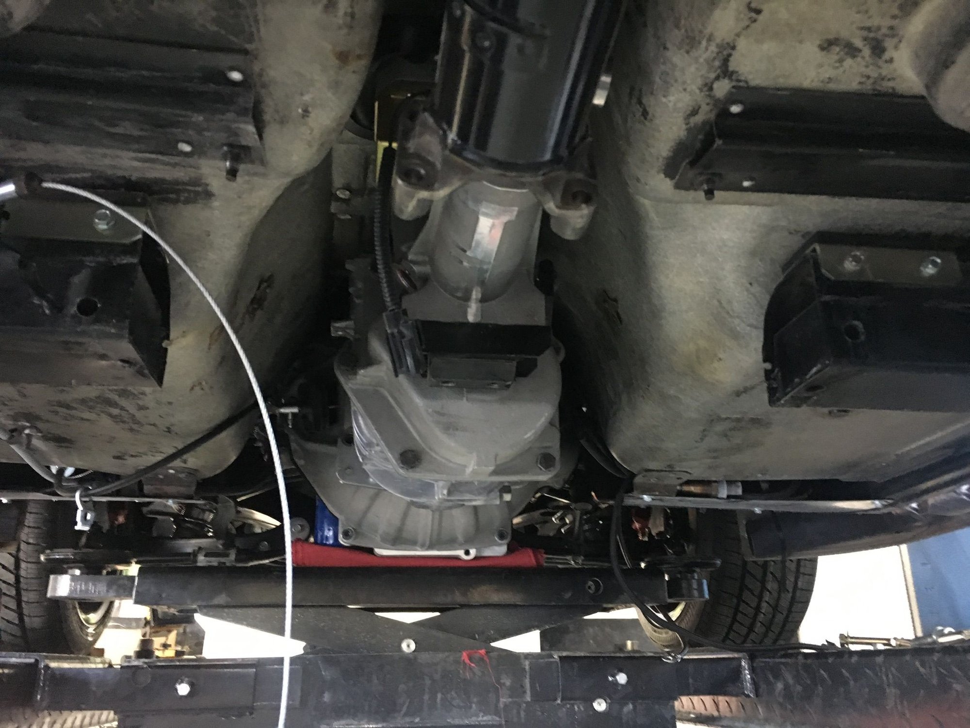

Some of these removal plans become complicated for no reason. Keep it simple

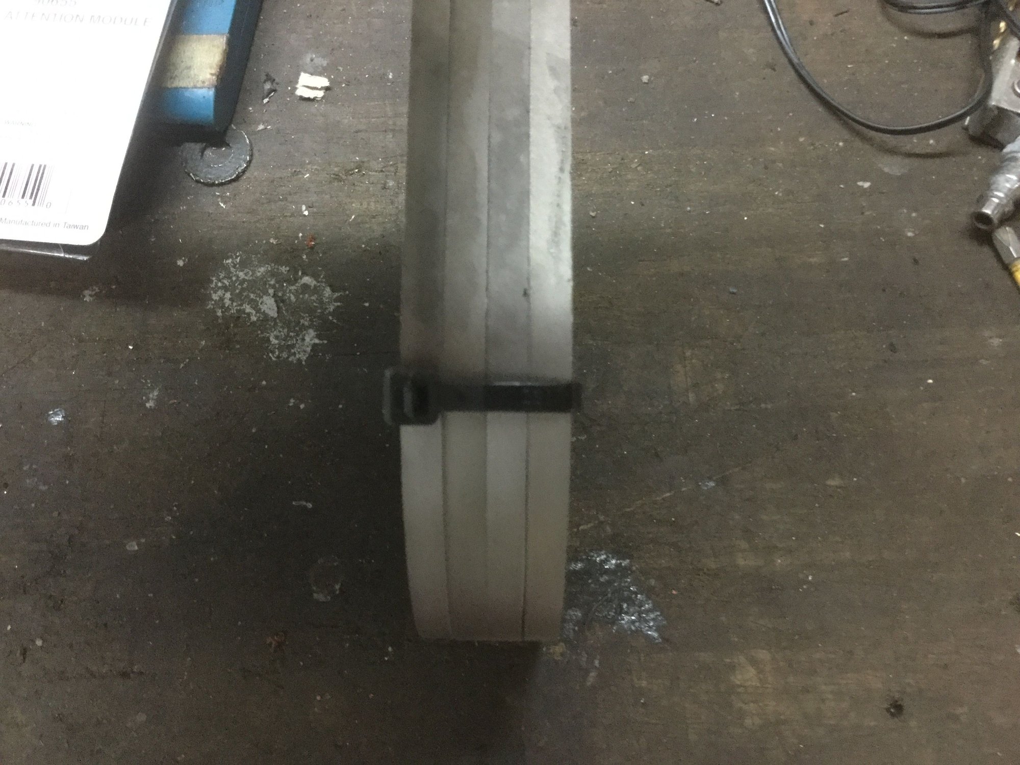

I have a brand new set of these flanges purchased from a forum member that I’m not going to use. My 66 body sets just too close to the frame for serious cutting and welding and I’m just not up for raising the body at this point. 100.00 with free shipping. PM me to purchase.

Bought a set of these brackets from a forum member and they look great. However, he did not have the instructions which come with the brackets when bought new. While I understand how they work, sometimes the directions contain advice or tips which might not be readily apparent, and this is my first time using them. Does anybody have a set of those instructions they could scan and post, or otherwise get to me? Thanks!
