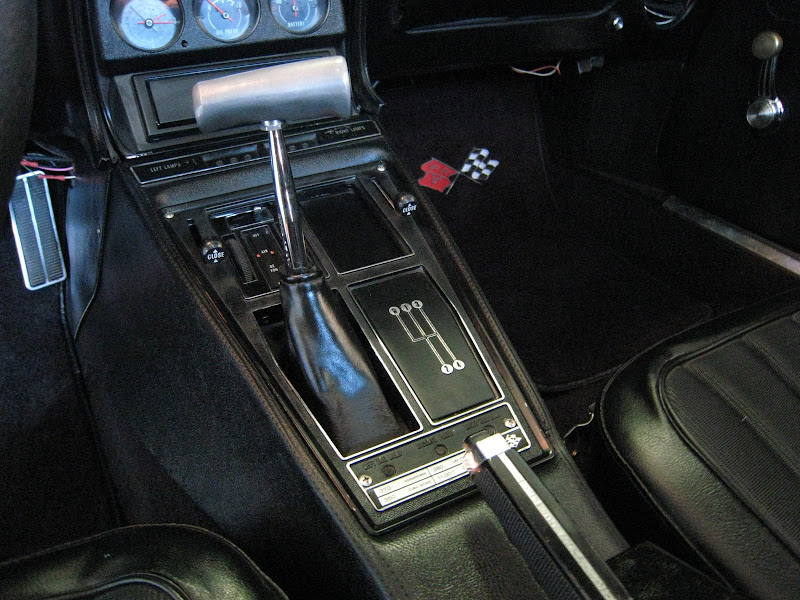

ps: Saw your earlier post on the shifter. For my 81 which was an auto, I had to offet the shifter about 1.5" at 45 degree angle. McLeod makes offset shifters. I decided to do my own and a buddy welded it up for me.
Nice job on the shifter. I looked into the McLeod shifters but I can't see spending $400 for a shifter. I'll most likely do domething similar to what you did. One more design project I have is a mount for the McLeod clutch master cylinder that came with the trans.

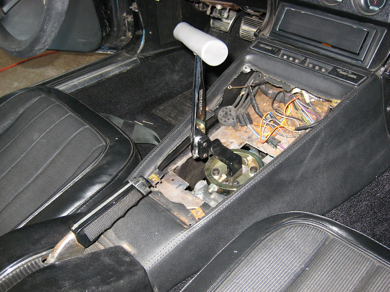

You can get a straight water neck from CSR. The cool thing is that it uses an SBC thermostat so you can choose your temp. http://www.csr-performance.com/csr_cooling.html Part #911LS1.
Here's my modified Pro 5.0 shifter:
For the motor mount plate that I used, I had to go rearward with the shifter to fit through the stock console plate whereas Joe had to go forward.
