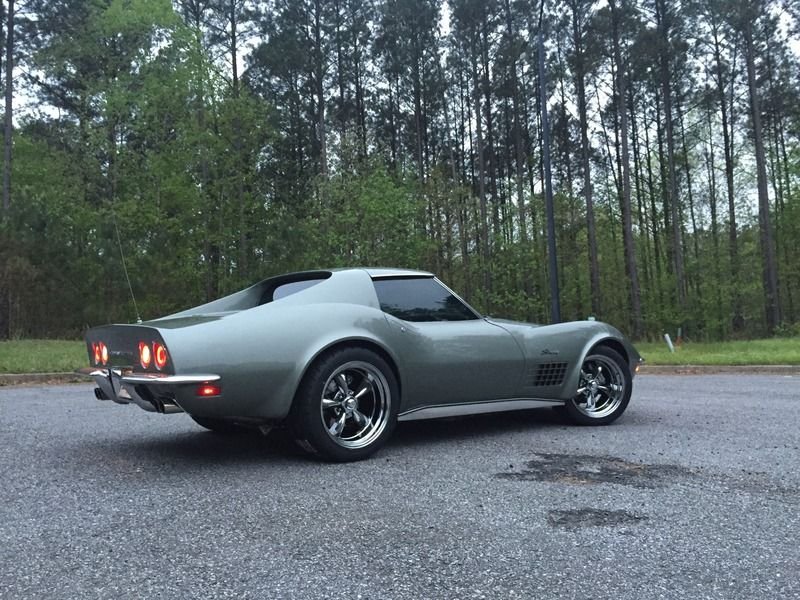

Neil - Are those Billet Specialites?? Look similar to my US Mags. I love the look and really considered buying a set but just didn't want to spend the money again. Plus, I really hate keeping the centers clean!
Here is my contribution to the 18" wheel thread
US Mag U202 18x10 5.75" BS front & rear (pass. side only for test fit)
BFG KDW2 295/35-18 Tire
American Racing Torq Thrust II PVD Finish 18x10 5.75" BS
Nitto NT05 295/35-18 - all 4 corners
This combo does very slightly rub the upper frame with the Nitto. I did not notice it with the BFG KDW, although that tire has been melted 1/2 way down too. I think a 1/8" spacer may remedy this, or if not, a few passes with an angle grinder should do the trick, I hope.

fleming23, I really like the look of the US Mag on your Silver C3.
Thanks, yeah me too! Unfortunately those were "borrowed" from the rear of my 70 Chevelle. I think they look better, and bigger (even though same size) than the Americans but also cost a good deal more. Plus, I couldn't have the exact same wheel on both cars.
I really like a soft lip on wheels as it just looks so much cleaner. American Racing make a few versions but most are forged and in the $6-800 per wheel range, which was more than I wanted to spend for this car.
