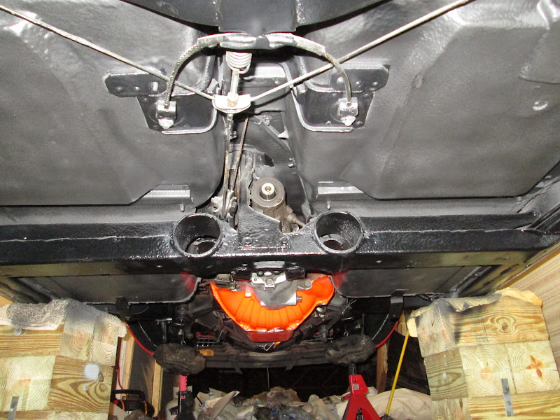

I would tape off the ends and paint the half shafts cast, then clear coat them.
Then I would paint the differential cast with a coat of clear. Leave the driveshaft black.
Either paint the rear tension rods, or get some new adjustable ones. The adjustable ones make aligning the rear a snap.
Here is a couple other suggestions:
1. Paint the differential mounting bracket black and the tension rod bracket black.
2, Go back over the frame rails with satin chassis black from Summit Racing (it is much cheaper than Eastwood's satin chassis black.
3. Re-pant the front spindles and tie-rod ends cast, but leave the control arms black and the sway bar black and the tie-rod adjusters black.
Paint the calipers red and put on a couple coats of clear.
4. Polish the hard brake lines and clear coat them. Clean the e-brake cables and clear them.
5. Replace the rubber brake lines with braided stainless lines.
6. If you get new rotors, paint them with clear. If you have good rotors, paint them cast, then clear coat them.
7. Paint the trailing arms gloss black like the front A-frames.

Thanks for the suggestion.
I already got the adjustable strut rods so thats ready.
1. Paint the differential mounting bracket black and the tension rod bracket black. -ALREADY DONE
2, Go back over the frame rails with satin chassis black from Summit Racing (it is much cheaper than Eastwood's satin chassis black. -I was going to use semi gloss black....
3. Re-pant the front spindles and tie-rod ends cast, but leave the control arms black and the sway bar black and the tie-rod adjusters black. - Good idea on the spindles...I think I will redo in cast
Paint the calipers red and put on a couple coats of clear. - Was going to do red but decided to do black
4. Polish the hard brake lines and clear coat them. Clean the e-brake cables and clear them. - Good idea
5. Replace the rubber brake lines with braided stainless lines. - Maybe a future project
6. If you get new rotors, paint them with clear. If you have good rotors, paint them cast, then clear coat them. - Keeping old rotors, still good.
7. Paint the trailing arms gloss black like the front A-frames. -They will be rebuilt as part of a future project so will be done at that point.

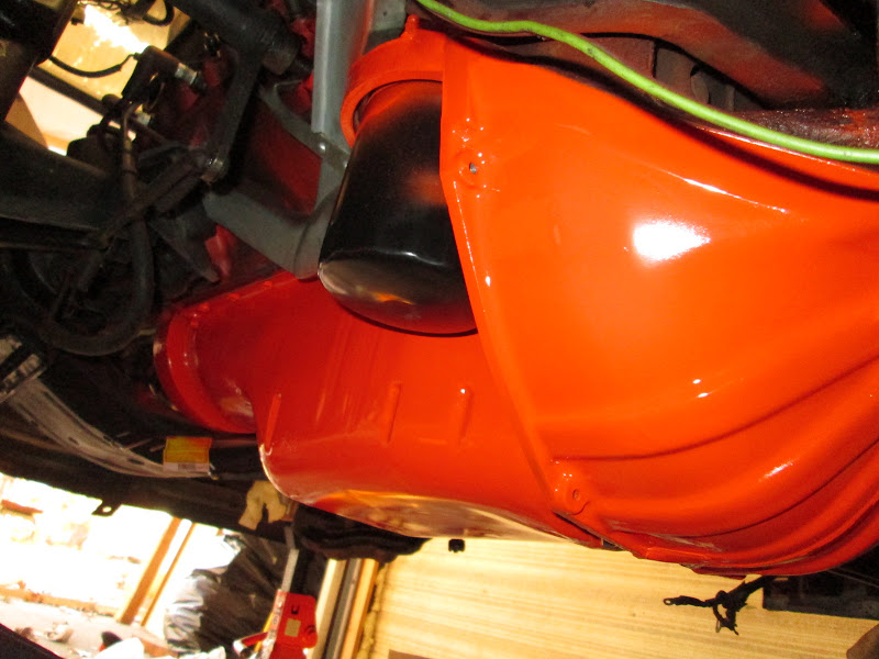

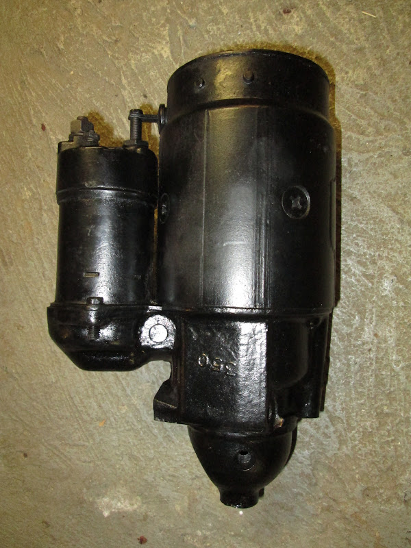

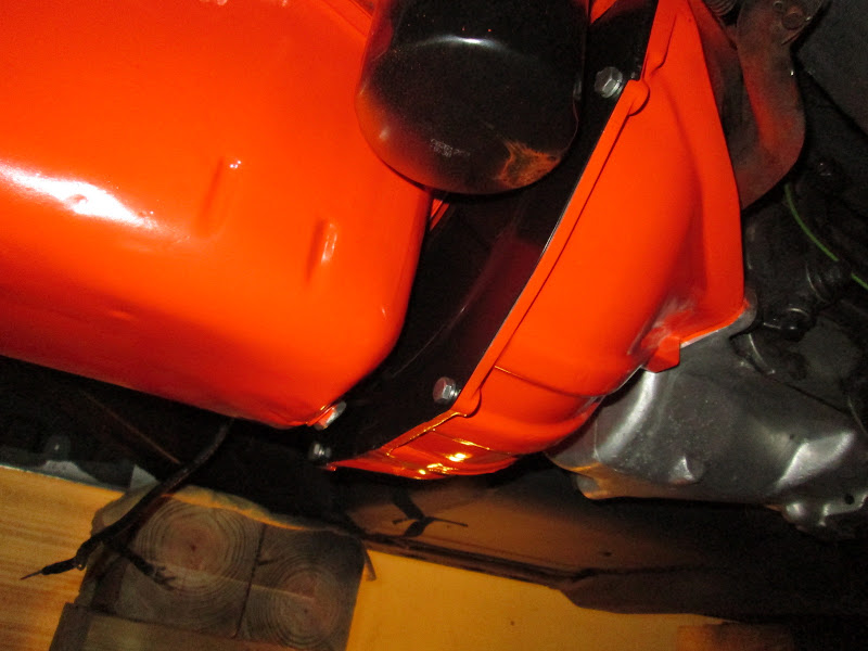

Oil pan and bellhousing finally got some paint. Also got the correct inspection cover on. Fixed some wiring while I was there...old electrical tape was breaking off.
Starter has to come off anyway for header installation so this was a good time to clean and paint. Stabilizer bar also got a cleaning and paint.

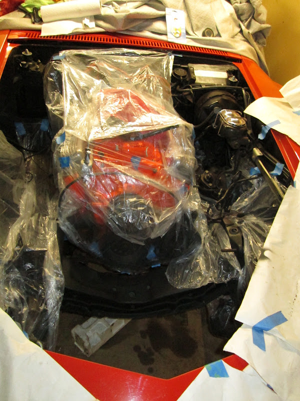

Engine finally got masked off and got some fresh paint.
Certain parts may need a touch up either when it gets warmer out or when I have the car running in order to heat up the paint. I think the under 60F temp might have caused the following or maybe it just needs to be baked with the motor on:
The orange heater hoses got taken off and heater box inspected. Will be putting in correct black hoses and I'm on the fence about shut off valves...
