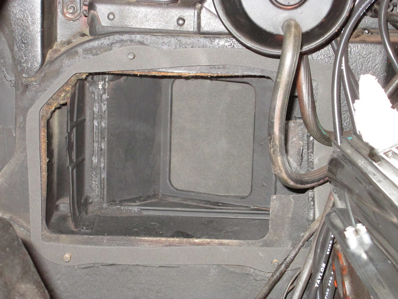

New insulation installed, heater core/box back in, new hoses installed. Hardest part was fitting the heater core back in with the new insulation. Had to trim it a little.

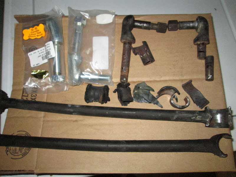

I tried to save these guys but after soaking in Kroil followed by 3hrs of heat, more Kroil, and hammering left side still wouldn't budge. Right side was a bit easier but still PITA.

nice work and great fun.i cannot believe i missed this thread.btw i got my shock supports out with a small wheel puller after soaking in pb blaster in an aluminum foil form for two days.a forum member detailed that procedure with good photos.best of luck on the restoration.

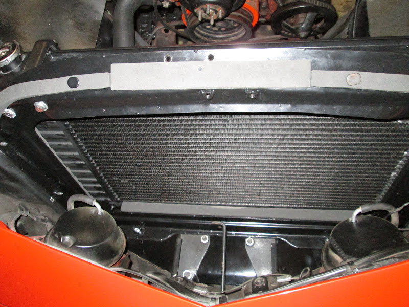

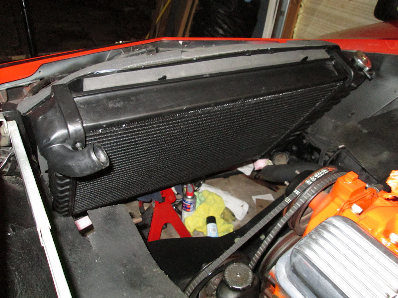

Radiator got mounted in the new core support. Front crossmember bolted up, radiator and core bolted up. It was a tight fit, did not need any shims. The only issue was that the core support holes and the front crossmember holes did not align exactly. Had to enlarge the crossmember holes a bit.
