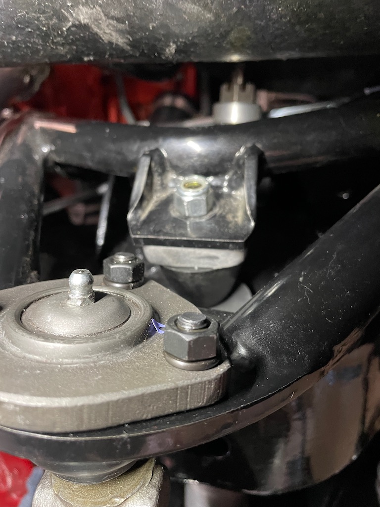

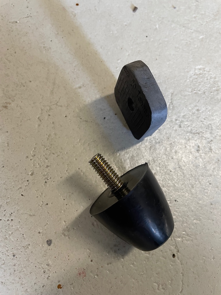

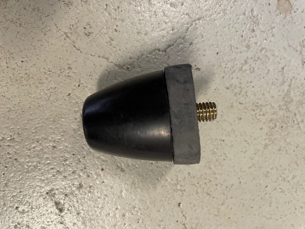

Given I am using a shorter coil-over body for lower ride height my top mounted bump stop needs to be moved down a bit so I made some spacers to ensure that the bump stop is hit before the damper body hits full extension.

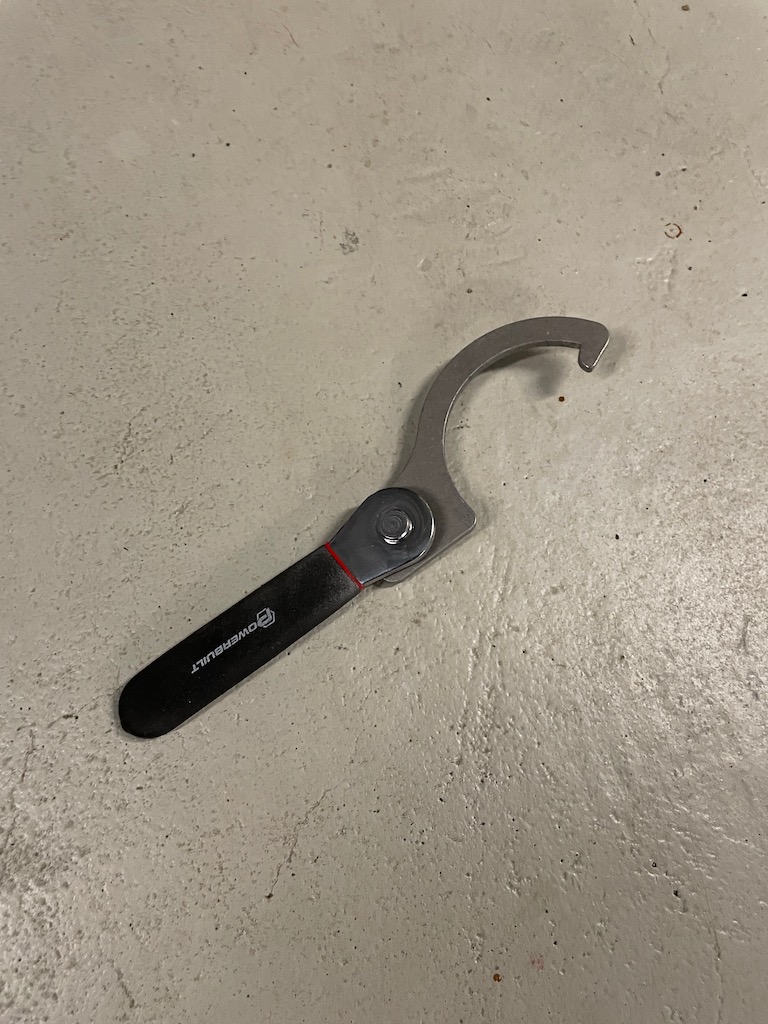

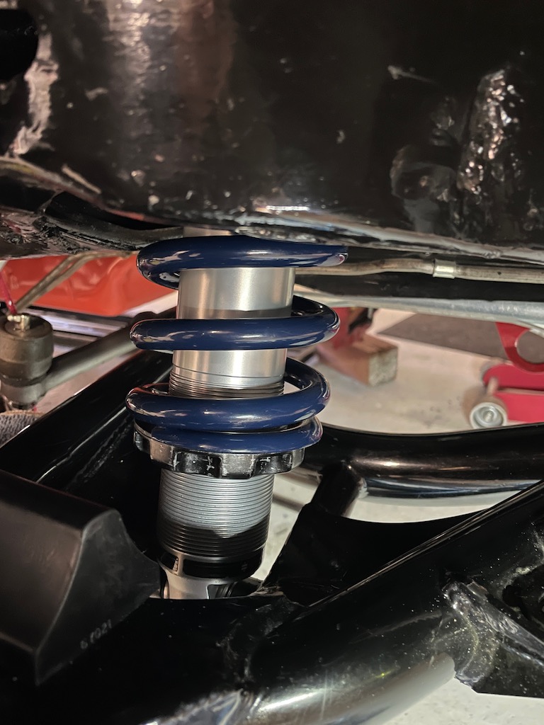

The Ridetech tool to adjust the coil base needs a 3/8" handle to give enough leverage.
At zero pre-load there is about 1/4" up the threads showing below the adjuster.
Before attaching the bottom pivot bolt I wound each coil-over up to where about 1 1/2" of thread was showing. I did it this way as its easier than when they are attached.
At this level I have about 1 1/4" of preload and from some testing that sat the front roughly at a good starting point with the 500 lb springs I am using.

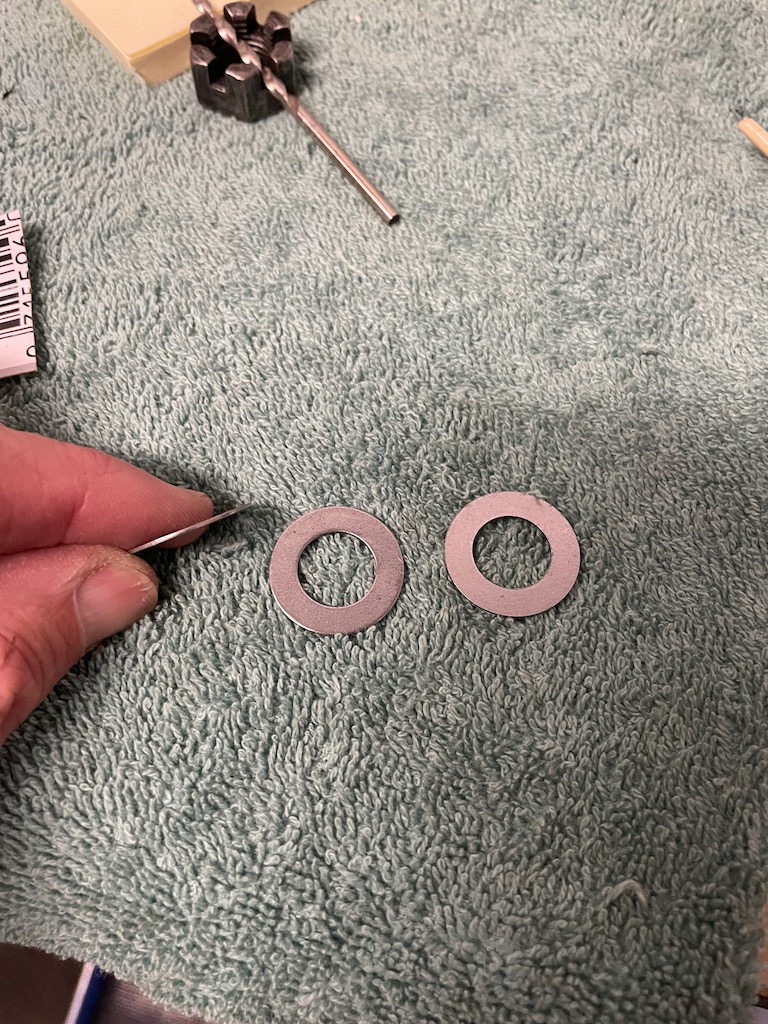

With the Global West arms I found I needed 3 shims to properly fit the bottom bolt nice and snugly.

Even though my testing showed no contact between the coil-over top hat and the hole in the top of the spring pocket other members have needed to trim it to some extent.
What I decided to do was to trim the hole so it was more even with the spring pocket top, so not offset a bit to the outer side.
Rubbing may have occurred if I was running longer body coil-overs (as per stock offering) as it gets closest at full extension.
All i did was just grind about 1/4" on the inbound side tapering to nothing and result is the hole is more centred with the spring pocket.

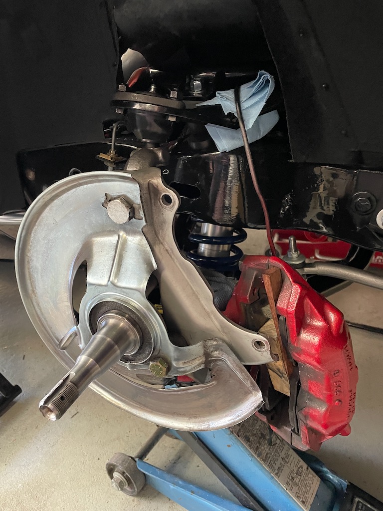

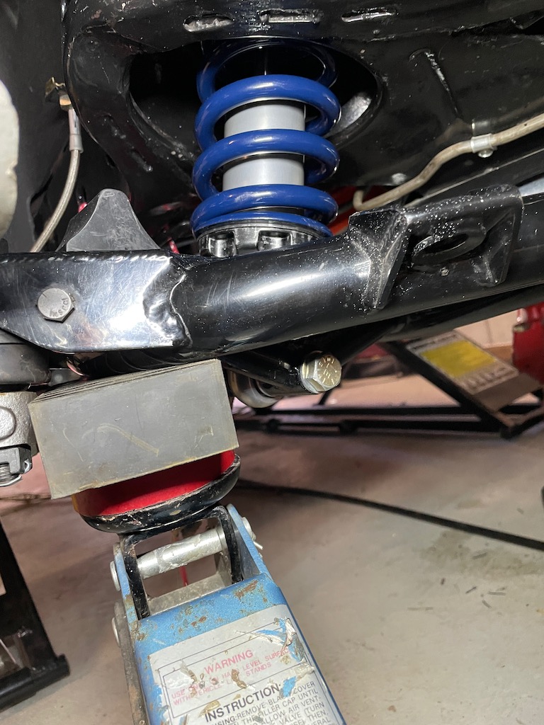

Suspension all buttoned up.
Just need to re-pack the bearings and install hubs, rotors and callipers.

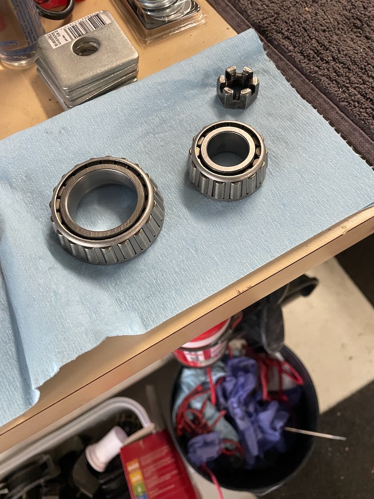

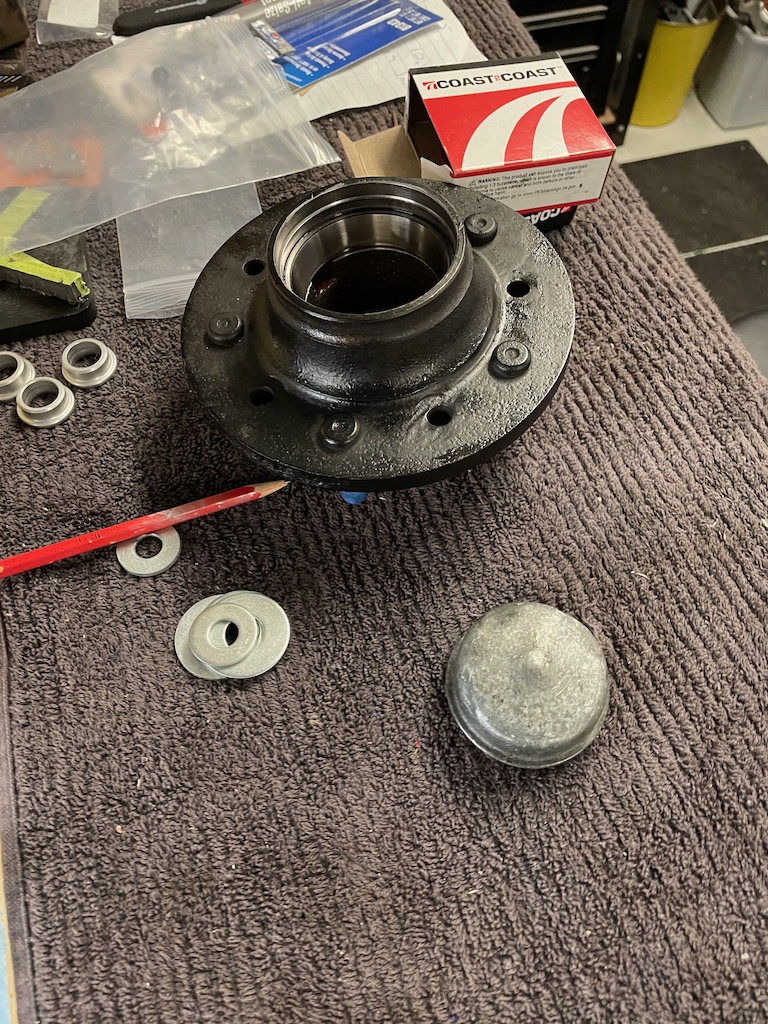

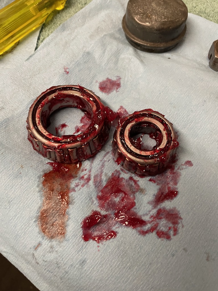

Doing the same now Craig! Is the assembly of the front bearings difficult or just a straight forward job?

Fiarly straight forward Primoz. There are some great YouTube videos on packing bearings, then seating the bearings etc with the correct amount of play.
Heaps of threads on here about the process as well.
I only decided to do it again now as I had it all in pieces.

The front bearing is a straight forward job except that on a C3 it's tightness controls the runout of the disc brake rotor. It must have some runout, it cannot be run snug. On a normal car, the backing off one flat procedure works fine, but on a c3 often produces too much runout for the solid mounted calipers. So some experimenting, or shimming, or nut grinding may be required to get a low runout #.

So finished up bearings, brakes etc and took the 71 for a test run.
Very smooth but a few rattles at lower speed bumps. Not harsh at all, with dampers doing an excellent job to handle road issues.
Took its home and looked for the rattle and found the top mounts had backed off a bit or had fully seated after some use.
Tightened them back up to 80 inch pounds and back out again.
This time no noises just a nice controlled smooth ride.
It is sitting a little low at 26 1/16” to wheel arch that will need to be adjusted up a bit.
Is it better than the semi coil-overs…..yes, certainly noticeable difference and I no longer have some of the suspension noises and harshness over speed humps and etc I had before.
Was it worth the extra $$’s, yes because it put a smile in my face with how it rides.
The Ridetech dampers seem better controlled than the QA1’s they replaced , even though they are single vs dual adjustable for the QA1’s
Will need to do some more playing with settings but this is first impressions, so you can get your Christmas letters to Santa in 😀.
