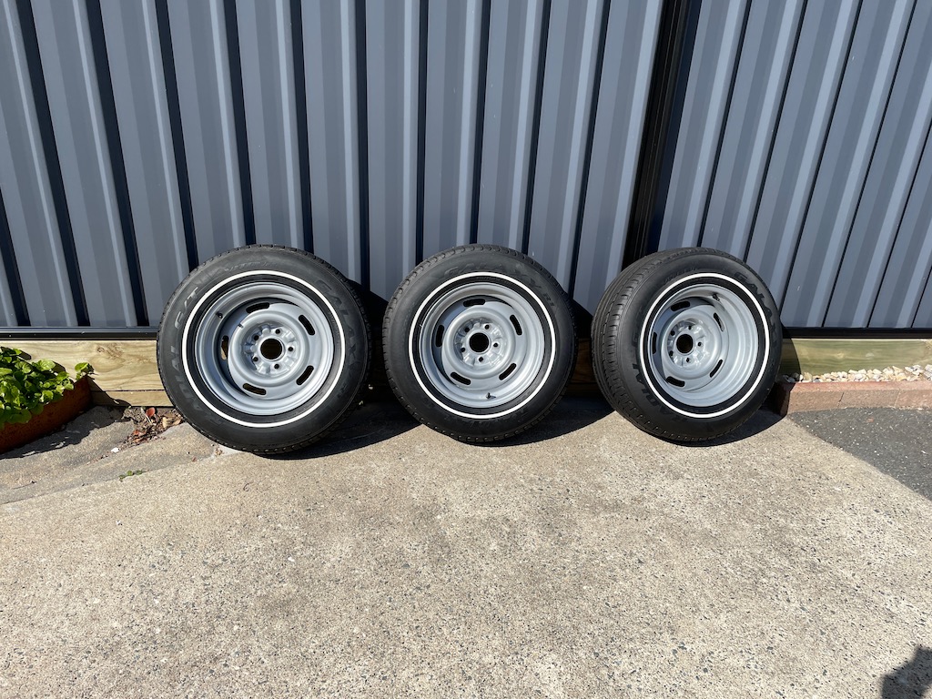

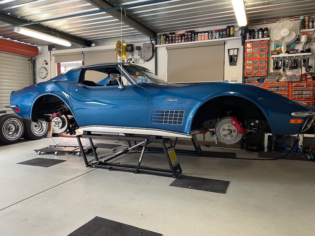

Finished the other tyres off today
Will try and fit them up during the week.

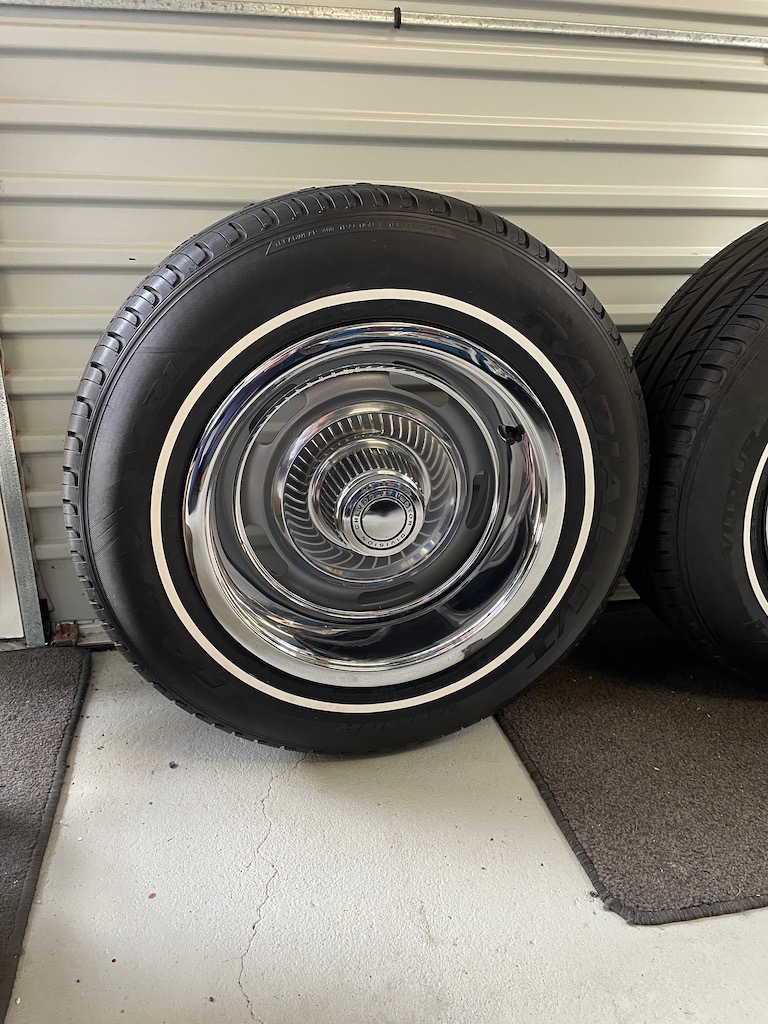

So am I danthony, I have been reviewing so many period pictures and the thin stripe was a popular option back then.
Cleaned them up and put the trim rims on.

Thanks Doc, had driven on these tyres for a while while I was working on the suspension and they are smooth and have good grip (for a 215/70r15). Hope they look good with the new heights I have set for the 18’s. We will see 😀

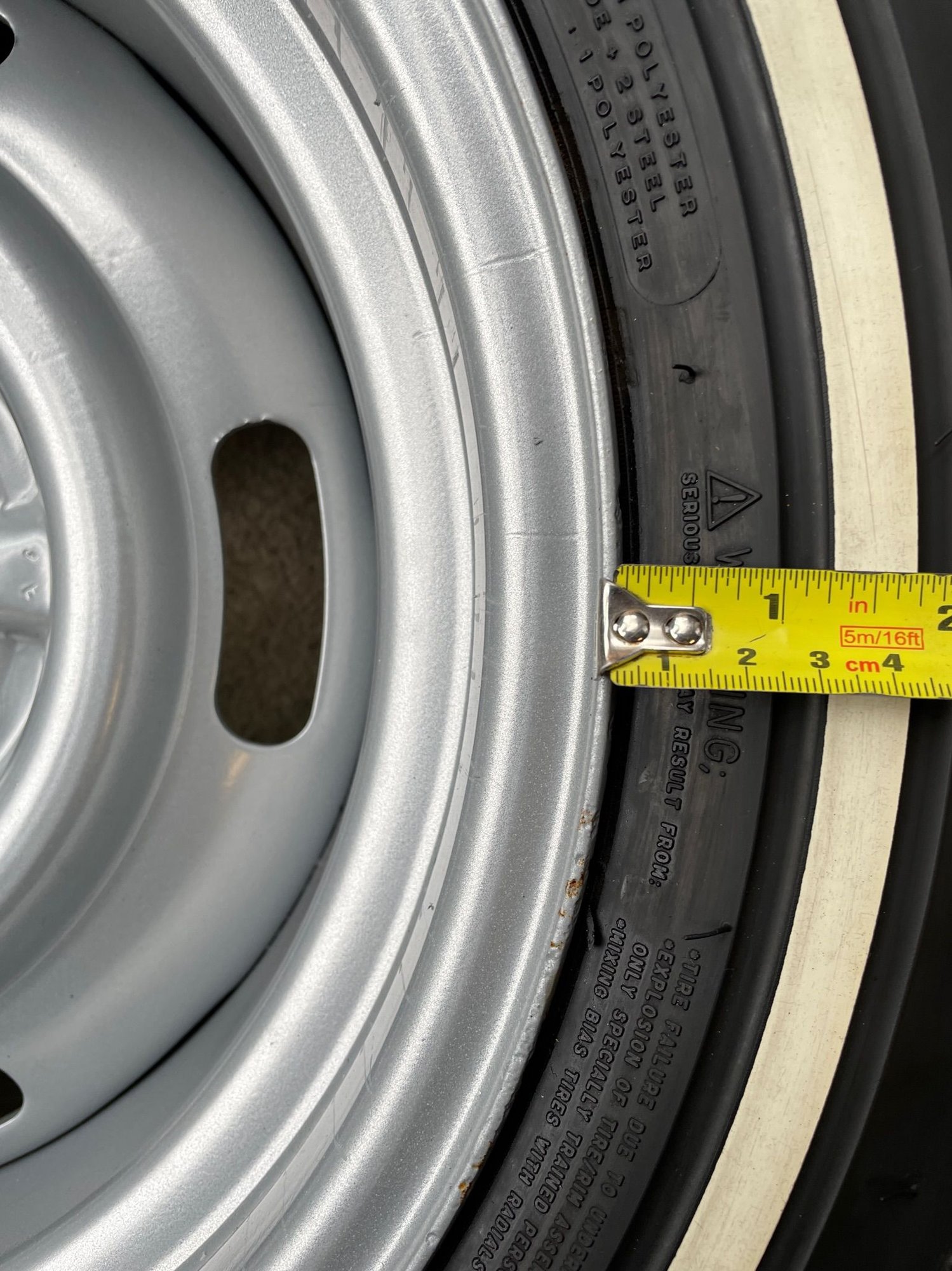

I am sure this won’t surprise anyone but I did some measurements of my old Michelin white stripe tyres before they came off a number of years back.
The new stripe is about 3mm off the original ones placement, close enough 😀

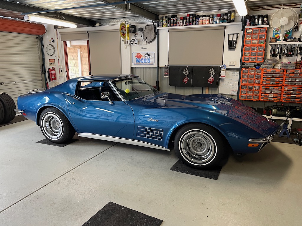

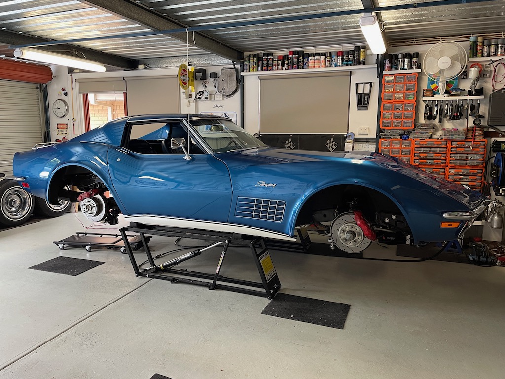

Swapped my rims over this morning
Gave it a good bounce but its raining so could not take it for a run to fully settle the ride height but based on past experience only the front will drop a little bit.

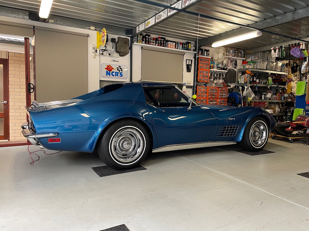

Old Aug 18, 2024 | 10:29 PM
  #2073
CraigH's Avatar
CraigH
Joined: Apr 2010
Posts: 2,795
Likes: 1,196
From: Canberra Australia

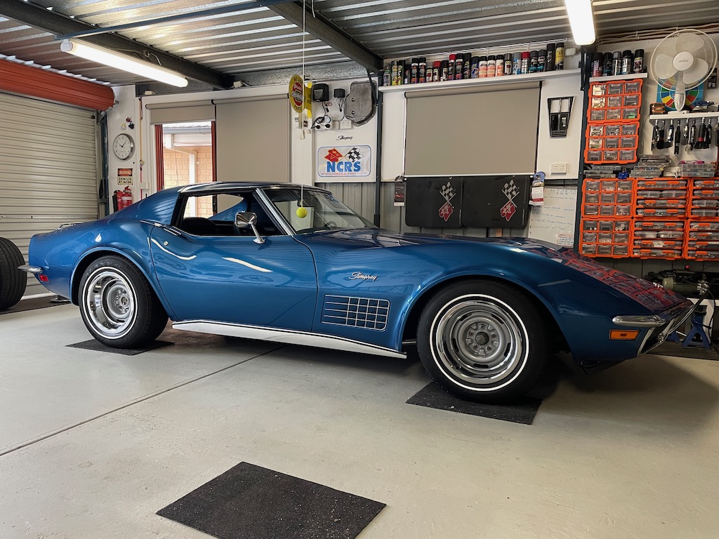

All up I am pretty happy with how that looks, nice classic styling.
The drive is not as sharp as with the 18's but still handles beautifully.
I thought a belt was squealing a few times then realised the 215's don't break grip the same way

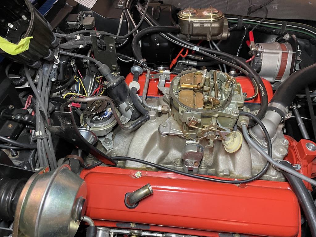

So I have been playing with the tune of the Vette
Testing what it was already, base + vacuum advance etc, and realised the vacuum advance was pulling way to far and the mechanical advance springs were very weak and coming in far too early.
I found a B20 advance unit I had and it was better but still too much advance so I made a small plate to allow adjustment of how far it would pull. I mocked it up on the B9 unit.
Should be able to test it out tomorrow and see how it goes.

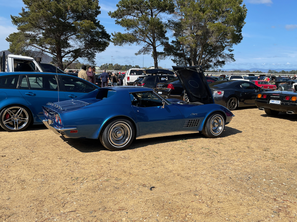

Went to a Cars & Coffee event here today.
Best turn out so far, over 1300 cars and bikes. Took over 40 minutes to get in the gate with traffic.
