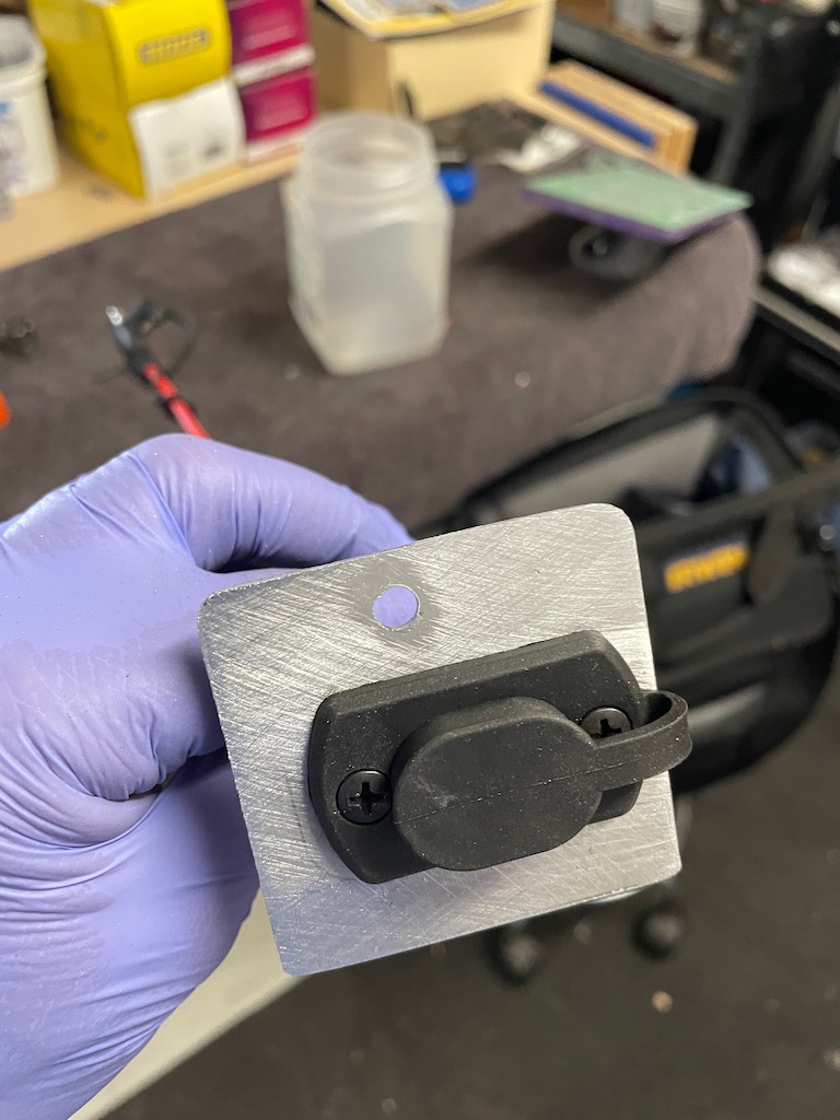

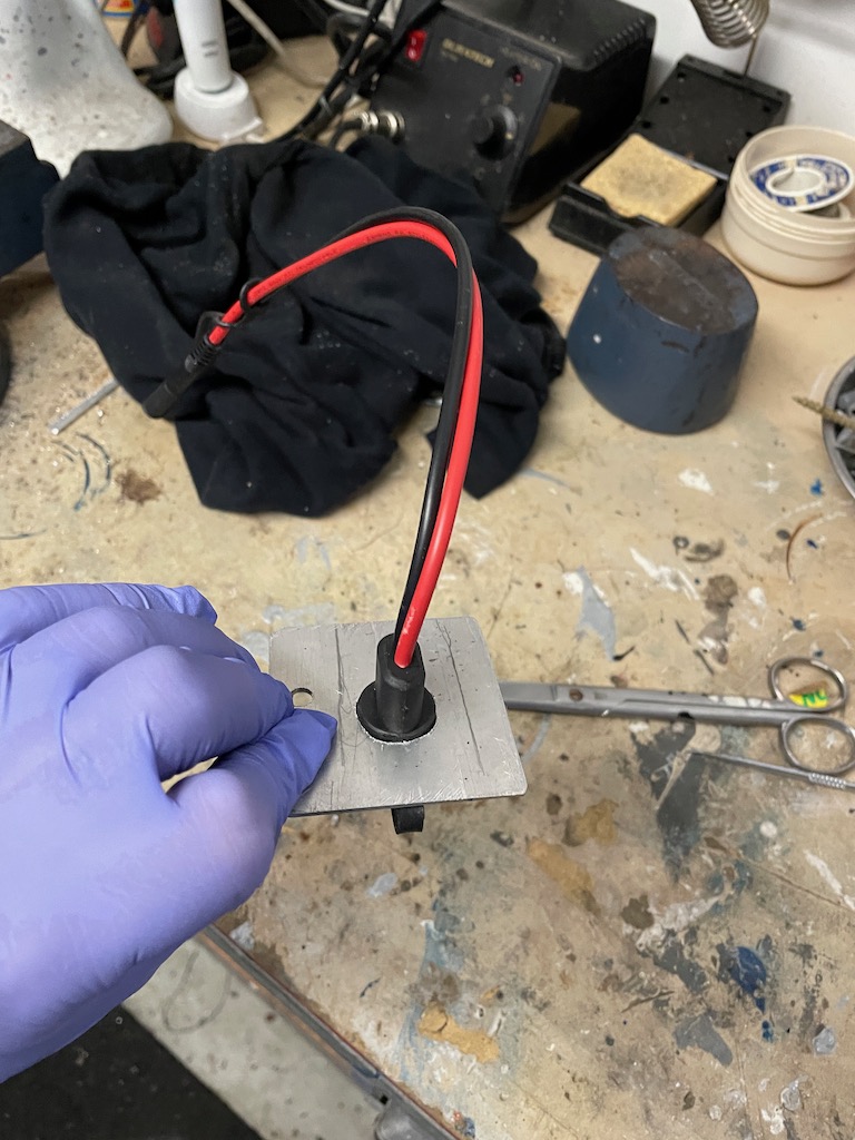

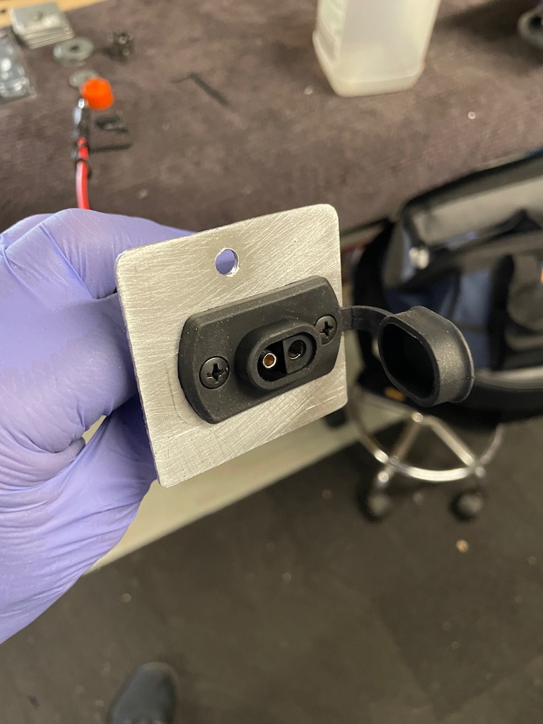

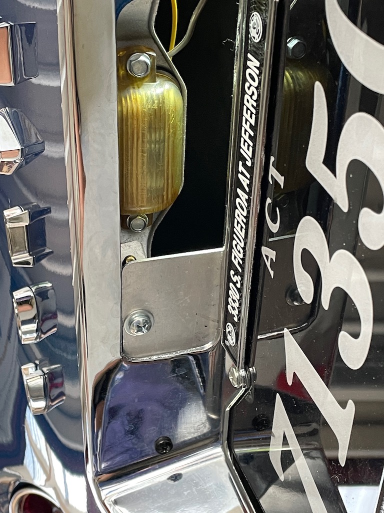

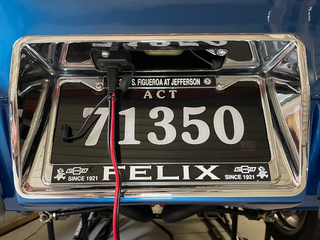

There was a discussion a few months back about wiring up your battery tender so I decided to move mine from the wheel well to the rear number plate.
Found a covered outlet on Amazon and perfect spot to place it. I think Alan (RiverRacer) put his here.
I thought about cutting and mounting it direct to number plate frame but thought that was overkill and may degrade chrome finish over time.
Uses existing fixings and is solid so won't move when plug is put in or removed.
Just needs to be painted, fitted and cable run to battery.
I tried running cable inside rear part of frame but it seems to be blocked about where the rear diff crossmember attaches.
Will sort that out in a few days.

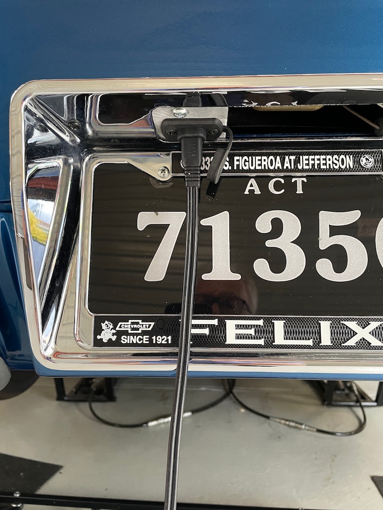

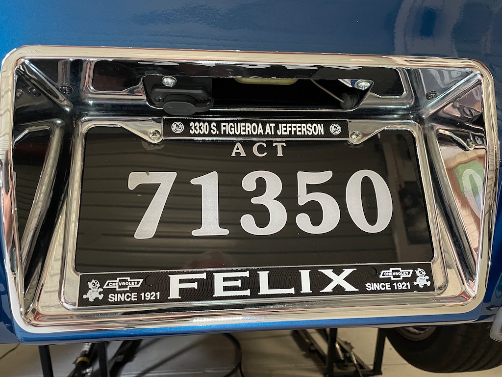

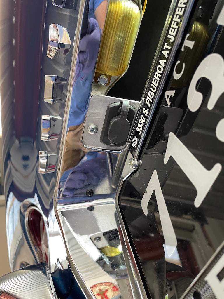

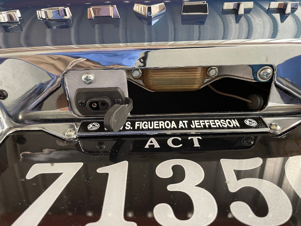

Finished it off today. Painted and baked the panel ran the wires through the frame where I could then behind it to the battery box.
If you look from underneath its pretty much hidden. Shame I could not get all the way in the frame.
Vette is charging away.

What if you redid that mounting bracket with a z bend right after that mounting hole? Couldn't you then recess it in a bit?
Not looking at the car. So maybe there's no room up there. Just thinking.

I tried that first Doc, but did not leave enough room to mount the socket.
Also thought about putting it under the tail light bracket but then I don’t get the chance to lock it between the glass and the number plate frame, that gives it a more solid mount for constant plug …unplug.
I am taking these pictures from below the number plate, when it’s on the ground the socket is not visible at all.

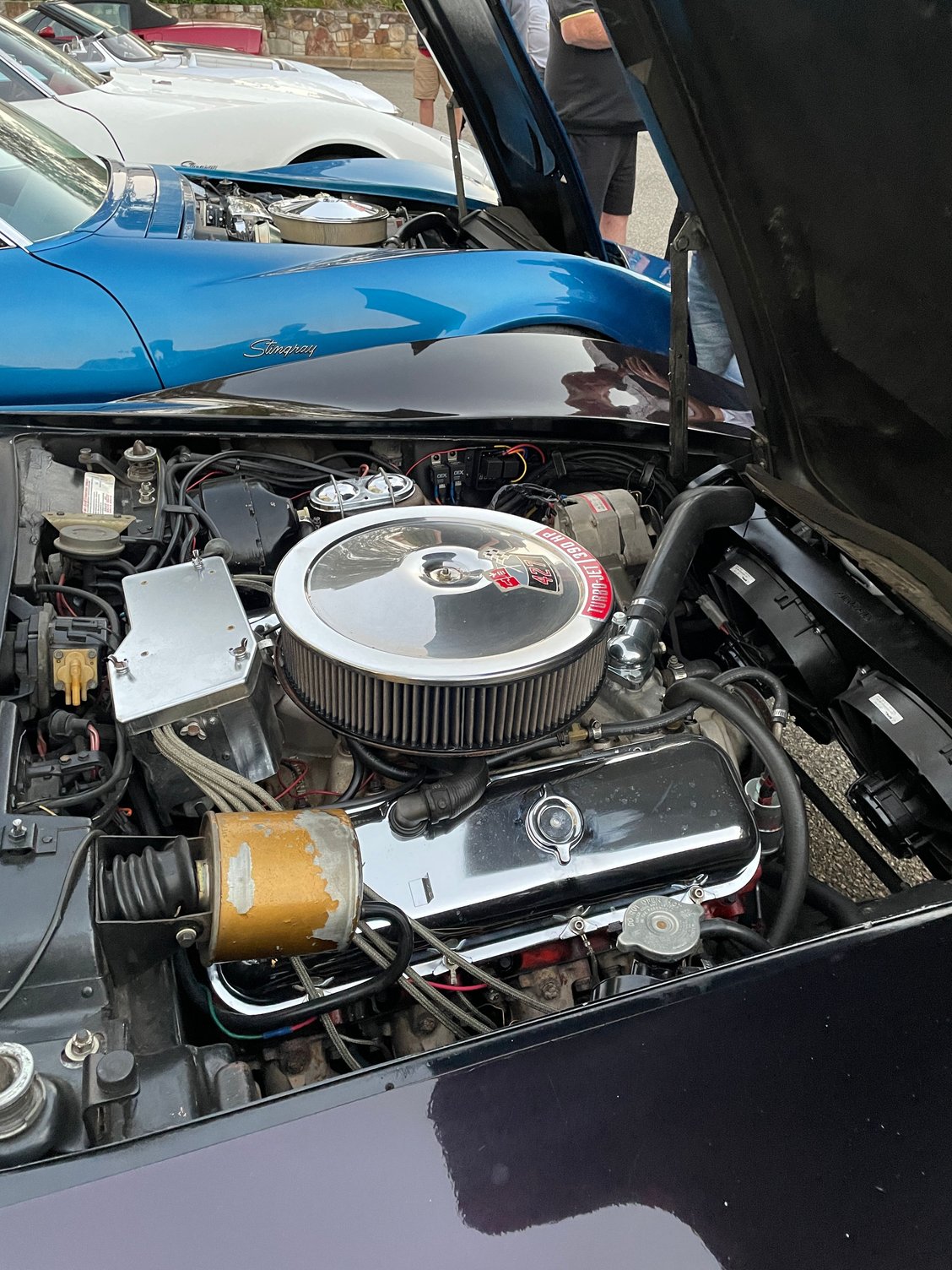

I could not attend today or Sundays events but I saw these posted just now from today’s drive to Araluen, a small country town. A couple of hour drive each way.

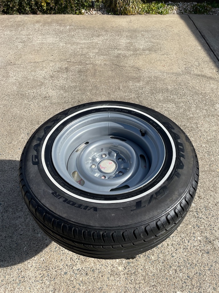

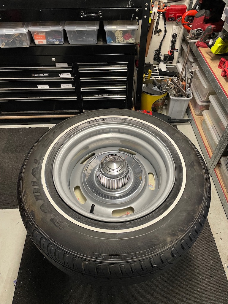

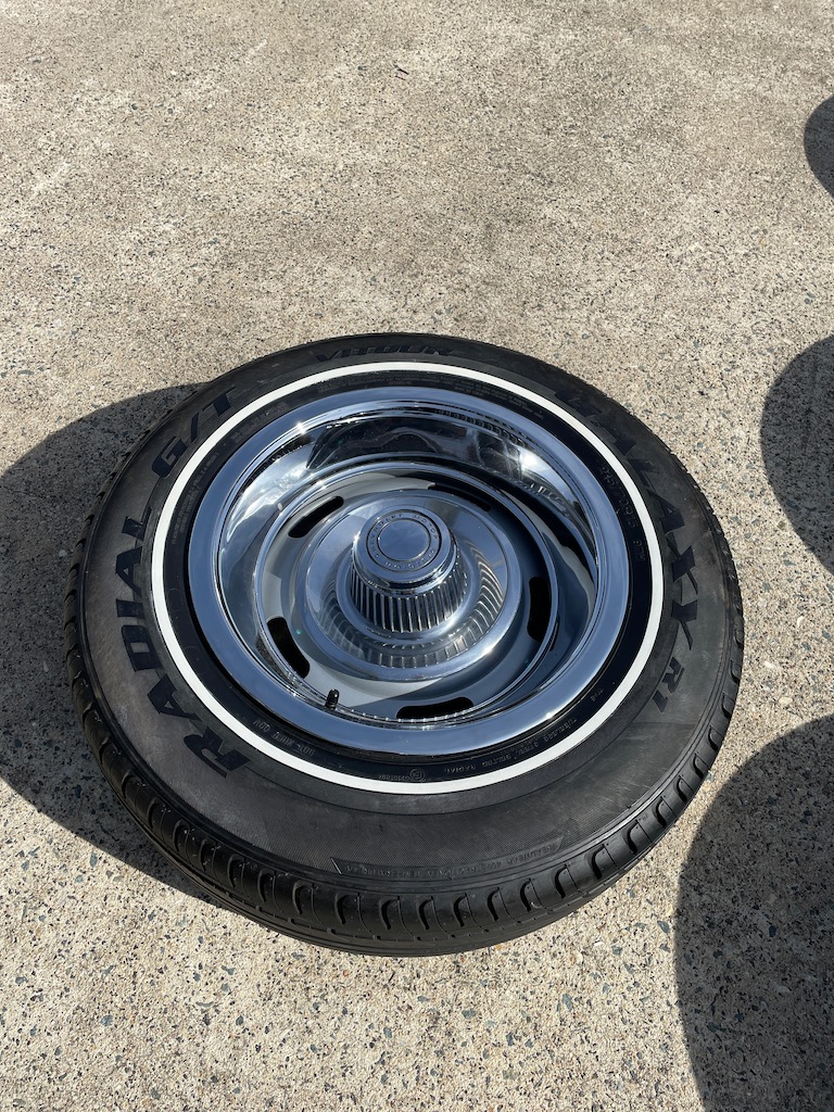

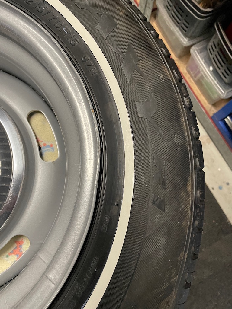

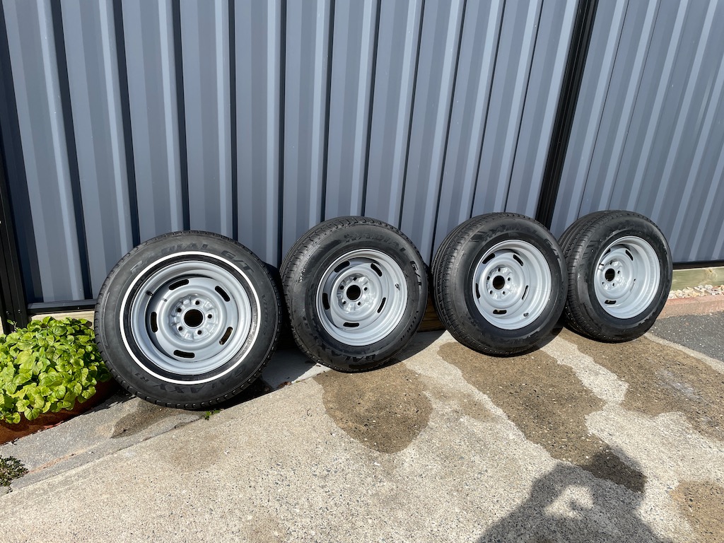

Finally got back to doing some Vette projects.
This is one I started a number of years back when I purchased a test white stripe off TredWear.
It sat on my shelf till I saw Rescue Rogers do his red stripes then I purchased a full kit and also stored it on the shelf.
Given my original white stripe Michelins were too old I needed to have an alternate set of original style wheels and tyres for the classic look. I started with white letter but then decided I wanted white stripe so I reversed the tyres.
Well today I decided to give it a go.
Starting with one wheel I thoroughly degreased and cleaned the area where the stripe was to be attached then sanded it with 150 grit to give it a surface to bind to, then apply the glue in 6" sections and stick it to the tyre. Luckily these have a perfect line to run it against.
One test done and all cleaned up and I was happy with the looks so I cleaned all tyres ready to do them in the next few days
