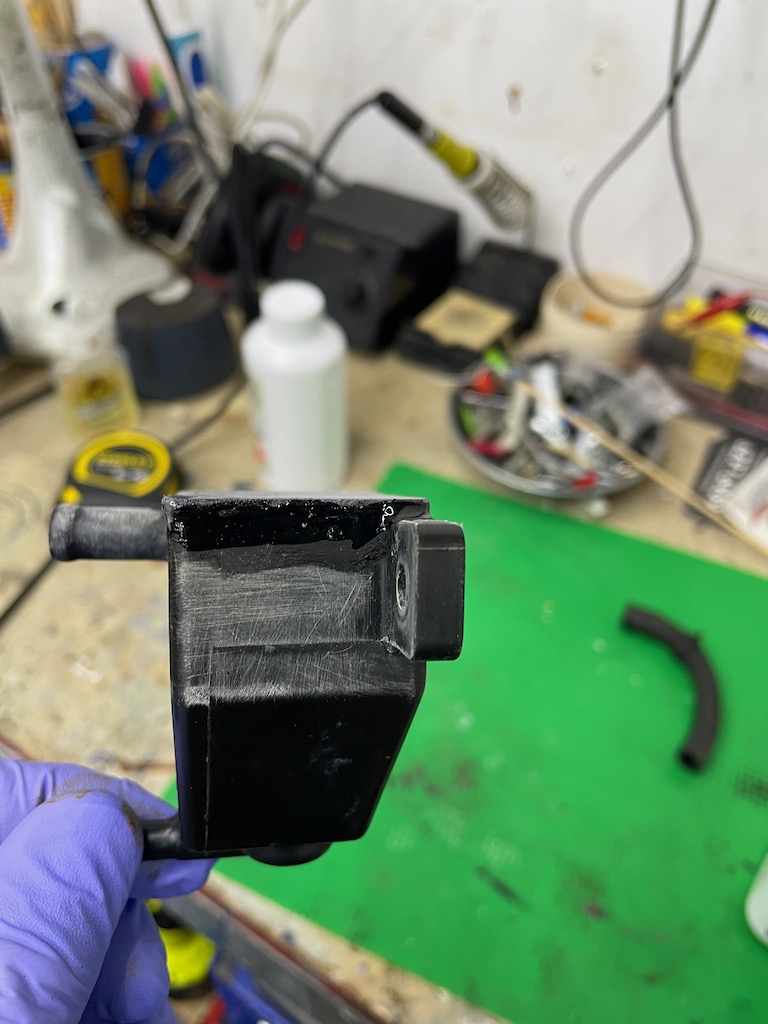

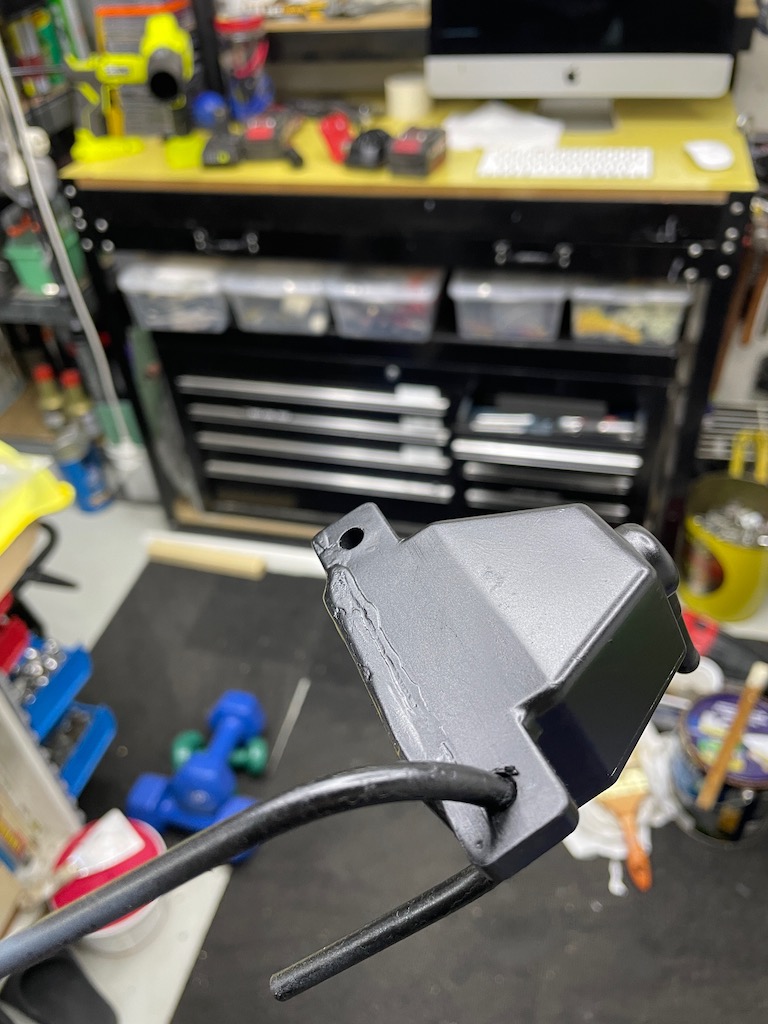

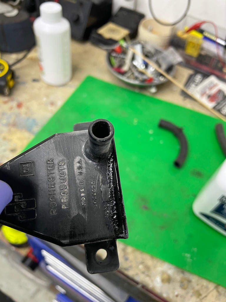

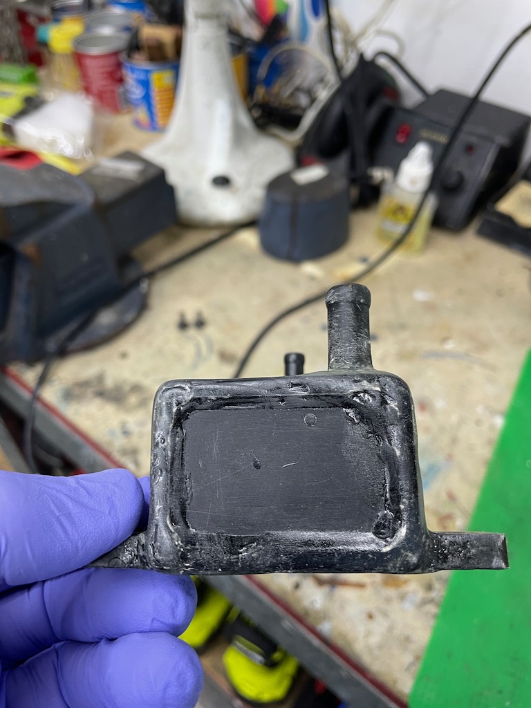

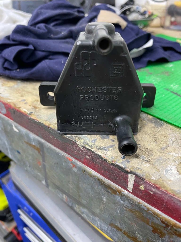

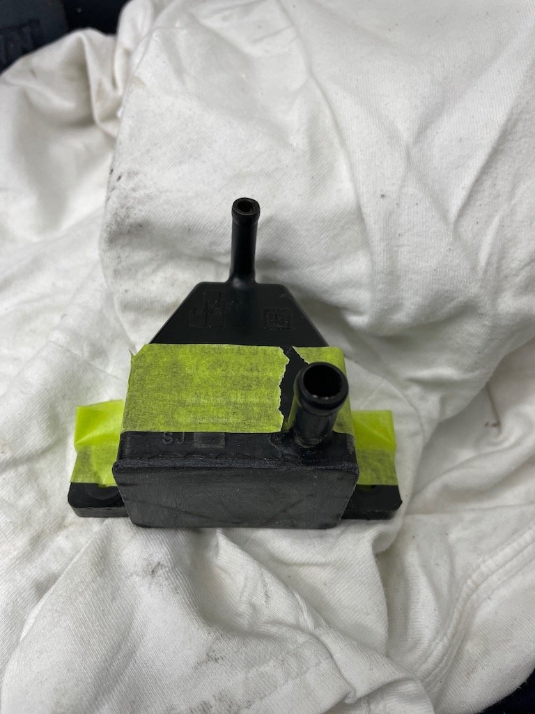

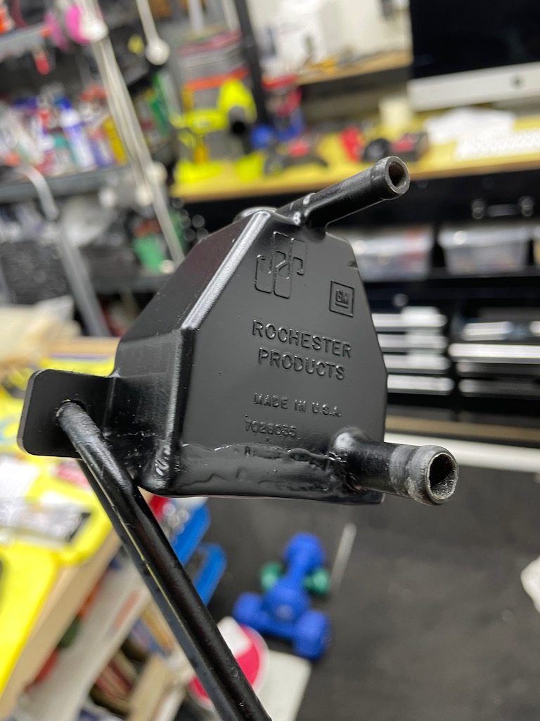

So I took the Vapour Seperator out today and you could see how the factory sealant had started to come apart near the bottom edge allowing some fuel to weep through when any got into the separator.
The bottom appears to be glued in and then appears to have been dipped in some sort of sealer to cover the joints that has only lasted 50 years.... :-)

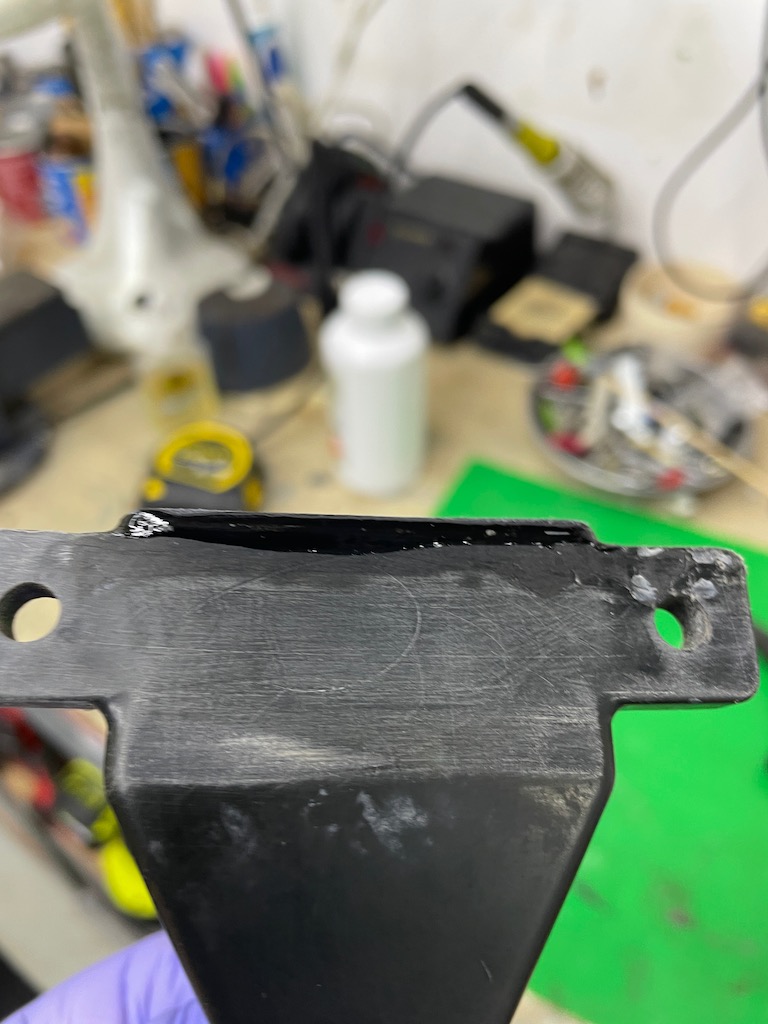

So I sanded the bottom 10mm of the casing to give something for the epoxy to bite with then masked it up.
Applied some JB Weld epoxy around the bottom edges and onto the bottom of the case.
Not very pretty but I hope it will stop the fuel weeping out.
Just need to paint it all satin black and fit it up with new hoses etc.
if I was to do it again and want it to look more like original I would possibly mix up some epoxy resin and dip the bottom.

Ya know I really like JB Weld for a lot of things. However, I'm questioning if it's actually a good fix on a fuel separator.
Food for thought.
Food for thought.

Yes I did read that tank weld may be better for prolonged contact to fuel but in it’s doco it states it’s not recommended for plastic.
I found some older posts where they used JB Weld and it was holding up 10 years later.
Will need to monitor it.
Its a shame from reading feedback the reproduction items all seem to leak.

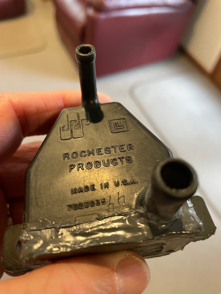

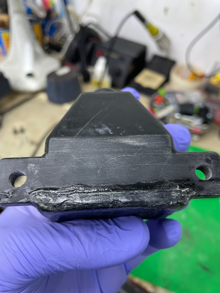

Take II of fixing the vapour separator
Step 1 remove all the JB Weld.
After the JB Weld was removed I inspected the bottom seal to see where fuel had previously leaked.
Step 2 re-bond the bottom to the sides of the canister with gap filling thick CA. (High Fuel Resistant)
Once this sets up I will run a bead of Devcon DS220 two part epoxy (Highly resistant to hydrocarbon fuels including gasoline, jet fuel) around the bottom edge then repaint and refit.
I feel a higher confidence level with this method.

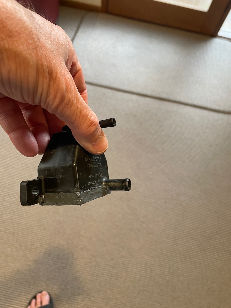

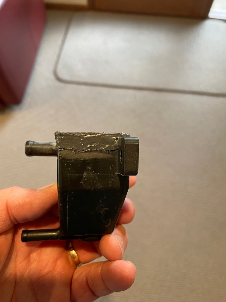

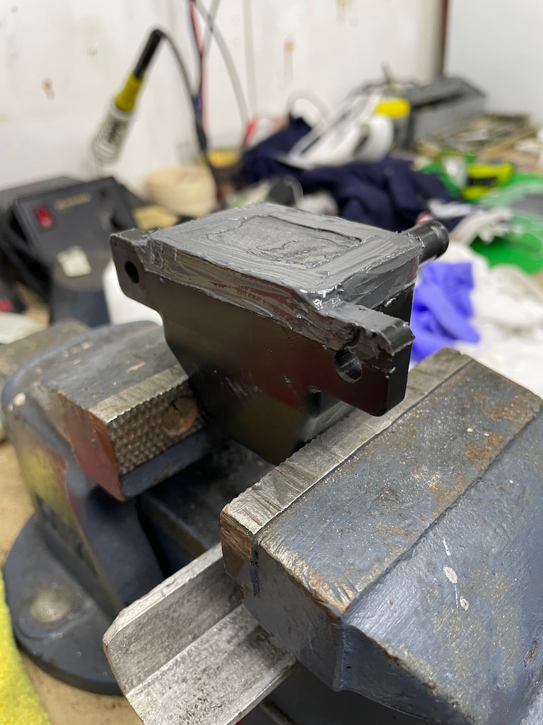

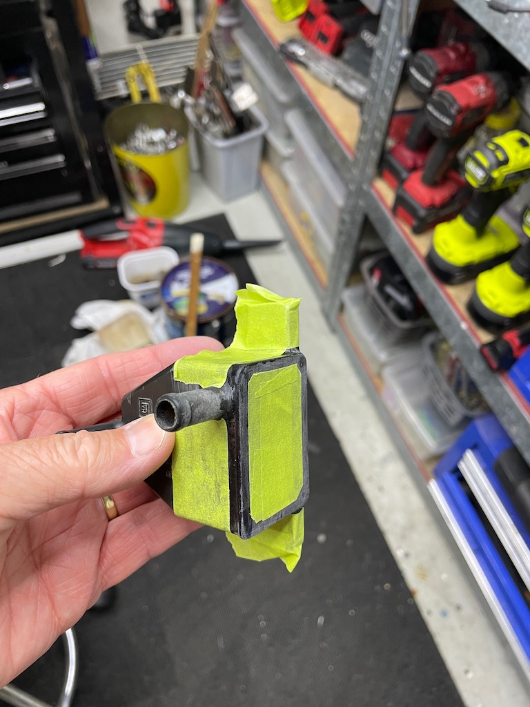

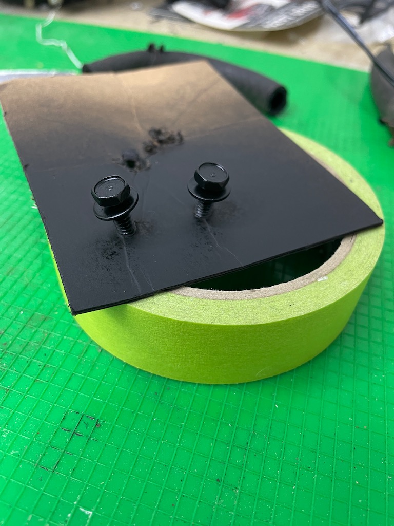

Masked it all up to keep the epoxy where I wanted it.
The DS220 sets amazingly fast so hard to work it really smooth.
Once set I sanded it to give some bite and did another layer of Gap-Filling CA, Overkill I know but can't hurt.
Sanded it all again to give a better surface for paint to adhere and painted the canister and hardware.
Seems to hold a vacuum so good start.
Will put in back in the Vette and monitor it to see if it actually sealed and stays that way over time. :-)

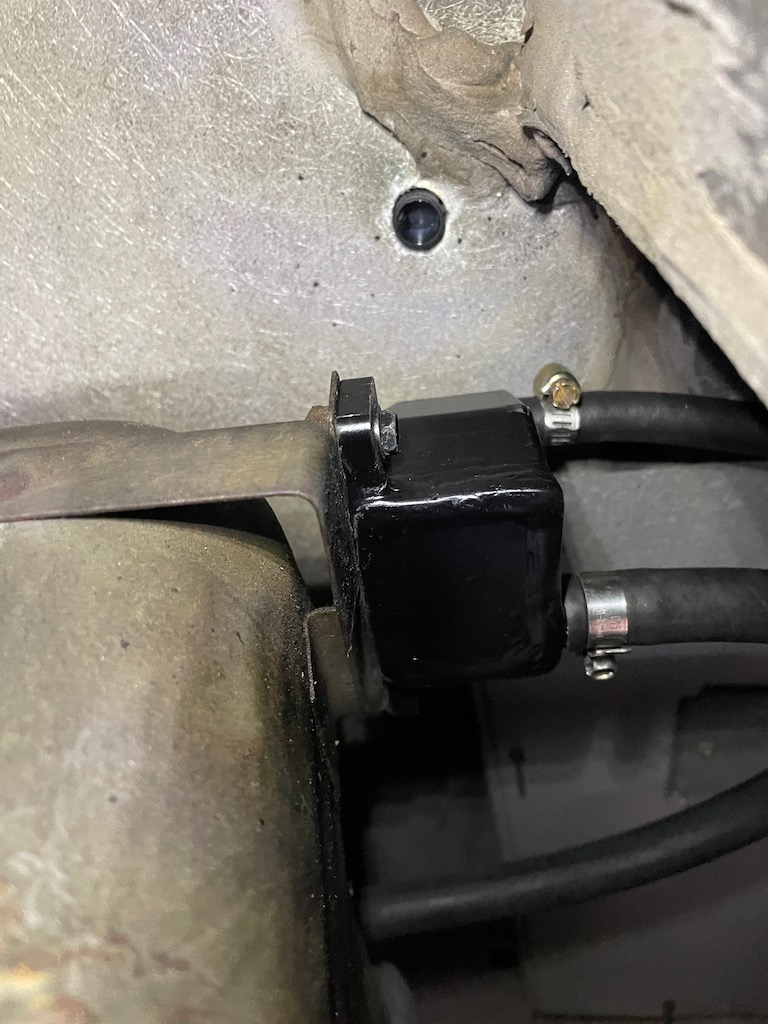

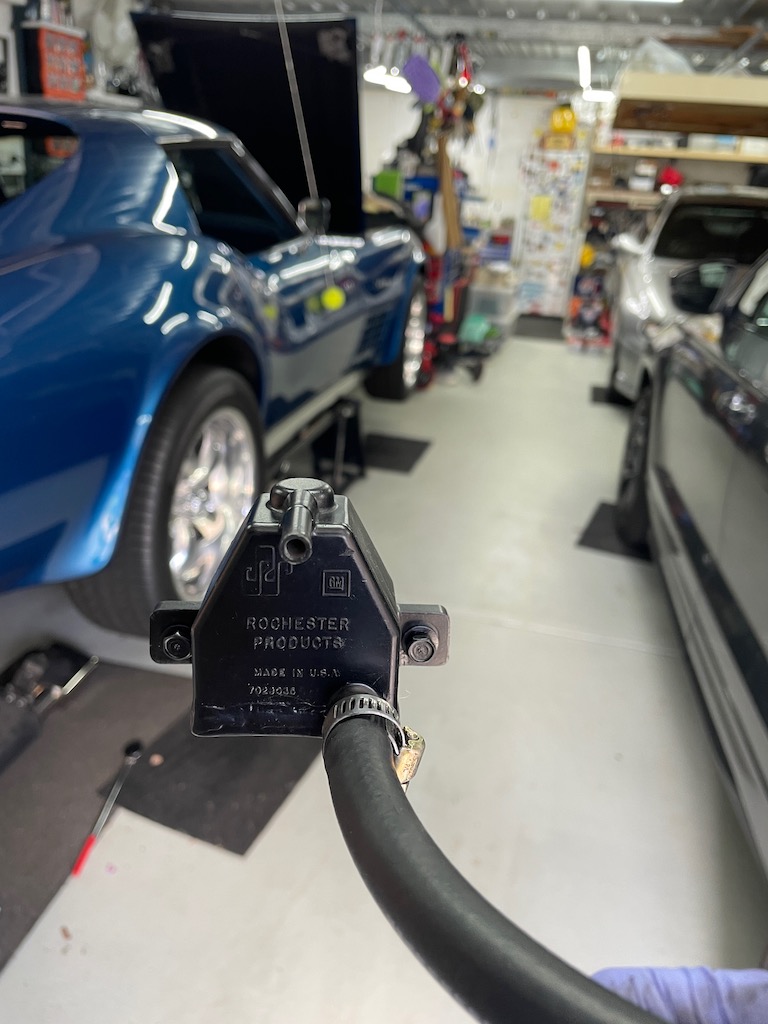

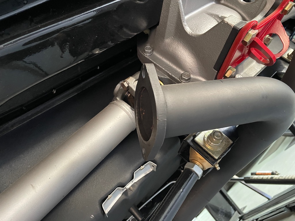

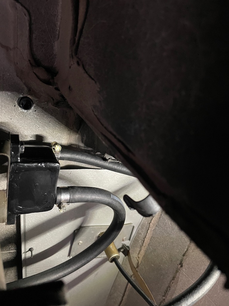

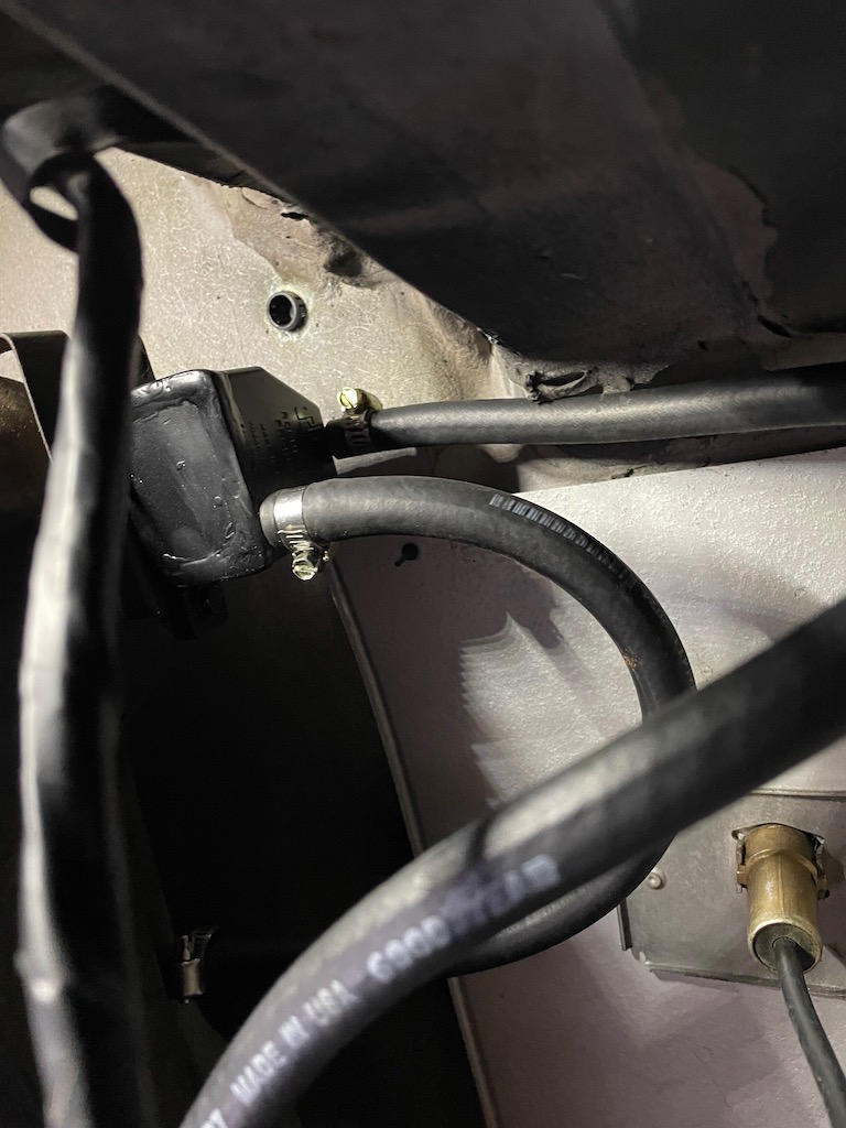

Time to finish this off and re-install the vapour separator.
After a few minutes i decided the left rear muffler needed to come off to make it a bit easier to get to.
New hoses and clamps, still a bit of a pain but went back easy enough.
The second I took the cap off the tank fitting you could smell fumes. Once all hoses were on it went away quickly.
Hopefully it will last a few more years now :-)
