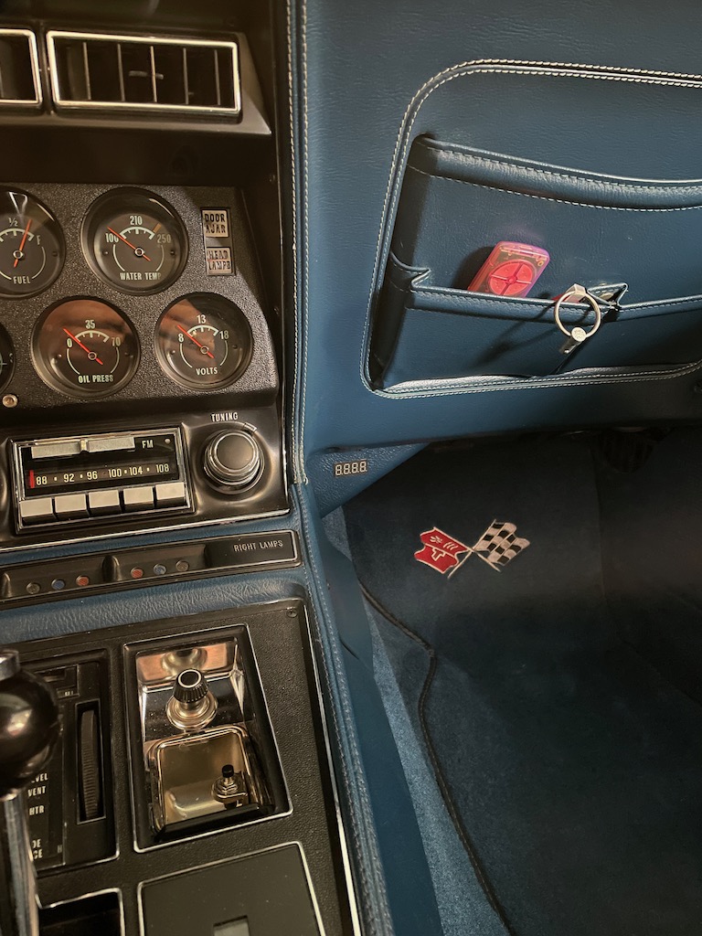

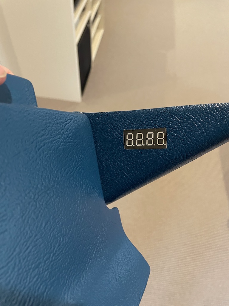

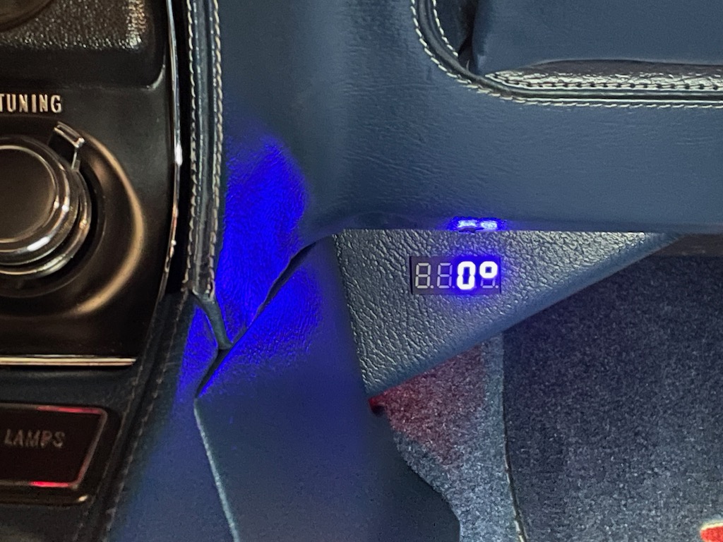

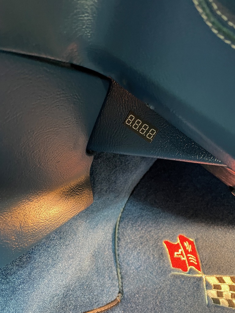

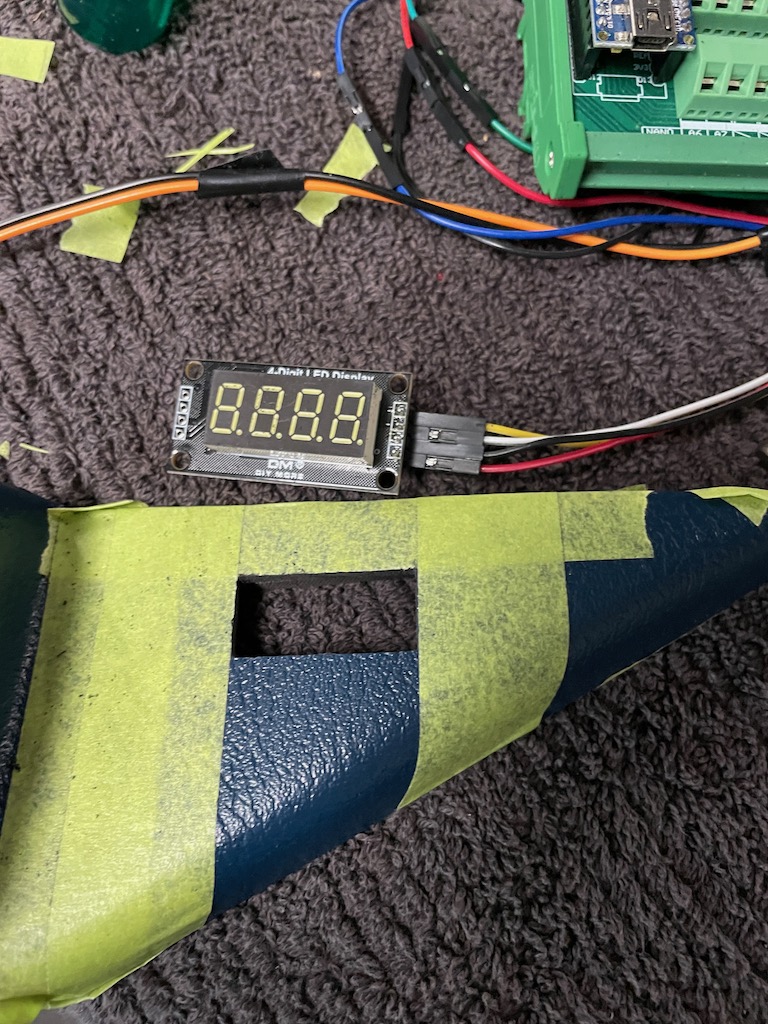

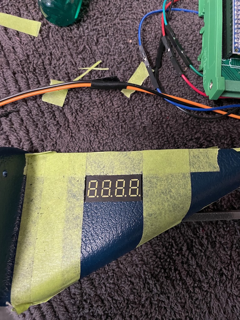

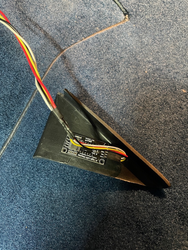

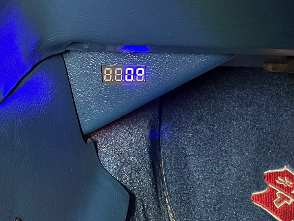

Got back onto finishing off the display mount for my PWM fan controller.
Decided to mount it in the wing of the console side cover
Will need to play with brightness etc. Can toggle it on and off from ashtray button.

Nice spot for it.

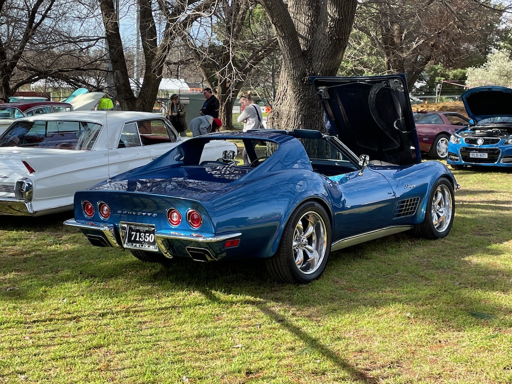

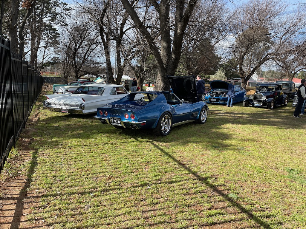

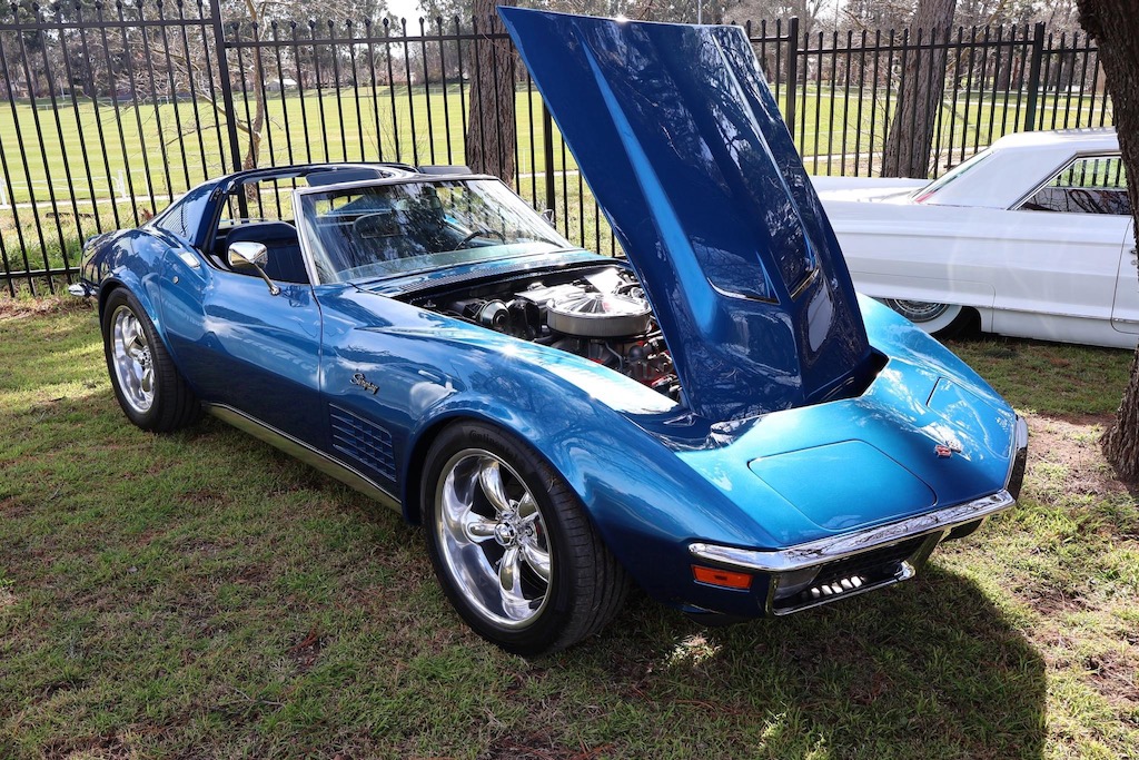

There was a American Car Club event on yesterday
One of my favourites was this clean Hemi Roadrunner

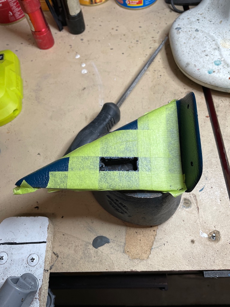

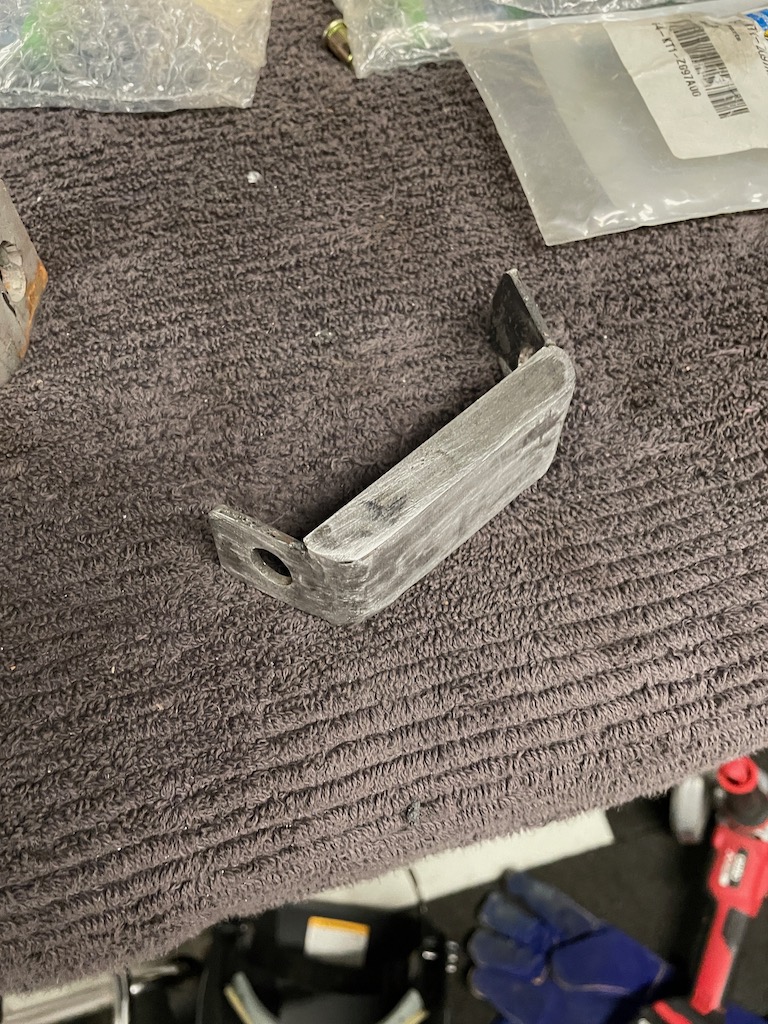

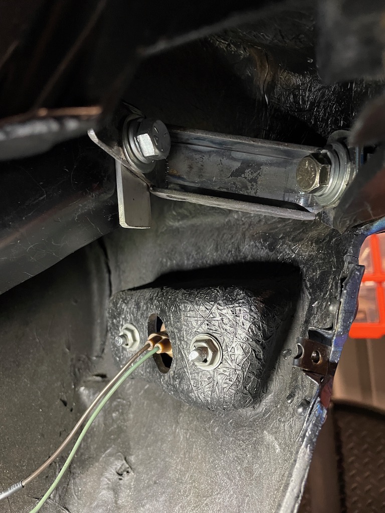

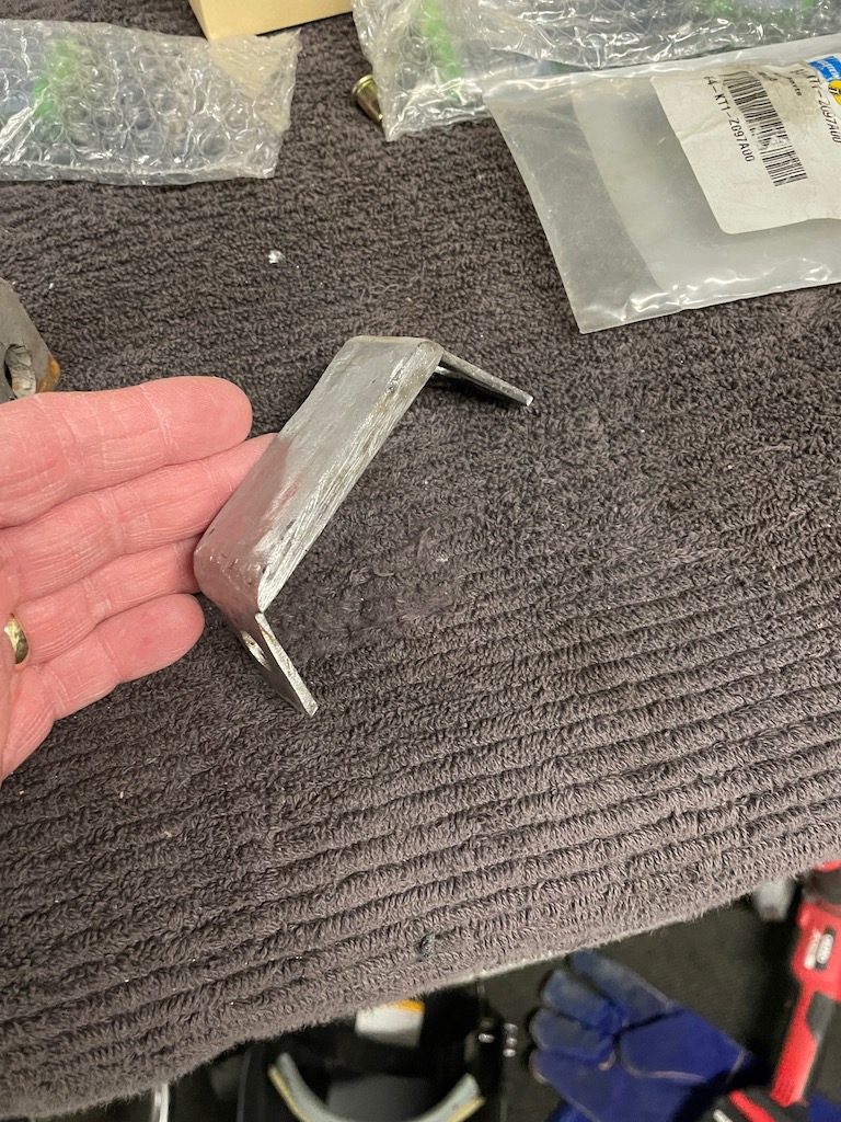

I Got around to something I should have done earlier but.....
With the fibreglass repairs to the front in the cars life and my work before repaint the two brackets between the bumper corners and frame attached brackets never fitted properly and put force on the glass if used.
So I decided to make some new ones that would be a good fit with possibly a single shim behind.
I used 3mm steel not 5 but boxed the edges. (in fact it seems to be the same thickness as the frame extensions)
Still a work in progress.

Those look nice!
Thanks, now I just need to make a second one, and I am sure it will need to be slightly different from the first, I can’t assume symmetry. 😀

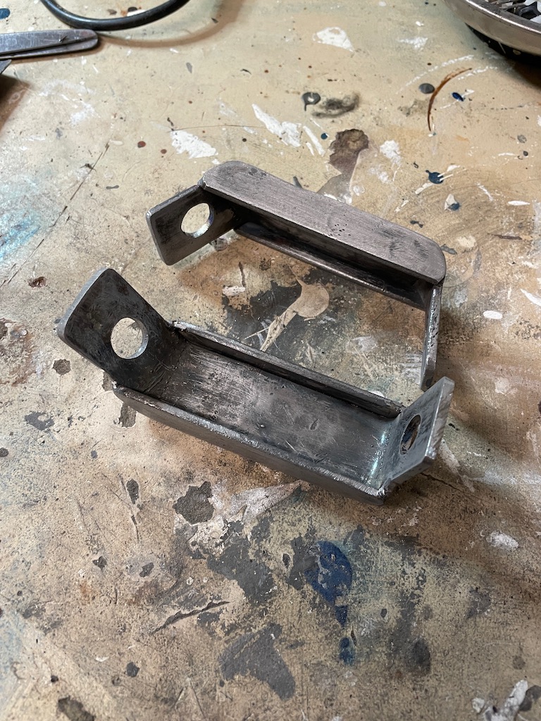

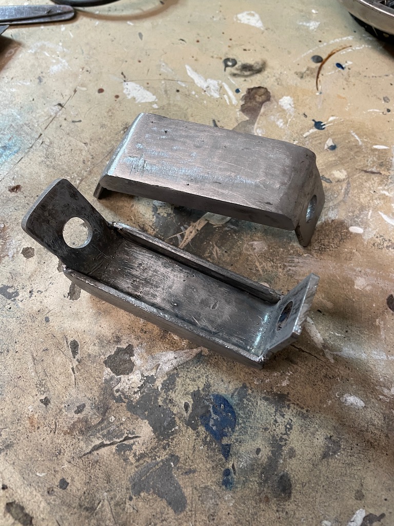

Both brackets ready for paint then fitting.
Left and right were certainly different, not even close to mirror image but the second one came together much faster than the first.

Now I am on a roll I will build new brackets that go behind the front spoiler and up to the frame. The factory ones I have look to have had a hard life with holes enlarged and bends repaired. 😀
