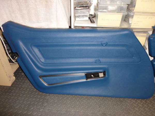

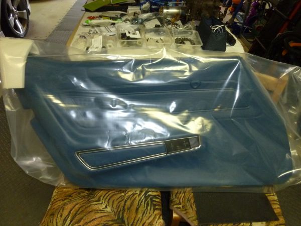

I trial fitted the new Corvette America door panels this evening for those who have been asking.
To my eye they fitted very nicely.
The velcro did not hold but I think the ones on my door itself need renewing.
All fittings lined up fine.
I intend to fit them without the upper screws as it looks so much neater and the top is held in tight by design.
My comparison is my existing panel that are aftermarket.
They are not the same molds so not sure where the set on the car come from.
Are Al Knock ones better, possibly but I am sure they cost heaps more and with 10 or 15% off at Willcox at present !!!!
Will fit them up properly next year when I re foam the seats and add new leather covers.
I refitted the old ones :-(
Here are a few shots

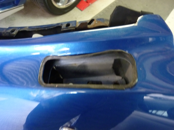

Have driven the vette a bit at night recently and the lights are ok but could do being a bit higher to give more throw. So I decided to adjust them up using the garage door as the measure.
Well one thing leads to another.
Also the passenger side light did not sit up tight so I spent some time adjusting it so it locks up nice and tight.
Will paint the buckets tomorrow and finish them off.
