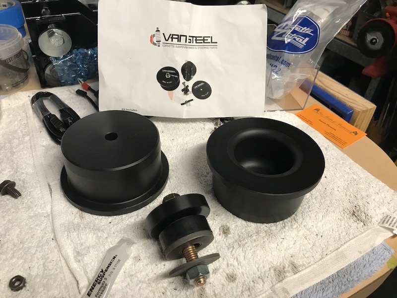

Parts have turned up from Corvette Central and Van Steel.
Time to start again.

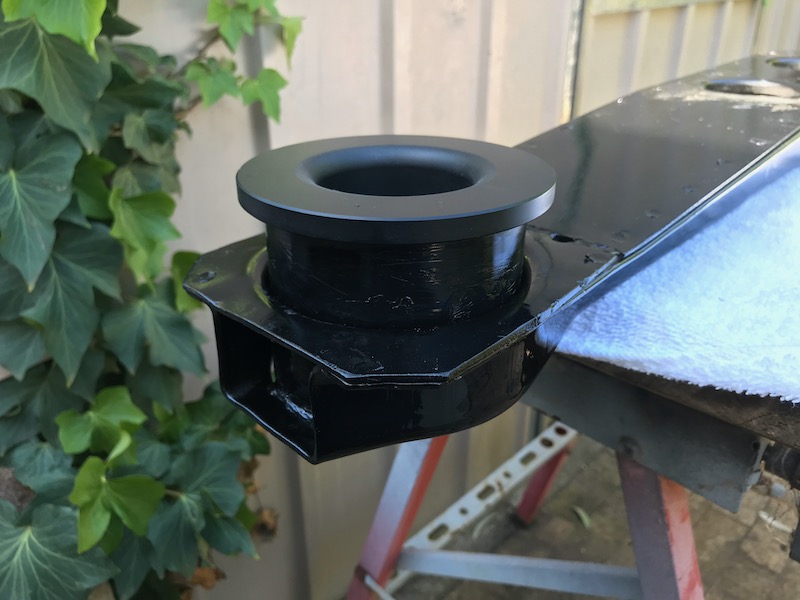

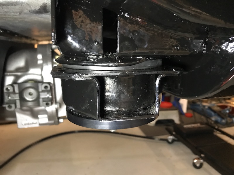

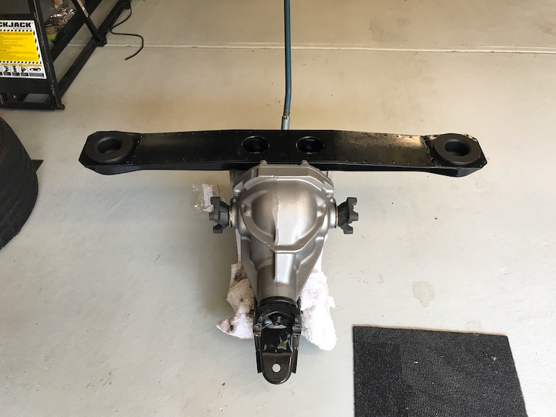

Started by applying supplied grease to the bushes and then pressed them into the diff crossmember.
No issues with getting them in.

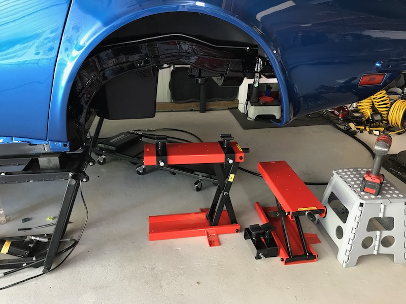

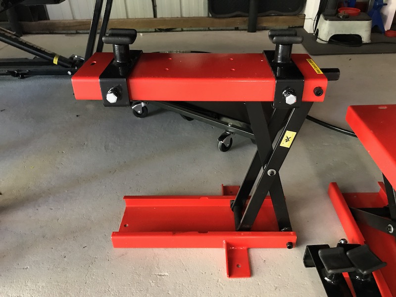

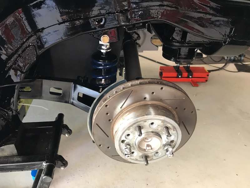

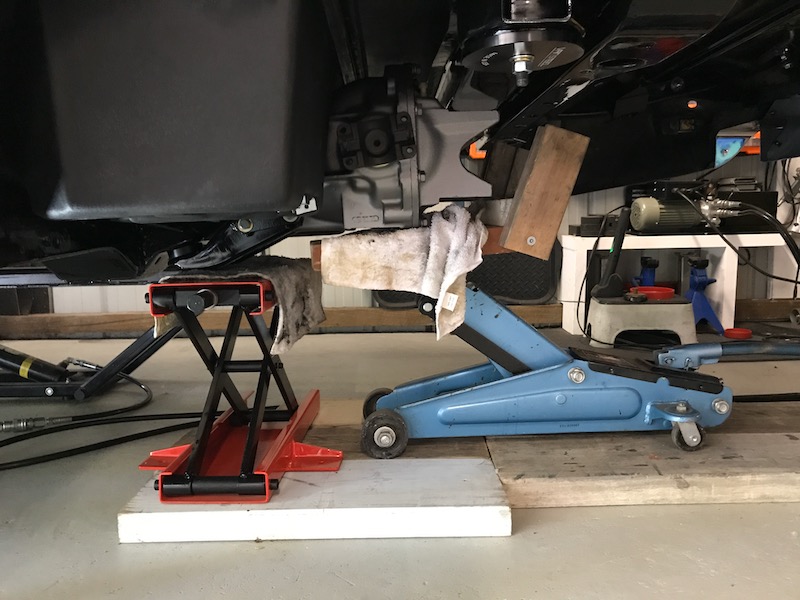

Also picked up these bike lifts to help with setting up the rear suspension at ride height etc. $67 each seemed good value to me.

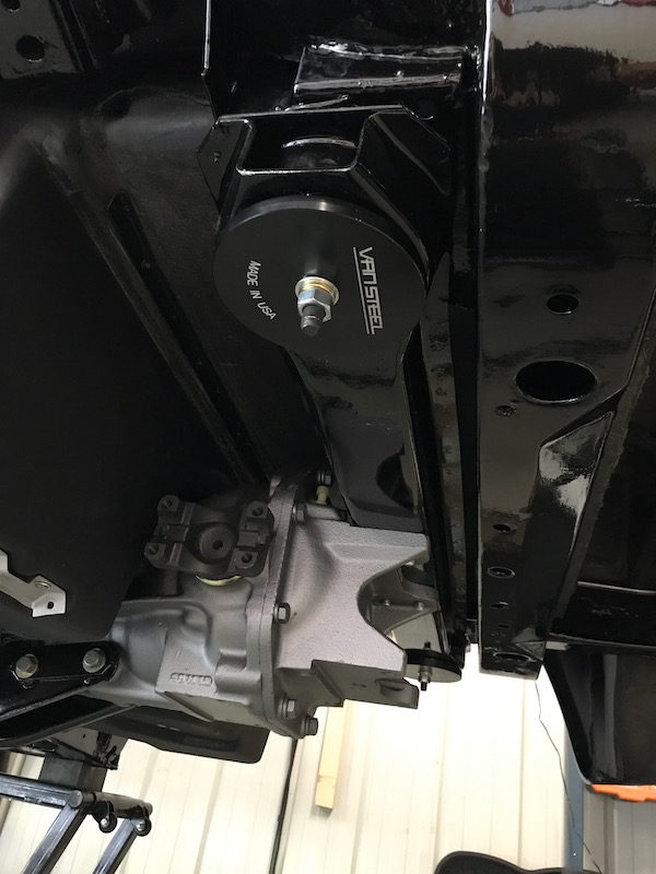

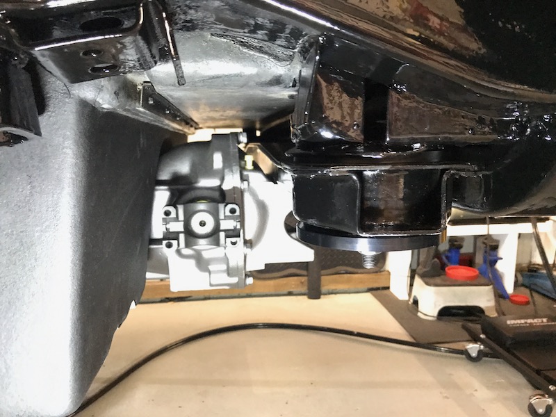

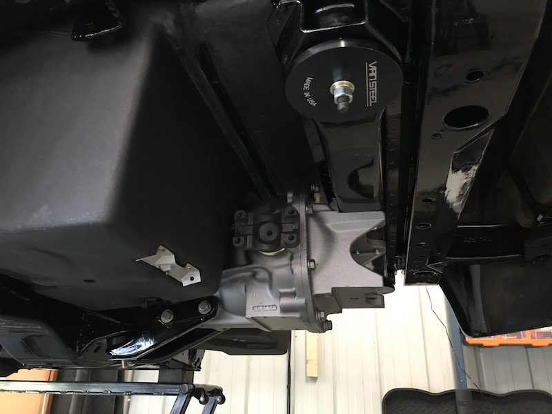

Crosmember bolted to diff.
Raised into place.
The new lift helped align the front.
Bolted in.

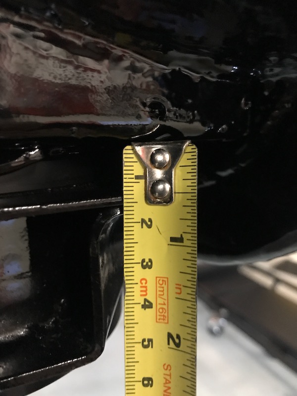

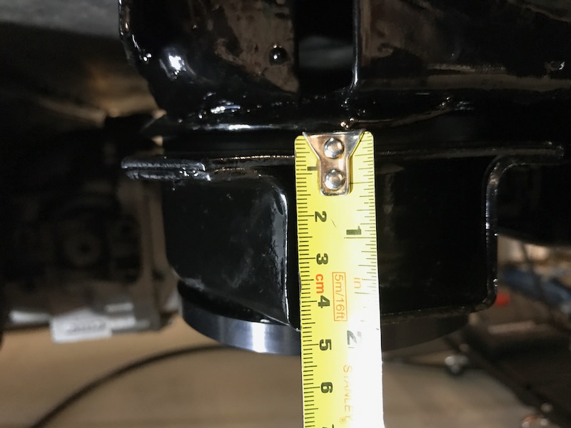

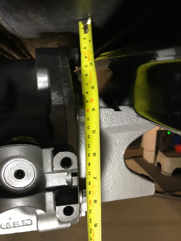

Hi Craig,

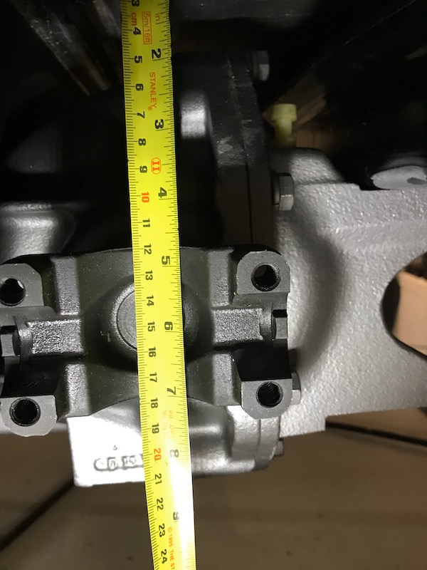

how much higher do you think it's placed the diff cross member compared to when using the original bushes. Looks like to new bushes have quite a large flange on them and it's a bit hard to see how much your gaining.
Would it be possible to get a side picture (taken from inside the wheel arch) showing the gap between the cross member and the frame with everything mounted up tight.
I think mine is currently about 3/8" with new standard bushes, however I'm using the aluminium bottom plates so this may of helped them pull up tight.
I'm just looking at ways to straighten the half shafts a bit with a lowered ride height.

Hi Brad
i will take some pictures today and measure.
its hard to tell given it’s been out for a while but it certainly seems to sit up tighter to the frame than before.

If you are using Van Steels kit, they told me it will place the diff cross member 3/4" higher up into the frame.
Thanks. I can’t see gaining that much, I currently have about 3/8” gap so that would be the most I could gain.

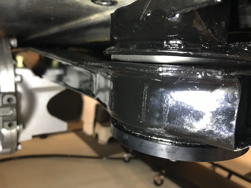

So there are some shots and with a tape measure as well
Old Nov 1, 2019 | 07:05 PM
  #1571
wabco40's Avatar
wabco40
Joined: Jan 2005
Posts: 370
Likes: 77
From: Perth Western Australia
Thanks Craig,
looks like the gap is down to about 6mm. I will have to check mine when I get home from work next week.

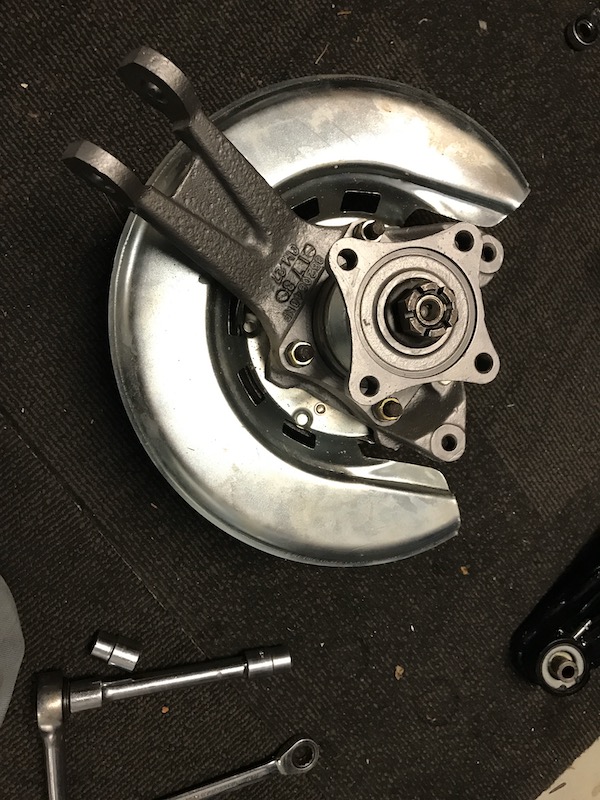

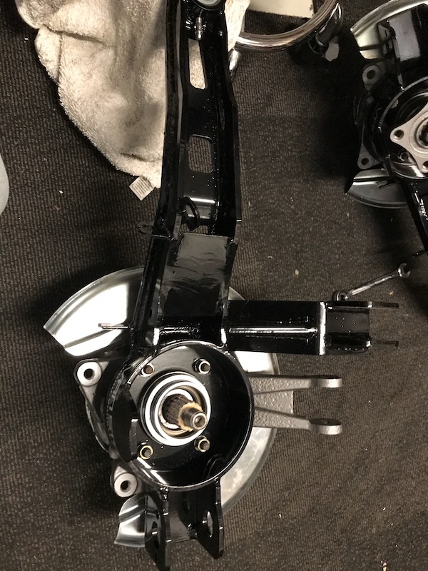

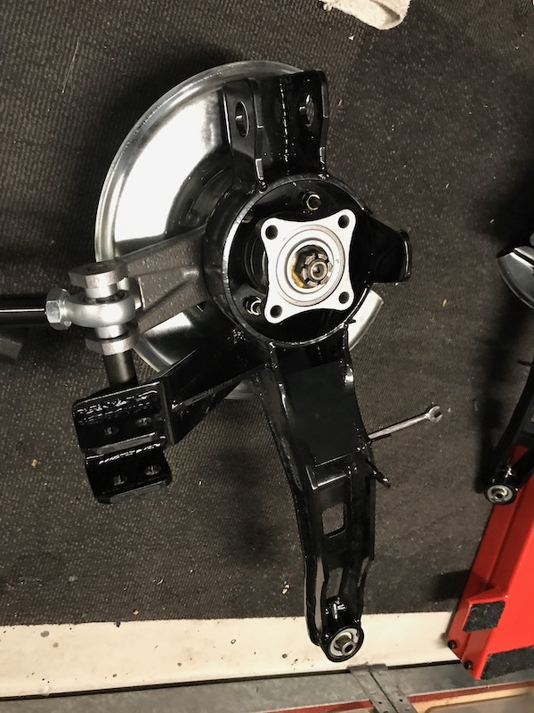

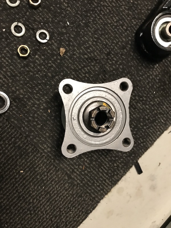

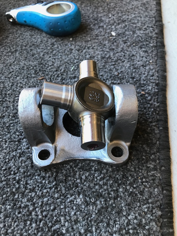

Finally back to where i was a few years back. About to fit new VanSteel Coilover trailing arms etc.
The rear bearing assemblies from Bairs had reverse studs so they can be bolted to the trailing arm as a unit.
First remove the flange and 4 stud nuts slot then onto the training arm.
Tighten nuts on stud to 50lb then refit flange.

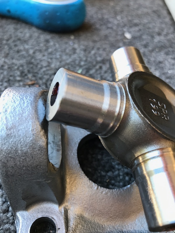

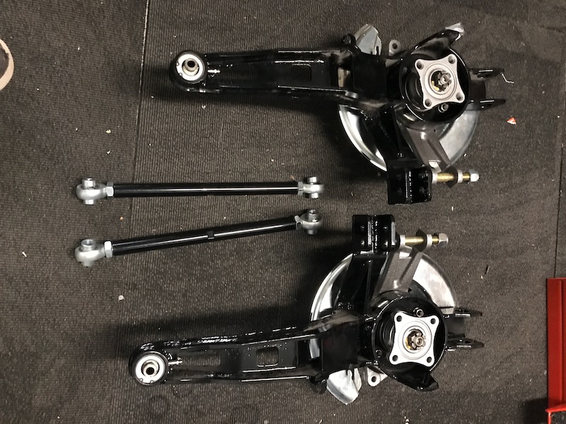

A bit more progress.
Fitted up the new cv joints to the half shafts. Had to grind a small amount on the side that bolts to hub to get larger Spicer CV's on.

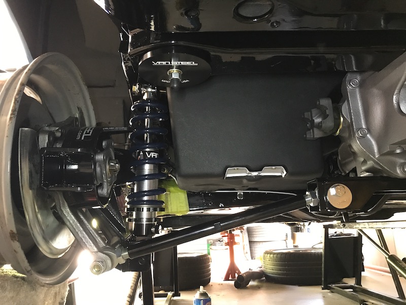

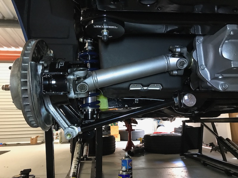

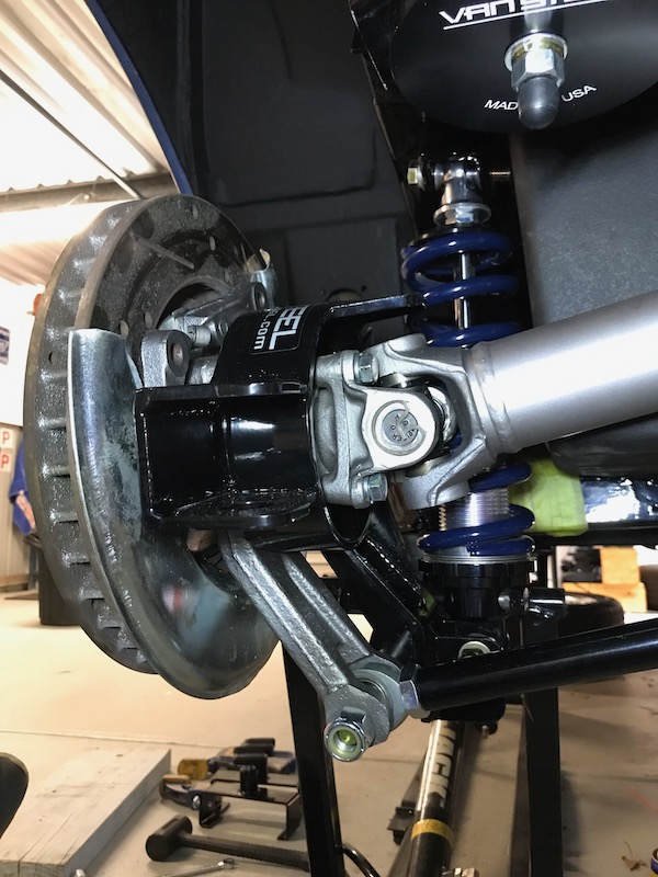

Some progress fitting the new trailing arms, half shafts and strut rods.

Hi Primoz I had all the parts and tools to rebuild my rear bearings but decided to just purchase some rebuilt ones from Bairs Corvette.
They had a great reputation and had the option to have reverse studs added so I could just bolt them up to my new arms with minimal disassembly. No need to pull them apart again to fit them.
being in Australia I had to pay a higher price for not shipping back my old ones to the US for them to rebuild and sell on but it was not that much more expensive.

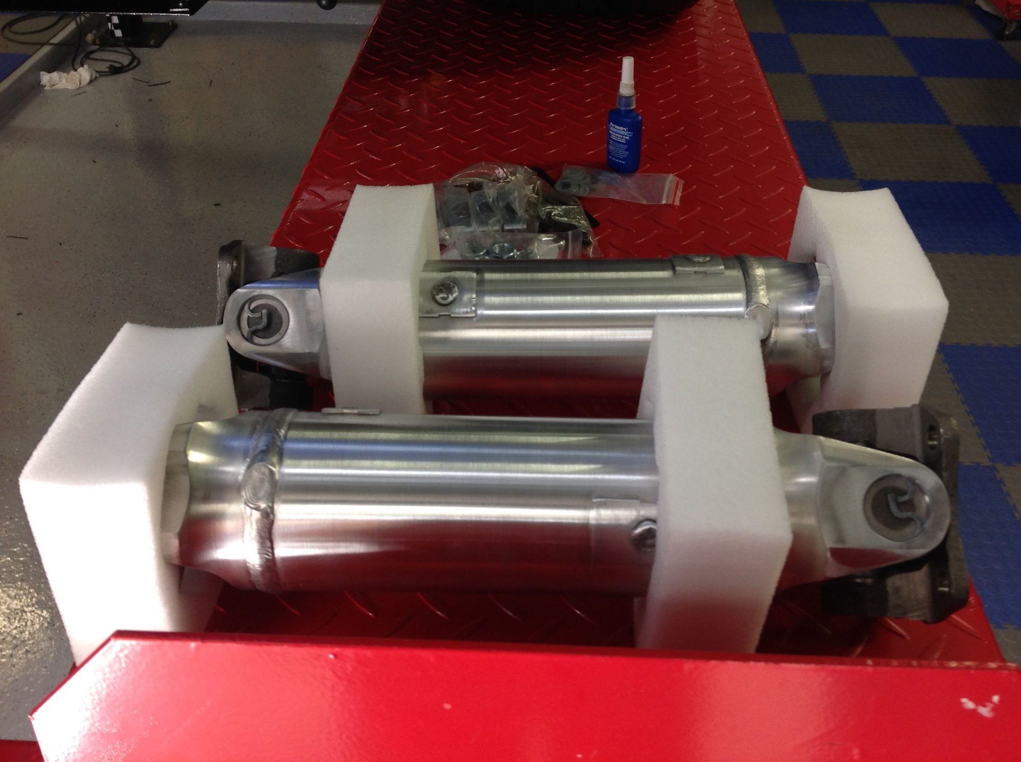

Just checked and the Spicer CV’s came from Denny’s Driveshafts in a rebuild kit. They are sealed with no zerk fittings. At the time about $110.00
Hi Craig,
I'm surprised Denny's Driveshafts wanted anything to do with you!!!
I had a hell of a time purchasing there aluminium half shafts and CV joints, the boss simply did not want to deal with any overseas orders. After numerous emails and a phone call I managed to get them to ship to a freight forwarding company in California. I guess he must have been screwed before!!!

Thanks, I am quite impressed with them. Worth all the hassle.
