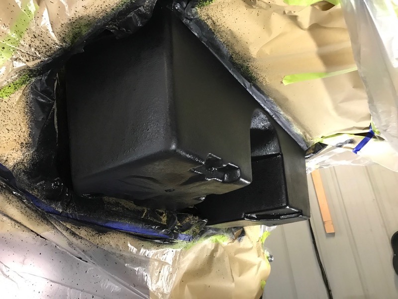

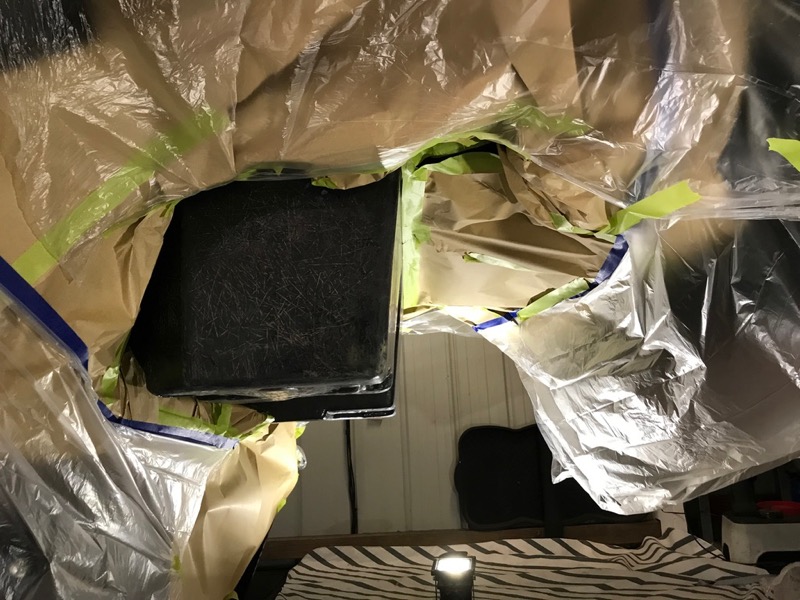

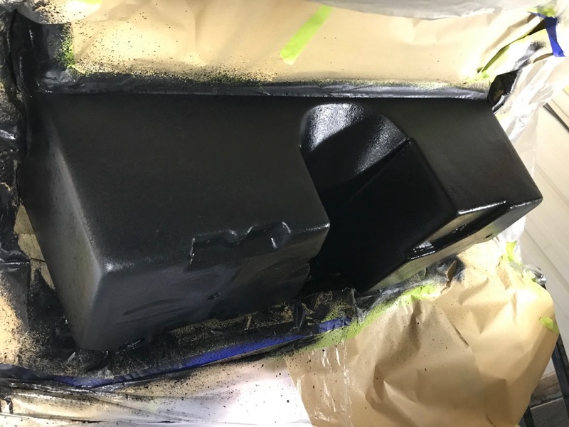

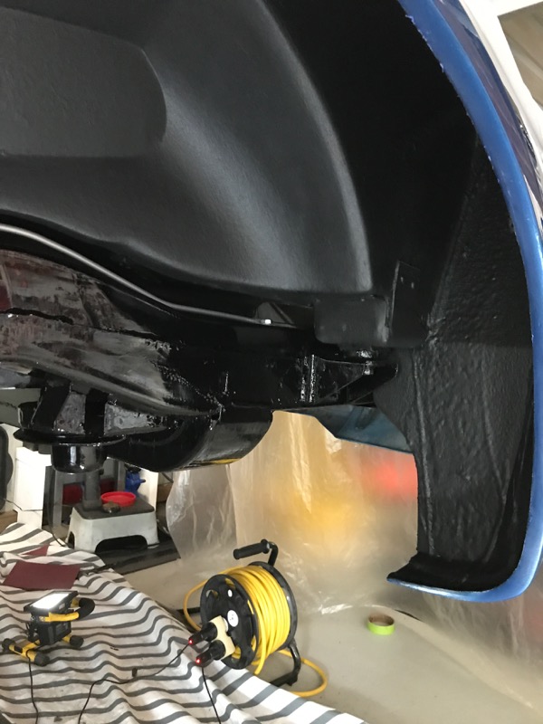

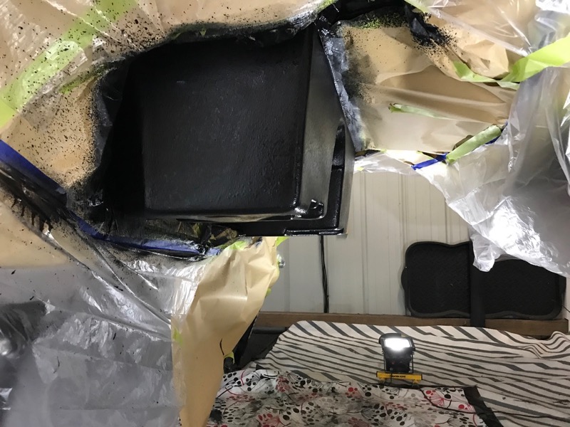

Painting the storage boxes with bed liner today.
Started by sanding the epoxy coating I added with medium grit sandpaper to give a better base to paint on.
Then masked it all up.
Sprayed First coat.
Just after third coat.
Now wait for it to dry up and i can move onto doing the rear wheel wells.

Old Sep 19, 2019 | 10:43 PM
  #1544
caskiguy's Avatar
caskiguy
Joined: Nov 2016
Posts: 9,264
Likes: 951
From: Lake Tahoe, CA
Sprayed First coat.
Now wait for it to dry up.
Thank you Craig for posting all your work as I'll use quite a bit of your information as I restart my rebuild. Keep it coming, nice work.

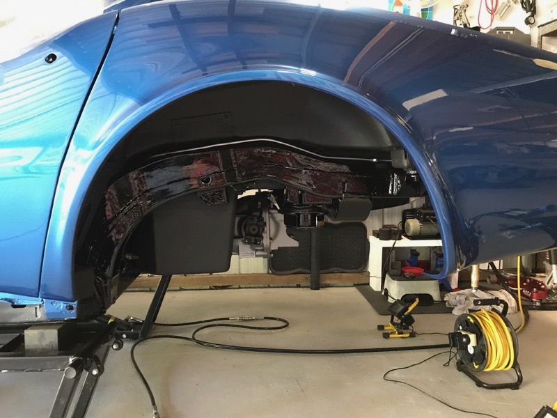

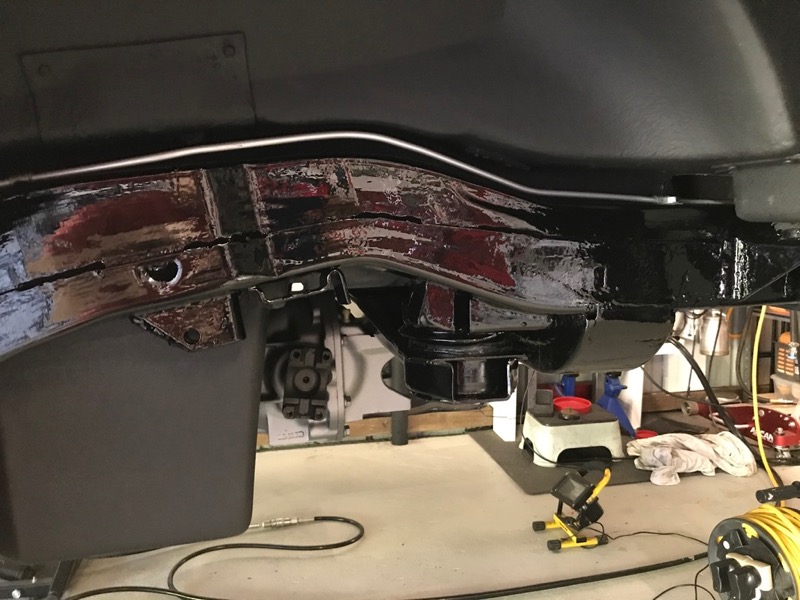

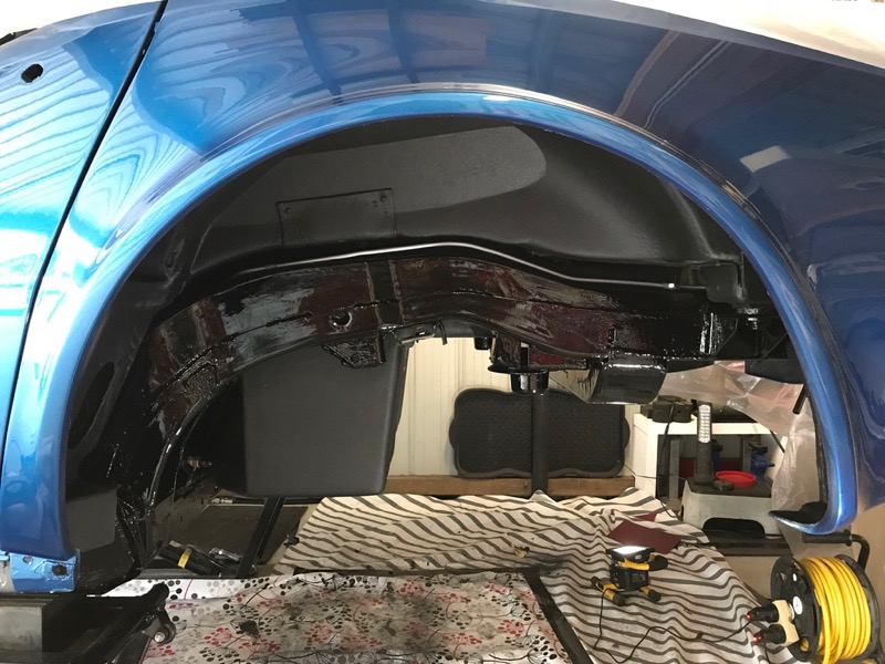

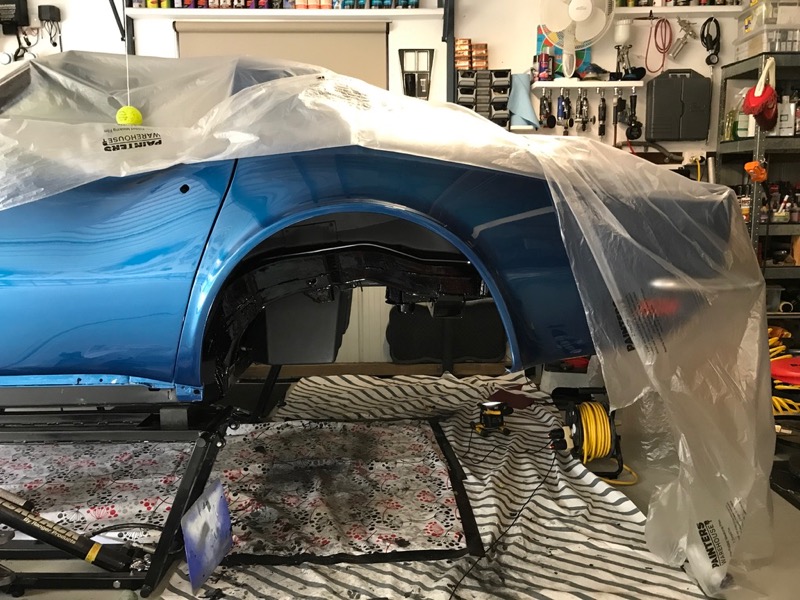

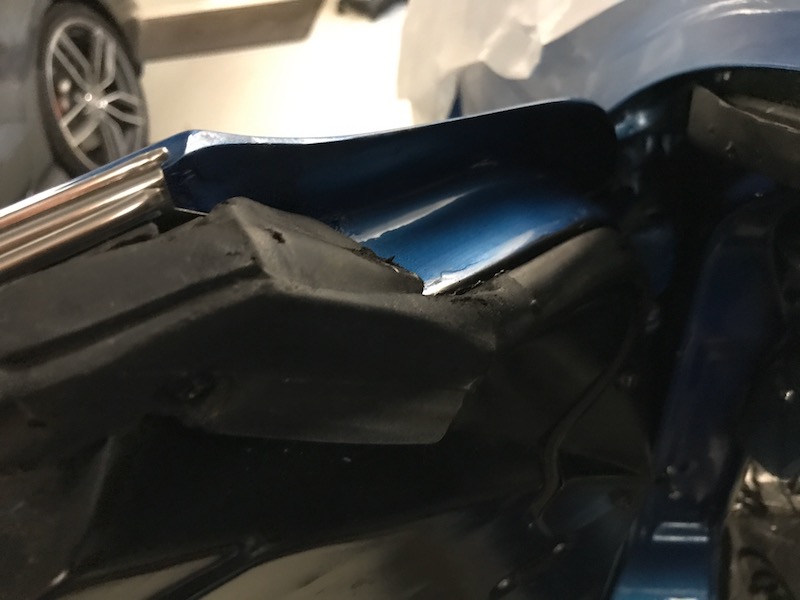

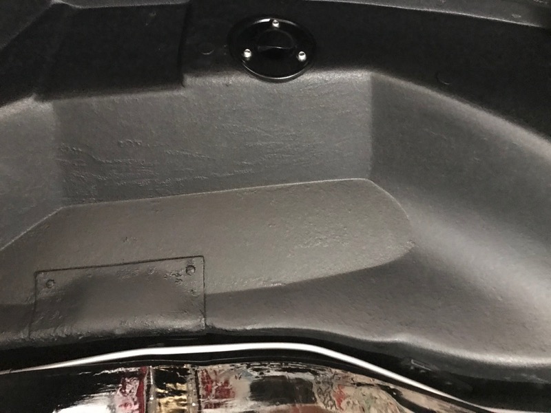

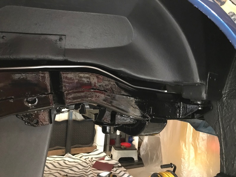

I got to peel back the masking paper and have a look at how the inner guards turned out.

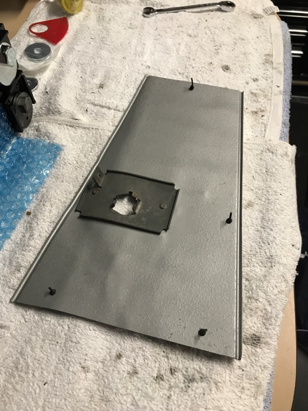

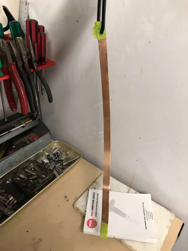

I refinished the radio aerial mount and strap again while I had some spare time.

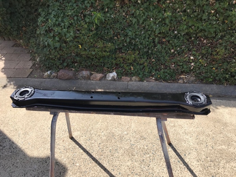

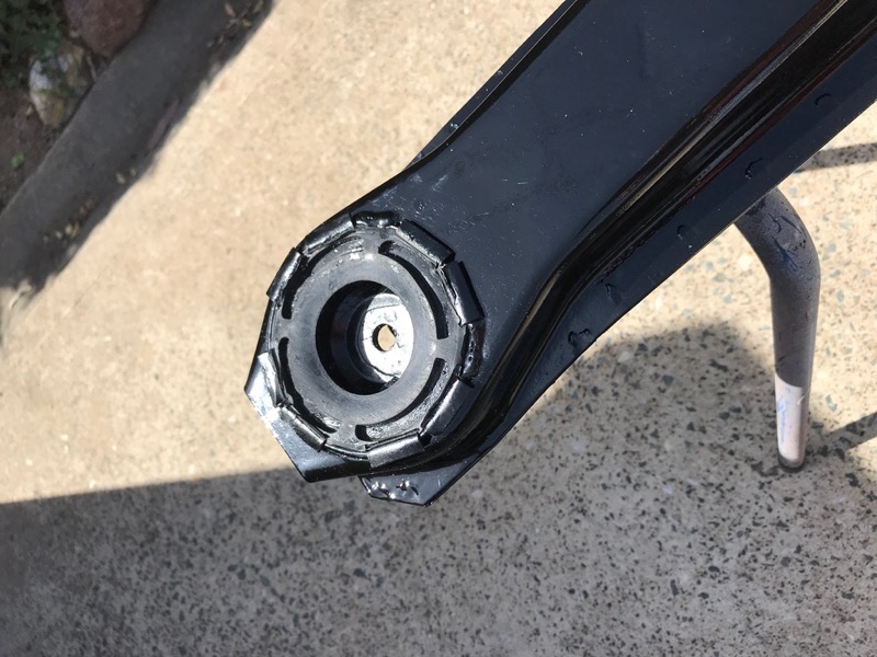

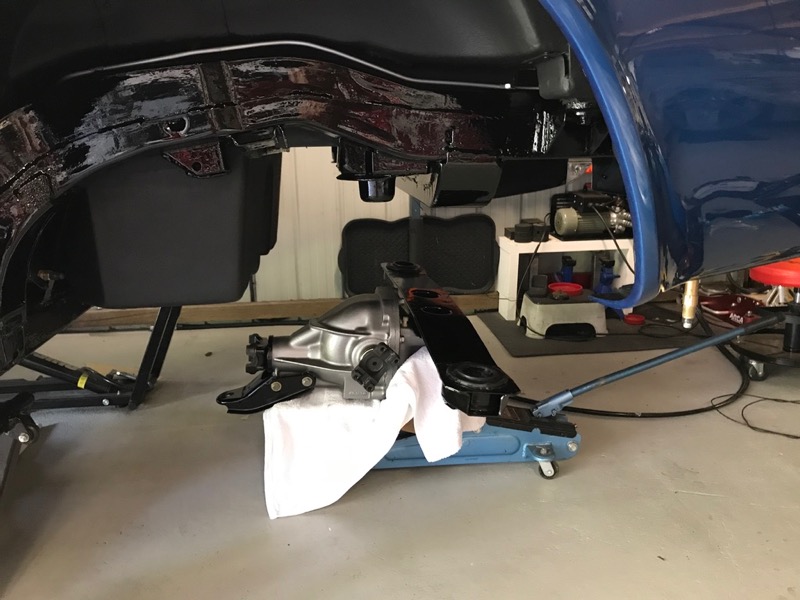

Diff crossmember bushes pressed in.

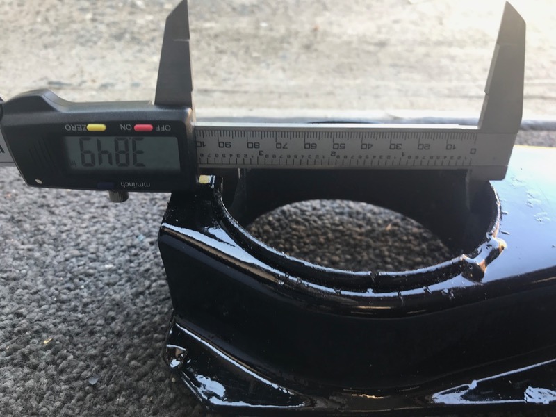

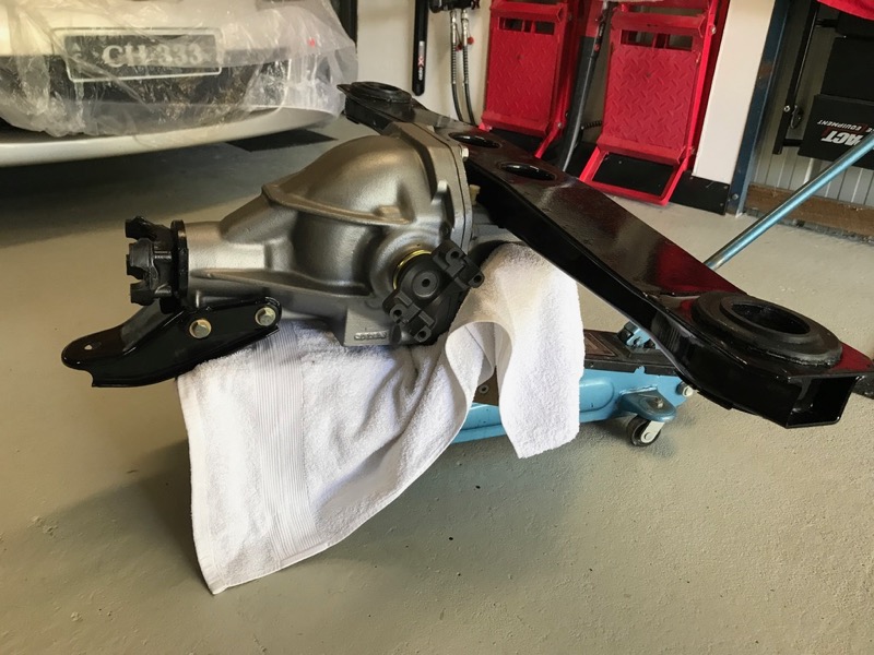

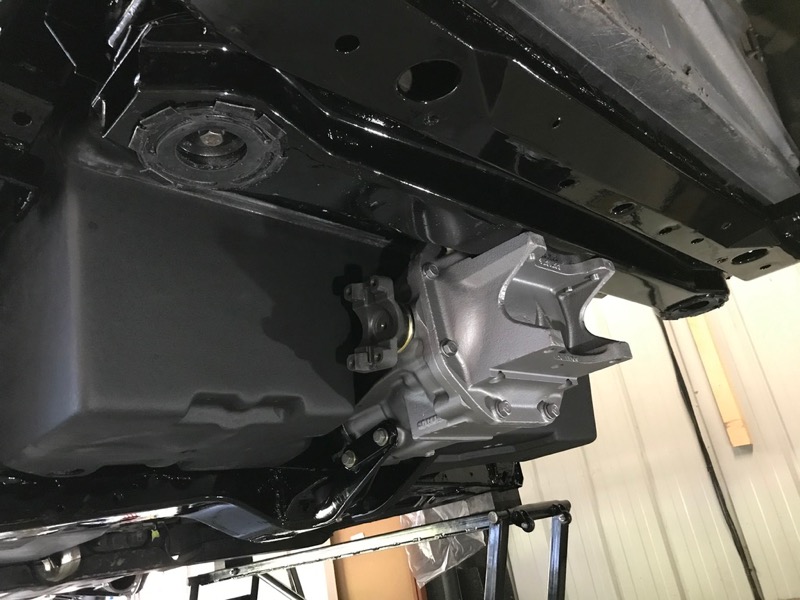

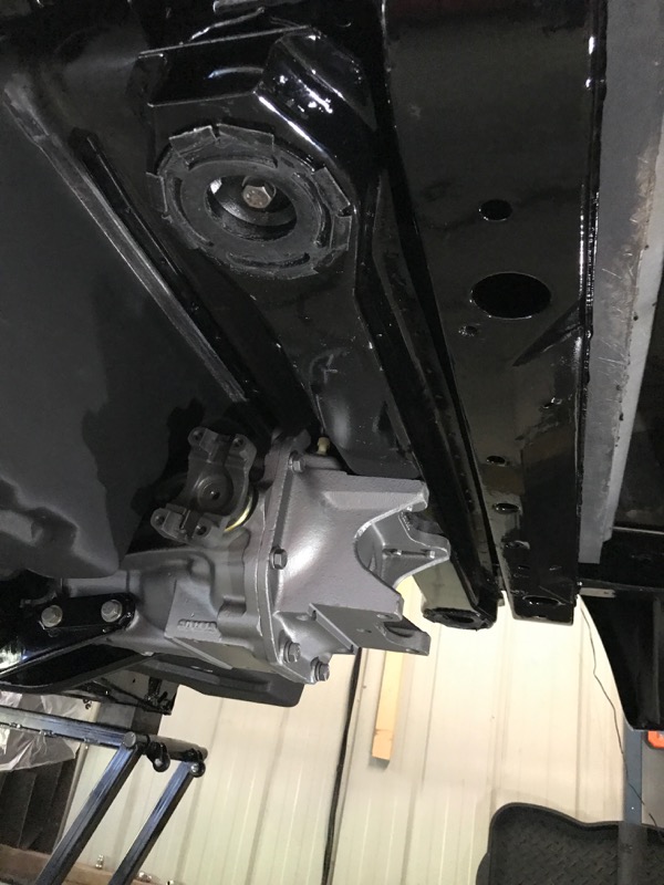

I put the diff and crossmember back in ......
....but am not really happy with how its ended up. The new bushes don't sit up as far as the old ones on the frame so I may pull it and use some of the Vansteel Delrin bushes to get the diff a little higher and mounted more solidly.
Anyone have any feedback on using them ?
https://www.vansteel.com/index.cfm?f...p=1503&ID=3905
Old Oct 2, 2019 | 10:50 AM
  #1554
OldCarBum's Avatar
OldCarBum
Posts: 14,406
Likes: 8,212
From: Napa Valley California
I purchased a set for my 73.
I haven't installed them yet, but like everything else I have purchased from Van Steel, they are top quality.
Give them a call and talk with Dan or Paul.
Great guys and they know their products.

Have been emailing with Dan from VanSteel re the Delrin bushes for the diff crossmember then called Eric this morning (Australian Time) to discuss.
Turns out that some very rusted crossmembers may have enlarged mounting holes that mean the bushes are not tight enough.
Luckily mine is nice and clean so I ordered a set.
Now just have to wait for them to ship to California then be bundled up and sent to Australia.
Still have lots to keep me busy so not a real delay.

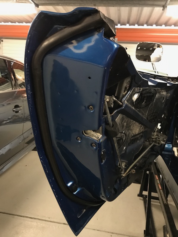

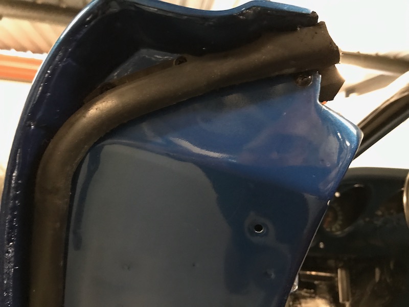

Cleaned up the drivers door removing all the old weatherstripping glue.
Then fitted the cleaned weatherstrip.

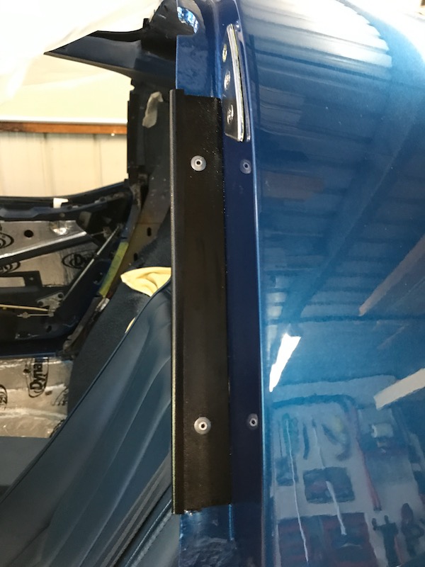

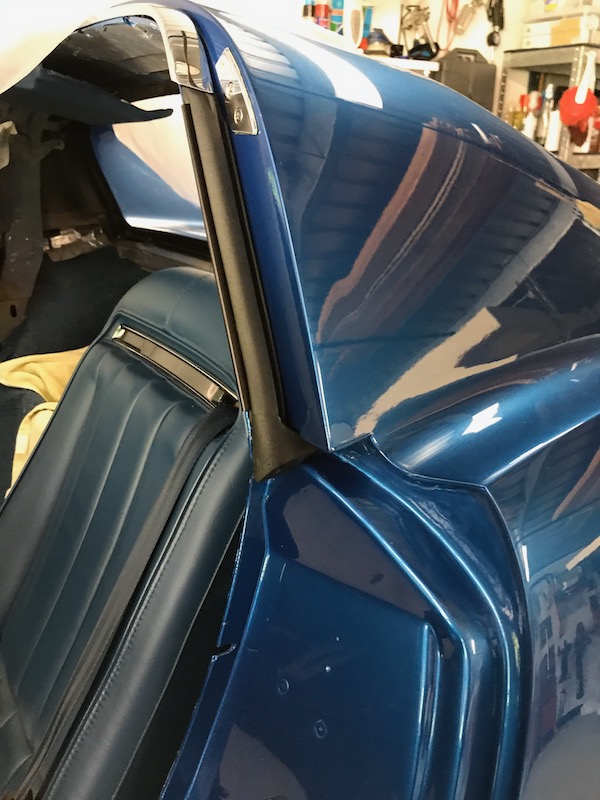

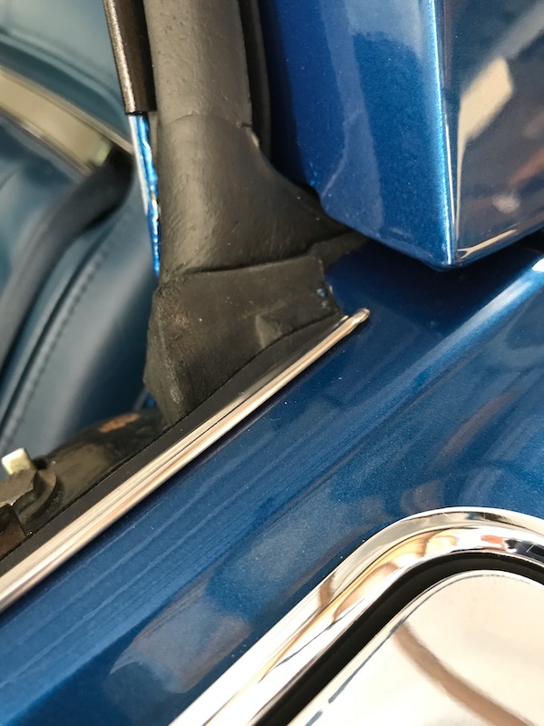

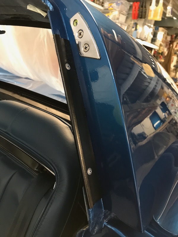

Fitted up the drivers side door handle and locks. Had forgotten how fiddly some of those clips can be.

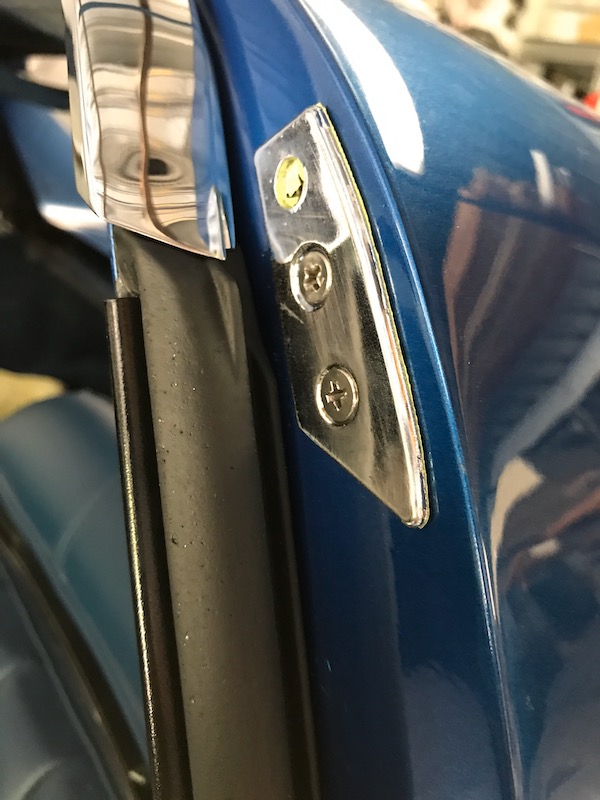

Moved on to the b-Pillar.
Riveted new channels with sealant behind them.
Then glued on the weather-strip
Halo chromed strips are just sitting there to ensure things line up.

Craig, your other option on the diff crossmember is just to solid mount it as per the Chevy Power Book (http://corvettefaq.com/c3/ChevyPower.pdf), which allows you to also raise it up in the chassis and improve the geometry when lowered. I did this on my car.
Looking great!
To 1971 Journey
Old Oct 9, 2019 | 10:10 PM
  #1558
OldCarBum's Avatar
OldCarBum
Posts: 14,406
Likes: 8,212
Somebody told me that you should re check your drive shaft angle after installing solid mounts to the rear differential crossmember.
Don't know how true his statement was???
Old Oct 9, 2019 | 10:22 PM
  #1559
Metalhead140's Avatar
Metalhead140
Joined: Aug 2015
Posts: 1,939
Likes: 477
From: NSW, Australia
C3 of Year Finalist (track prepared) 2019
Depends if they also raise the diff. If the diff is moved higher/lower then yes you should check the angles.
Old Oct 9, 2019 | 10:56 PM
  #1560
CraigH's Avatar
CraigH
Joined: Apr 2010
Posts: 2,795
Likes: 1,196
From: Canberra Australia
Looking great!
i considered that Andrew but had a credit with VanSteel so opted to use their kit to raise it up.
It should be in California ready to ship next week.
