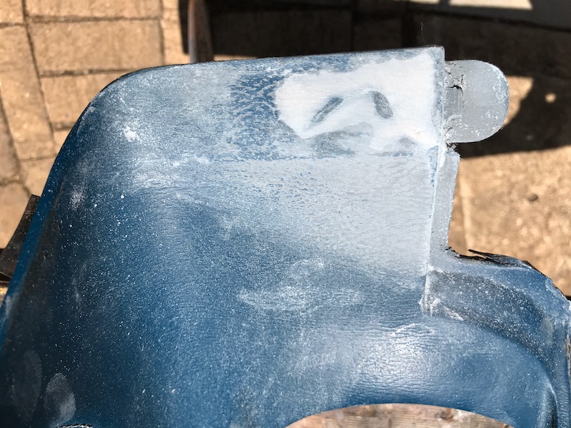

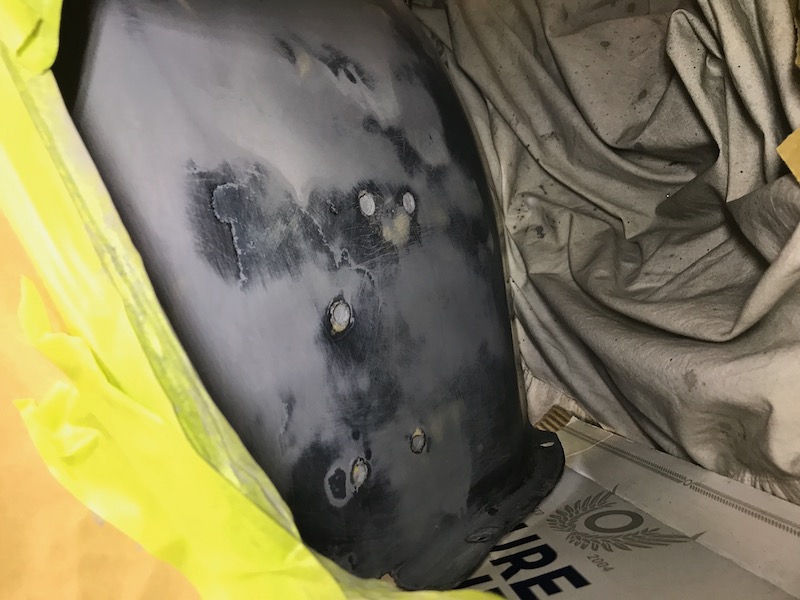

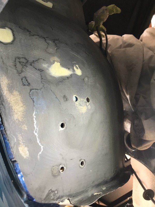

The inner guard has a number of holes in it from my old vacuum tank and the vapour canister I originally mounted too high so I ground them all out to a taper and filled them with glass.
This fender appears to be the only one ever hit hard on my Vette. A partial guard replacement and repairs to the inner guard being the extent.
The inner side will get smoothed and resprayed satin black while some bed liner will go over the wheel side.

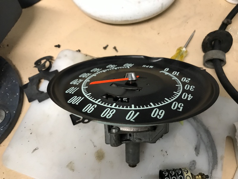

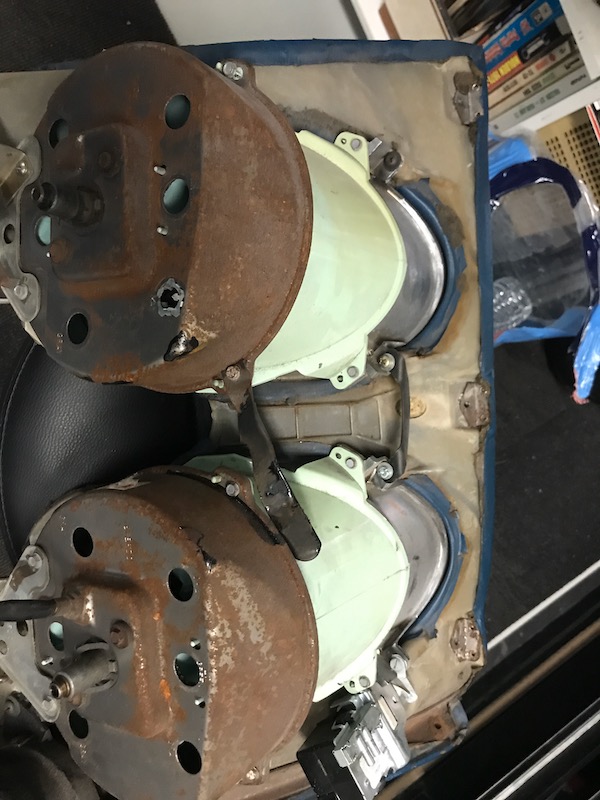

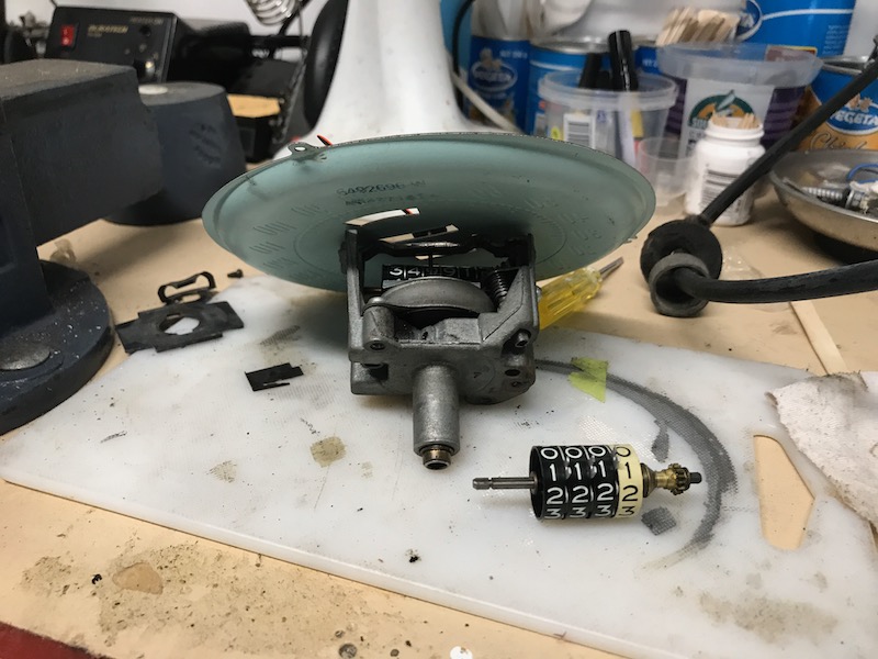

While I had nothing to do i had a look at the speedo and tachometer as my odometer did not work properly.
After dissembling the speedo i found the worn part and have ordered a new one.
A lot simpler to do than I had imagined after following some instructions showing you don't need to remove needle.
Also remove any rust and repaint the parts.
Link to doc re disassembly without removing needle....http://corvettefaq.com/c3/odometer.doc.

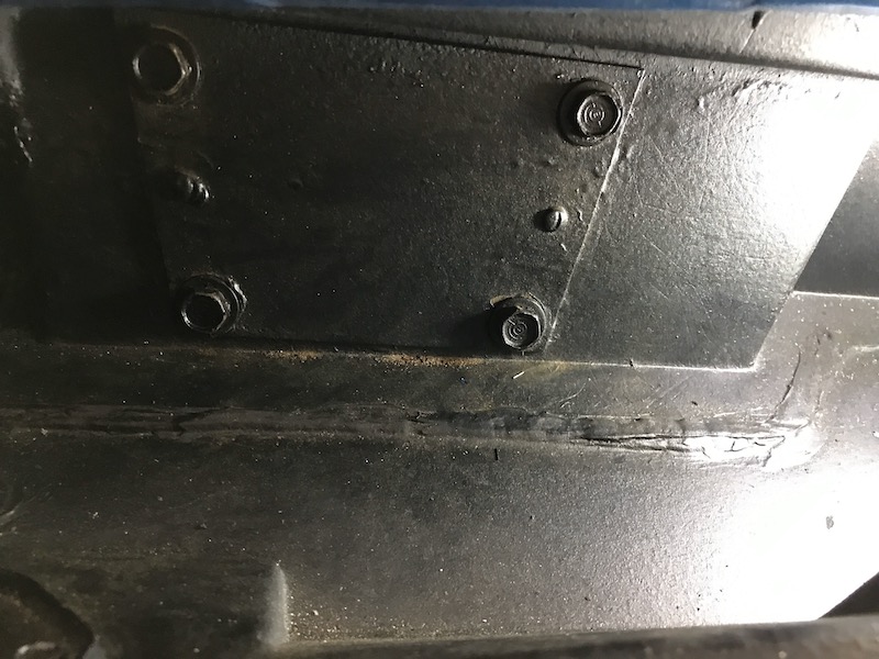

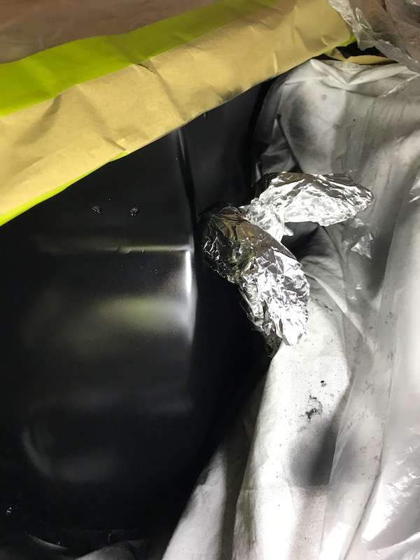

I finished the fibreglass repairs to the inner guard and sprayed it satin black.

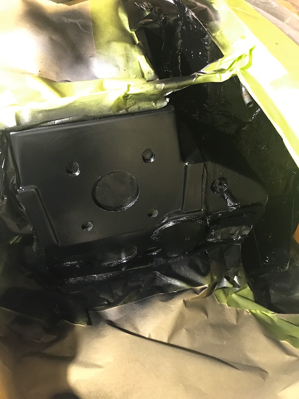

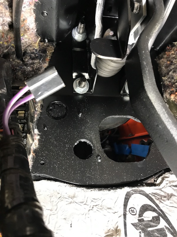

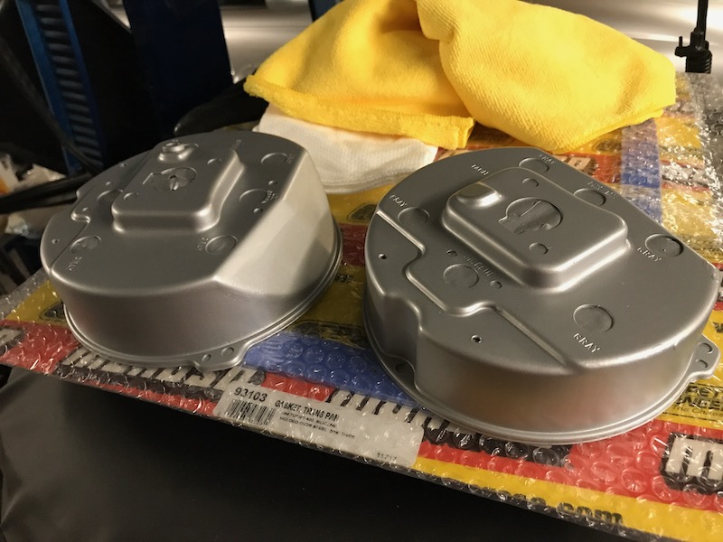

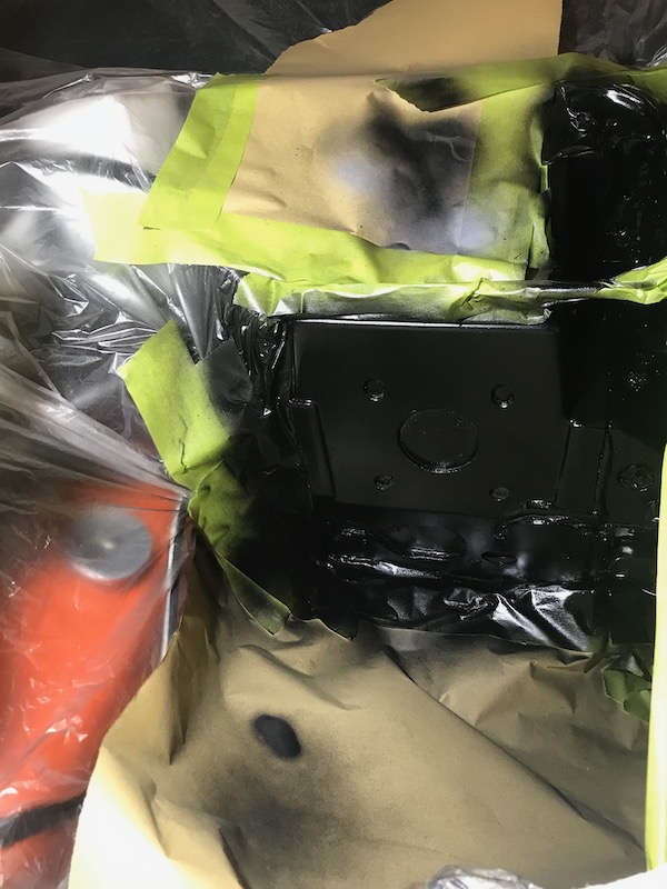

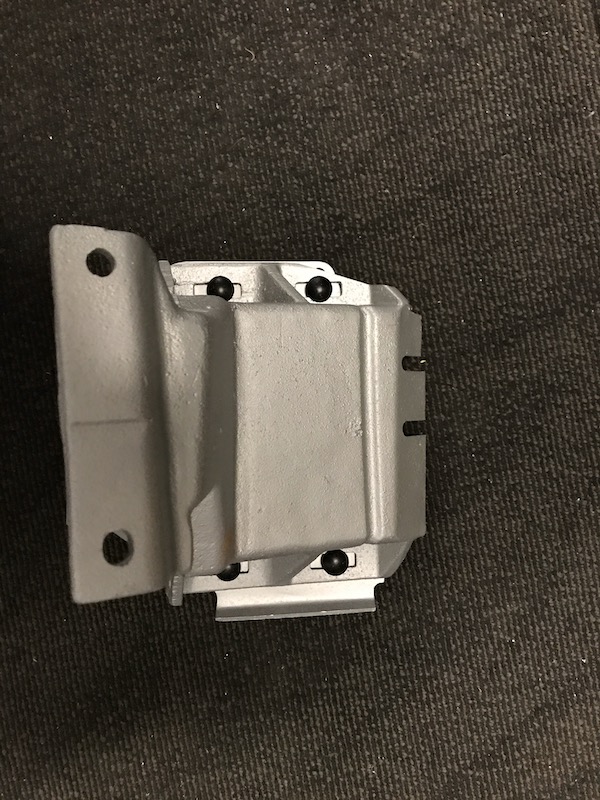

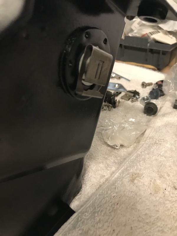

Next the firewall behind the brake booster needed refinishing before it goes back together.

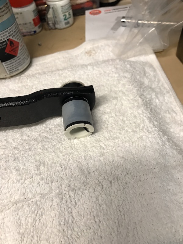

Back from other projects....

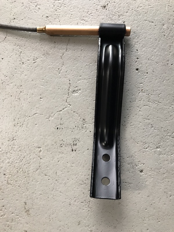

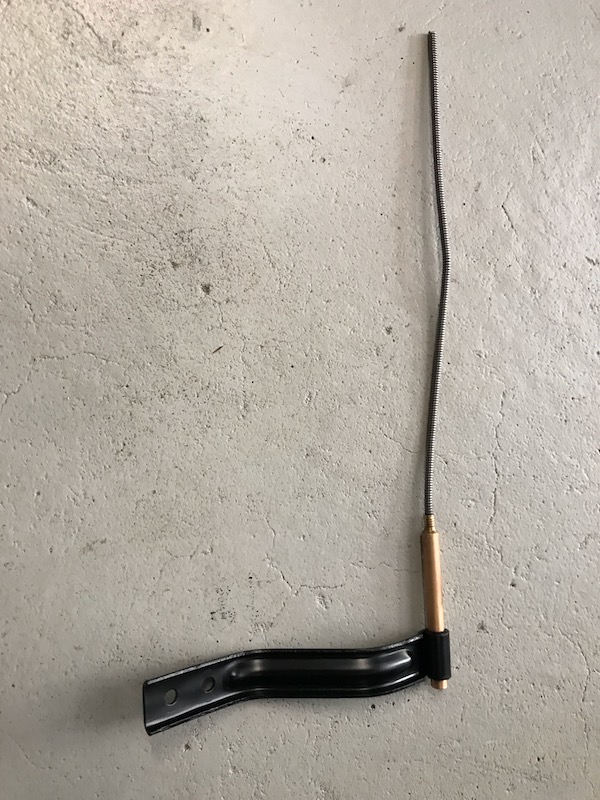

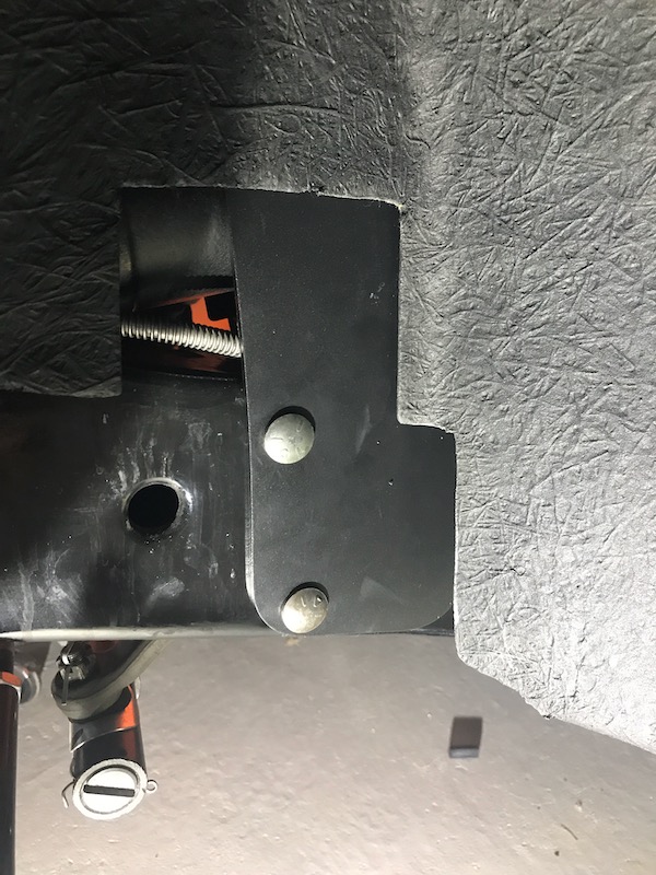

Hood Release Handle bracket refinished.

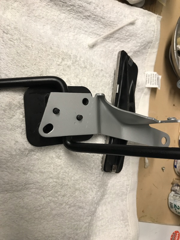

From: Canberra Australia

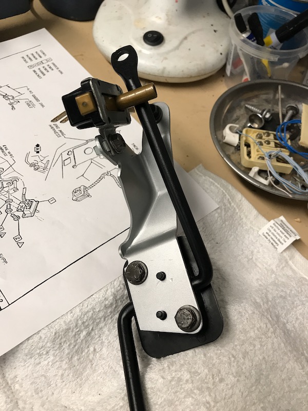

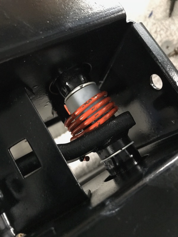

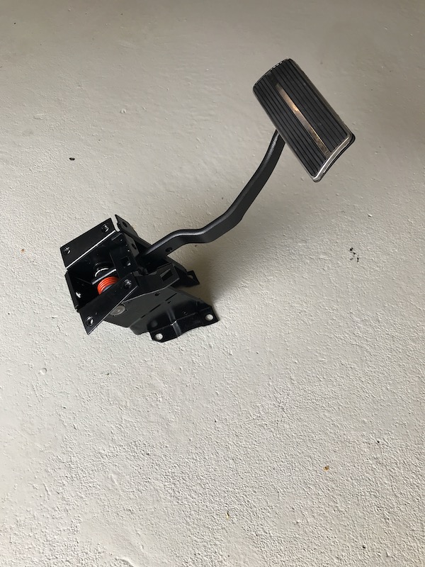

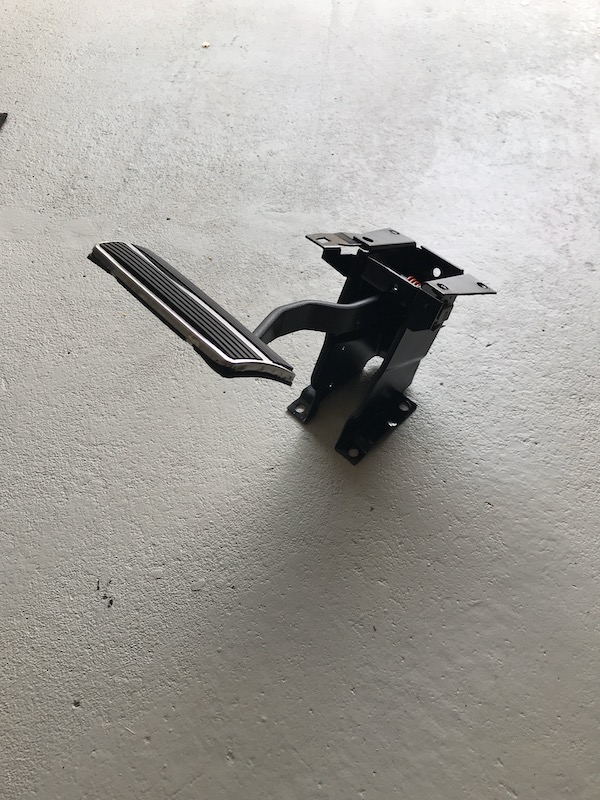

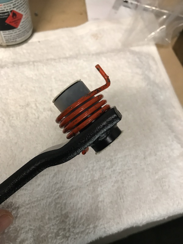

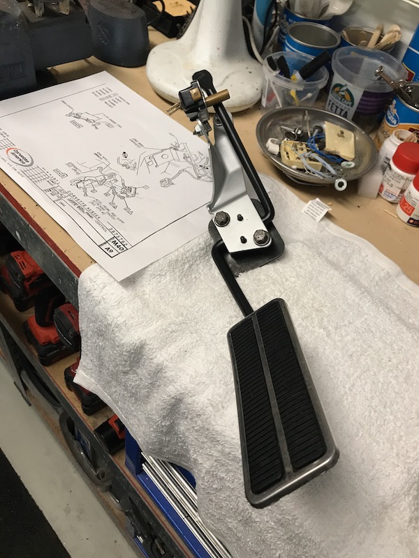

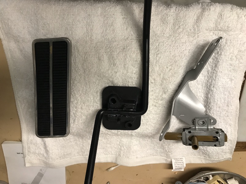

Gas pedal refurbished

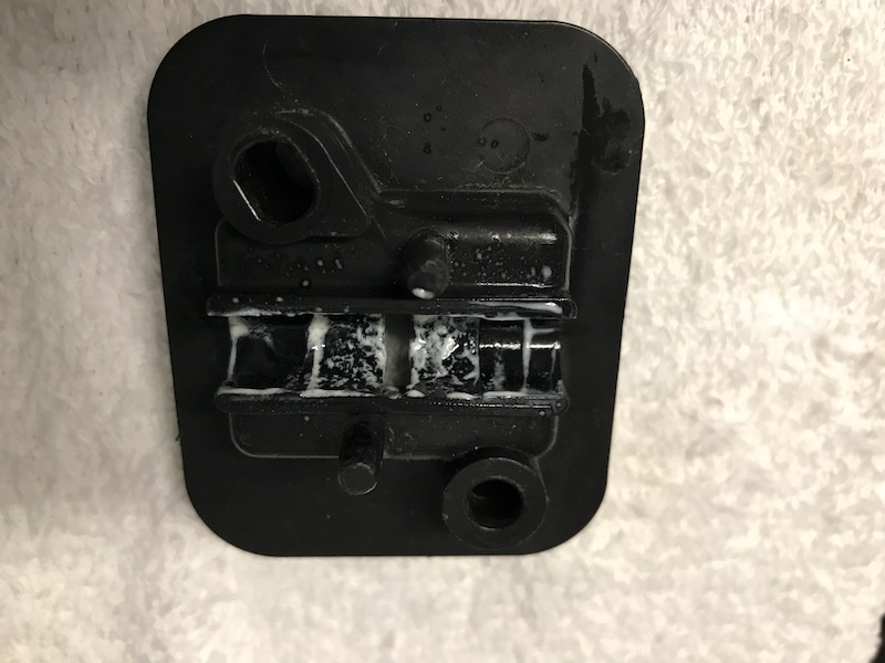

Dash steering column support refurbished.

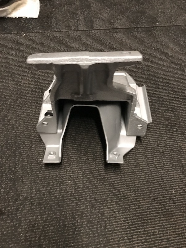

Old Jan 15, 2020 | 11:52 PM
  #1610
CraigH's Avatar
CraigH
Joined: Apr 2010
Posts: 2,795
Likes: 1,196

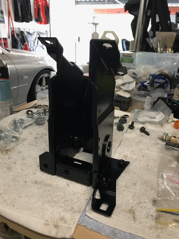

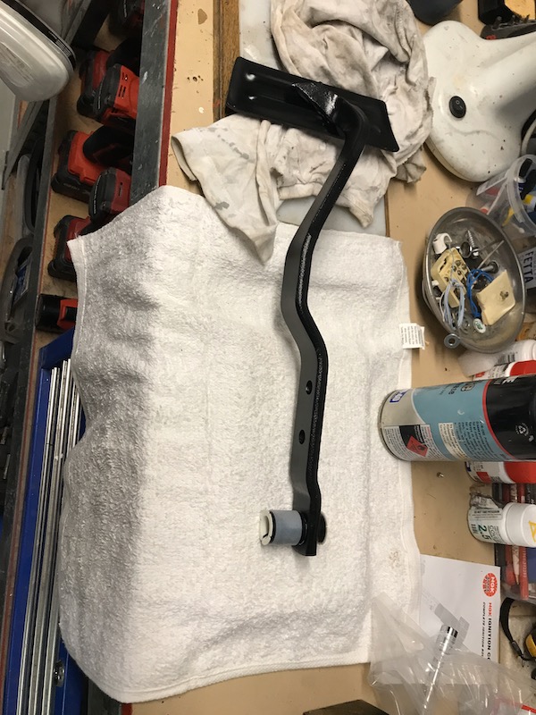

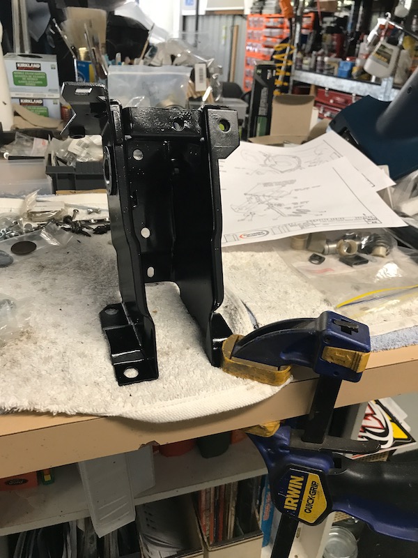

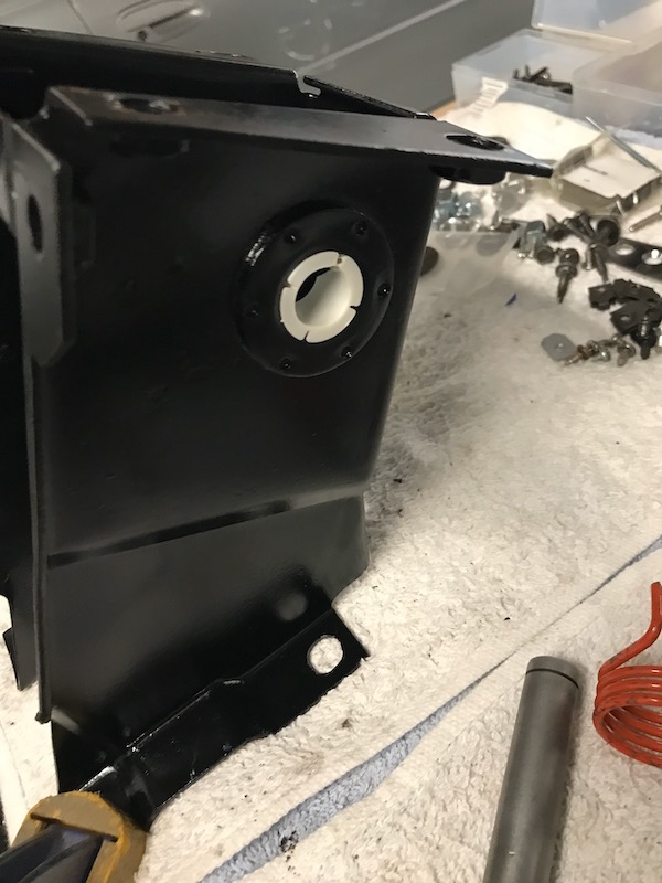

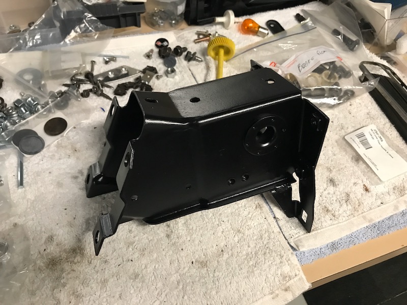

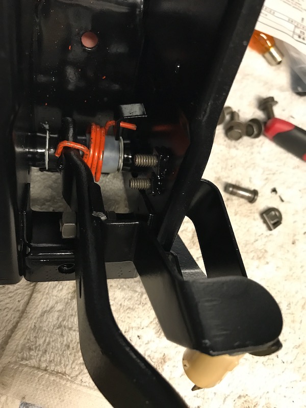

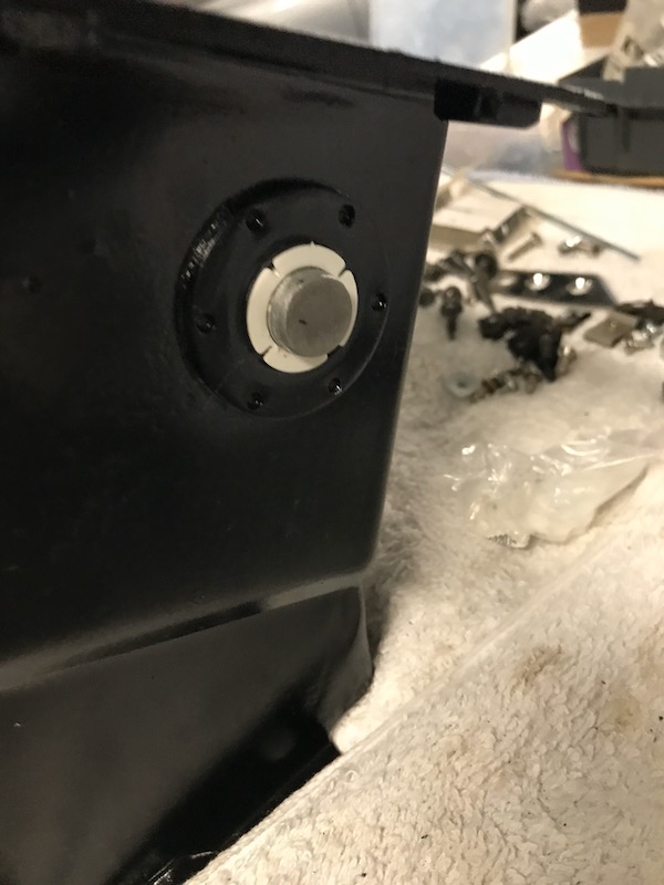

Brake pedal box refurbished.

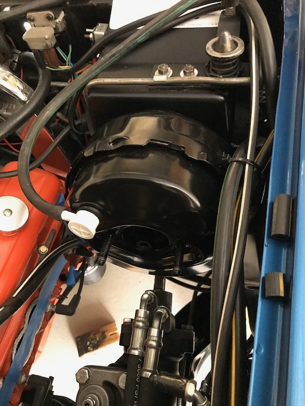

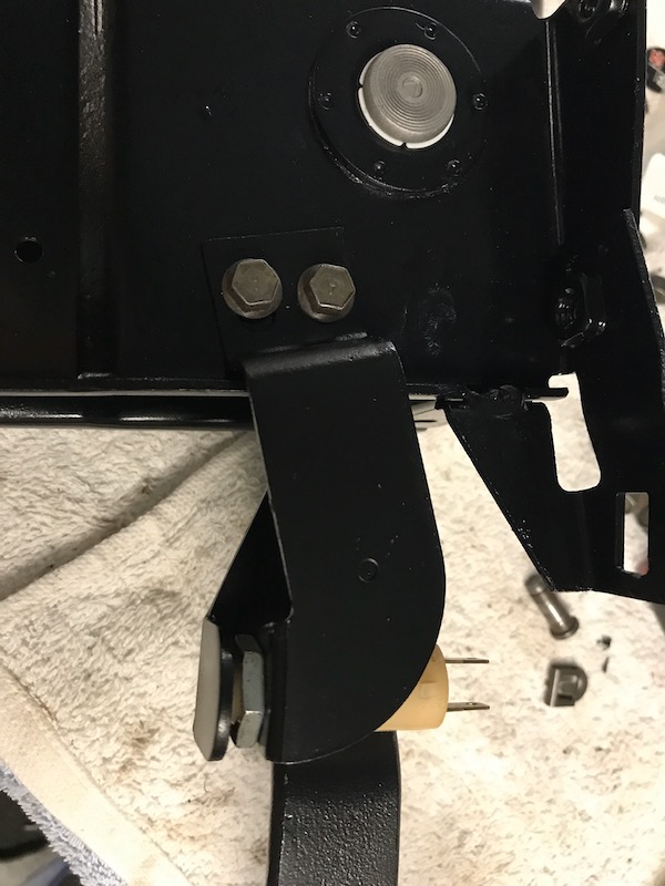

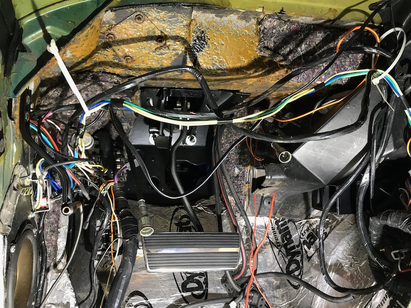

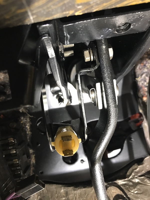

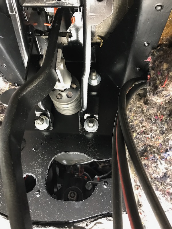

Pedal box and brake booster back in car.
As per other posts, couple of 3/8" extensions and a wrapped universal and access to the bolts is simpler.
With everything out getting the clip on was also fairly quick.

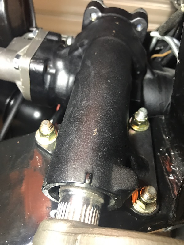

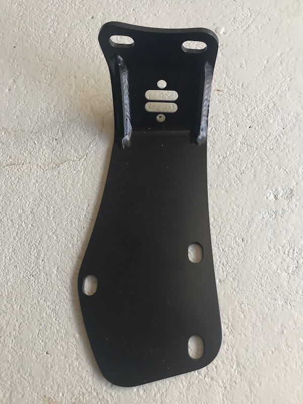

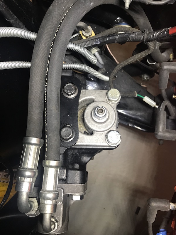

While its apart i have added a Ridetech strengthening bracket for the Borgeson steering box.
I used a new set of coach end bolts to avoid rubbing tyres on full lock rather than the supplied bolts.

Craig, just the modification I ordered. The Borgeson box and the strengthening bracket. Can't wait to see how the vette steering will feel after that.
Old Jan 21, 2020 | 02:21 AM
  #1617
CraigH's Avatar
CraigH
Joined: Apr 2010
Posts: 2,795
Likes: 1,196
I will be interested as well Primoz.
The Borgeson was a big improvement and hopefully a little tighter again with the bracket.

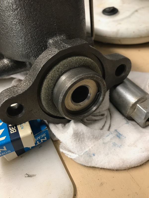

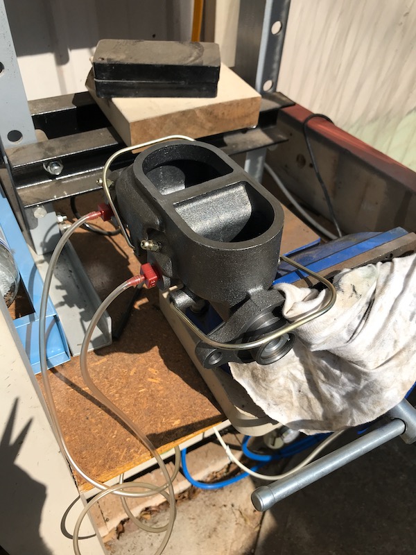

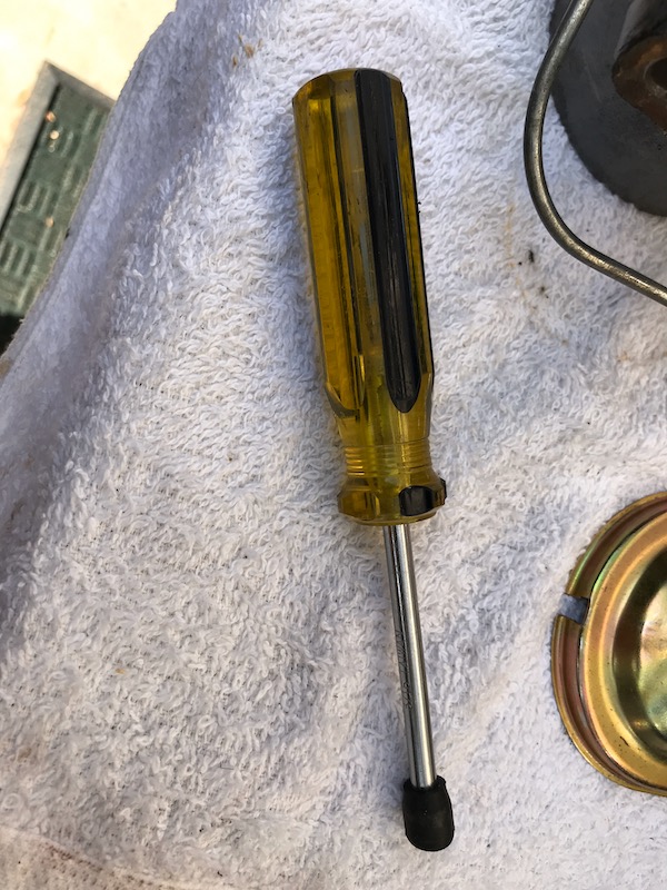

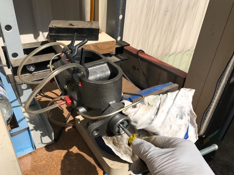

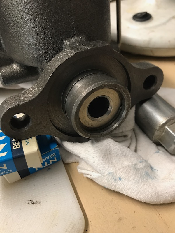

I did a bench bleed on the new master cylinder today.
Put it in vice and used the simple kits available from parts stores.
Took a few minutes to get all the air out.

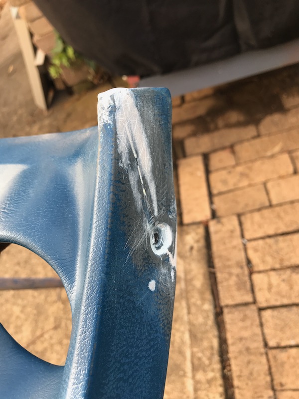

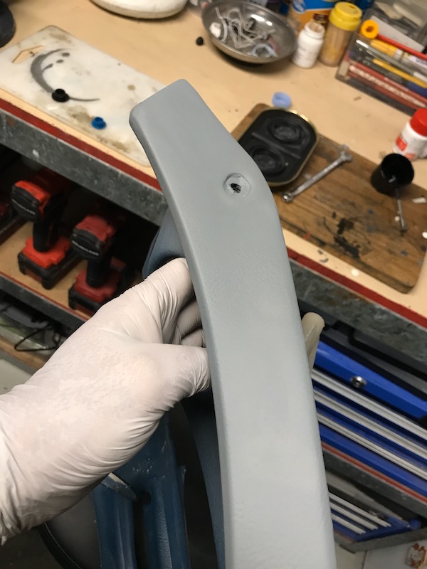

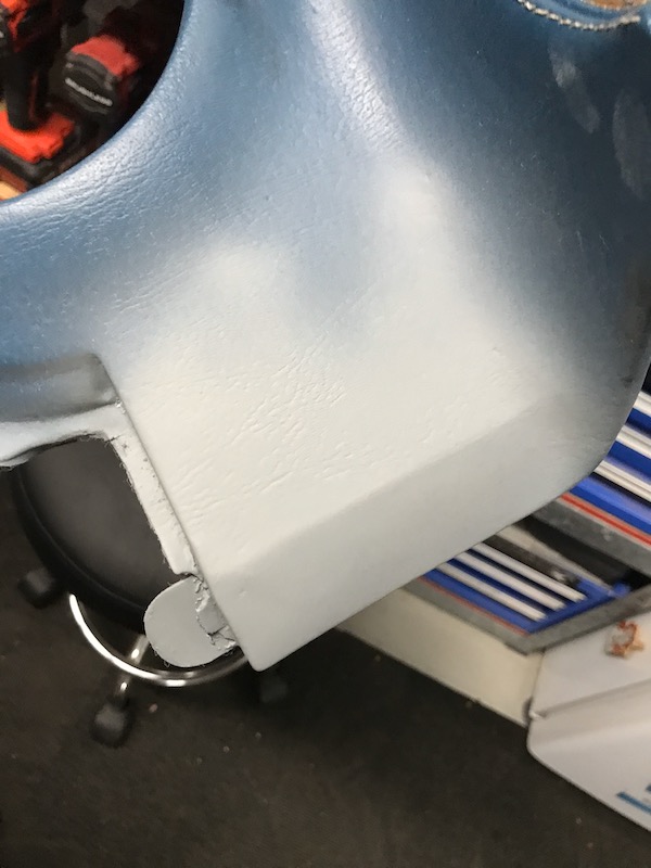

Been doing some repairs on the drivers dash pad while it is out.
The side that goes into the door jam had over time become misshaped so I cut it apart and glassed it back to a better shape.
Lots of trial and error then filled the gaps with Evercoat FiberTech followed by body filler etc.
There was also a few cracks on the bottom edge that got done with gap fill superglue followed with some body filler.
Painted it with plastic primer. You loose some of the texture but can recover it a bit when you spray the colour coats

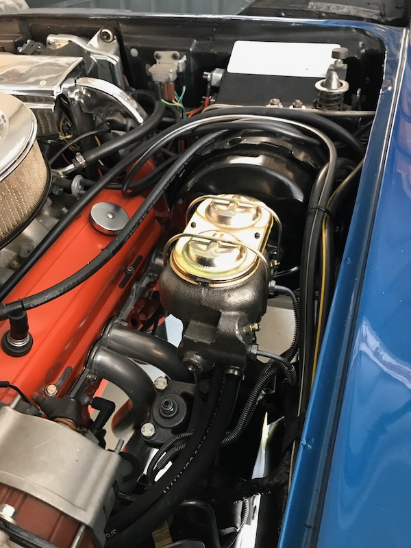

Master Cylinder back in Vette and all lines tightened up. Just need to bleed it all now.
