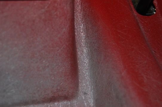

Pictures from behind panels
The door
The rear tail light panel
Rear Quarter
Rear Deck
The quarters have a little less visible fiber than the others.
Not sure if that helps decide if they are SMC or press moulded polyester

Still would love some comments from the experts on the inside panel pictures as to if my rear quarters are SMC and the rear tail light panel.

Hi C,
Here are some photos.
At the fear of being yelled at I won't post what I think the material is.
Again, this is a mid-January 1971 assembled car. (6589)
Regards,
Alan
Underside rear deck:
Tail light panel:
underbody and quarter panel.

Mine is early May 16432: May 6, 1971
Depends if smc started at beginning of 71 or mid production and was it just the quarters or the rear light panel as well
