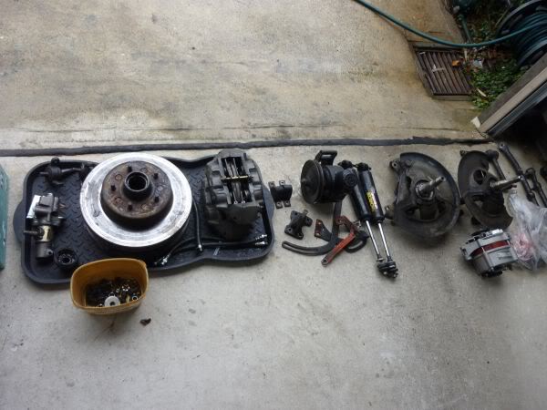

Have not been able to get much time but I have the lower control arm out now.
The upper arm needs the power steering pump moved or removed to get enough room to get it off.
Radiator out as well.
Some of the parts removed.
