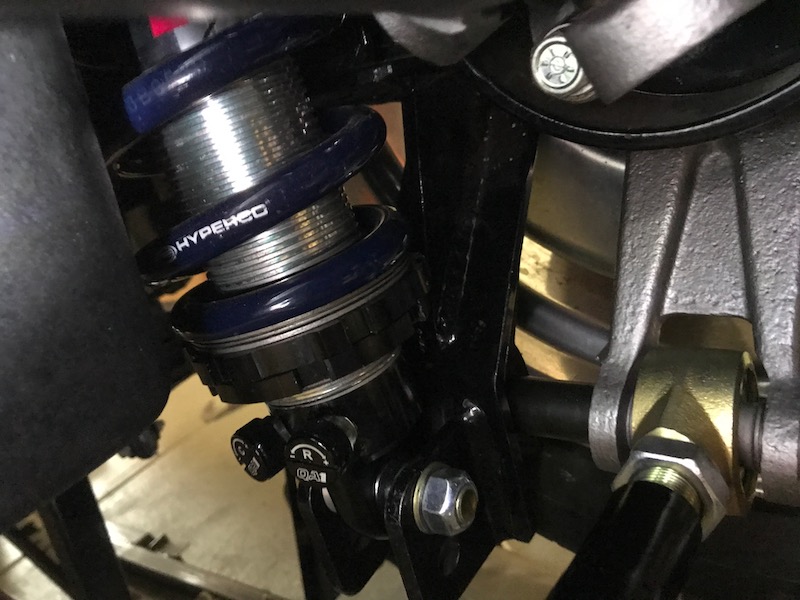

However when I want to run the rear of the Vette “low” I have heavily reduced the amount of travel in the shock.
I have cut down my bump stops by 1cm and only have 1.8cm gap before they touch.
So I have had a thud over high speed bumps like bad road joints.
What to do !!!
Talk to Dan at Van Steel and do a few more tests and it is the shock bottoming out.
Luckily QA1 have lots of shock body length options so next step is to work out what one would work best when the Vette is sitting down low.
If I screw the coilovers up 2 cm it has no issues whatsoever but...I like it lower...!!!’

As for shock settings is work in progress but i just went and checked and front C4R6 and rear C3R5.
Roads here are getting worse but that seems to work fairly well with a firm but comfortable ride.

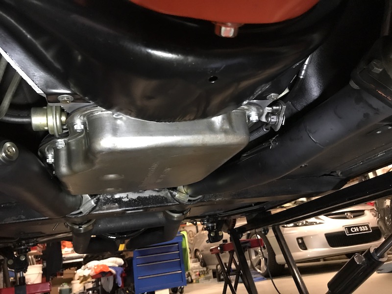

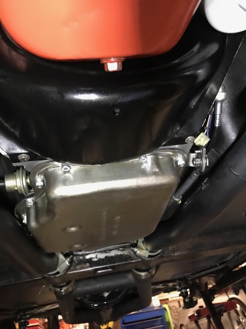

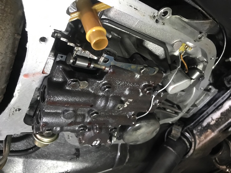

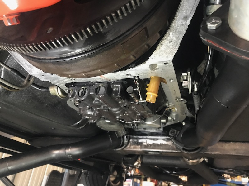

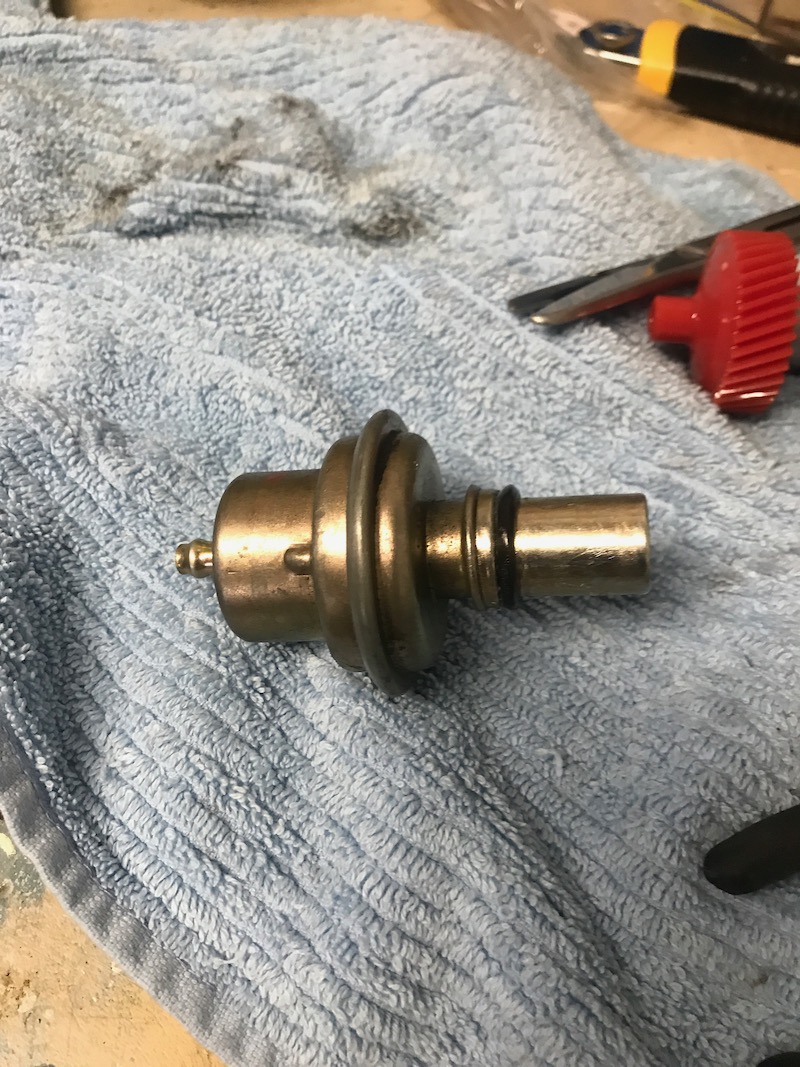

Changed the fluids in power steering pump then decided to do the transmission
Easiest to drop the front exhaust sections to gain better access.
Dropped the pan, not as messy as I thought it would be.

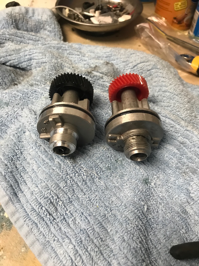

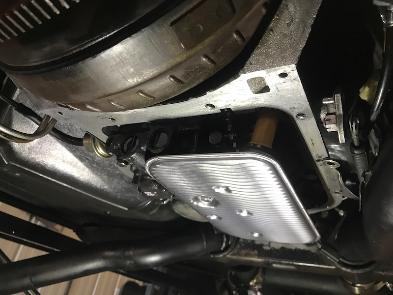

Then changed filter, o-rings on the vacuum actuator and swapped to the correct gears for my 3.36 rear end. Also calibrated the dip stick.

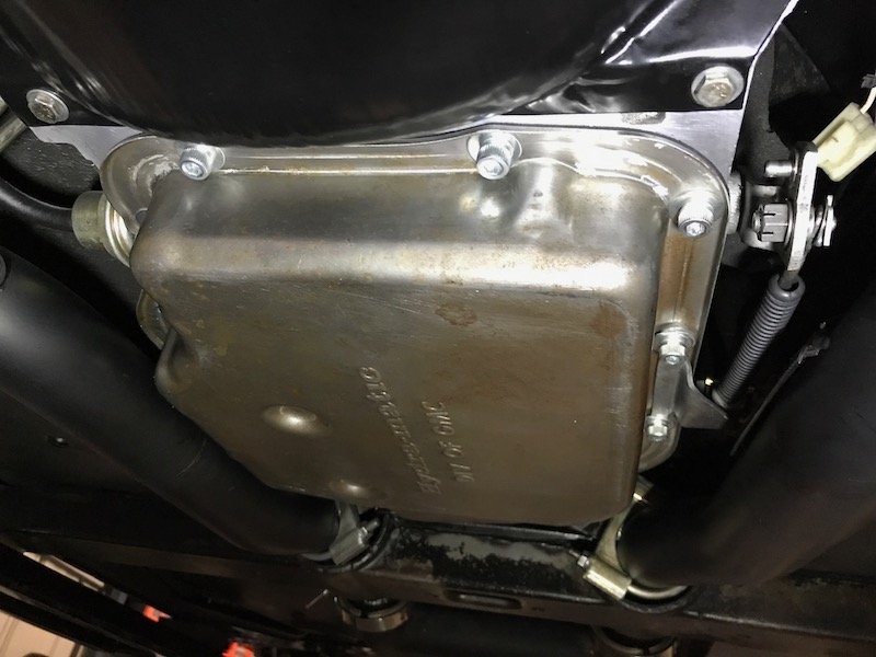

Had a nice aluminium pan but ended up going back to steel pan as it was too close to exhaust and also hung down a bit more than I wanted.
Spent a while panel beating all the edges before putting it back on using the keyed bolts from the new pan.

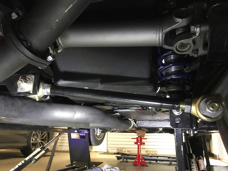

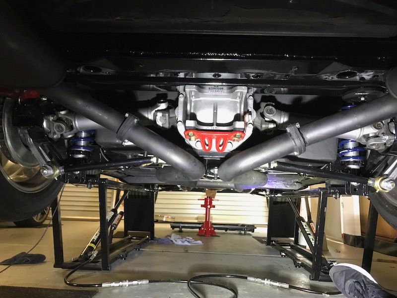

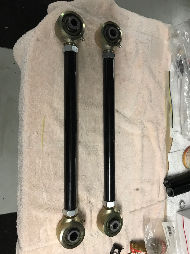

Yesterday my new shorter strut rods turned up from Vansteel.
Dan made me a 12" long set to handle the larger Johnny Joints I am using and allow enough adjustment.

Originally Posted by doorgunner
Aircraft Style and Quality
Well they are certainly robust. Hope they operate as smoothly as the trailing arms that are fitted with johnny joints.
When I had heim joints in the strut rods they were smooth but the centre heims squeaked and I could hear a rattle/vibration at low speed.
As I took the off I found one of the outer heims was very loose compared to the others. possibly the issue.
The Johnny's should transfer a little less harshness than the heims

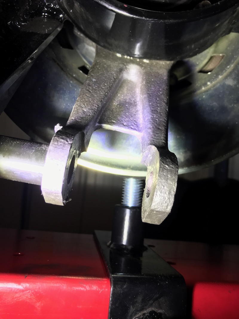

Got back onto the Vette this week.

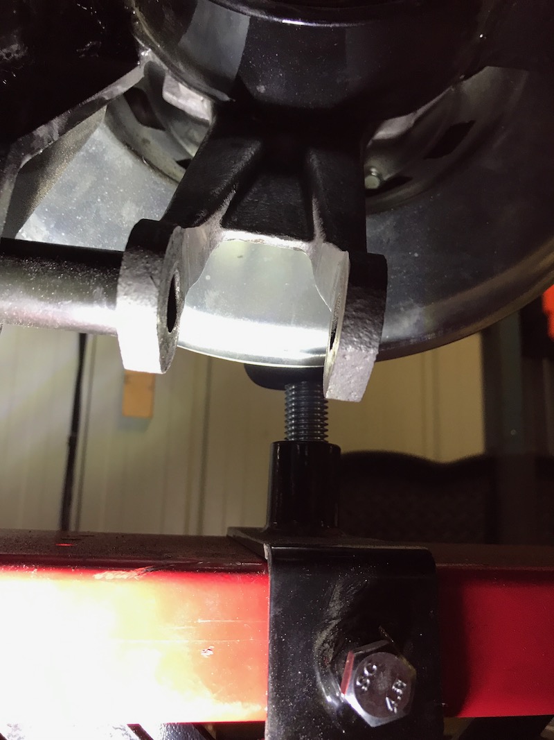

To fit the Johnny Joint strut rod ends I wanted to smooth out the outer casting to ensure no chance of contact.
This shows the rough machining from factory.
I smoothed out a transition so the joints will have heaps of clearance.

Fitted the strut rods today and did a rough starting adjustment for camber.
Will get on ground and do some more adjusting then tighten lock nuts.

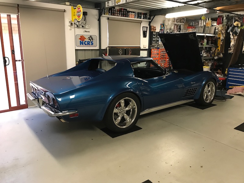

Got a chance of Friday to do a good shake down drive with the the new Johnny Joint strut rods, revised ride height and its all feeling very good. The strut rods transfer less harshness than the heims and feel very solid.
Overall ride is excellent and controlled, great street manners with no darting on ruts etc etc, even with my home alignment. Enough suspension travel up and down with the new shorter coil-over bodies in the rear.
Transmission shifts much smoother after the service as well.
Vette is a bit dusty and dirty but still looked good in the sun.

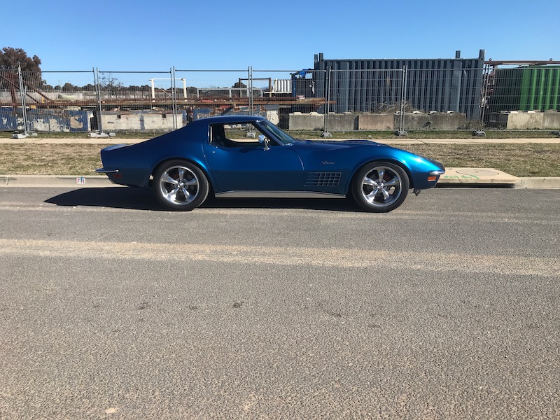

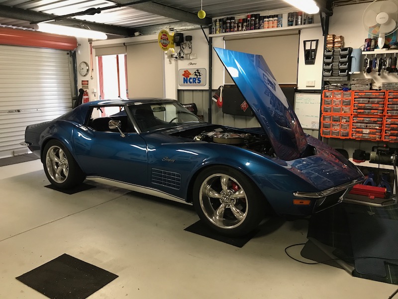

So I think I have my ride height just about correct now.
I can fit my fingers to the knucles between tyre and wheel arch.
It measures ground to lip.
- Front 26-1/8"
- Rear 26-7/8"
