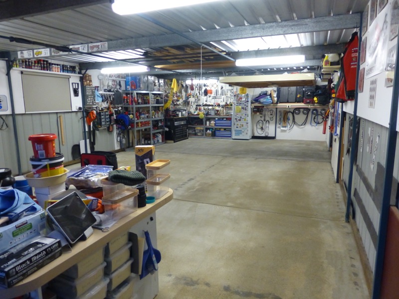

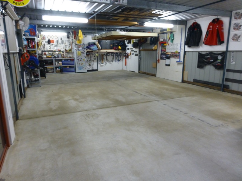

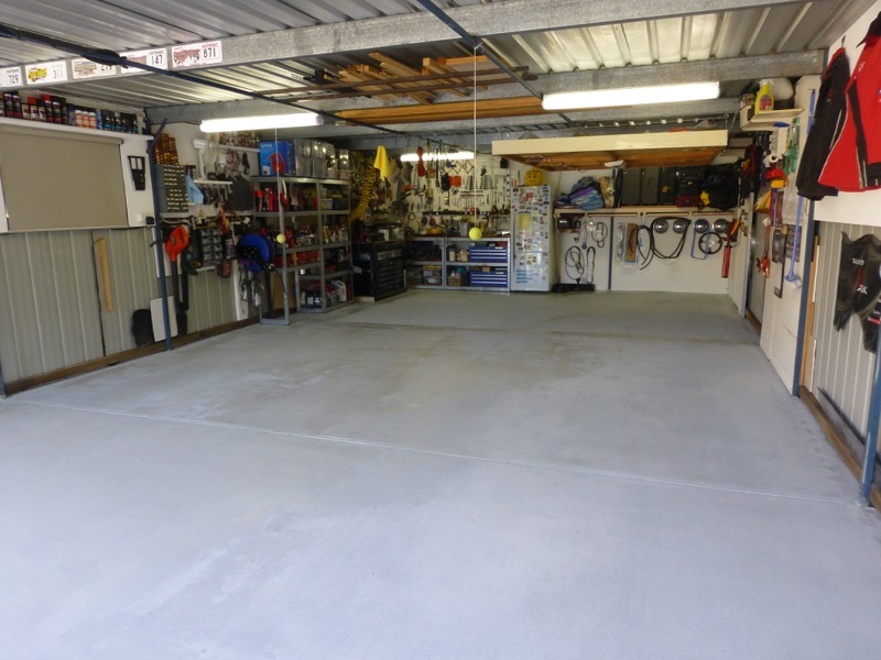

Started work on my garage floor today. Have been meaning to do this for ages.
Went around and ground down any non smooth joints, filled all divets etc as it has been extended and had an inner room built and pulled down over the years
Did a test patch under the fridge to see how the paint process will go. Cleaned concrete, acid washed surface to give a good bite then 3 coats of paint.
Now I just need to wait for a week with a number of warm days in a row so I can take on the rest of the project.
Will probably do it in 2 stages.

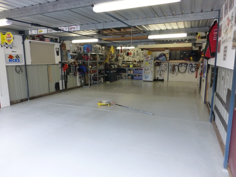

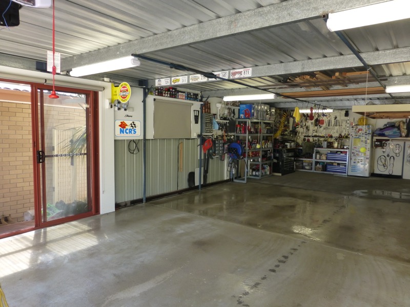

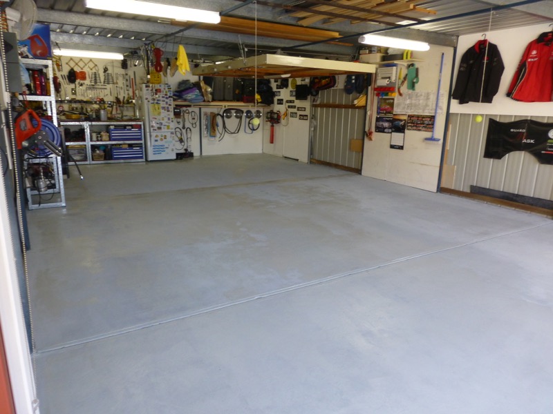

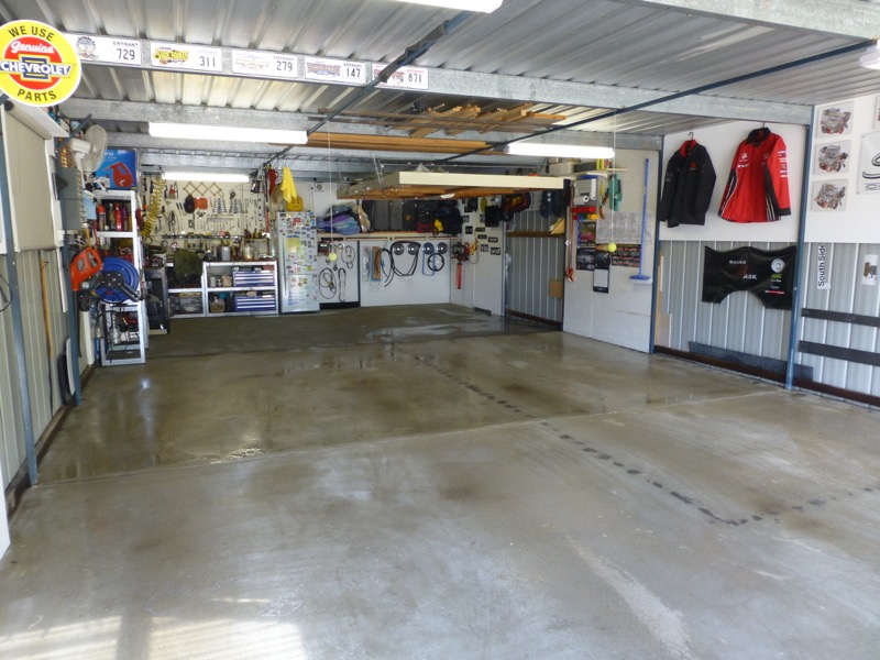

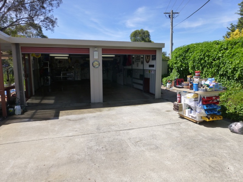

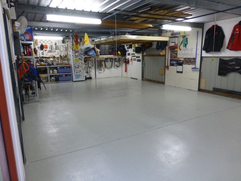

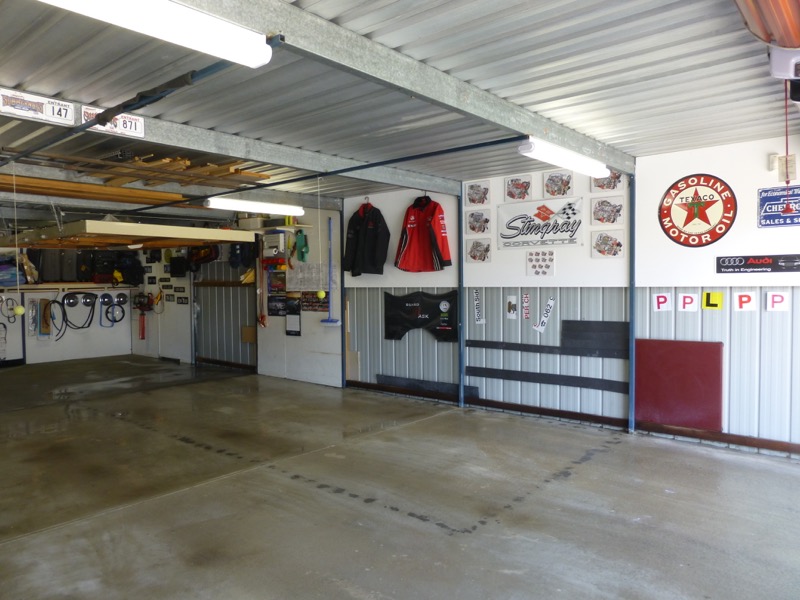

Garage work continued on the weekend.
Removed most movable gear out of the garage including the vette.
Floor was first power washed to remove initial grime then sprayed with degreaser and floor wash and allowed to soak.
Then power washed again.
Then sprayed with acid to etch the surface, then power washed a final time and allowed to dry.

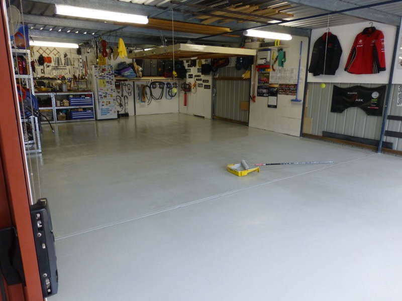

First coat of floor paint went on diluted with mineral turpentine to get it to soak in better
Second coat went on undiluted and third coat the same.
Third coat finished, just needs to dry for a few days.

Good advice!
My car is to the point that the "messy work" is nearly done............
I need to refinish the garage floor (per my darlin' wife)

Always sound advice to follow - when given by the wife :-)
Will be interested to see how robust the finish over time is but as long as it keeps the garage a bit cleaner and removes the dust it has to be worth it.

the garage looks great.

great work, both the car and garage look excellent.....

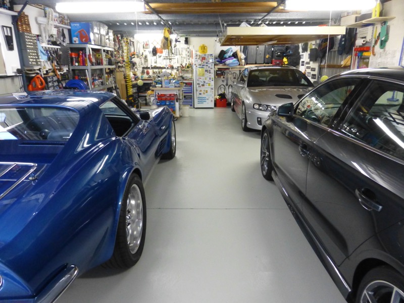

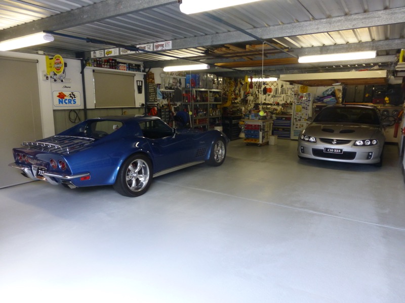

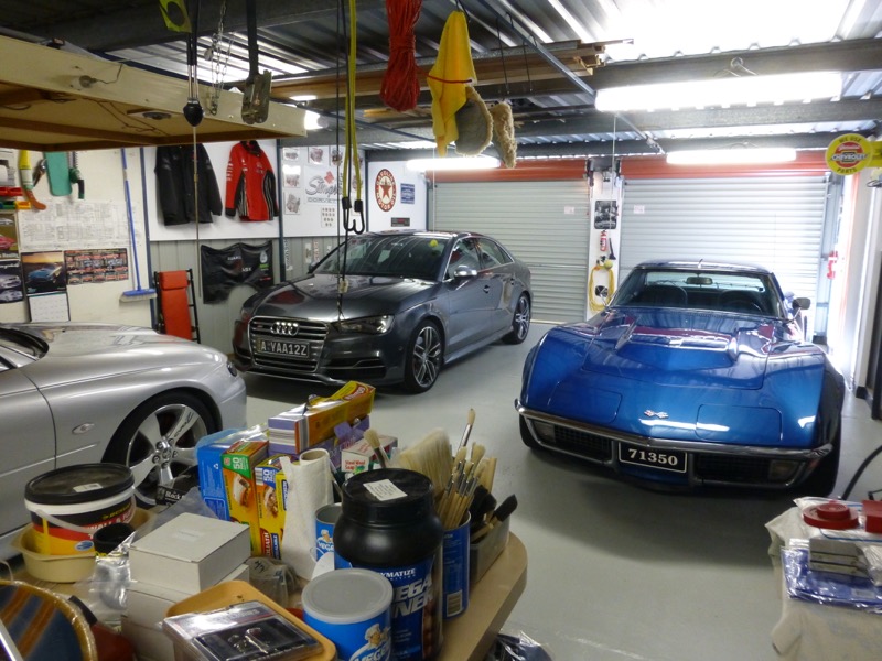

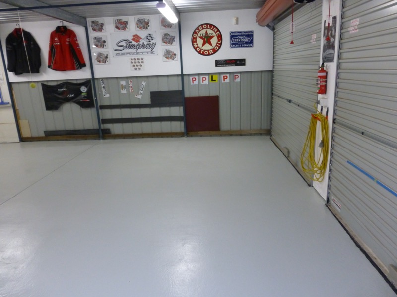

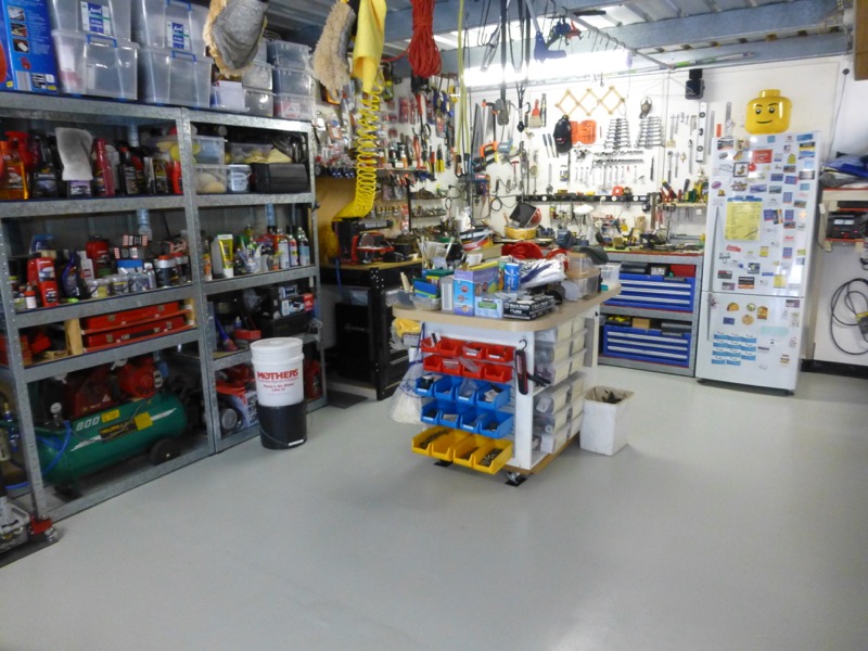

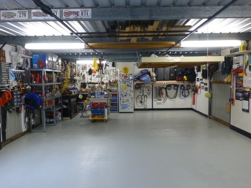

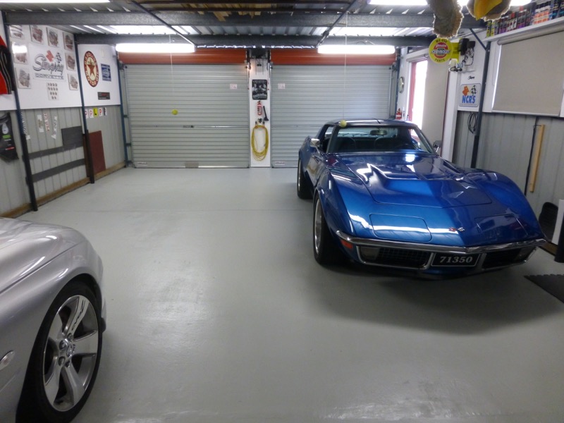

We have had rain on and off since I finished the garage floor.
Instructions said 2 days before driving on to so i left it 5.
Happy with the finished result now need to work out what to put back and where.

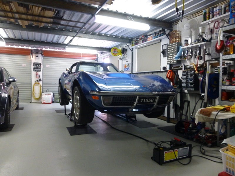

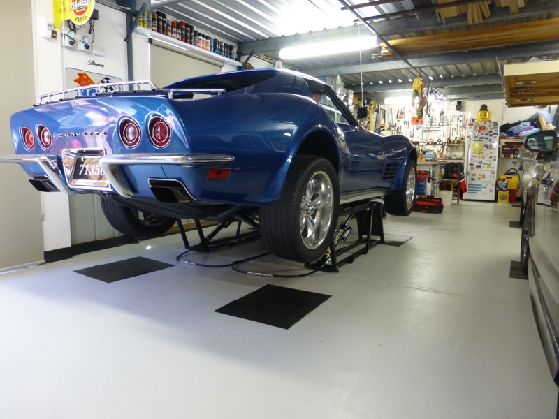

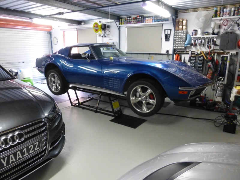

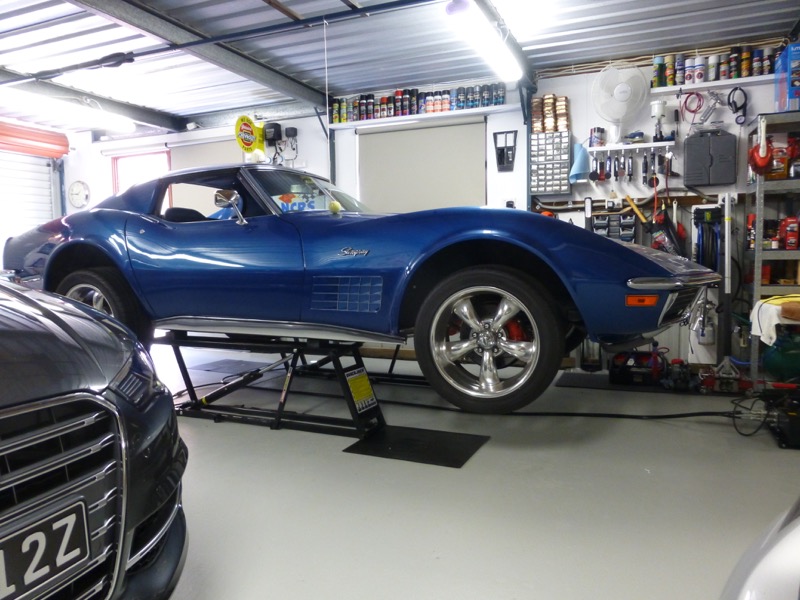

Got my Christmas gift a little early. QuickJack BL5000
Low garage roof so best option, portable as well.
Garage floor came out looking good Craig
Where did you get the lift from?
