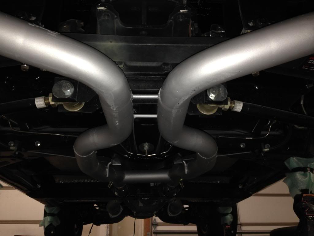

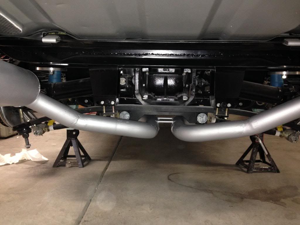

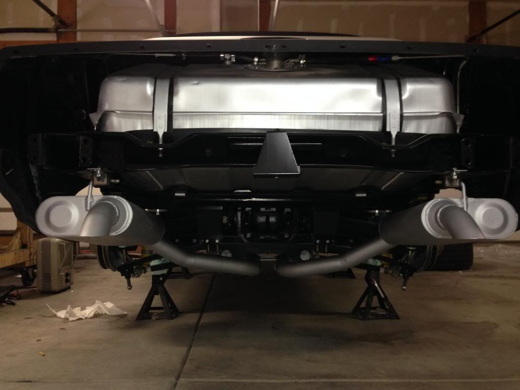

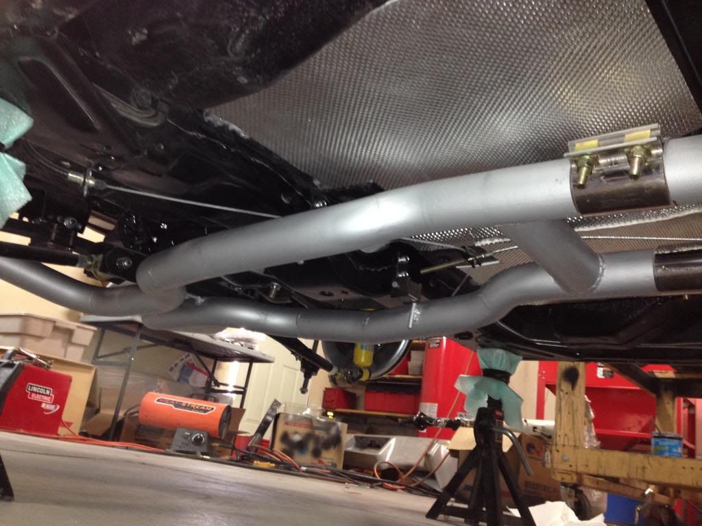

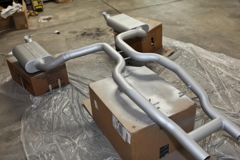

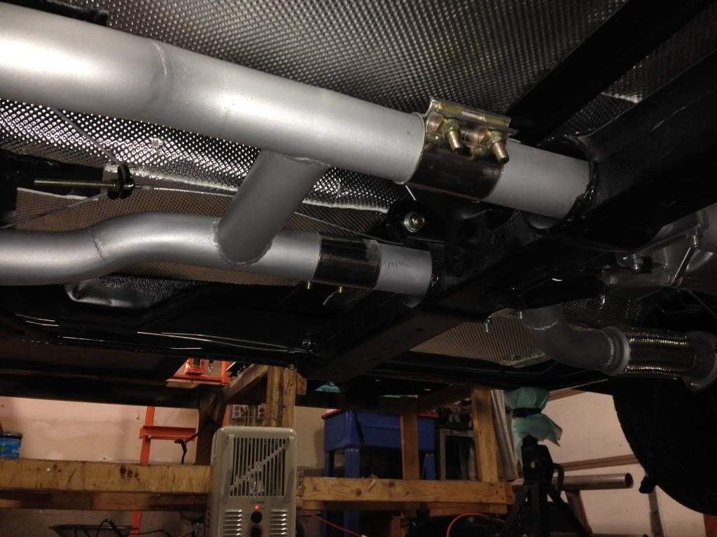

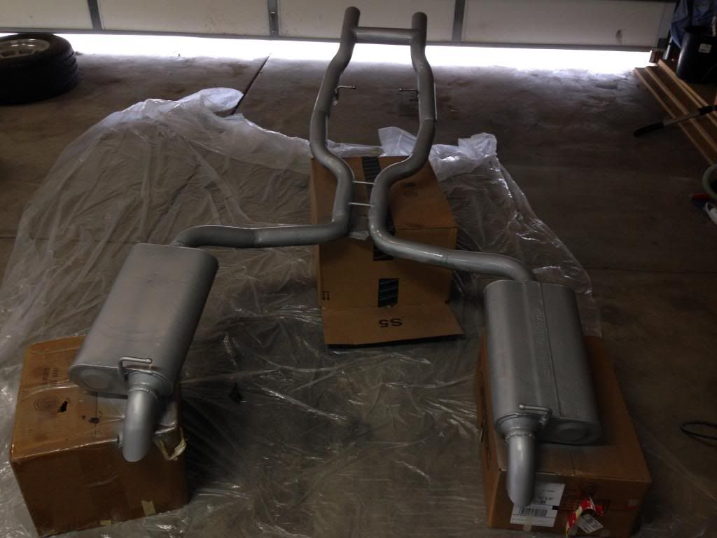

I finally finished the exhaust! It all went really smoothly and the only hard part was matching the two sides where they come up from under the dif to the mufflers. The kit I used was $170.00 from summit and the only thing that I had to add was one more 90 degree bend for the little tail pipes but it was $14.00 from the local parts store.
Just ordered my Painless wiring harness from summit!
I went to pick up my valve covers from the powercoaters but there was dirt in the finish so they are redoing them.

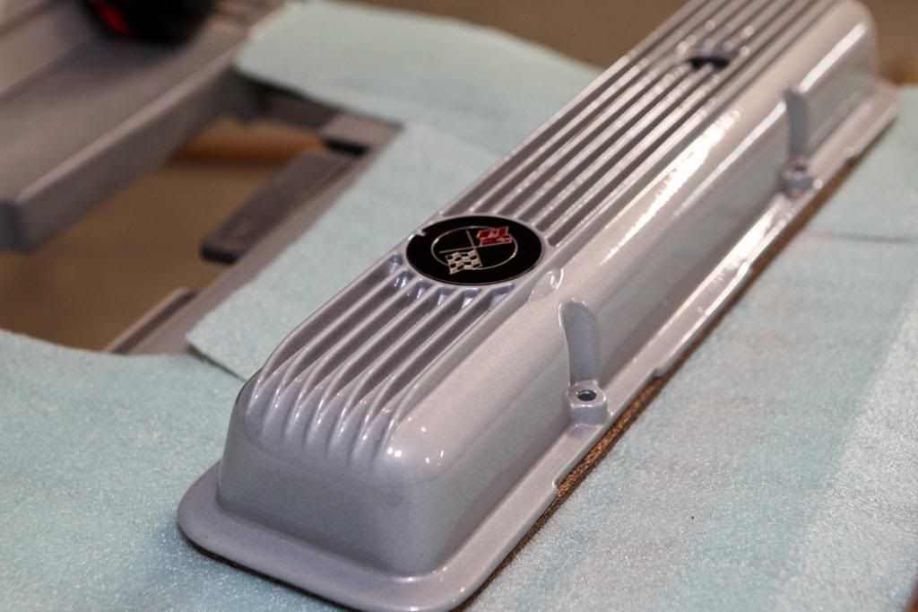

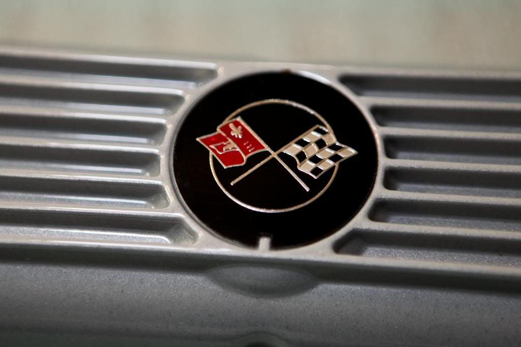

Just got my powercoated valve covers back.

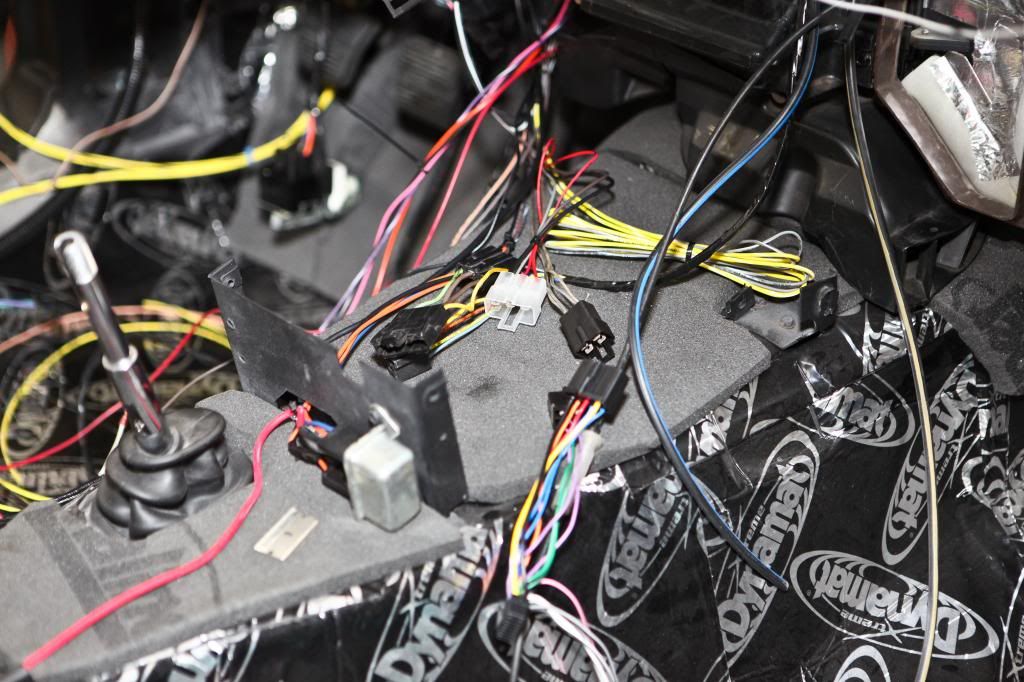

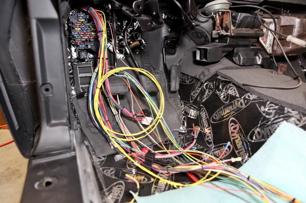

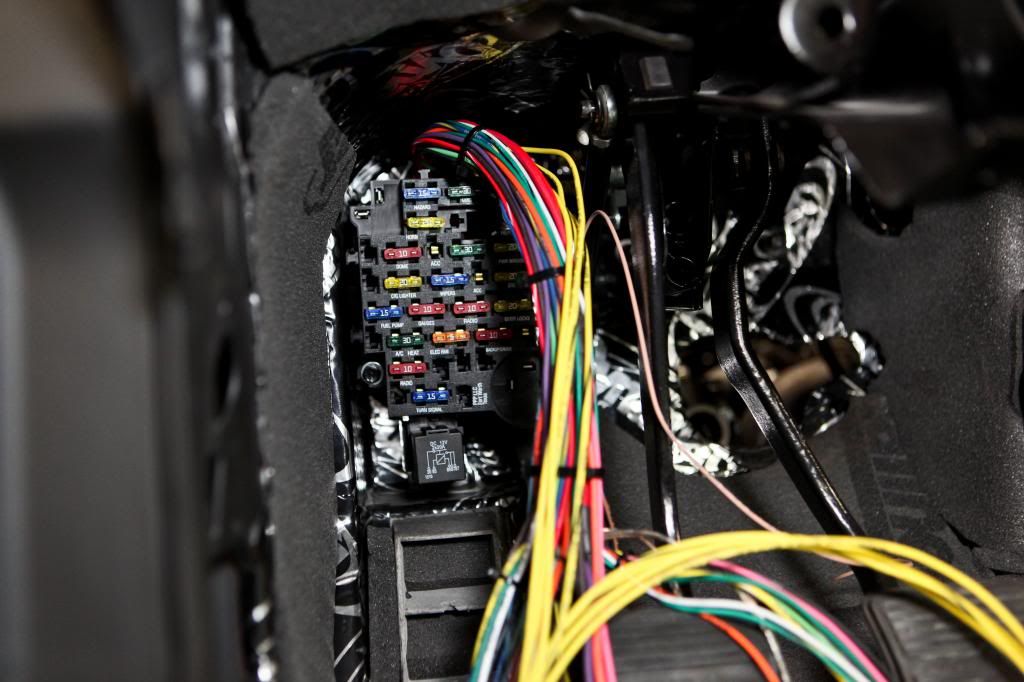

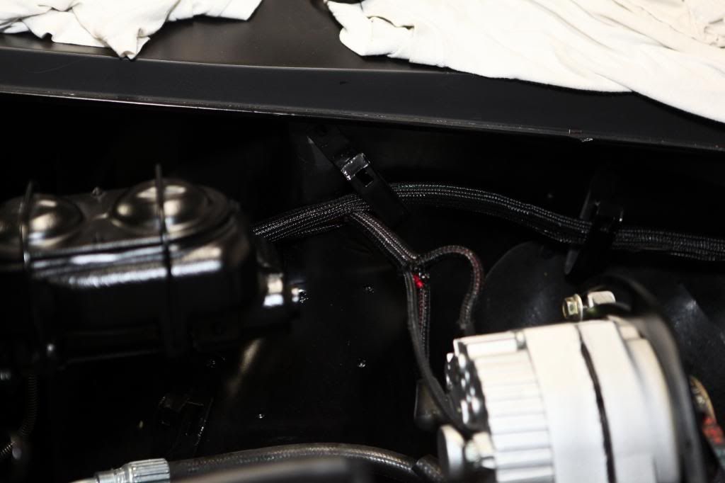

I Just got my Painless wiring harness. I am going to try to post lots of information and photos as I do this. Its going to take some time but I think it will work out well.
So far all I have been doing is looking over everything and figuring out how I am going to set it all up. I plan later to go to fuel injection and electric fans so I want to have everything wired ready for that.
I did bolt the fuse block to the fire wall and its a perfect fit.

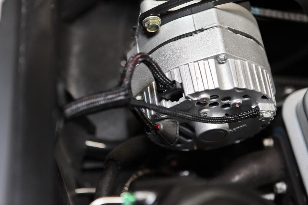

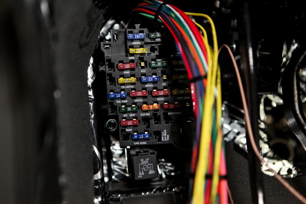

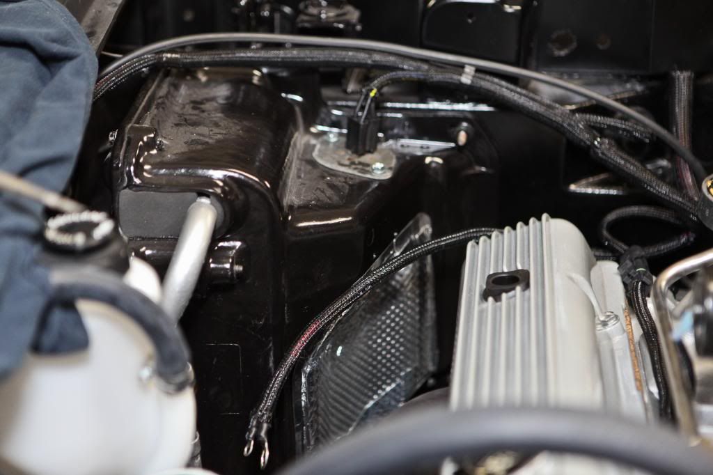

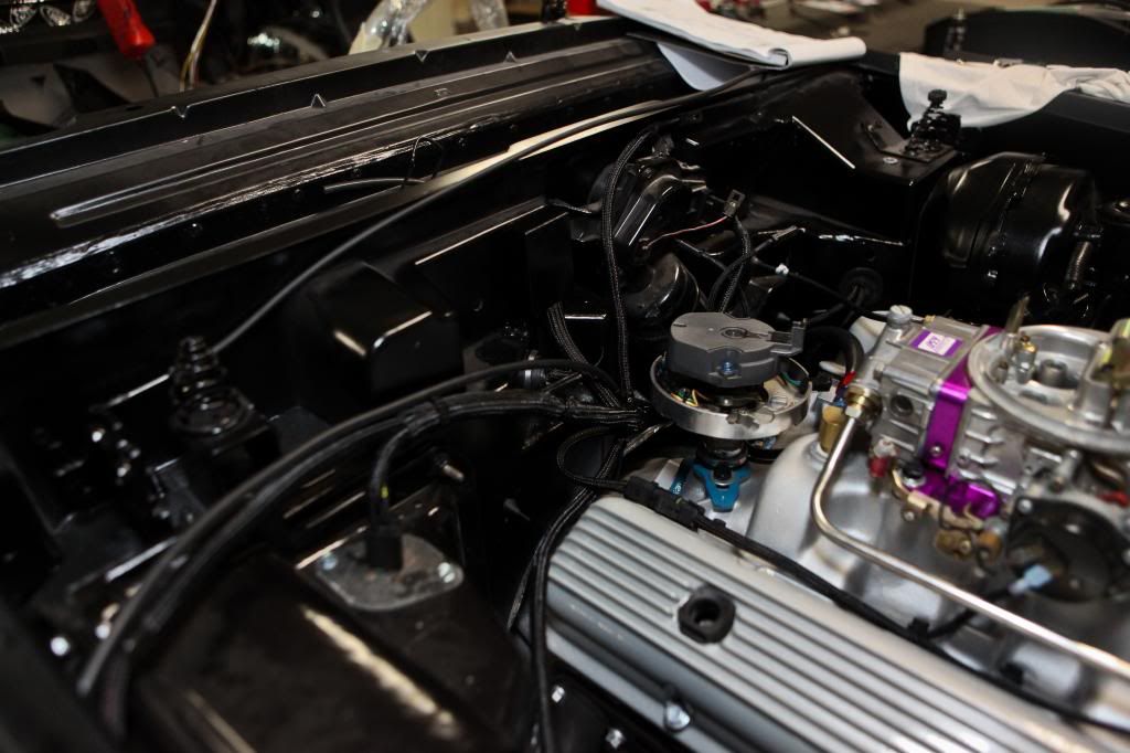

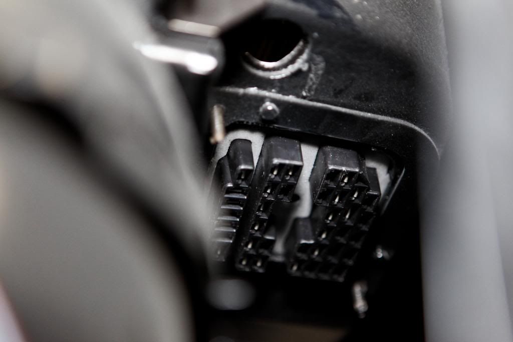

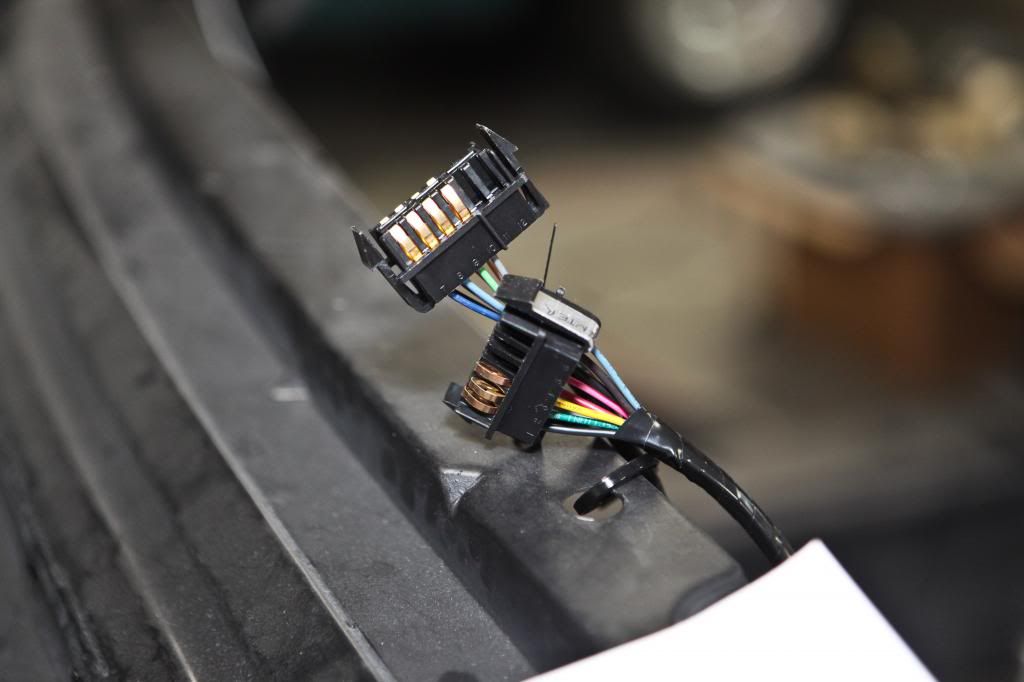

Adding a few photos of my Painless Wiring harness.

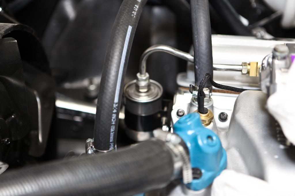

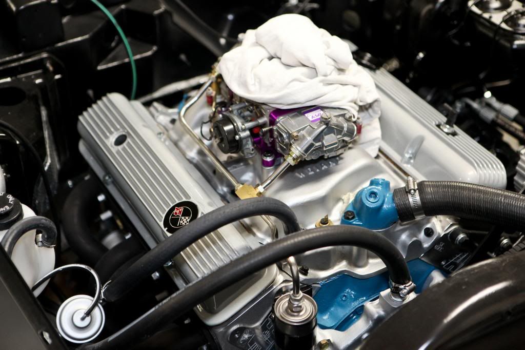

Here is a close up of the GM fuel filter that is used on 1987-late 90s vettes and most other newer GM vehicles. I also used a Ford coil bracket to mount it.

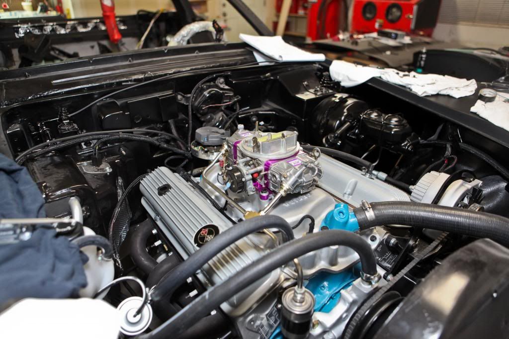

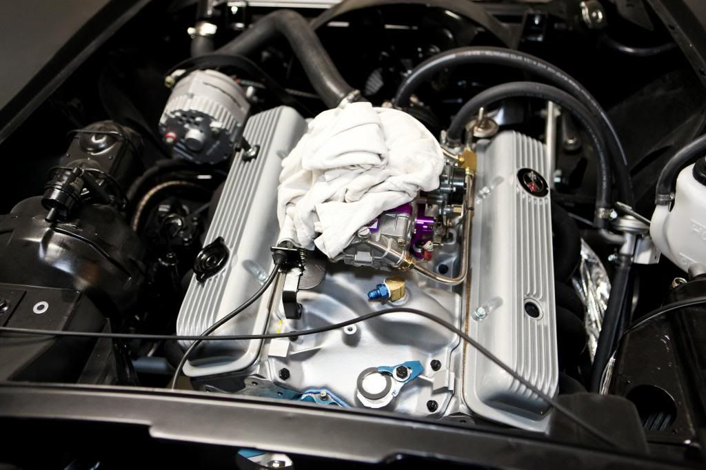

Where did you get the pink/purple carburetor parts?
Old Feb 1, 2014 | 11:19 PM
  #96
mac79vette's Avatar
mac79vette
Joined: May 2008
Posts: 582
Likes: 9
This is a proform carb and that is the color they come. This carb is about 10 years old. I wish it was black but not spending any money on it because I plan on fuel injection in a year or 2.

Any idea what sort of FI? True FI or TBI?
To 79 Corvette Build Thread
Old Feb 2, 2014 | 12:32 PM
  #98
mac79vette's Avatar
mac79vette
Joined: May 2008
Posts: 582
Likes: 9
I guess your referring to multie port injection when you say true FI? I am looking at the FAST TBI with the 8 injectors that are in the base plat area of the TBI unit.
