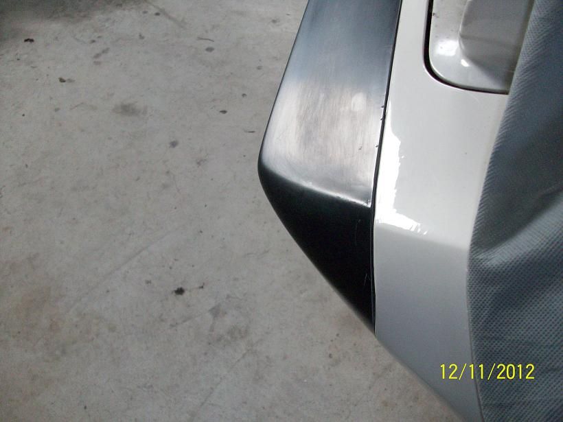

heres how mine first fit...trueflex on a 73. dont let the flex name fool ya, theres very little flexibility. i had to work mine over quite a bit, filling w resin/mat and sanding. also had to sand the body where the bumper met up, i had a few high spots and cracks to take care of. had a local body shop paint it, they did a wonderful job matchin the color.

heres a couple after shots. fyi it took me longer to mount and fit the front bumper than it did to rebuild my muncie. you mention quality and longevity...i dont think ull have issues w either. the piece seems strong and heavy. there was just enough give to get the top seam lined up well without applying what id consider excessive force. for the final fit along the top seam i was able to press slightly with one hand and snug the mounting hardware w the other. the boday shop was willing to paint the bumper on the car, i really didnt want to take it back off once i had it where i wanted it. they charged me $200 for the paint.

learje,
Thanks for the pictures and the explanation. This has really helped me understand what people mean by fitment issues and the difference between the types of bumpers.
I know you said you bought a truflex, but just out of curiosity, do you have any idea, or opinion, on the difference in work and time that would be needed if you bought a regular fiberglass bumper over the truflex?
